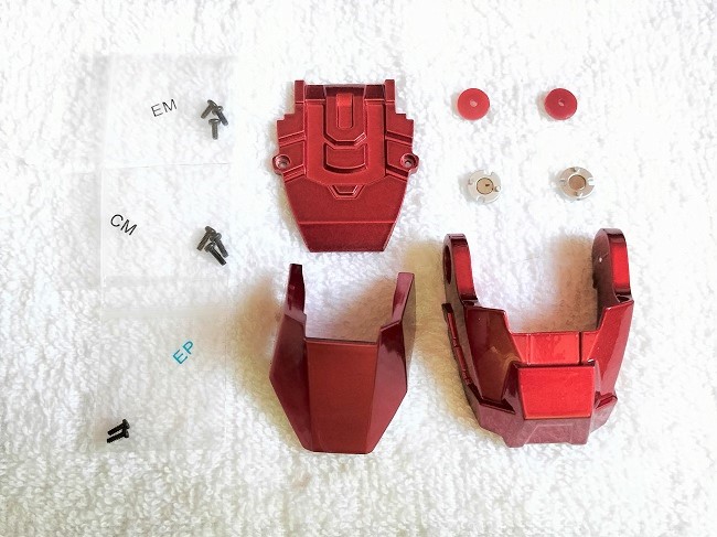

The parts supplied with issue 47 are shown in Pic 1.

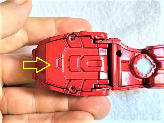

To start the construction you need to bring the foot constructed (up issue 46) back to the work space and add the two Red Joint washers and Toe parts that were supplied with this issue. Pic 2.

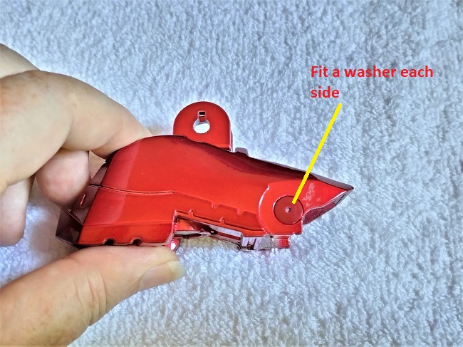

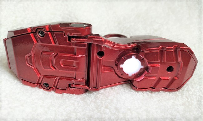

Position a washer either side of the foot as shown in Pic 3.

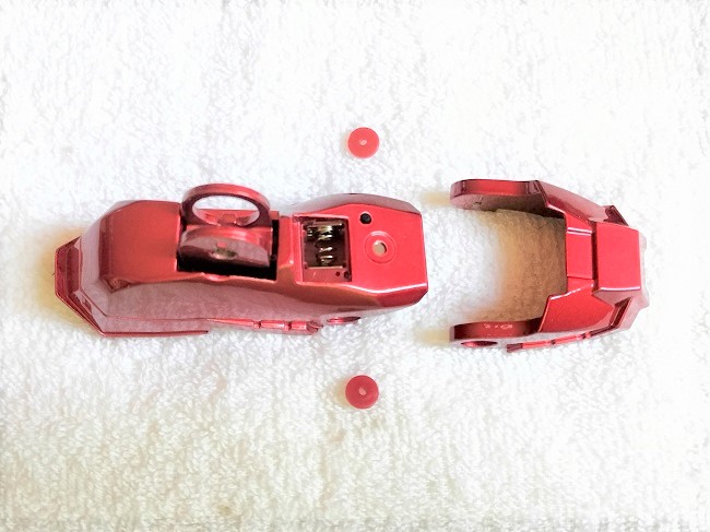

Now, whilst holding the two red washers in place , slide the toe section over the front of the foot. This will hold the two washers in place . Pic 4.
Carefully making sure the washers don`t fall out of position, fix the Toe section in place using a CM screw on both sides that pass through the toe section, washer and into the main foot assembly. Pics 5 and 6. NOTE: How tight you tighten these screws is up to you, but I would suggest that when you move the toe section that you can feel some resistance to the movement.

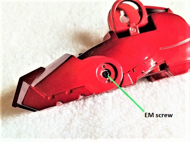

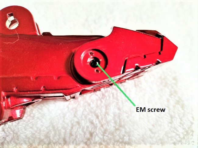

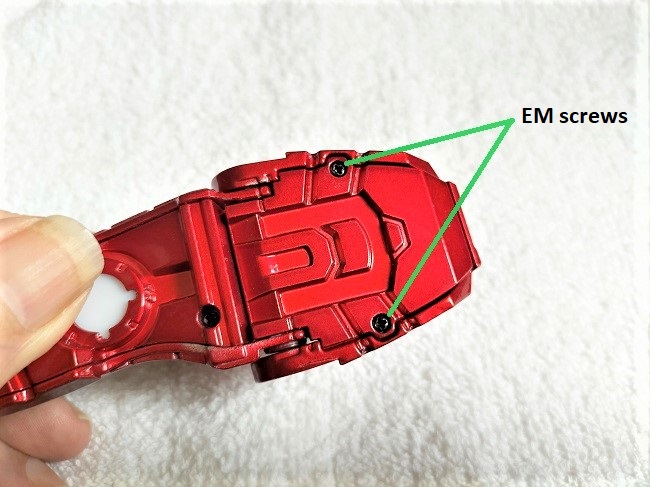

The next thing to do is insert the front sole into position and fix it in place with two EM screws as indicated in Pics 9 and 10.

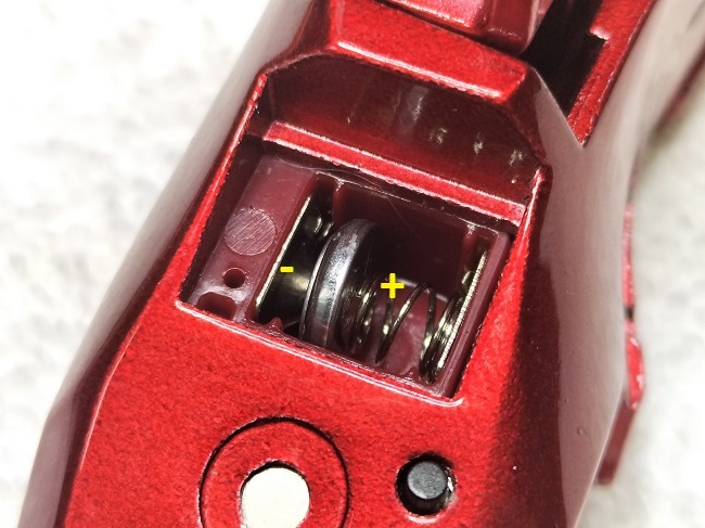

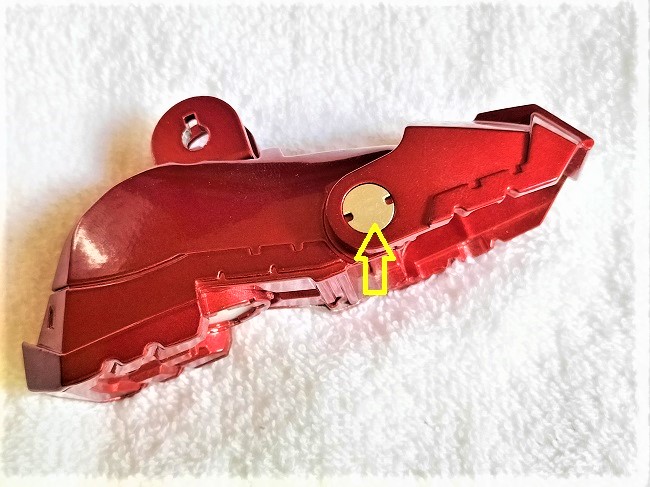

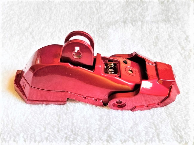

Start by inserting the battery supplied with an earlier issue into the battery box, with the polarity as shown in Pic 11. As the battery is firmly held in place by the spring pressure, I chose at this point to test the workings of the LED in the sole of the foot. Pic 12.

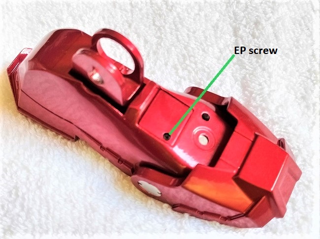

If all is working correctly, switch off the LED and fit the battery cover and secure it with an EP screw (both supplied in an earlier issue). Pic 13.
Fit the magnetic foot cover in place on the instep and that completes the assembly of the right foot, Pic 14. Store the foot away safely as it will not be used again for a while.

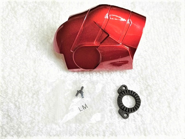

Parts supplied are shown in Pic 1.

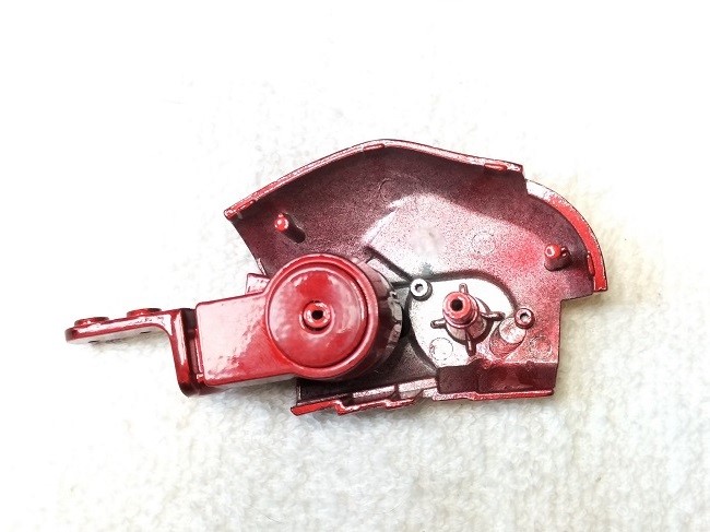

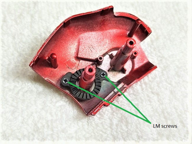

Place the gear ring into position on the right knee cover and fix it in place with two LM screws as per Pic 2.

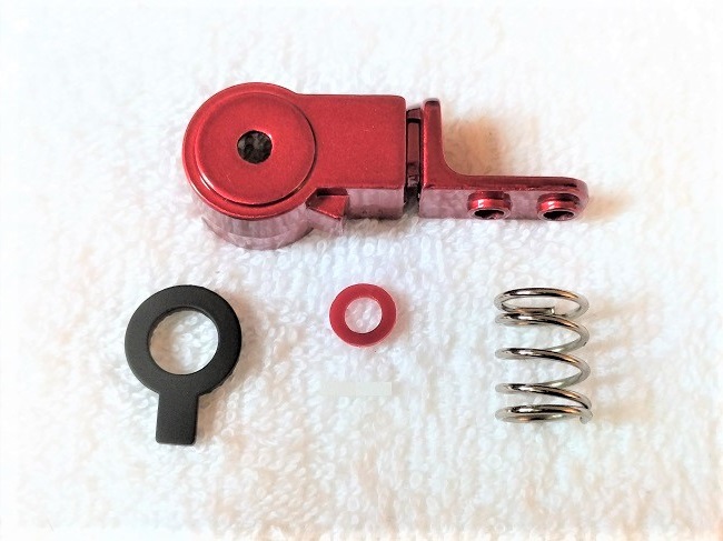

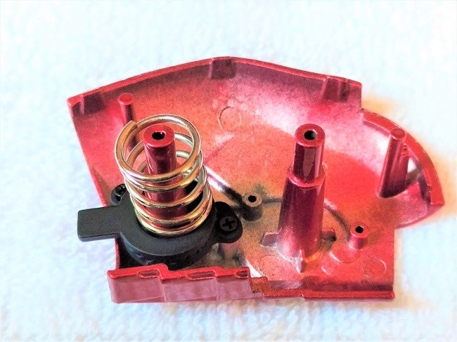

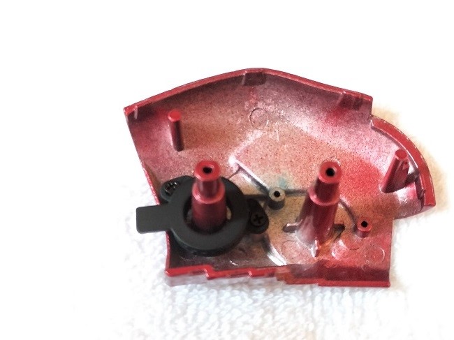

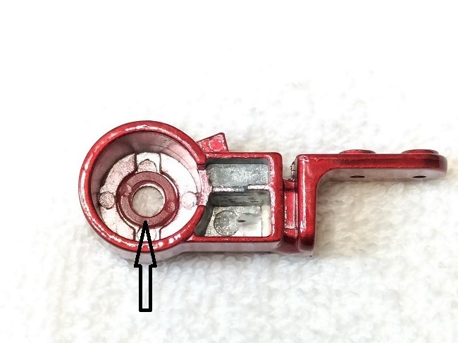

Position the rotating gear ring as shown in Pic 2. NOTE: The position of the tab on the ring will give you the mid point of movement for the joint, so should only be set as shown.
Now position the spring as shown in Pic 3.

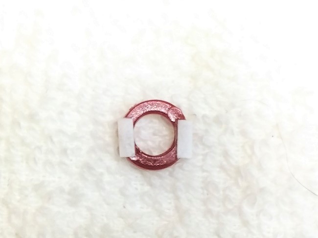

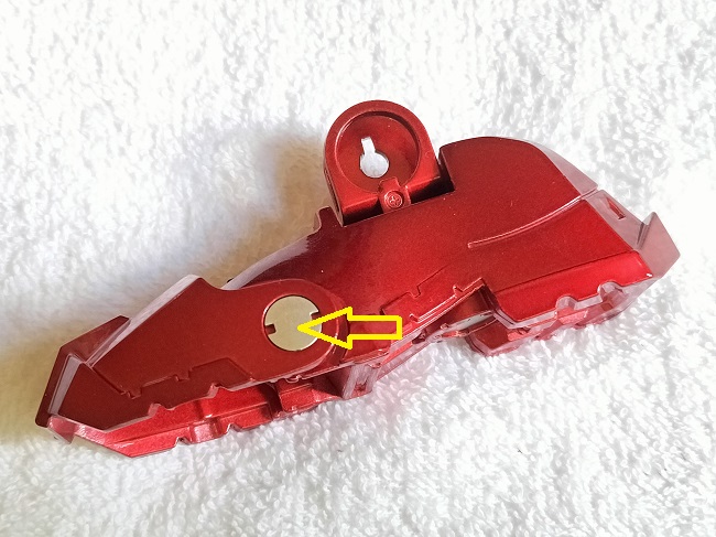

I used a pair of curved pointed pliers to position the double sided tape onto the washer as shown in Pic 4 which meant the natural grease of my fingers didn`t affect the glue of the tapes. Then removed the paper off the second side with a sharp craft knife, before placing the washer (using same pliers) inside the lower right knee joint. Pic 5.

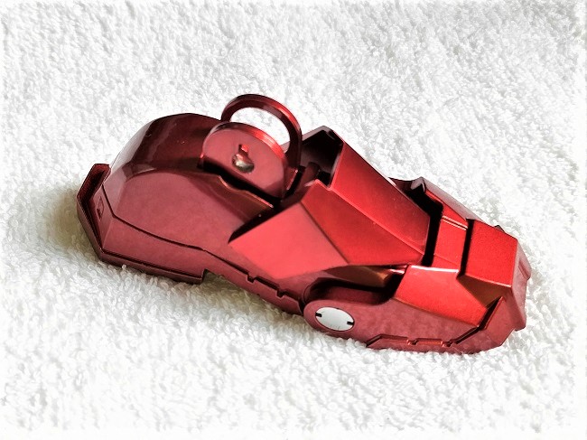

All that`s left to do now is position the lower knee joint over the spring of the main assembly. Pic 6.

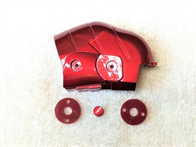

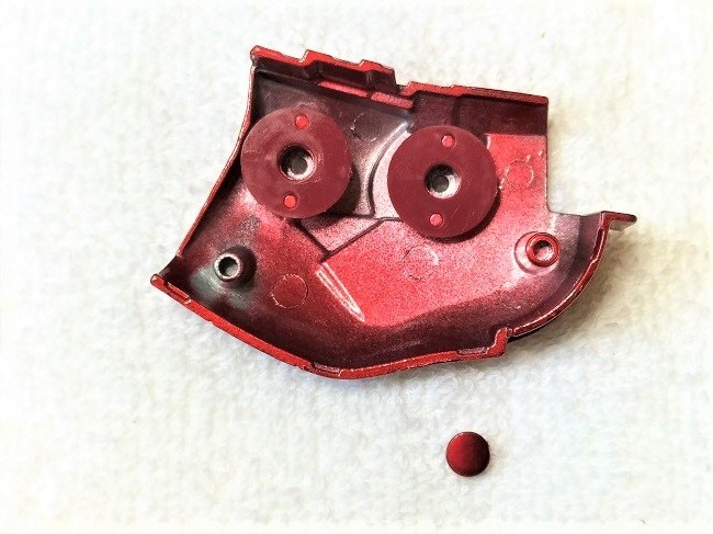

From the parts supplied, position the two washers into place on the inside of the knee cover. Pic 2.
You will have the screw cover unused at this point, so keep it safe as it will be used at a later stage. Note: I still have the screw cover for the first knee joint unused at this stage. I intend to leave this as long as possible before fitting it, as it may be necessary to adjust the joint and the screw cover will be difficult to remove.
