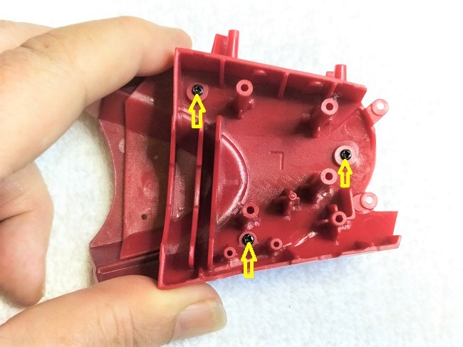

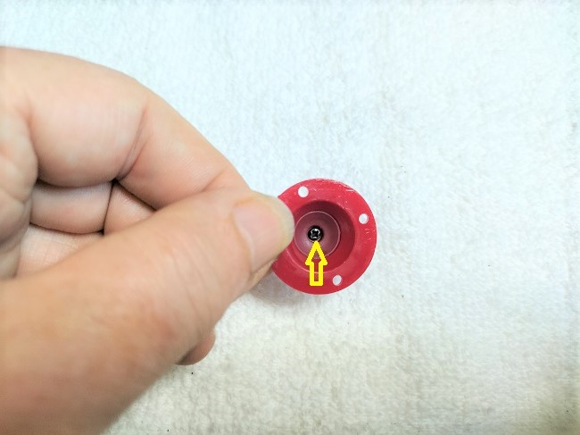

Parts supplied are shown in Pic 1.

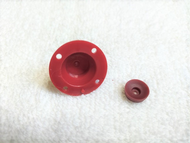

Now press the two washers firmly on their respective posts, whilst making sure they locate squarely onto the two pins with the small holes in each washer. Pic 2.
Note: I say "press the washers firmly in place", because in the next issue you will turn this part over and you won`t want the washers falling off. (Believe me Blink ).
Well that`s it for Issue 31.
See you very soon for Issue 32.Drool

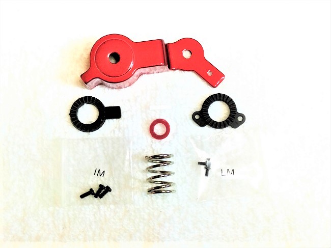

Parts supplied with this issue are shown in Pic 1.

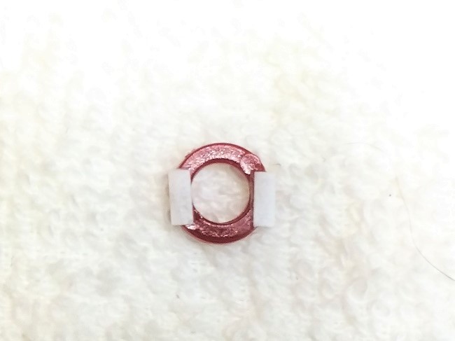

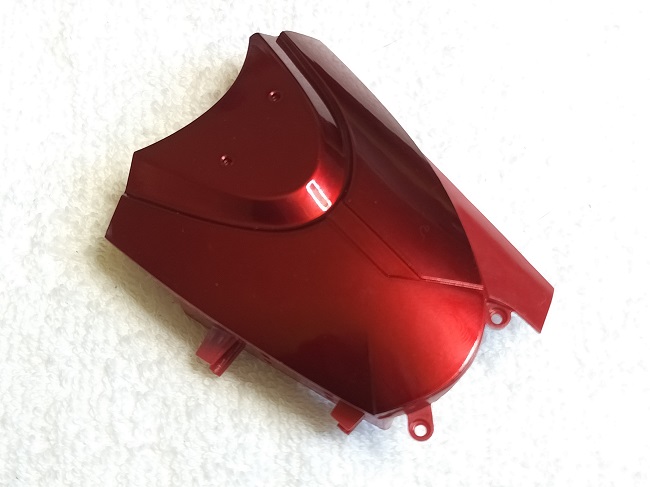

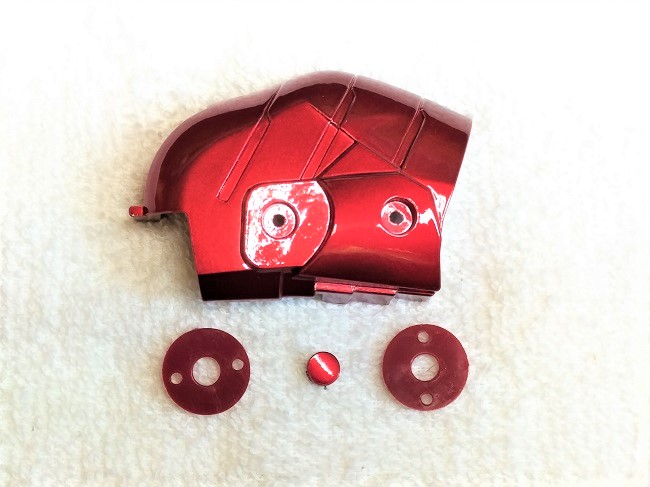

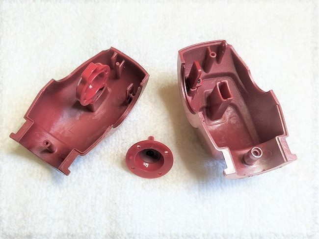

Stick the double sided tape onto the washer as before Pic 2, remove the second covers of the pieces of tape and carefully position the washer inside the Upper Knee Joint and press firmly in place. Pic 3.

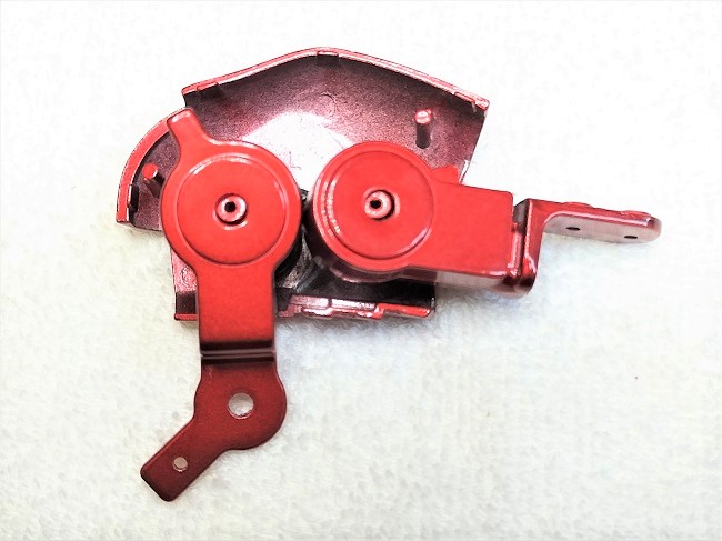

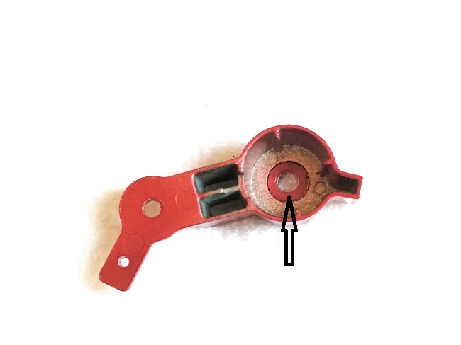

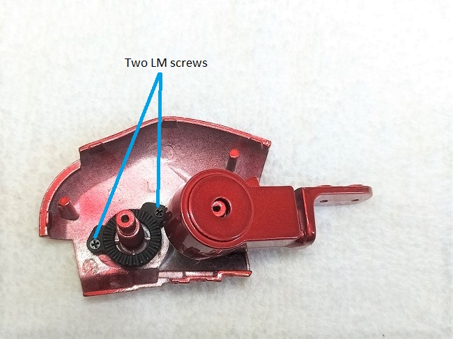

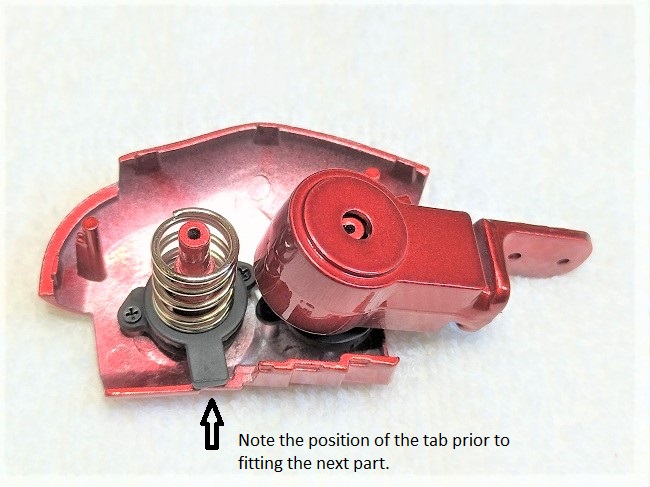

Next fix the gear (without the tab) in place and secure it with two LM screws. Pic 4.

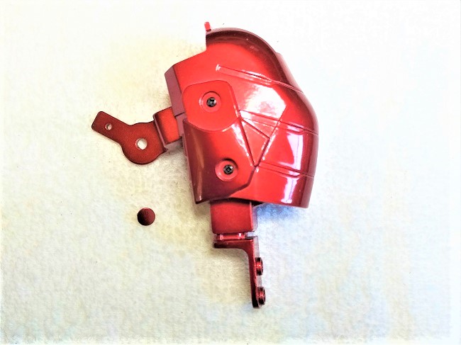

Noting the orientation of the tab on the other gear, position it as shown and then place the spring on top. Pic 5.

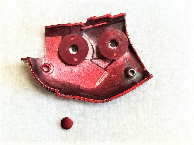

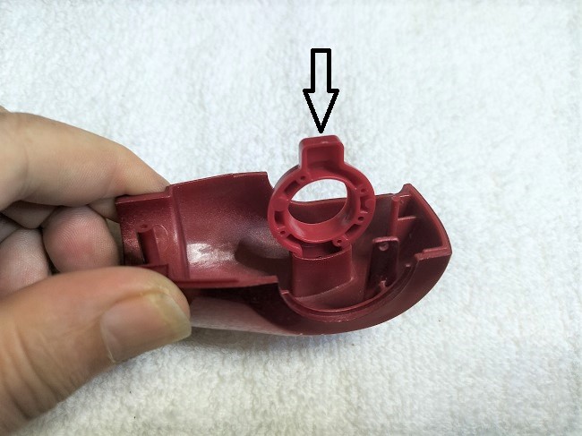

Before we close the Knee Joint carefully position the Upper Knee Joint in place as shown in Pic 6.
What comes next can be a little tricky, you will take the assembly from issue 31, invert it over the assembly from this stage and press all the parts down against the spring pressure. The parts should all come together, with the tabbed gears locating into the cut outs under the upper and lower knee joint parts, then screw all the parts together using two IM screws.

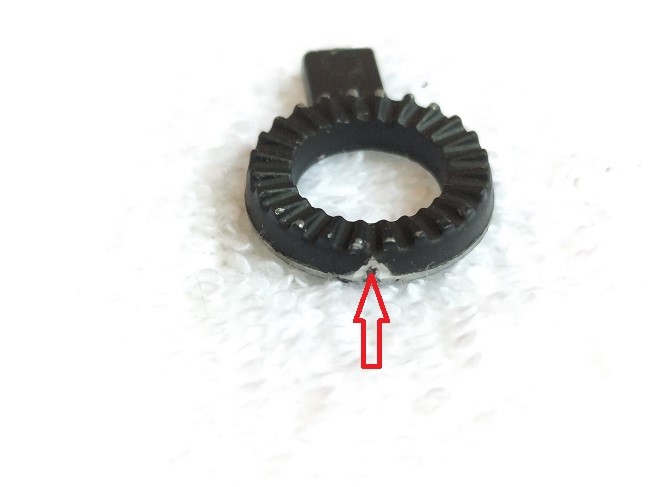

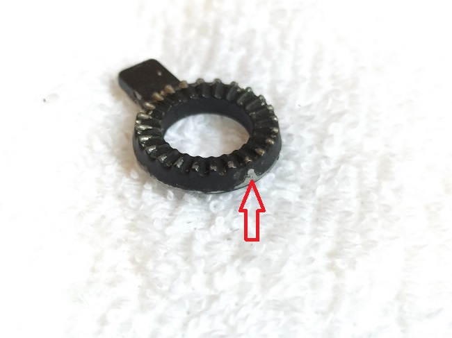

Whoa Tiger: what if the parts don`t all come together by about 4 - 5 mm. This was the problem I had. First thing to check is, have the tabs on the upper gears located correctly into their relevant knee joint. Well mine were in line but I couldn`t get the parts to close any nearer. After further investigation I found that the knee joints could not pass over the tabbed gears as they should.Confused Confused Confused Having made a close, critical observation of the tabbed gears I found the problem. The tabbed gears are cast metal items and where the castings should have ended there was a large amount (well enough to cause a problem) of metal that mis-formed the circular shape of the gears .
Solution: Using just a miniature file I removed the excess metal and problem solved.
Now, as I said earlier this may have been just a one off problem, but at least you now know what to do if you have the same problem.Flapper If you check out Pics 7 and 8 you can see what was done for the fix.

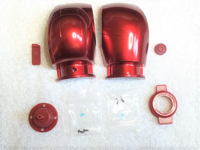

This update is for Issue 33 and is the start of the Hip Joint.

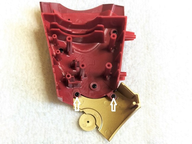

Bring the Hip Joint Cover (33a) and the Joint Support Bracket to your work space. Position the bracket inside the cover and fix it in place with LP screw as shown in Pic 2.

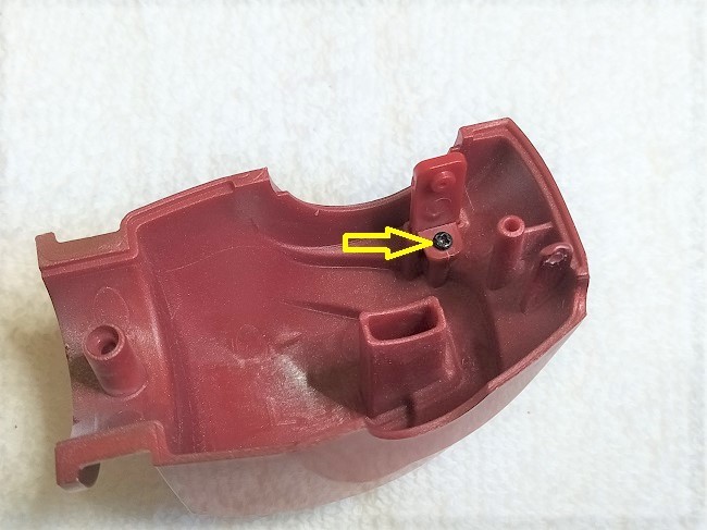

Now, take the second Hip Joint Cover and the Bearing Ring to your work space. Press the Bearing Ring into place inside the Cover making sure that the orientation is the same as shown in Pic 3.
The last two parts supplied in this issue are the Socket and Joint Bearing. Pic 4.
Position the Joint Bearing inside the Socket and secure it in place with an IP screw as per Pic 5.
You have now completed the first three components of the Hip Joint, Pic 6 and completed this stage.

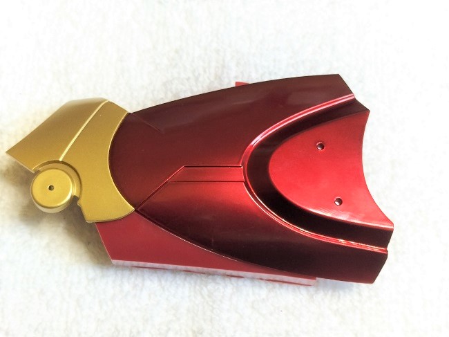

Start by positioning the the Outer Thigh Armour Plate on top of the Outer Thigh. As seen in Pic 2.
Carefully holding the two parts together, turn them over and secure them together using three AP screws. Pic 3.
Now with the parts still inverted, position the gold coloured Outer Knee Pad to the Thigh parts and secure the parts together using two more AP screws. Pic 4.
That finishes this issue and pack. Pic 5.
