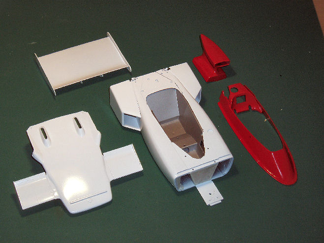

Well, now I know why the kit was only part started...
There are two sprues of parts missing and one of them contains lots of suspension bits as well as other assorted gubbins.
However, never one to give up, I'm going to try to scratch make the required bits, at least so as to be able to complete it somehow.

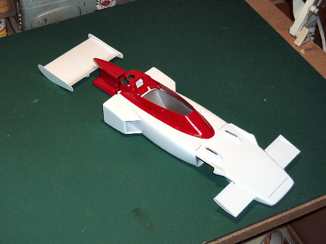

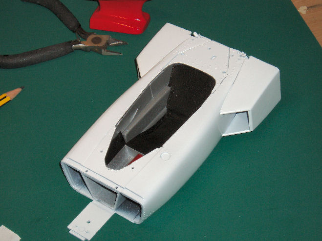

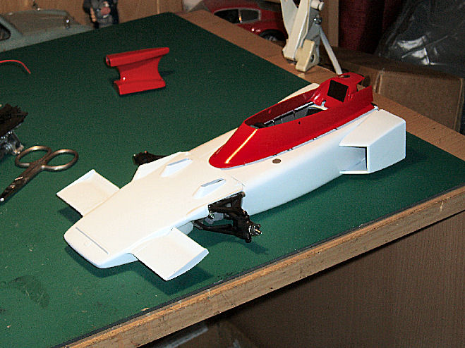

The body parts have been dismantled, cleaned up, reassembled and now painted.

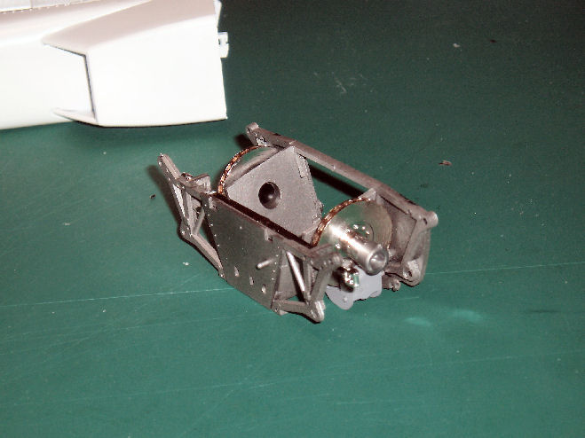

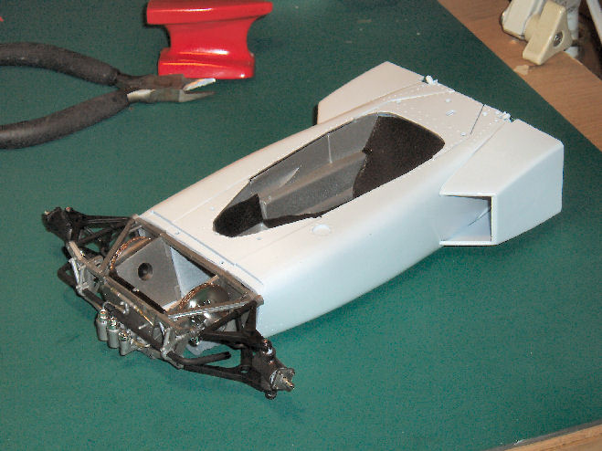

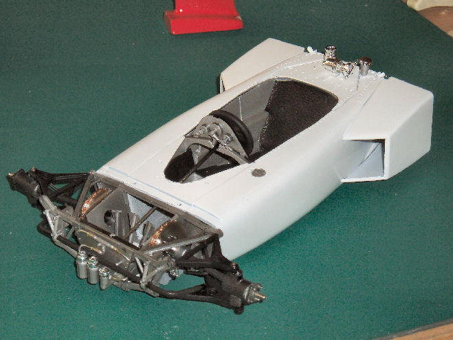

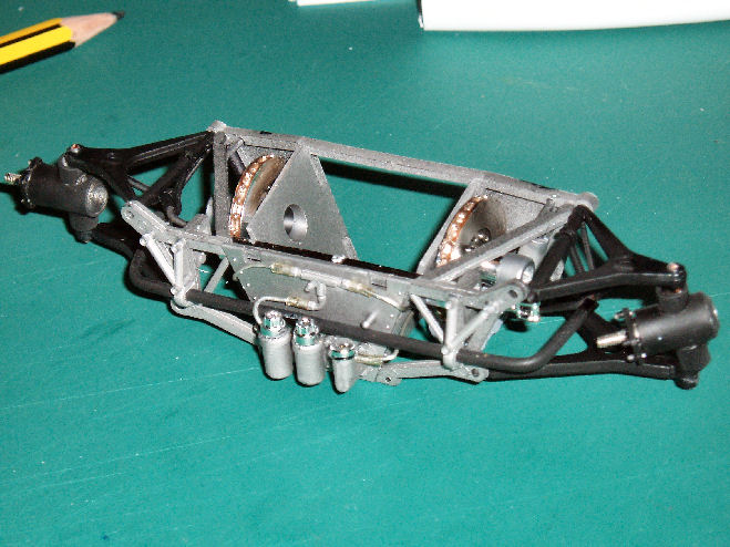

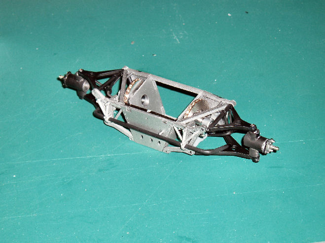

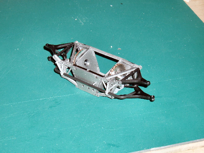

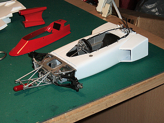

I've built up most of the front cage but there were a good few missing parts:
Suspension drop links for the the upper arms to torsion bars, anti-roll bar and worst of all, the front hub uprights.
The links and roll bar were made fairly easily from different thickness brass rod.
The uprights were cobbled together using bits of tube, and thick copper wire.
Not particularly accurate but they will be hidden inside the front wheels so can't really be seen.
Brake shafts are also missing but I'll make those from plastic rod or even sprue.

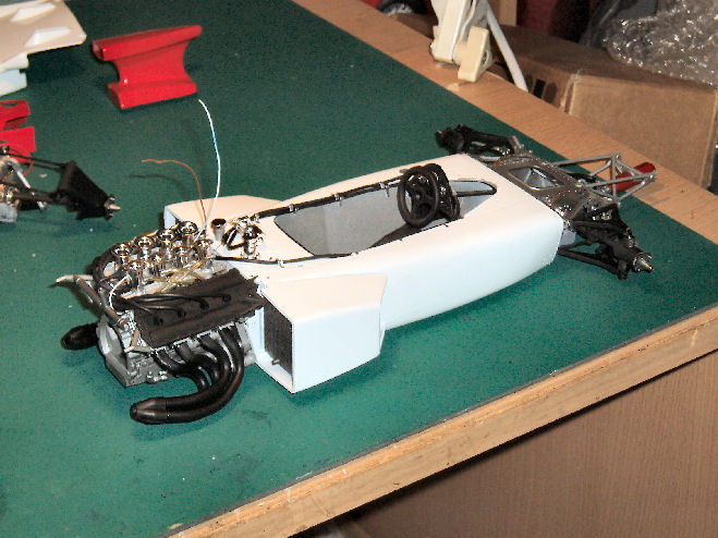

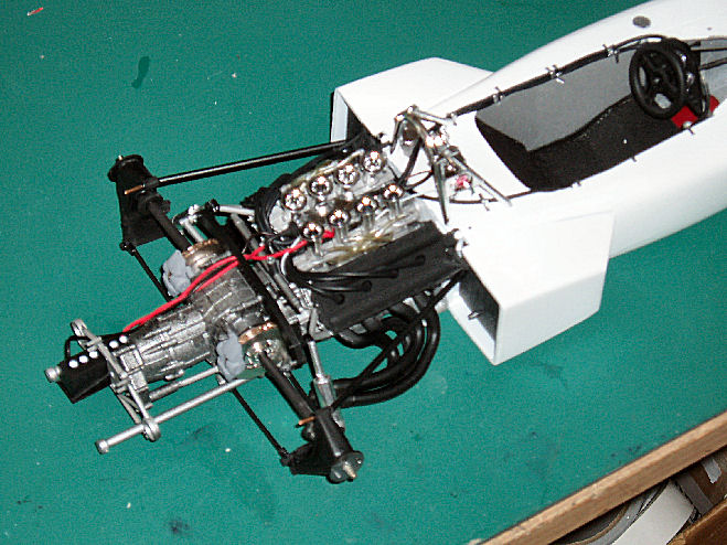

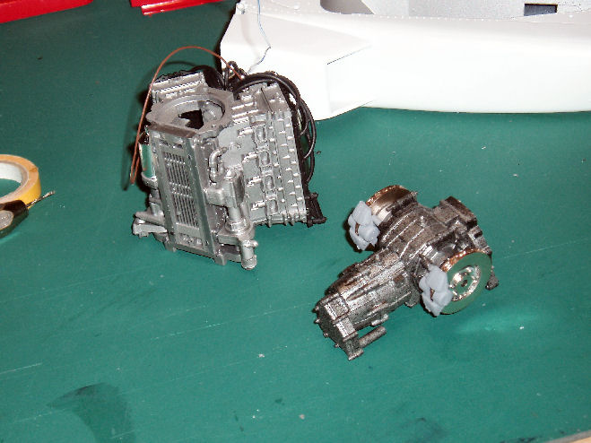

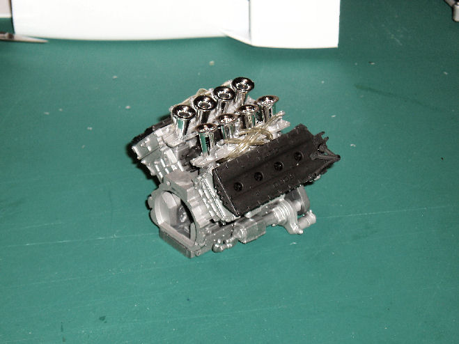

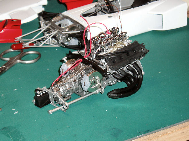

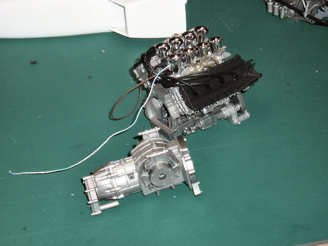

I've assembled the main engine parts and now the transmission.
I contemplated using thinner plug leads but TBH, this model is going to have so many scratch/bodge parts, I just went with the supplied kit tubing.

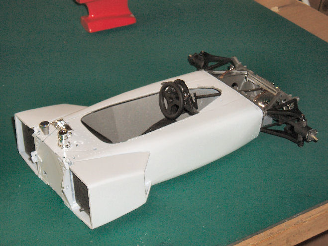

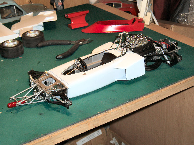

I've just about sorted the front end now. The steering is fixed out of neccessity due to the number of 'fake' parts I've had to cobble together.
Main engine and transmission assembled althought there will be more wiring and plumbing added later.

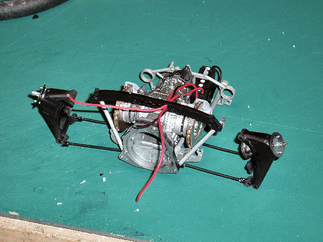

The next task is to invent the missing rear suspension rods, arms, supports etc etc.
To get the sizes (almost) correct I'm using one of my remaining 1/8 Entex kits for reference.
I'm measuring the bigger Entex parts and then re-scaling them to 1/12 so that when I make my own parts they shoud be the correct size.
Here's hoping...Laugh

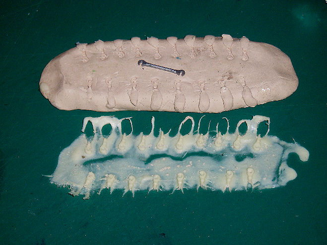

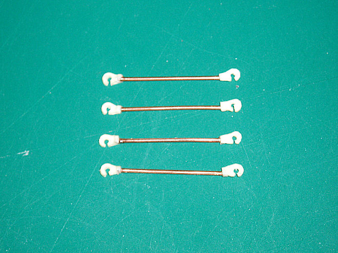

I measured the relevant suspension parts in the big 1/8 Entex kit, then calculated them in 1/12.
Using a steering arm from the 1/12 kit I made umpteed impressions in plasticine and cast a load of link ends in resin.
Once cleaned up and the ends drilled, I made the rod from thick copper wire.
Once glued together and painted, they don't look too shabby.
All the rear suspension will be rigid as the small resin pieces aren't strong enough to support working springs etc.
More to invent...

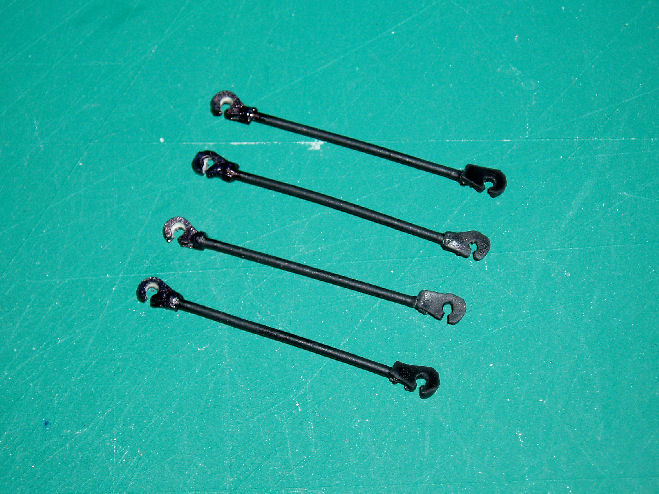

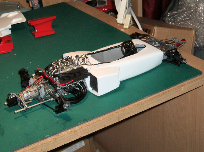

#14 Posted : 28 March 2023 09:18:41
Posts: 5,183
Points: 15,698
Many thanks for looking in and commenting chaps.

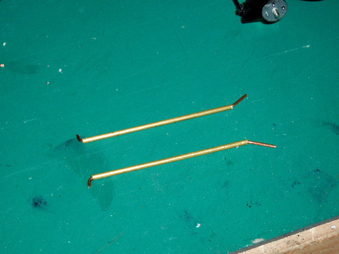

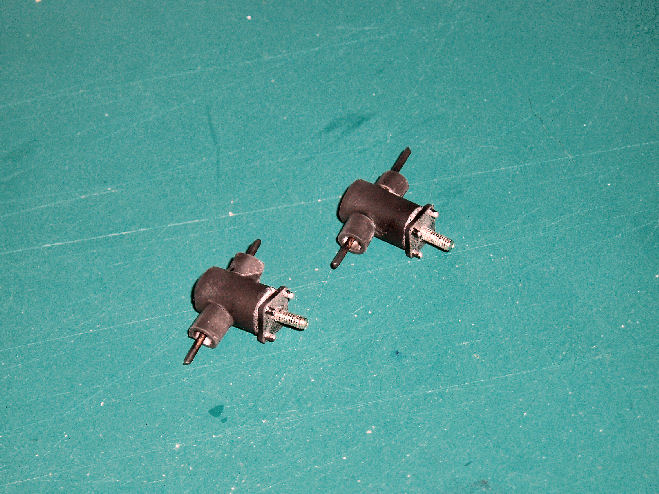

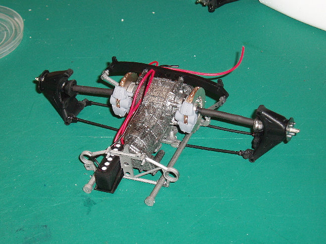

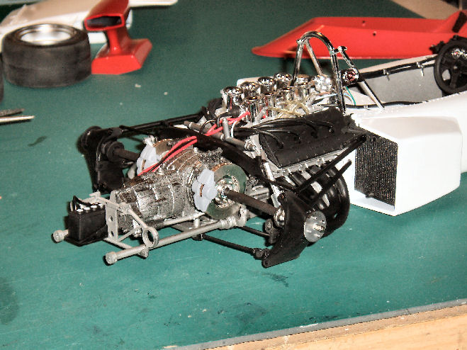

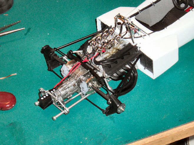

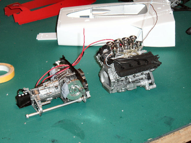

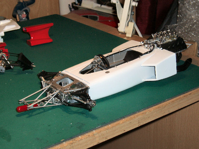

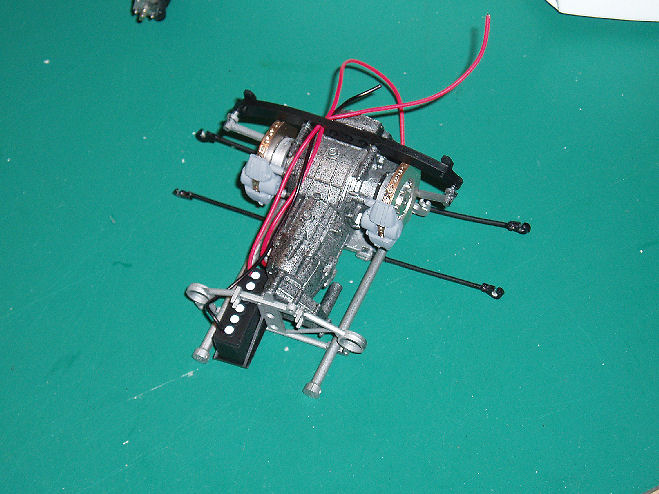

Ok - the engine and transmission are now attached so it was down to making all the missing bits that hold the rear wheels on - everything apart from the hub uprights.
I've used brass tube and copper wire to produce a set of parts that aren't totally accurate, but will serve to give the look of the '72 rear suspension.
Still a few parts to make and fit and then it will be the home straight to finish.
