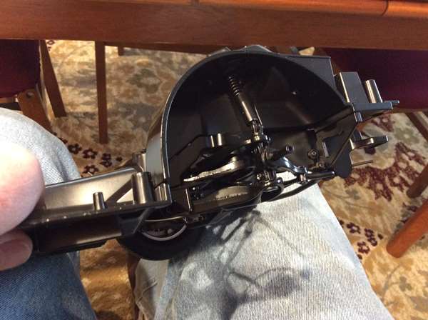

Stage 15 Assembling and mounting the right wheel well.
Step 1 Secure the top mount of the shock absorber to the wheel well with 3 GM screws.
Step 2 Mount the shock post to the wheel well using 1MM screw.
Step 3 Put the electronic control box together. Mount it on the post and secure with 1CP screw.

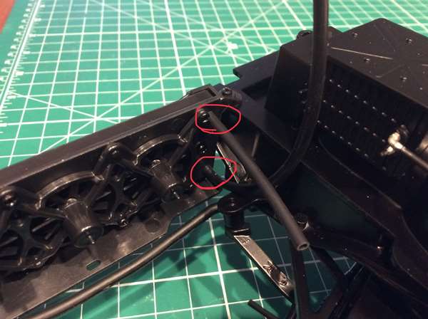

Step 4 Carefully insert the tube into the into the 90* wiring terminal. Put it into the top hole of the control box. The other terminal goes into the lower hole.

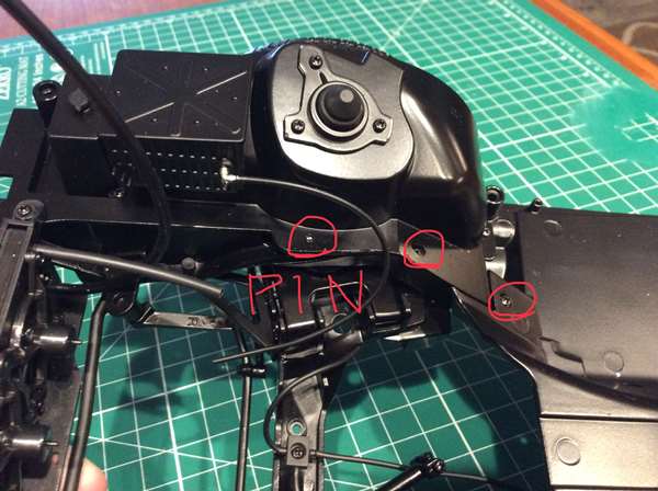

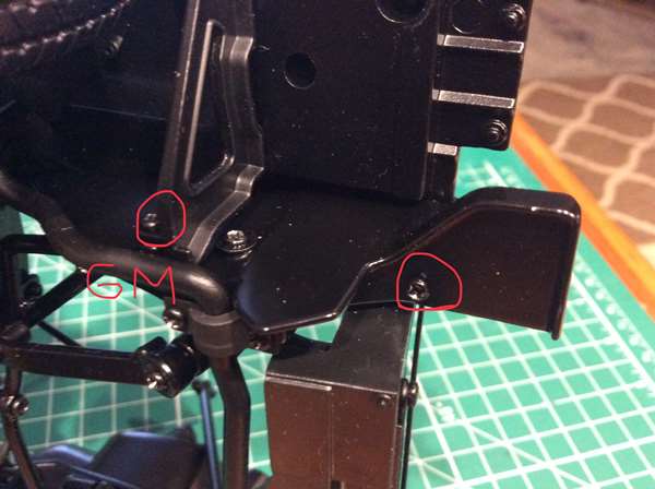

Step 5,6&7 Find the locating pin on the frame in line with the shock body and set the wheel well on to it Secure the wheel well to the frame with 3 EM screws and one GM screw.
Step 8 press the shock top cap into place.
Stage 15 is done.

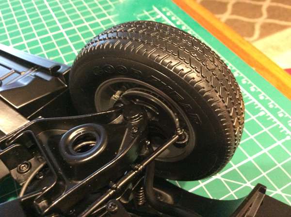

Stage 16 Brake and Wheel assembly
Step 1 Heat the tire as we did before, assemble the two halves of the wheel and secure with 3EM screws.
Step 2 Put the brake disc into the caliper dust shield assembly. Line up the notches on the disc and dust cover.
Step 3 Slide the parts onto the axle. Make sure the notches are both positioned correctly on the axle.
Step 4&5 Put the wheel assembly onto the axle and secure with a washer and 1 FM screw.
Step 6 Place the hub cap onto the wheel, line up the screw holes and secure with 5 AM screws.

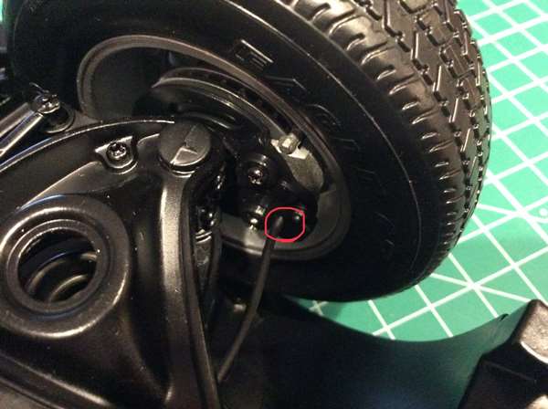

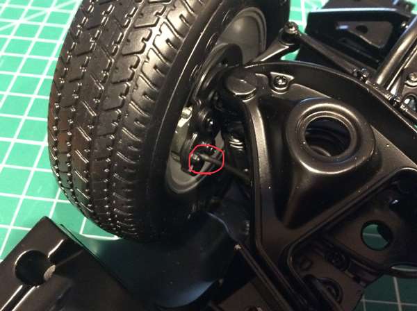

Step 7 Fix both brake lines to the brake calipers.
Stage 16 is complete.

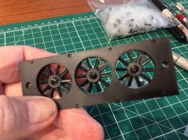

Steps 1,2&3 Attach the 3 fan blades to the fan frame with ! DP screw each.
Step 4&5 Secure the fan and motor frame to the fan assembly using 4 BP screws.
Stage 17 is complete.

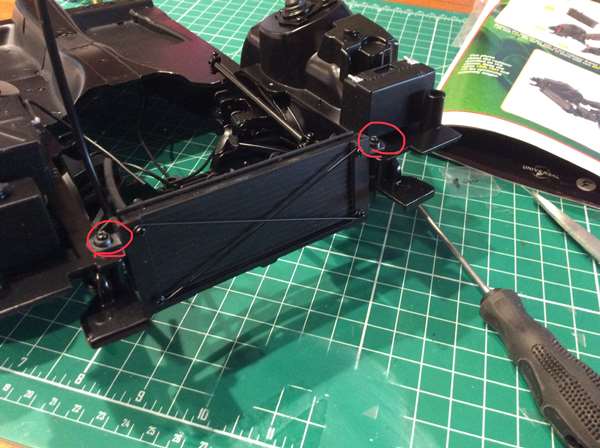

Stage 18 Mounting the fan assembly to the front clip.
Step 1 press the radiator halves together.
Step 2 Place the fan assembly onto the radiator and secure with two BP screws.
Step 3 Slide the radiator assembly onto the radiator frame.
Step 4 Using 4 BP screws, attach the radiator bars to the radiator assembly.
Step 5 Press the 2 large diameter hoses onto the pins on the radiator. Short hose goes on top.
Step 6 Put the radiator assembly onto the frame and connect with 2 EM screws.
Box 5 Stage 18 is complete. Safely stash all the parts and assemblies until the next box arrives.
