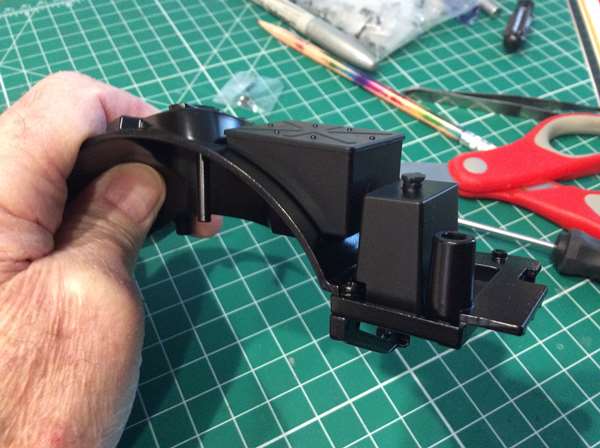

Stage 11 we’ll start building up the chassis and attaching it to the front clip.

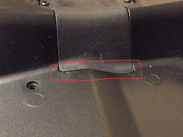

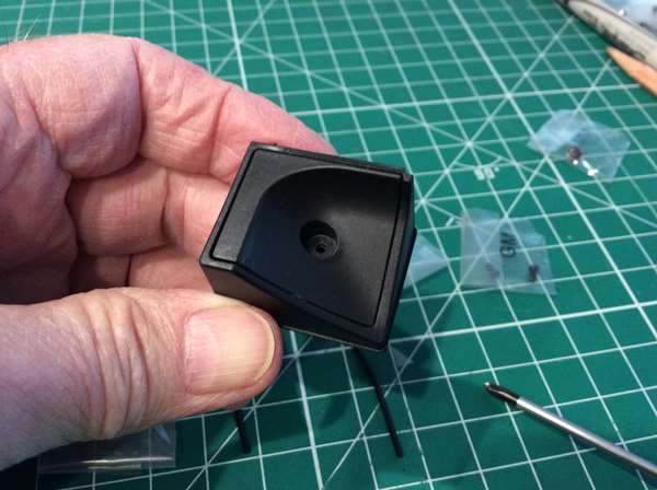

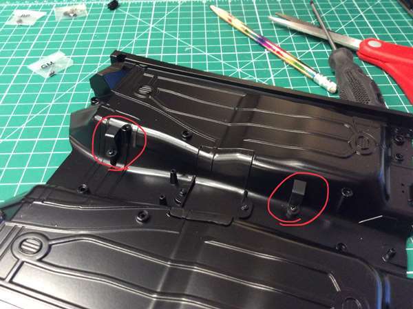

Step1 Attach the center cover to the center section. When oriented correctly, the transition on the part will feel smooth at the floor pan.

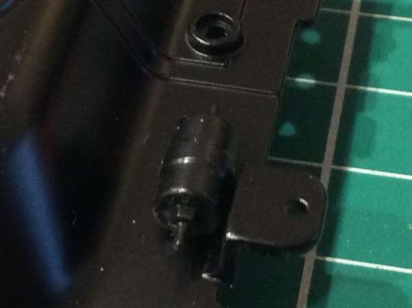

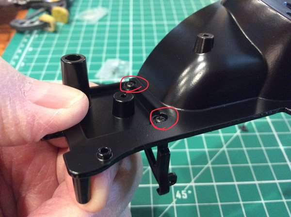

Steps 2&3 Attach the two brake line guides as shown with 1 GM screw each.

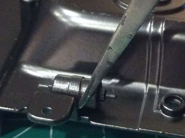

Step 4 Attach the fuel filter to the chassis. I had to hold the part with tweezers, my fat fingers wouldn’t fit in there to hold the part and push the pin in. Secure with a BP screw.

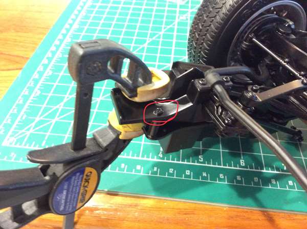

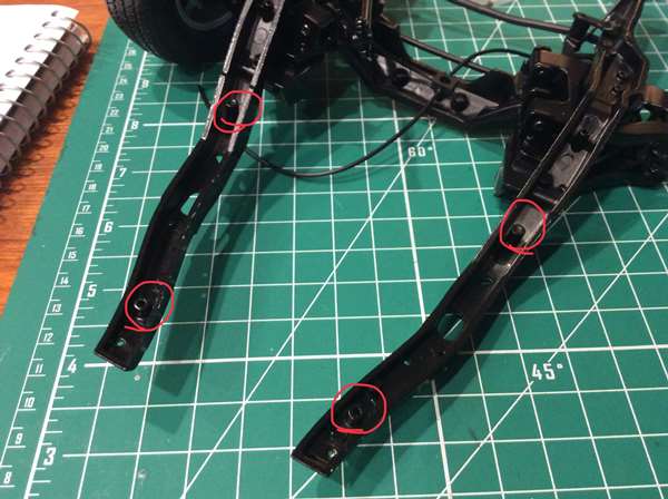

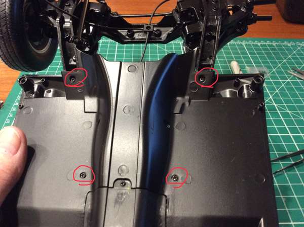

Steps 5&6 Retrieve the completed front clip. Attach the center section to the front clip
With 4 EM screws as shown.
Stage 11 is complete.

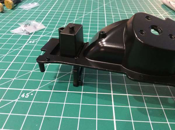

Stage 12 In this stage we will build the left front wheel well and attach the battery.

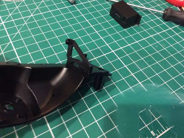

Step 1&2 Attach the left front wheel well support to the wheel well using 2 AM screws.

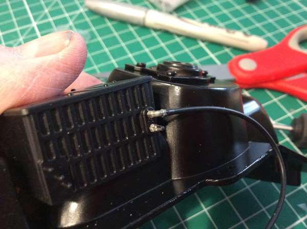

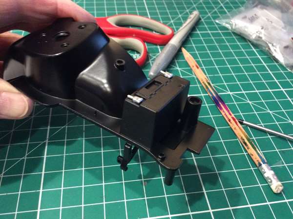

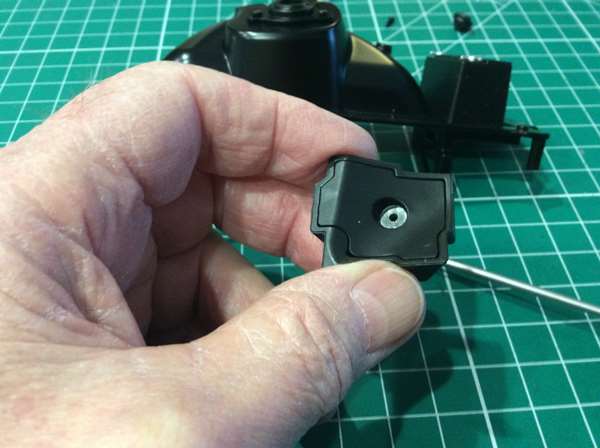

Step 3&4 The battery should be put together then placed over the mounting post and secured with a CP screw.
Step 5 Push the two battery terminals into the semi circular holes.
Stage 12 is complete.

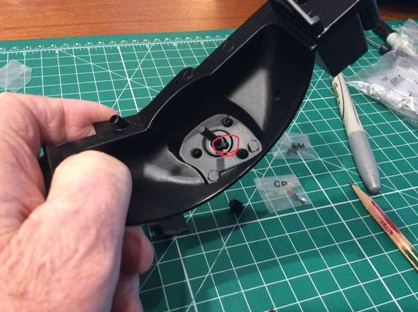

Step 1 Secure the upper shock mount with 3 GM screws.
Step 2 Mount the shock post into the wheel well, orient the post to the notch in the top mount. You may find it easier to pre-tap the post. Secure with one MM screw. The post should wiggle a little when finished. It will allow the post and shock body to work better.

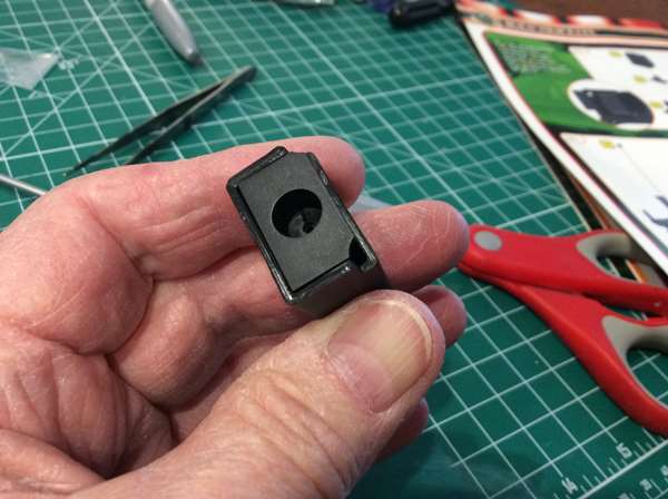

Step 3 Put the fluid tank together and mount with 1 CP screw.
Step 4 Push the shock cover into position. Push the fluid cap onto the tank. It is directional.
Step 5,6&7 Place the wheel well assembly onto the frame and check the location. There is a locating pin on the frame in line with the shock body. Make sure the locating pin is in the corresponding hole. Secure the wheel well with 3 EM screws and 1 GM screw.
Stage 13 is complete.
