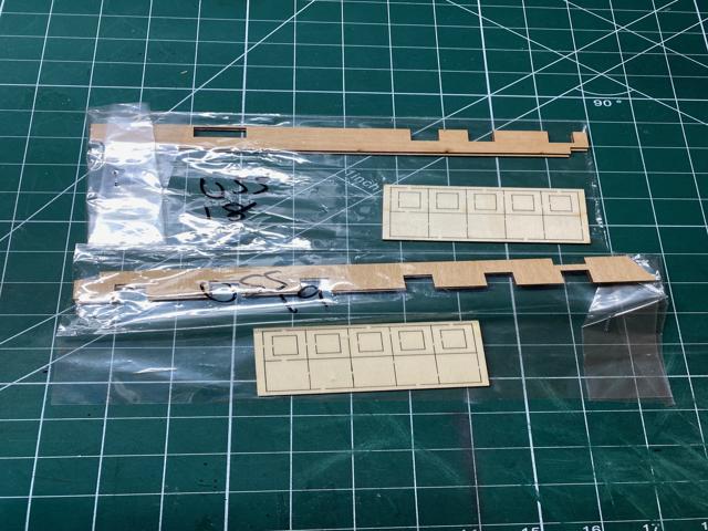

So, back in early August i posted about breaking the plywood deck beams and requesting replacements from Modelspace. I gave them the part number and issue number and was told they would be sent out from Italy. Well just look what finally arrived! Definitely NOT what i ordered, and probablt NOT even for the Victory. In the end, I got soooooo bored of waiting, i milled my own, which worked out much better that the originals anyway (didn't need scoring to bend). The thing is, IF i had been waiting for 3 months for specific parts and received these instead, i don't think i would have been so placid about it. Does anyone even recognise which kit they are from? USS 18 & USS19 are writen on the bags.
Honestly, you couldn't write it Confused RollEyes

Hi Gray!
When you said the bags were marked 'USS' I had a suspicion which turned out right! Have a look at stages 18 and 19 on the official USS Constitution build instructionsBigGrin
Robin.
#10 Posted : 31 October 2022 18:26:47
And there it is: Pack 3, walls and gun mounts for USS Constitution. RollEyes
