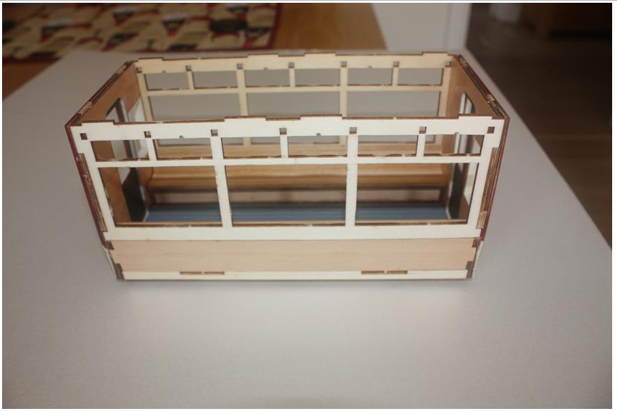

For my next Build I have returned to OcCre as I like their kits.
The London Trolley Bus looks an interesting build, plenty of instructions, lots of bits.
Have started, pictures attached more to follow as I proceed

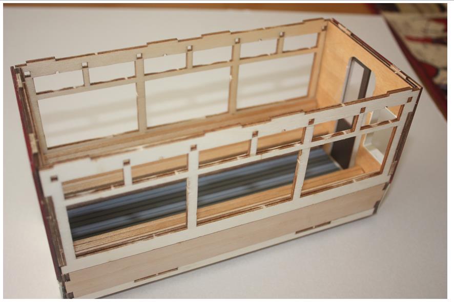

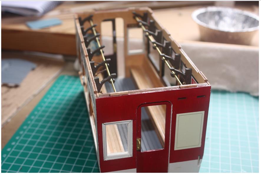

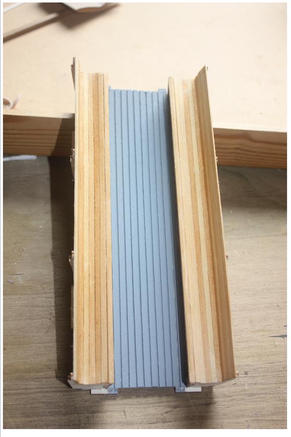

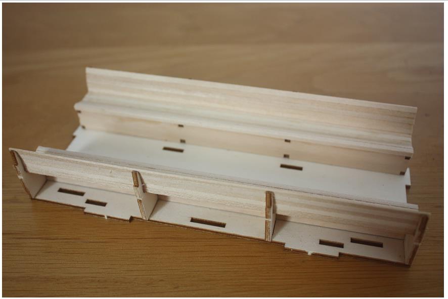

Progress so far, Lower deck benches installed and varnished, flooring laid and painted. When laying the flooring I laid the first strip down the center of the floor. Each additional strip was then added, with a 1mm gap between each strip until the bench was reached. Made a nice neat even look.
Picture attached

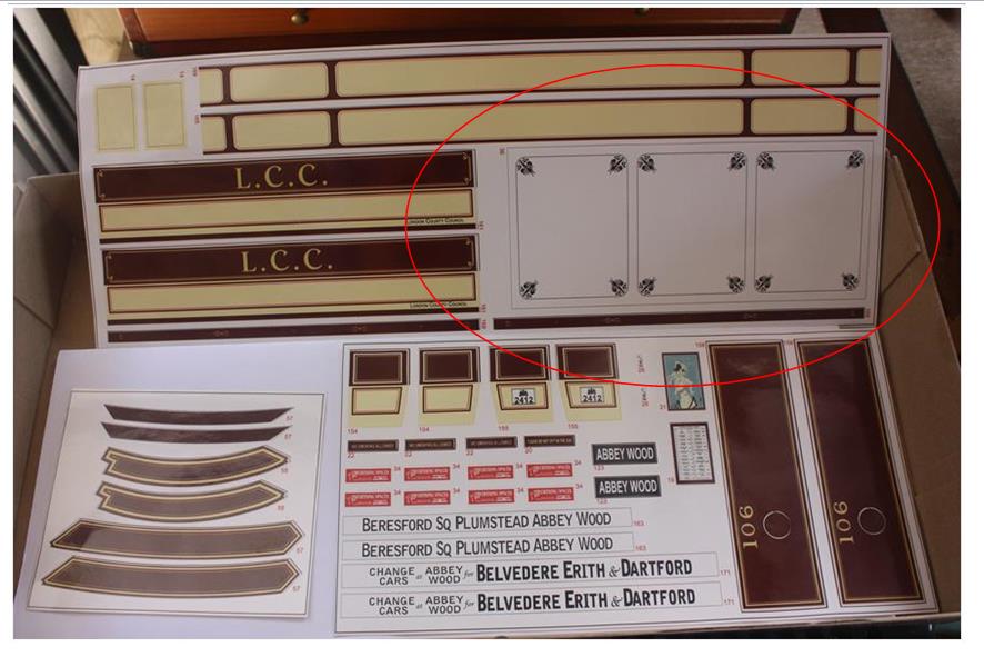

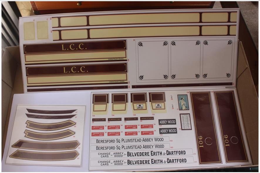

Could i please ask what sort of markings you have in this kit.
I purchased a number of occre kits a few years ago and at that time the markings were just laser printed onto plain paper. The idea being you cut them out and glue onto the kit.
I did read (i think) recently that the tram kits now come with self adhesive markings?
Thanks

just checked, the markings with this kit are the peel off and apply version. Not got that far yet so will post picture and let you know how good they are when I get there.

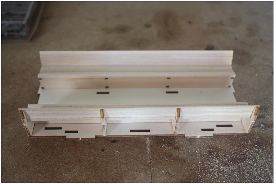

End panels and sides added to the floor, The inside is varnished. I find it easier to paint/varnish some parts before construction contrary to the build instructions. Each to his own.
Next is to add the supports for the cross beams, once again I have painted these prior to gluing in place.
Pictures attached

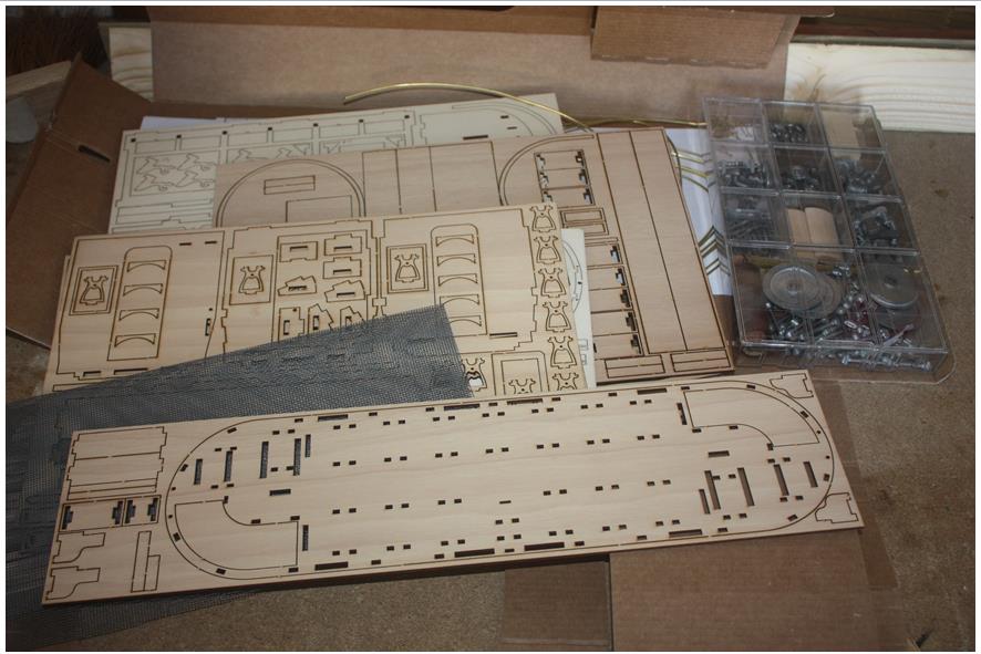

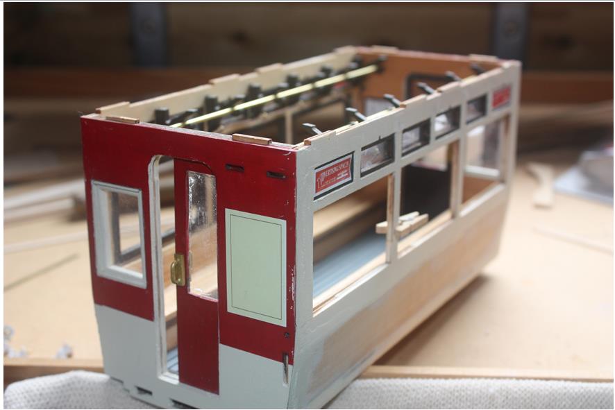

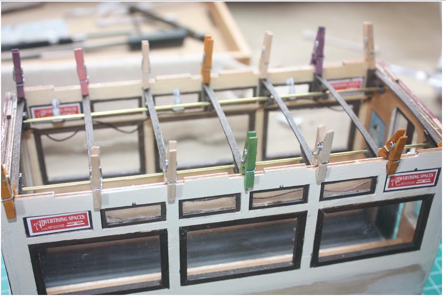

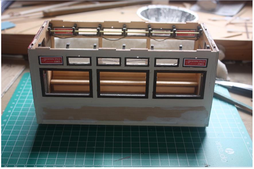

Slow progress on this build for the reasons already stated.

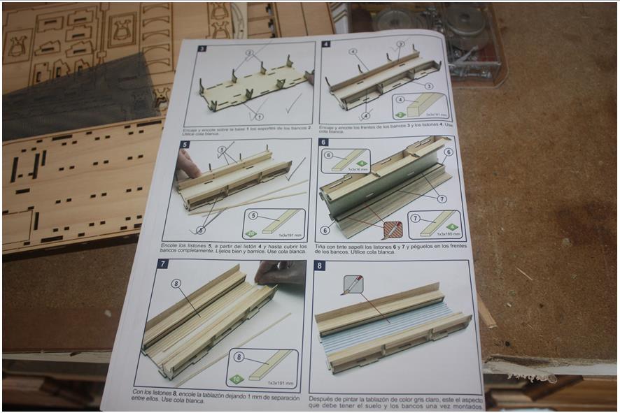

There are 6 frets full of parts, the numbers of which are shown on a plan in the build instructions. This elderly gentleman’s eyes are not what they used to be and in order for me to find the parts required I have scanned the plans, copied them into publisher, doubled the size and printed the result. Now I can see the part numbers

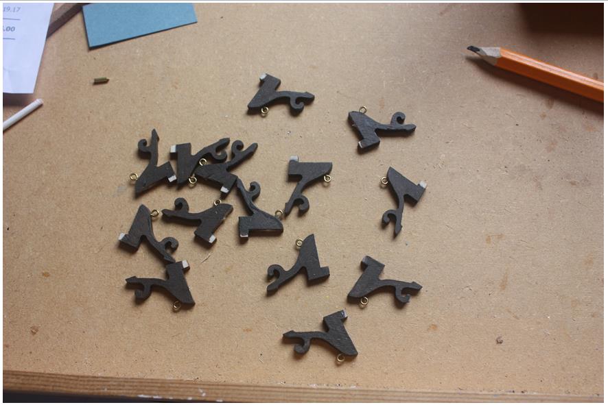

I use the instructions as a guide and do not follow them word for word. I find it easier to paint some of the smaller components prior to assembly. This avoids accidently applying paint where it is not required.
As we all do I have made some small mods as the build proceeds. The “glass” for the windows is a thin plastic. The windows are basically just a hole cut into the ply. In order to make is easier to install the windows I have added frames to the model
The roof supports have eye bolts which I added prior to installing the supports, less chance of any damage to the model if I was to install these after the supports had been fitted to the model as per the instructions
Have started the platforms for each end of the tram, gave me something to do whilst waiting for glue/paint to dry
The cabin roof will be next and here I have a problem. The patterned roof supplied with the kit consists of a printed sheet which is part of the sheet of stick-on labels. This seems rather thin for its purpose and also is sticky backed??. My solution is to stick this “transfer” onto a thin piece of card which will give it some support and allow me to glue it in place on the support beams
Pictures attached

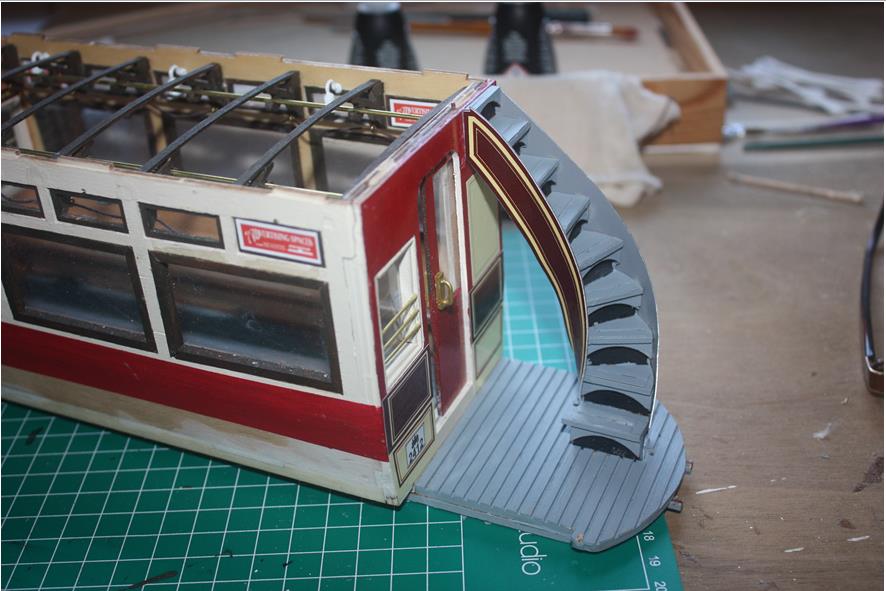

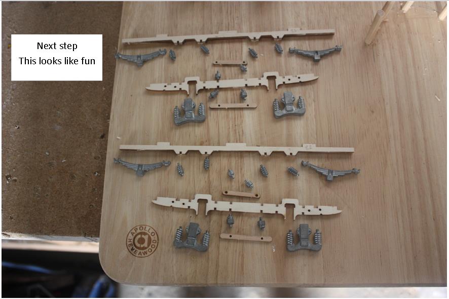

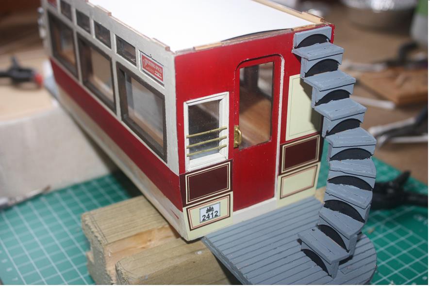

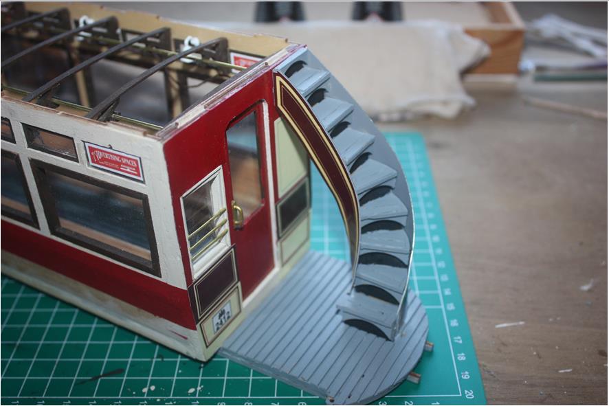

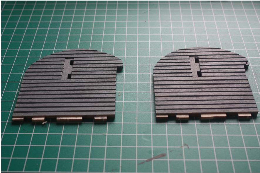

Construction has been held up by the grandchildren on school holidays, but now back on it.

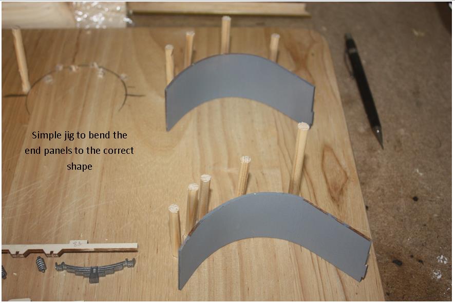

End platforms attached, the steps at both ends completed. It is essential to follow the correct order of assembly. This is a curved staircase and if you get the treads in the wrong order it won’t meet the top in the correct place. I assembled a few steps at a time and let the glue set to give a firm base for the next section.
Side covers for the staircases are supplied as pre-shaped metal components which need to be curved to fit the relevant side of the staircase. Transfers are added to the external sides.
The end panels are ply which needs to be soaked and then bent to fit the end platforms. I constructed a simple jig to do this. Worked well. These have yet to be attached.
I have started on the upper deck (filling in time whilst waiting for glue/paint to dry.) Looking forward to the assembly of the 18 chairs !!!!!!
Have also extracted to components to construct the carriage wheels and springs
One thing to note. The kit comes with numbered instructions which are linked to the relevant pictures. I have noticed that it is important to view the pictures carefully and there are occasions when instructions are shown on the picture, but not mentioned in the instructions.
The picture of the upper deck in picture 51 differs from that supplied with the kit. I think the kit must have been updated. Its only minor but threw me for a while. The difference is the small holes around the edge of the deck, these I presume where for the top deck rails. These have been replaced by slots which can be seen in other pictures of the top deck
Pictures attached
