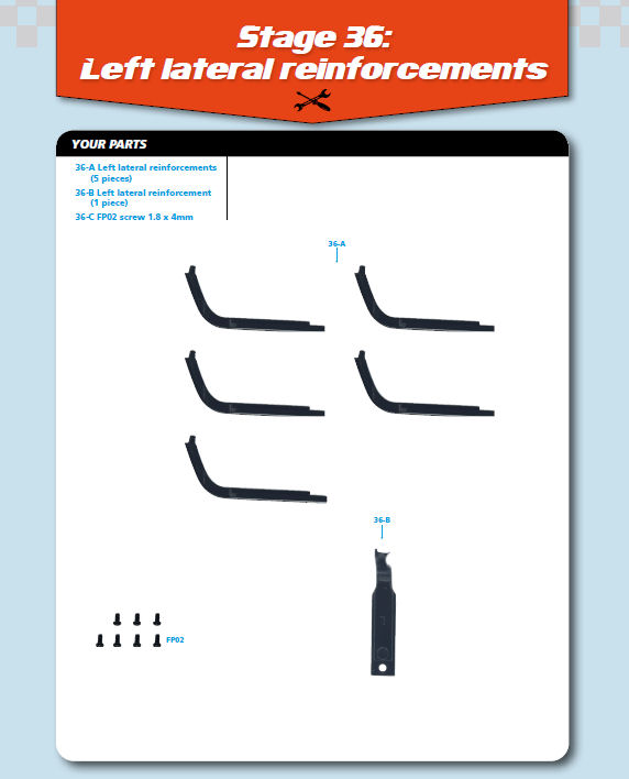

PACK 36:

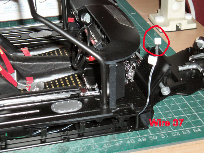

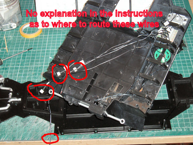

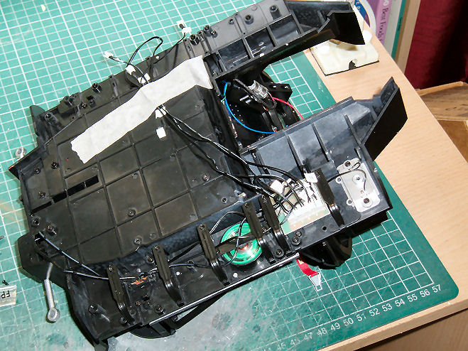

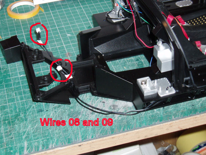

These parts comprise the lateral supports for the left side of the car.
As before, they serve no rel purpose being totally hidden when the model is complete. They are helpful however in holding the wiring in place.

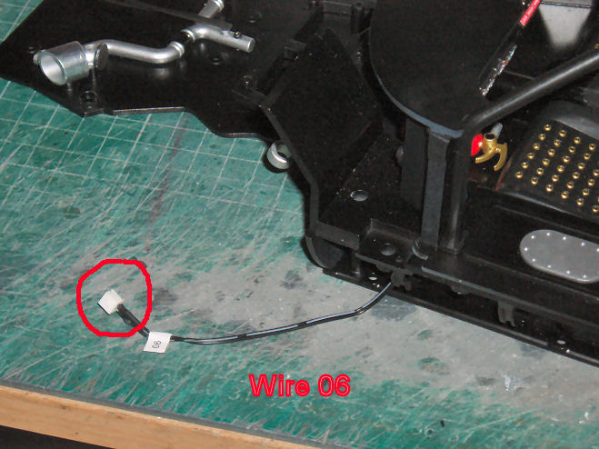

NOTE: The instructions give no clear guide as to where some of the wires need to be routed.
Attached pictures explain the required positions of the wires.

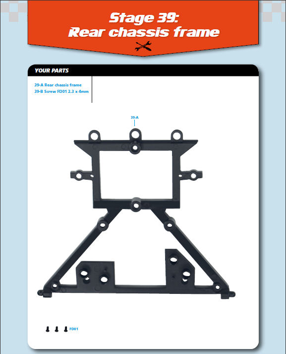

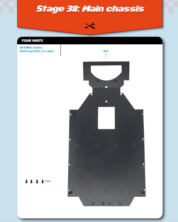

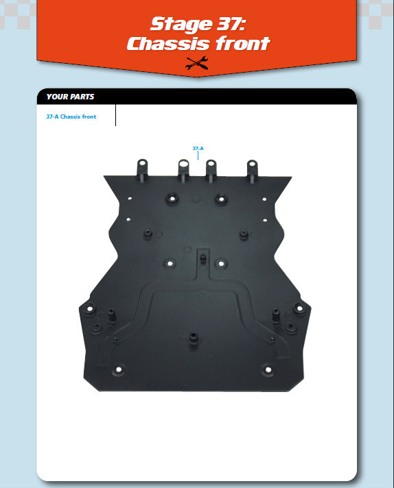

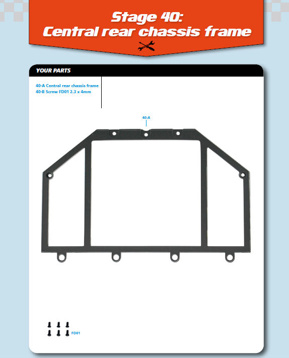

PACKS 37, 38, 39 & 40:
These packs make up the main metal chassis assembly.
Construction of all these parts is very straightforward.
