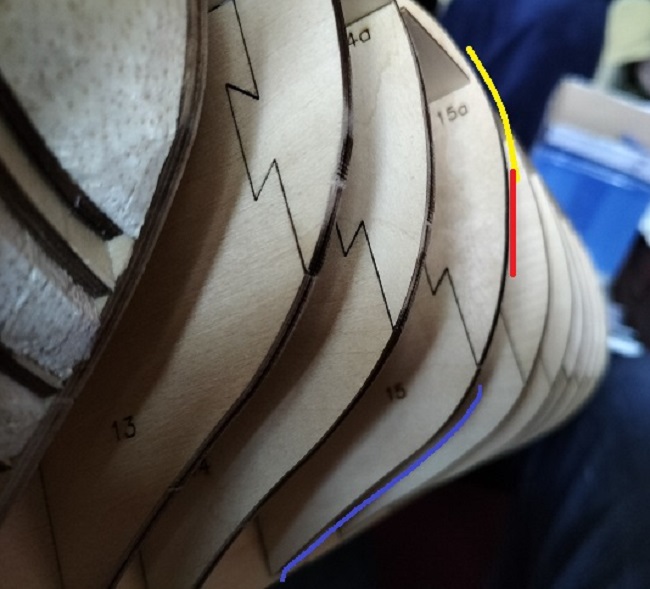

Hi Guys, BigGrin
Now I`m no master ship builder but don`t do to bad with my efforts and understand how these things fit together.
So here`s my thoughts on the grounds that my Vic is in exactly the same stage as Captns.
I have looked at rib 15 in my construction and "YES" I have the same issue.
To that end I have checked out the deck levels above the first false deck (Only pinned in place) and they appear to be fine. So I would be inclined "NOT" to extend the slot and lower the rib. I also have other reasons for that decision as I`ll explain now, with reference to the picture attached.
These observations are the same on the port and starboard side.
If you look at the attached pic you will see that there are three coloured marks around the rib shape as follows: (Top to Bottom)
Yellow: Rib is a lot wider than the deck and the ribs either side of 15.
Red: The rib flattens along this section and should be slightly wider making it more rounded.
Blue: This area is lacking some shape to fair smoothly with ribs either side.
So, the gritty bit.Blink Blink
As previously stated I would not lower the rib.
I can see two possible solutions in my mind and give no sure fire answers that these will work. That`s your choice, but for what its worth:
Solution 1: Balsa fill the hull between ribs 14 - 16. Shape to where you are happy and the file away proud areas / fill with strip wood on low areas, then fair to the final shape.
Solution 2: A bit more intensive. Remove the deck, remove rib 15 and trace it onto a piece of paper. Using the attached pic with the colour references make a new rib with 4mm ply (Make sure you change both sides of the rib the same). Leave the proud bit (Yellow) as it is. Add a bit more meat on the straight (Red) bit and add to the low area (Blue) bit to bring the bottom point down to the keel line.
Refit and fair as you would normally. A lot more intensive, but if you're up for it, the choice is yours.
So there you go, my thoughts for what they may be worth.LOL Flapper LOL

Funnily enough Chris, i have just done what you mention above (how spooky is that!). You are 100% correct, the deck supports all line up when the rib is short. If i lengthen the slot i too think it will throw the line of the deck out.
Del, i'm definitely NOT brave enough for Option 2 of what you suggest, so have plumped for Option 1 and ordered some filler (basswood though instead of balsa).
I want to thank all who have contibuted and looked in ThumpUp
