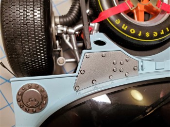

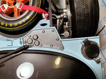

I began to install the parts from Stage 97. On parts 97 D,E,F,H - I added my typical black panel liner on the bolt patterns to give them definition (see picture below).

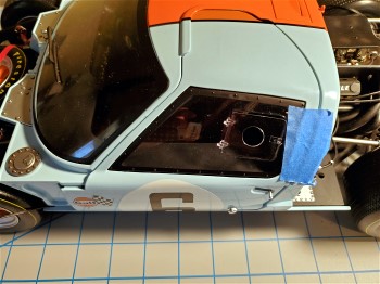

Added note: Use a painters tape to hold the doors in place while you do the next steps.

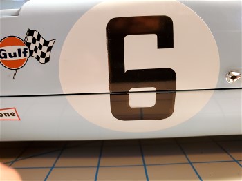

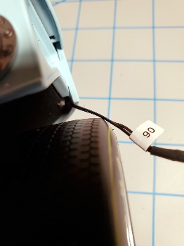

In Stage 100 we are going to add the left platform to the frame. Remember you will need to make sure the headlight wire is on the outside after you mount this panel. Personal note: I took a small hobby file (or an X-Acto knife can be used), and created a little dimple in the plastic well so the wire will not pinch when the panel is mounted. Now you will see the font of the number 6 will not line up properly. This can be corrected with a decal (Please contact roymattblack through the forum).
or
If you have patience, tape and an artist marker (Faber-Castell Pitt artist pen in black "S" point) You could widen the offset. The pen is an indian ink so you will have to let it dry (see pictures).
