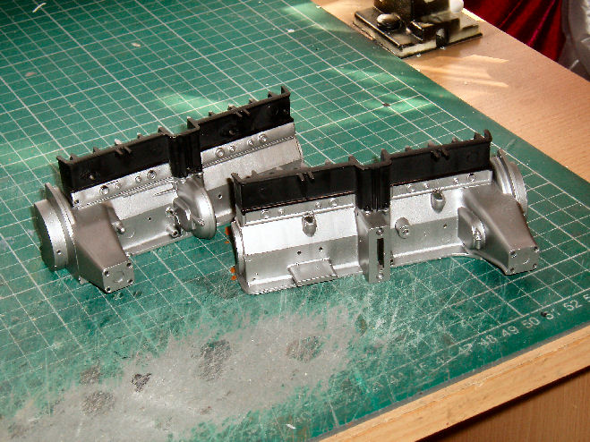

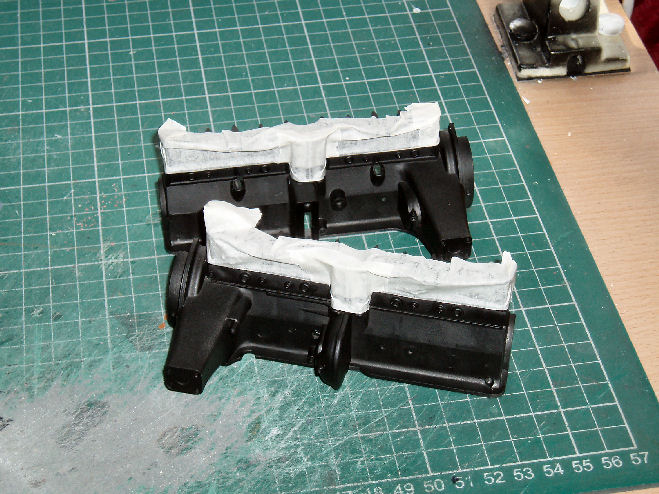

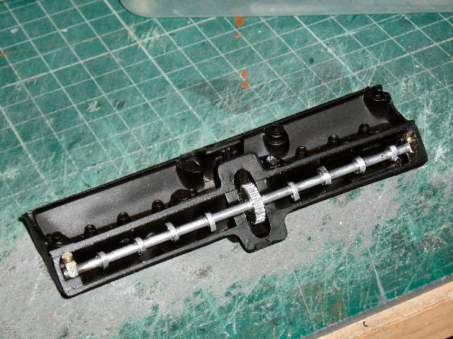

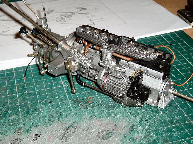

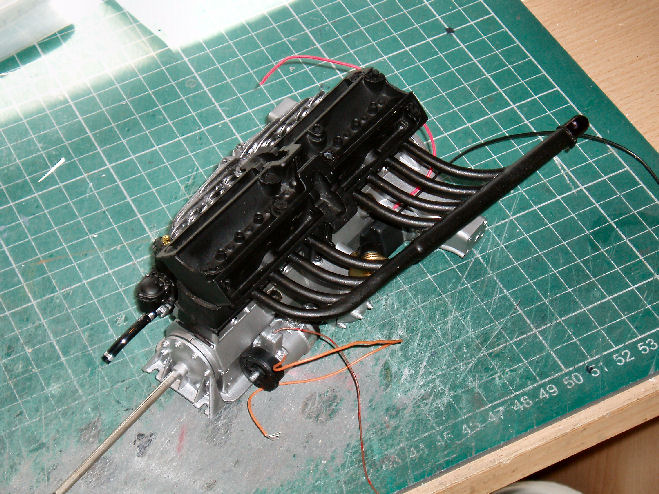

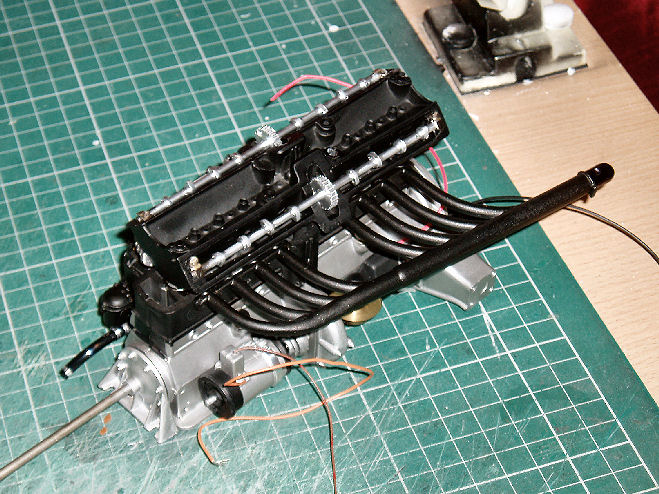

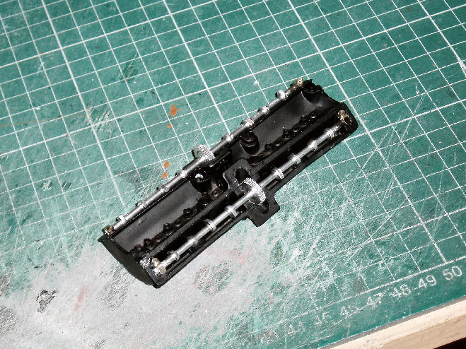

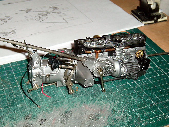

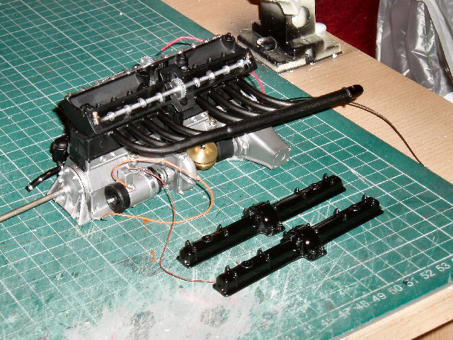

Well, I've made a bit of a start on the engine.
Loads of flash and sink marks to sort out as well as huge seam lines on everything. All part of the fun though.
All the parts were painted before assembly began.
There will be lots of linkages, wiring and pipework to add before much longer.

Great start on the engine roy
#9 Posted : 28 March 2022 17:37:07
Posts: 5,058
Points: 15,320
Thanks for looking in Ken.

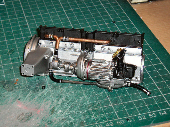

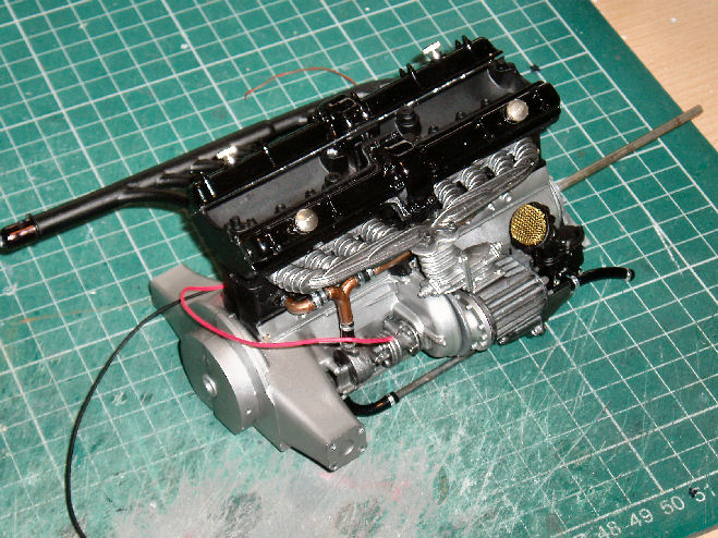

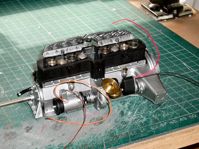

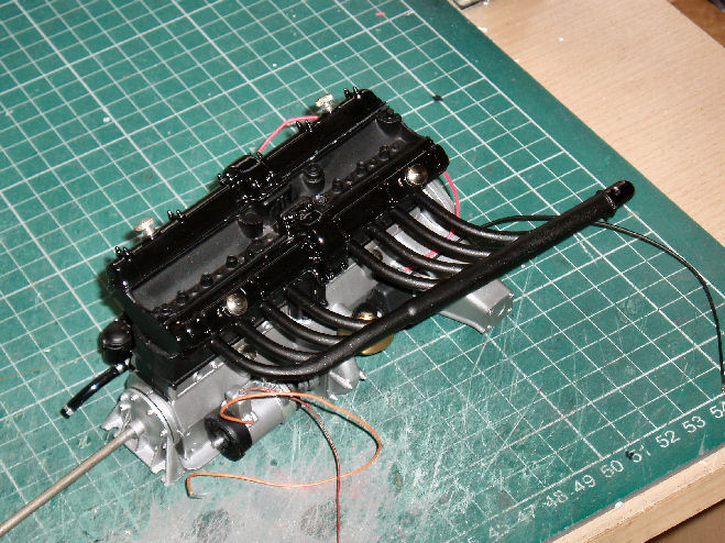

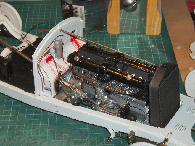

I've spent a chunk of time on this one over the past few days so here's where it's at, at the moment.
I've started to add wiring but there is a lot more detail stuff yet to add.
Cam covers black, as the Muletto wasn't always polished alloy...

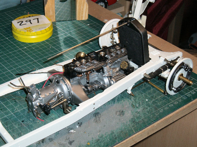

#11 Posted : 07 May 2022 13:21:57
Posts: 5,058
Points: 15,320
Righty-ho chaps.
Time to get back on this one.

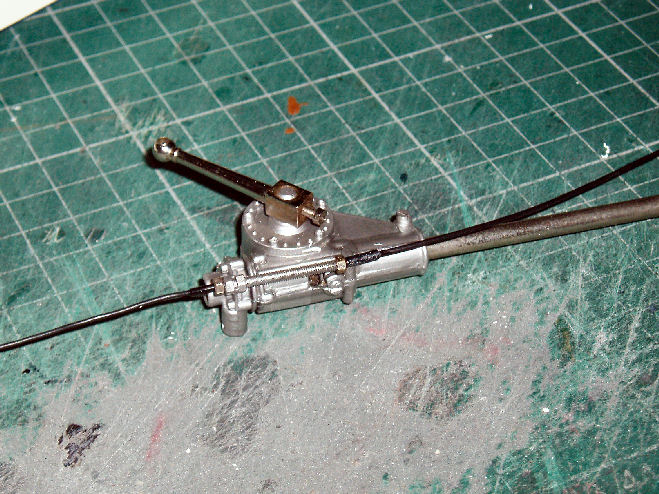

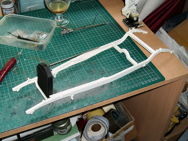

I've assembled the steering box and modified it to fit better on the engine which will also solve the known issue of the metal steering arm fouling the frame later on.

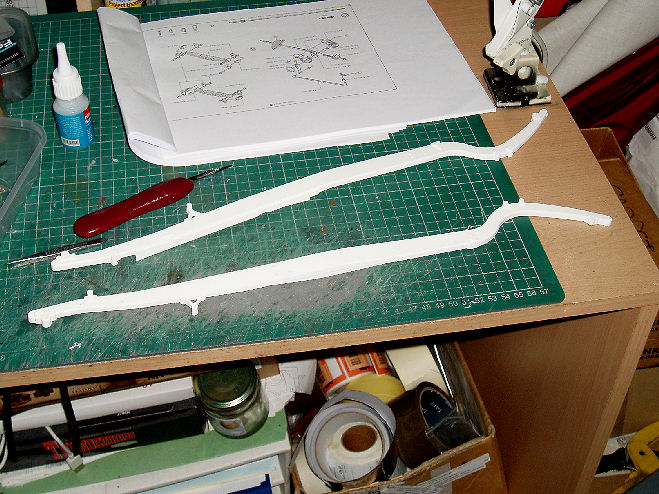

Side frames now cleaned up, flash and seams removed, primed and painted off-white.
On we go...

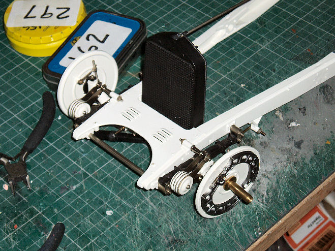

#12 Posted : 14 September 2022 13:14:27
Posts: 5,058
Points: 15,320

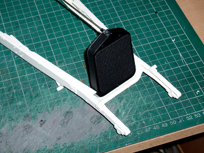

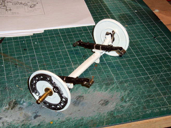

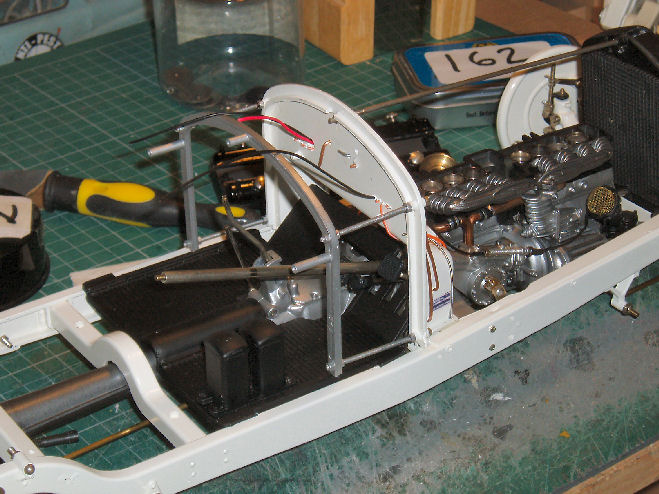

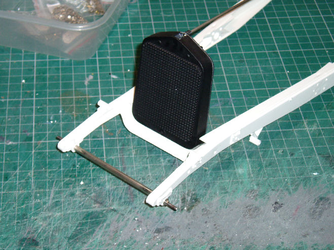

Ok - back on this one again for a while.

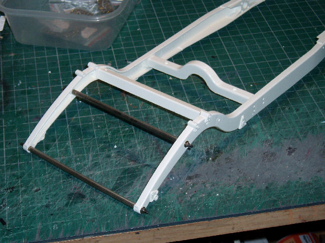

The frames have been assembled and the radiator is in place.
Next up was to build the front axle and fit it.
All the parts were painted first.
Next job is the rear axle and suspension...

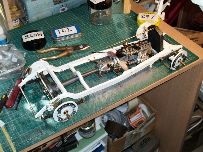

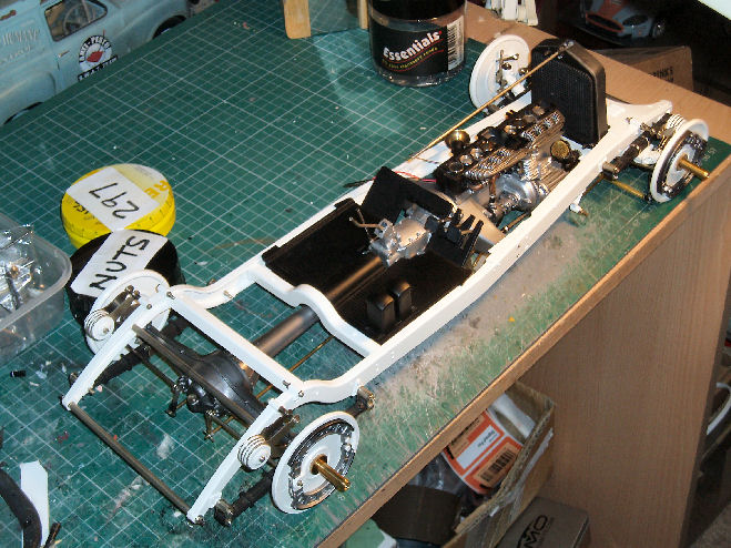

#13 Posted : 16 September 2022 14:20:36
Posts: 5,058
Points: 15,320

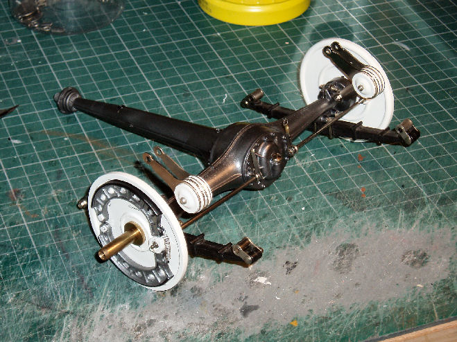

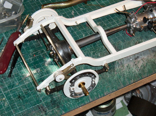

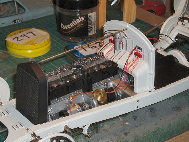

It's now starting to look like the basis of a car!
Rear axle etc all painted and assembled and the engine is in place after modifying the location and moving it back by 10mm.
If you build the kit as per the instructions, the engine is too far forward causing it to foul the radiator so that it affects the bonnet fitting later on.
Such is the fun of these old Pocher kits.LOL LOL LOL

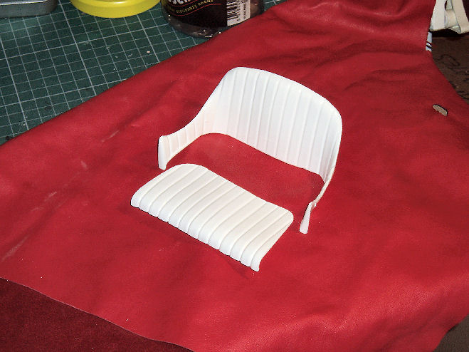

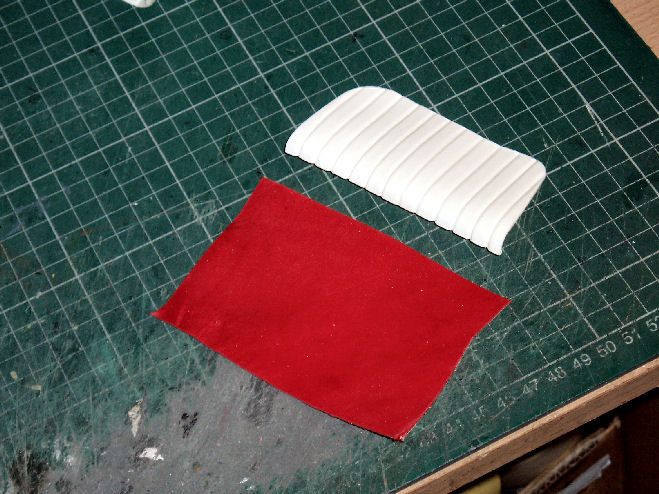

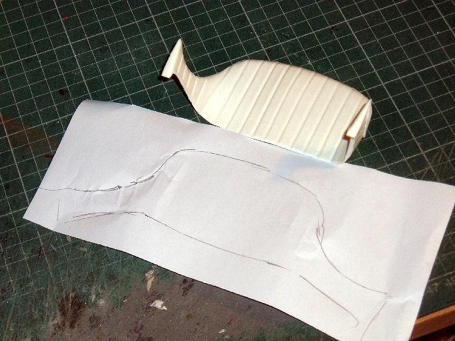

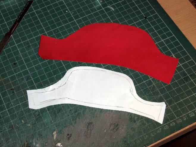

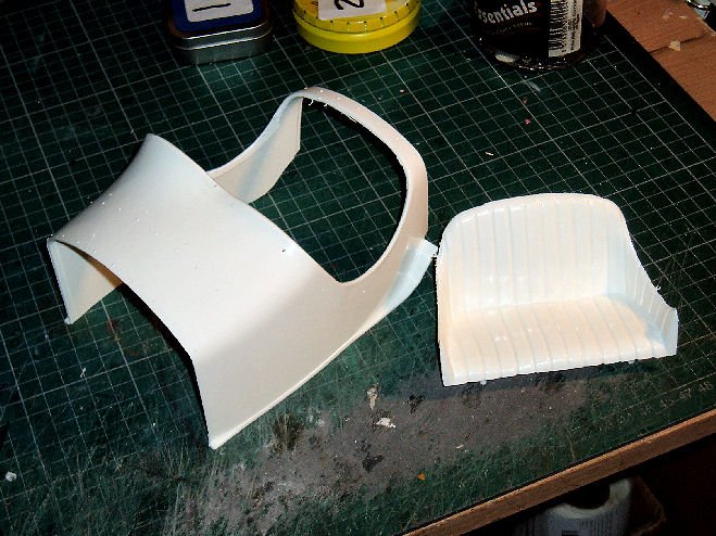

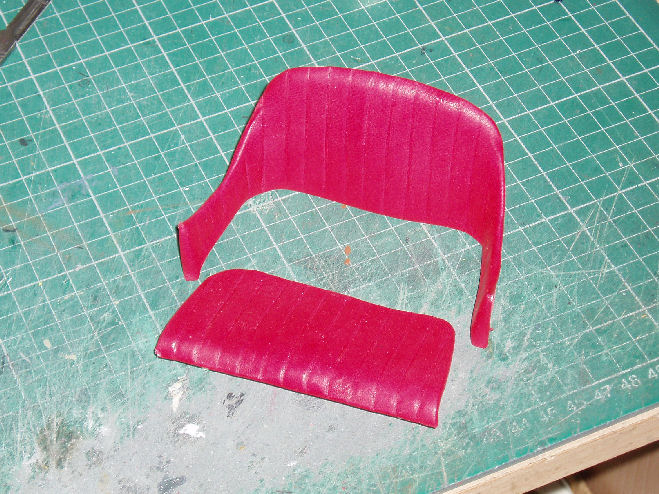

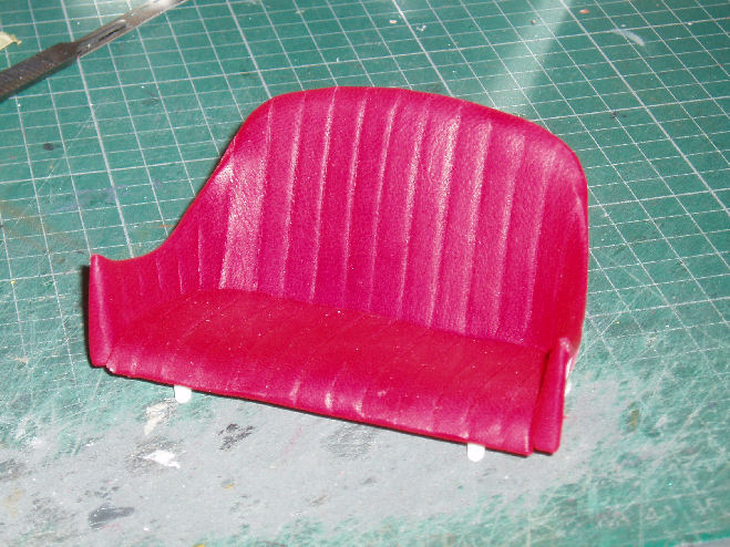

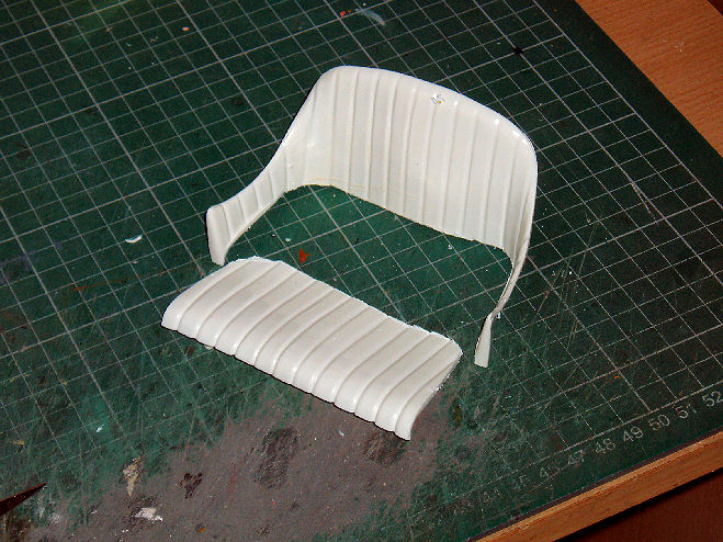

I decided it was time to have a go at the central body part as I wanted the seat trimmed in leather. (as usual)
This entailed cutting the seat section out as it was moulded into the body.
After a lot of scribing and cutting with a mini razor saw, the seat came out. It was then promptly cut into two parts. The back and the base.

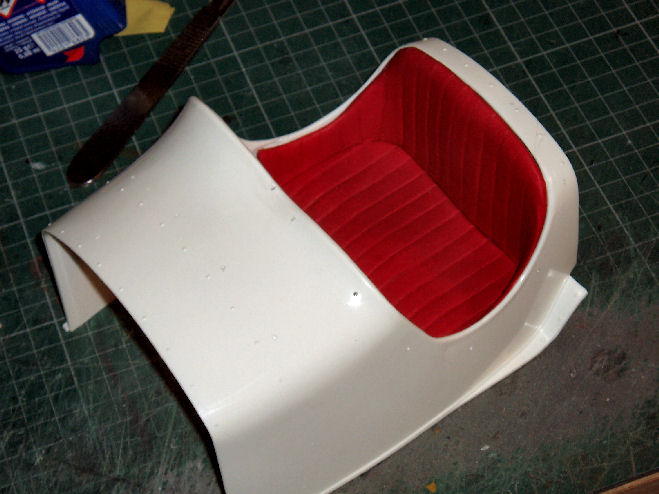

The parts were cleaned up and then covered in red leather. Ok, not prototypical but I thought the colour contrast would look good.
I made a paper termplate for the seat back and then cut out the leather which was attached using powerful D/S tape.

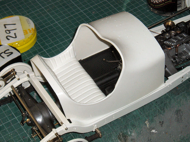

The parts were loosely reassembled and put into the body to check the fit.
All ok there.
The seat will be permanently fixed in place after the body has been properly sorted and painted.

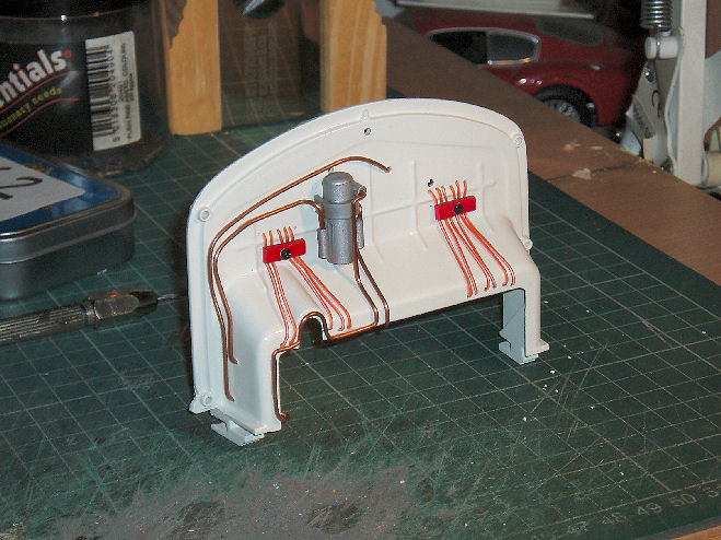

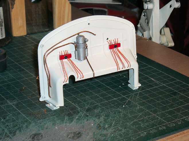

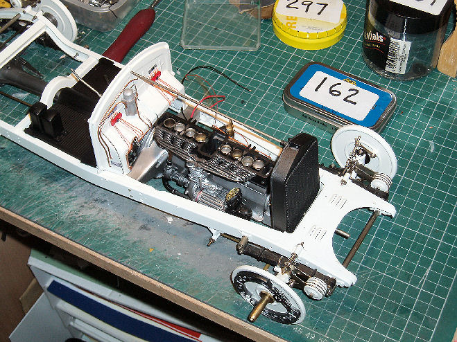

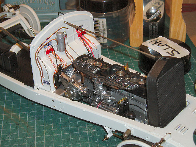

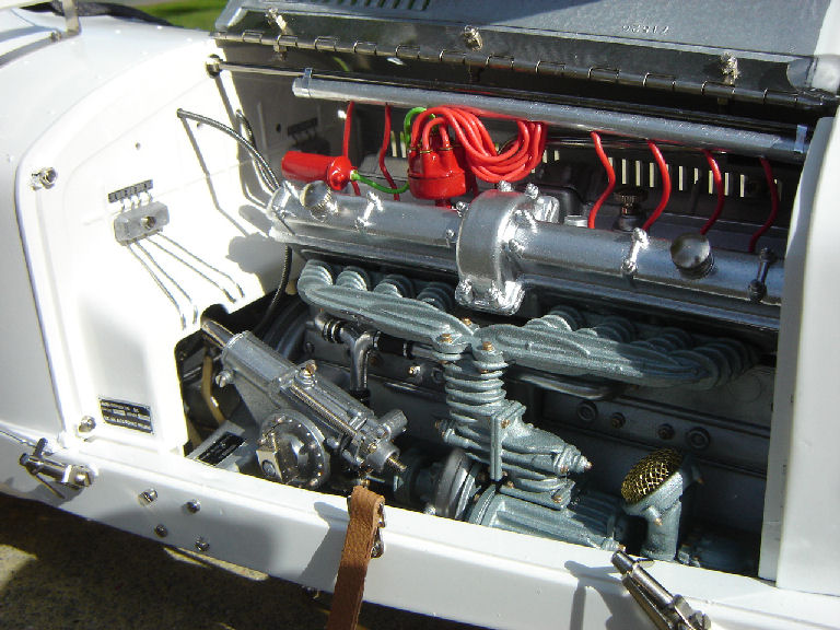

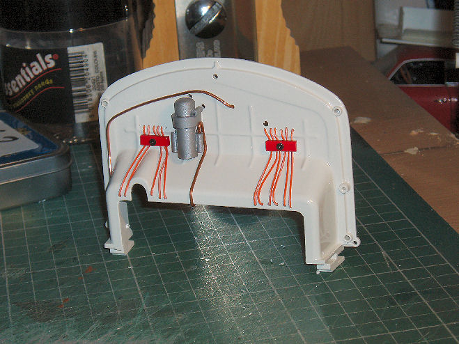

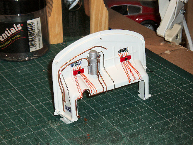

I've been working on the firewall using pictures of a genuine car as reference.
Let's just say the Pocher kit is a bit, errr, basic...
No fuel pump, no pipework, no cables, no 'plumbing', not enough wiring for the fuse boxes, wrong decals...
The first picture shows a Pocher kit very nicely built, but box-stock.
After that, it's mine in stages. BTW - the wiring on the real car was actually all the same colour orangey/brown.

#18 Posted : 22 September 2022 15:08:41
Posts: 2,081
Points: 6,238
That is some beautiful work Roy and that cutting out of the seat from the body was a work of art in itself! I certainly wouldn't fancy that job!BigGrin
I sometimes wonder if the missing out of such important parts like the ones you've added to the firewall was a deliberate cost cutting exercise (but why with the price of the kits) or a simple mistake in forgetting to include them in during the design of the kit!Blink
Either way, well done for a brilliant upgrade which makes all the difference.

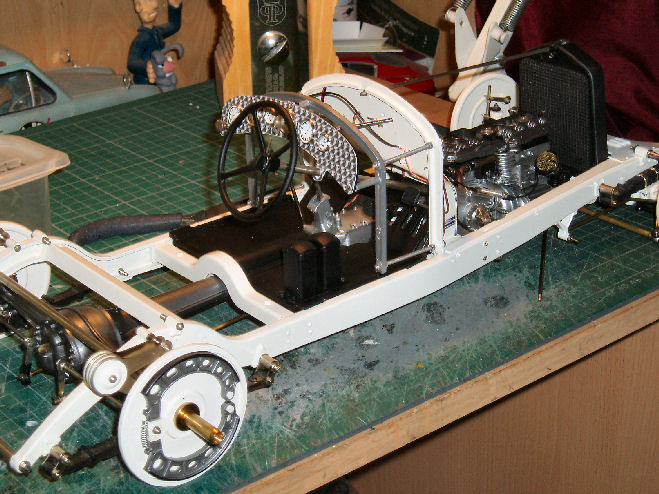

#19 Posted : 23 September 2022 11:06:10
Posts: 5,058
Points: 15,320
Many thanks Robin.
It's surprising how many simple bits are missing from these big old Pocher classics considering how other details such as engine internals are there.

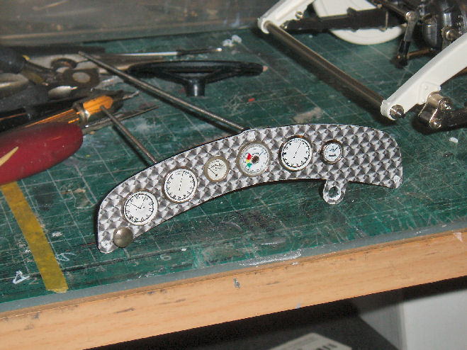

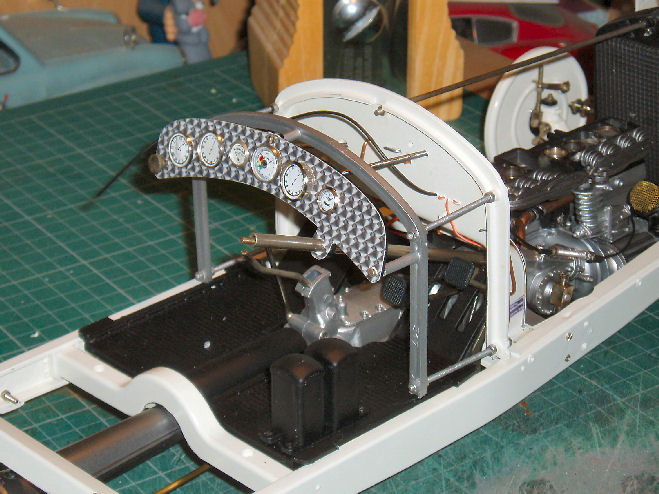

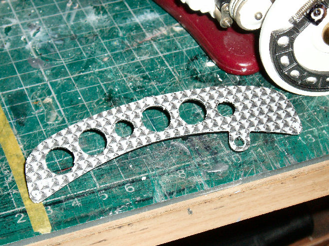

Anyway, dashboard now sorted.
Again, using referece of a real car, I've copied the engine turned metal effect for the dash.
Simple really - a googled image of engine turn pattern, resized for scale and then printed on photo paper.
Double sided tape, applied to the plastic dash part and then trimmed with a craft knife.
Moving ahead with the body and seat etc next...
