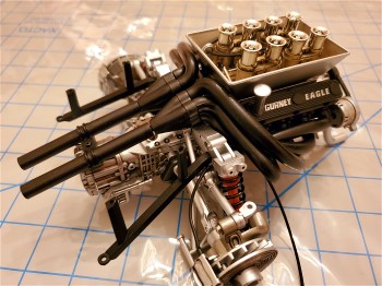

This step was relatively easy. Before I started the assembly process of steps 81,82 and 83. I painted the pipes in Tamays X-10 (Gun Metal). This took away from the toyish effect of the plastic black pipes. After the paint dried, I assembled the parts as per the instructions.
You will need a little CA glue to keep the pipes on parts 83A. There seems to be a bit of a gap, but adding a little CA glue took care of the problem.

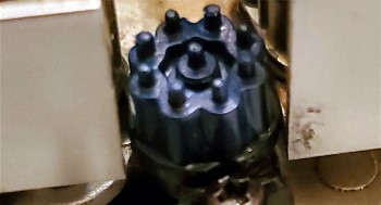

When it came to step 84, I did something a little different. I painted the distributor cap in a gloss blue color. With hindsight being 2020, you will not be able to see it, but it is done.

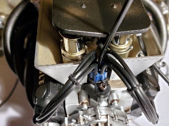

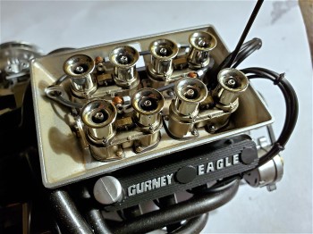

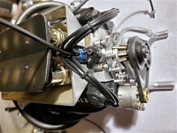

With regards to the spark plug wires. I used a thick black thread or black tie to for the wires and created a harness. This came in handy for the wiring. Also, I cut little pieces from the spark plug wires to make the harness a little easier to work on. 4 was the longest wire, 3 I cut a little off, 2 a little more off and 1 some more off. while you are putting the wires in the lynch pins, add a tiny bit of glue. This will prevent the cables from detaching from the lynch pins.
