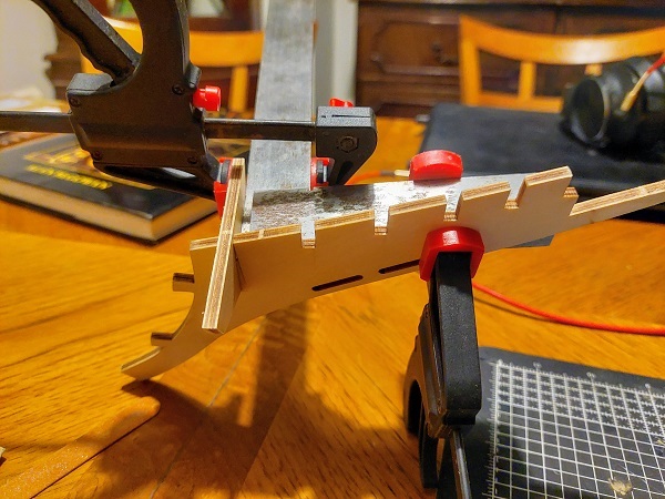

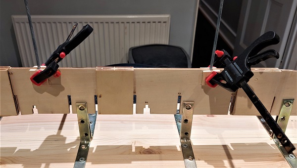

Just thought i'd put this picture up as a start to this thread, i must say the little balancey thing they give you for the front is completely useless unless you have the bow rib frame on with all it's bits and pieces, anyway, the keels edges were sanded and glued together on cling film on my kitchen worktop and more clng film was put on top and weighted down, just before being completely dry the bracing peces were added and clamped together.

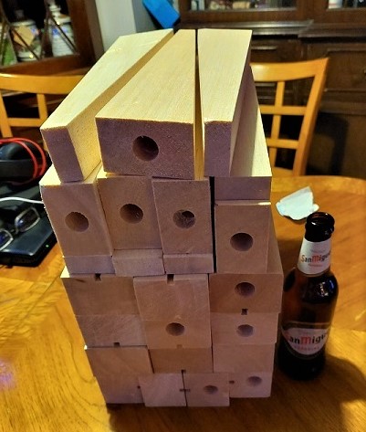

was having a look around on the internet and balsa wood is bloody expensive for a couple of slivers of craft and modelling labelled stuff, bought this lot for 20 quid on e-bay from a school in Derby who used it to make model cars, think i'll have plenty here to stick in between the ribs of the SOTS, if there's any left i'll put it up on here and anybody who can find a use for it is welcome to it.

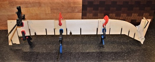

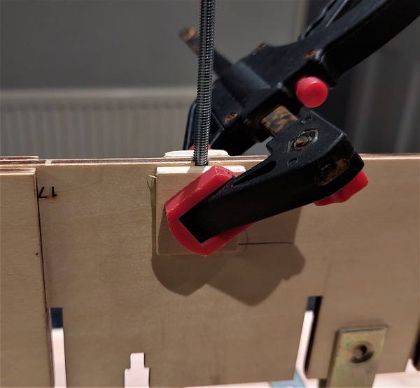

cut slots in the frame to take some 4mm threaded bar and glued some of the 4mm plywood sprue to create a channel to take the bar, next up is cutting a slot for the nuts so they dont spin and glueing them up with araldite to be able to mount this thing when all's said and done.

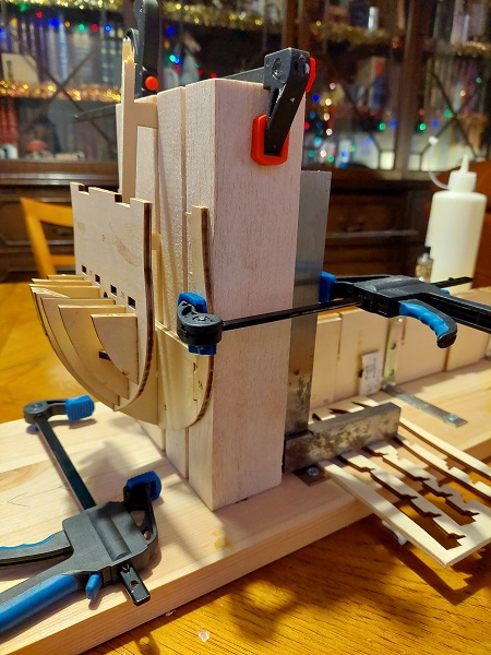

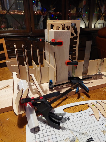

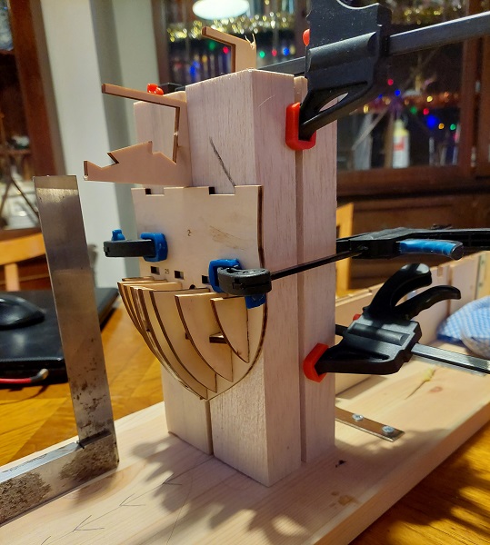

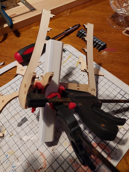

Those big lumps of balsa i acquired a little while ago have come in very very handy for squaring up the ribs on this stage of the build.

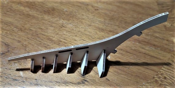

Started on the Bowsprit, the little boy next door came in and said "what's that" i told him it was a model of a newly discovered dinosaur called a Spritasaurus.
