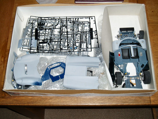

That aside, I've pulled out another wreck from my stash of junk kits to see what I can do with it.
It was part built when I got it. Not too shabby either but I'm still going to strip it down as much as possible and start again.
Currently Googling race colour schemes that are a bit different.
On we go...
#2 Posted : 08 September 2021 10:55:52
Posts: 5,057
Points: 15,317
Ok, off we go.
Any guesses?

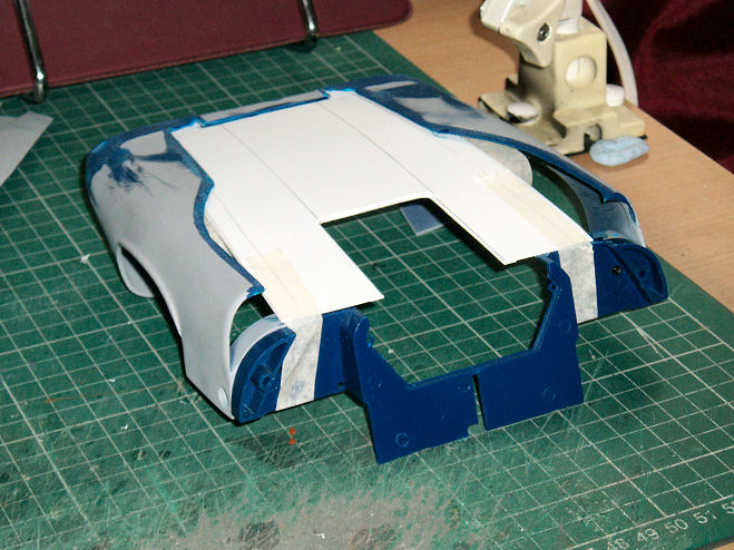

#3 Posted : 08 September 2021 13:41:41
Posts: 5,057
Points: 15,317

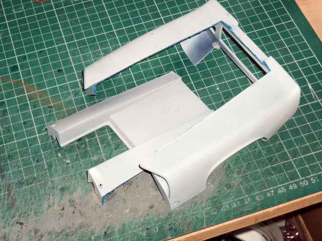

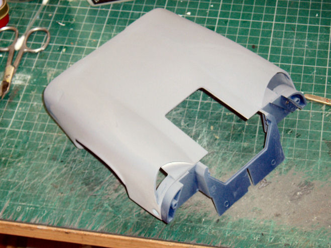

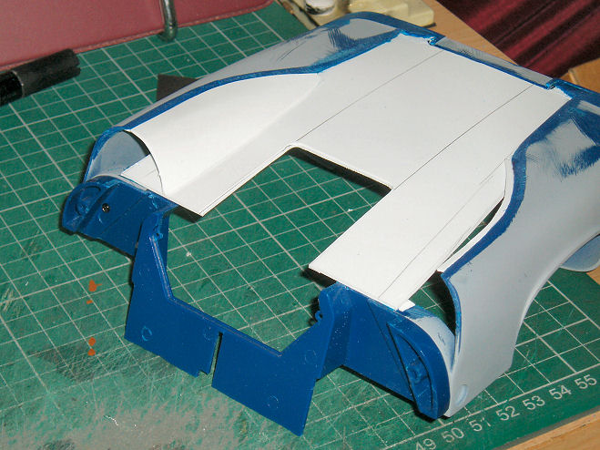

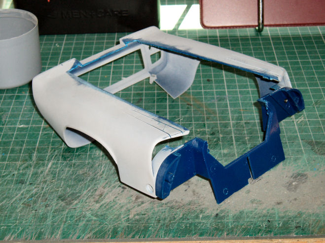

Rear inner bulkhead cut down and temporarily screwed to tail section to give shape and support...
#4 Posted : 08 September 2021 13:41:41
Posts: 5,057
Points: 15,317
Tail end cut down and re-shaped. Still lots to do.

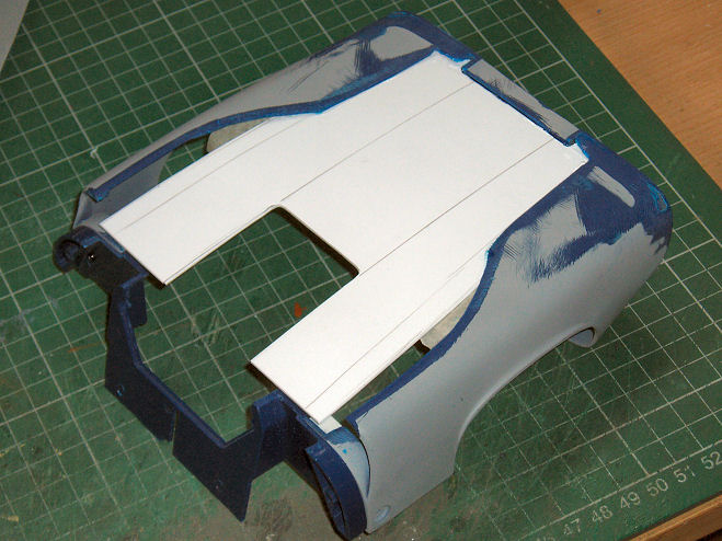

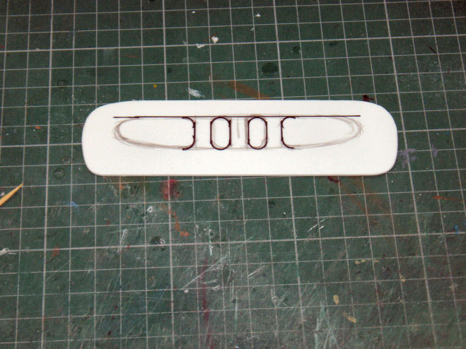

#13 Posted : 12 September 2021 09:54:49
Posts: 5,057
Points: 15,317
Thanks for peeping in chaps.

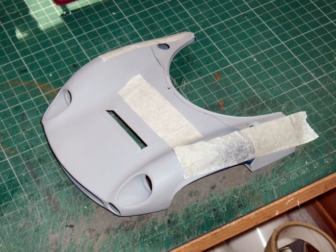

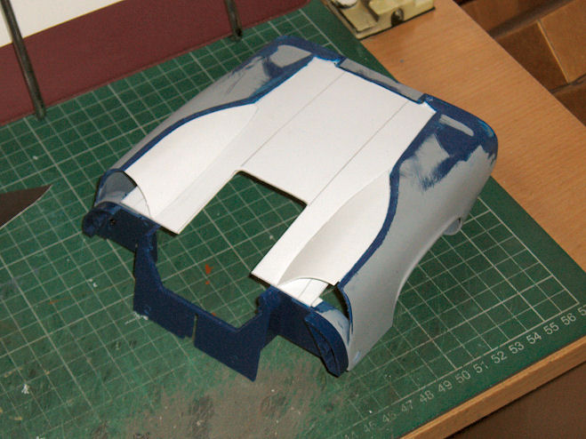

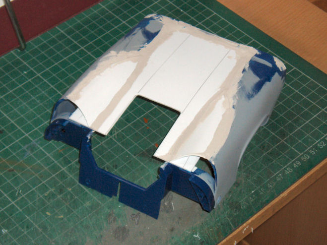

The rear deck has been made from sheet plastic and added, and then (umpteen) card templates were made to create the modified air intakes.
These were finally made in sheet plastic and glued in place.
Ok, I now have a rough tail end.
Lots of filler and sanding next...

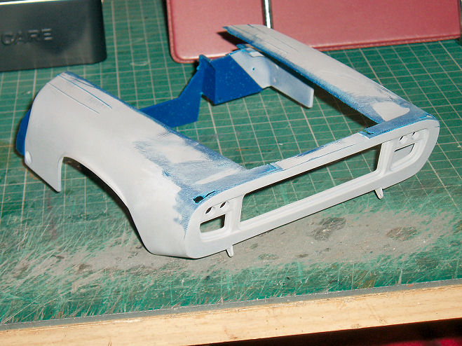

#15 Posted : 14 September 2021 09:50:54
Posts: 5,057
Points: 15,317
Many thanks Ken.

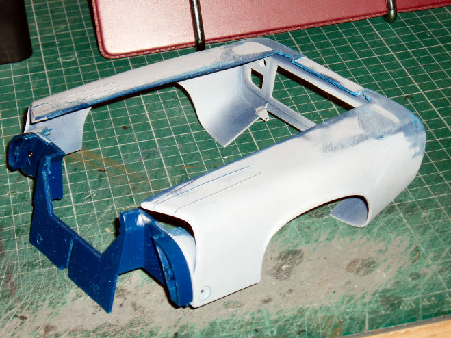

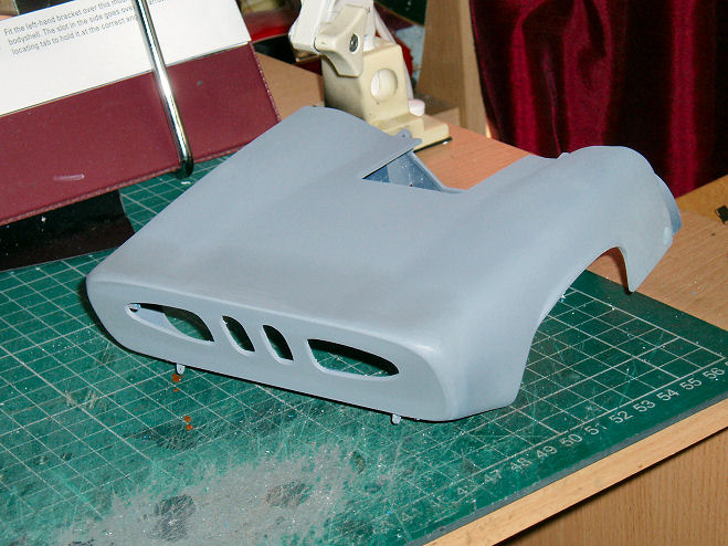

The rear end has had a first load of filler, sanding and a light grey coat to show up where it needs filling next, so still more filling and sanding to do.
The front end on the T70 Spyder opens in a different place to the standard cars so I glued the parts together and then cut them apart in the correct place.
On we go...

#18 Posted : 19 September 2021 18:26:09
Posts: 5,057
Points: 15,317
Many thanks for peeping in chaps.

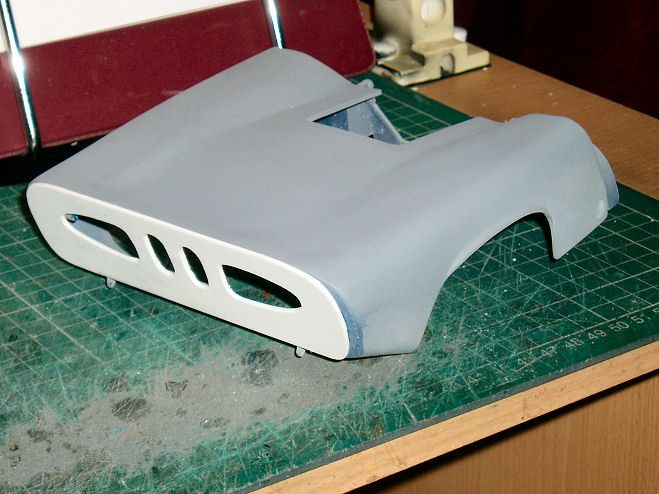

After a LOT of filling, sanding, filling, sanding, the rear has a coat of primer to show imperfections.
Still more filling and sanding needed and I've got to make a new rear panel as yet.

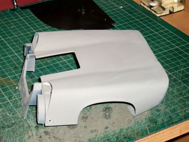

#19 Posted : 22 September 2021 10:39:35
Posts: 5,057
Points: 15,317
A little more for those following along.

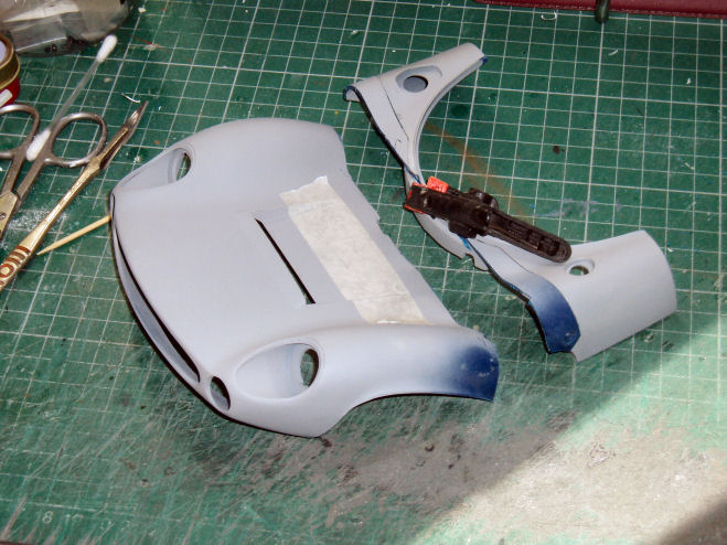

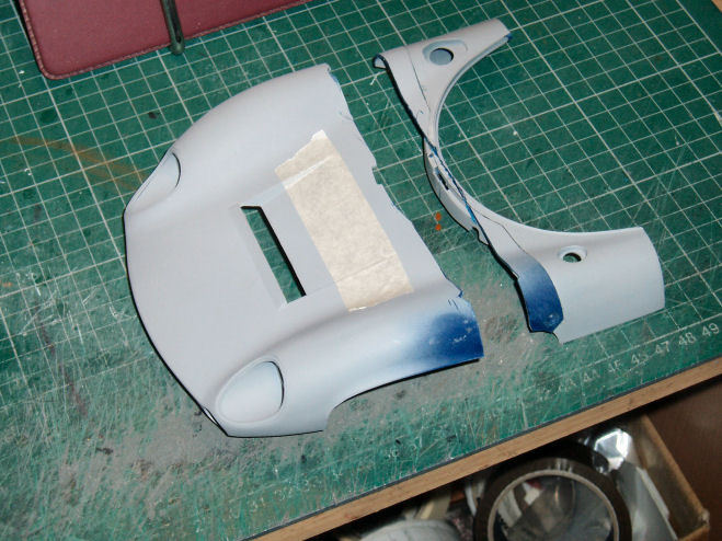

The rear end of the engine cover is completely different to a normal T70.
I've had to cut away the old rear and make a new one in sheet plastic.
Still lots of shaping and filling etc to do but the coats of grey primer give me a good idea of imperfections.
Slowly getting there...
