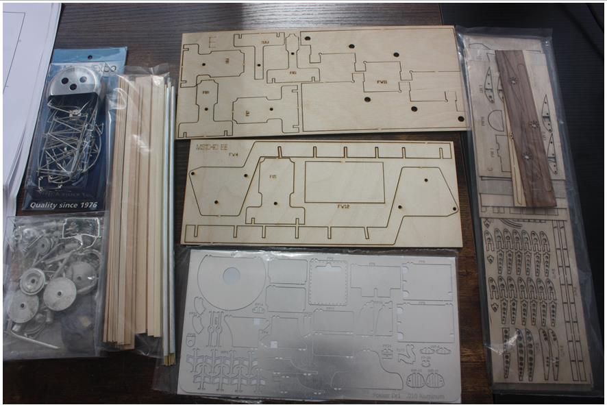

This arrived today, The Fokker DR1 1:16 scale by Model Airways. Built the Sopwith some time ago and this will make a nice addition.
Did build the Hachette Fokker many years ago 1:8 scale but this scale will best suit as a pair with the Sopwith

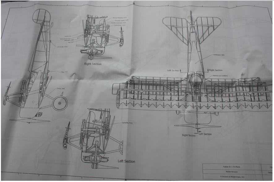

Kit looks fine lots of 1:1 scale plans
Parts list to check off
Instruction Manual 48 pages?!

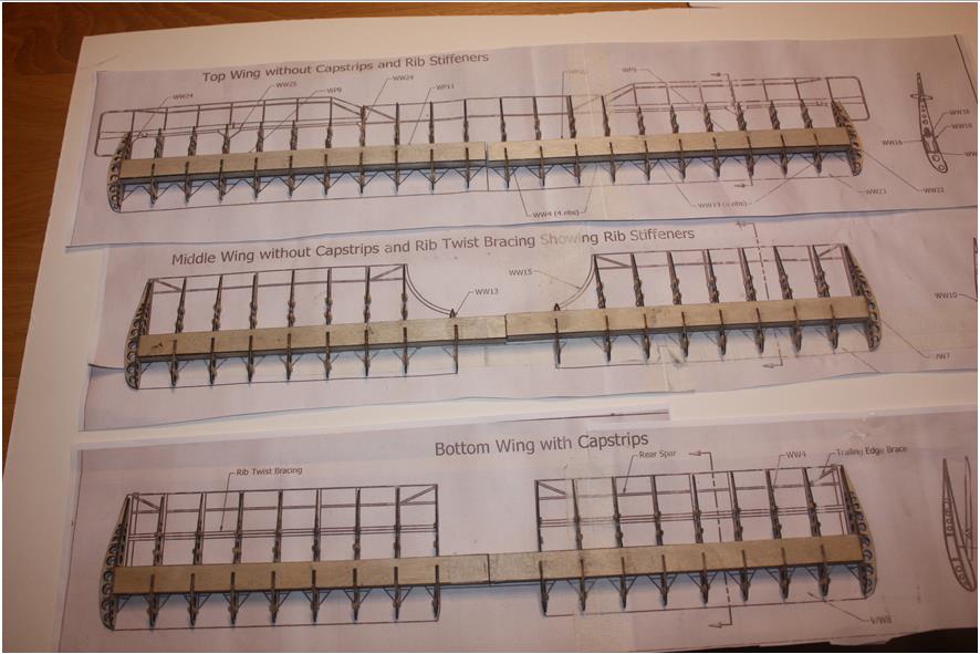

#2 Posted : 03 September 2021 15:43:19

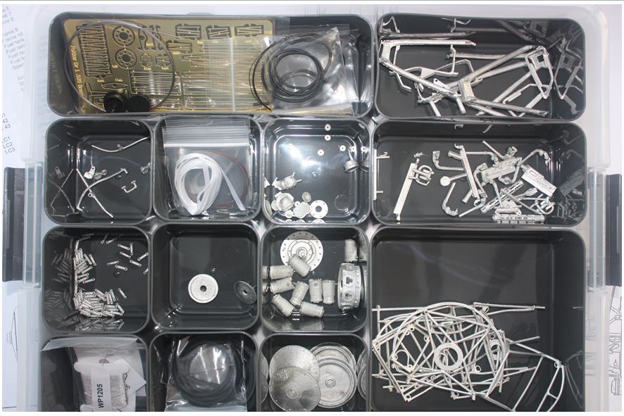

Step one, sort the components into sections. They where all together in a large plastic bag. Time spent sorting now will save time as the build progresses and enable me to check I have all the bits.

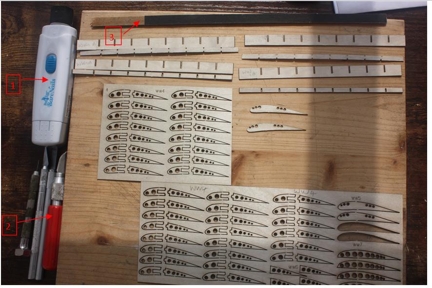

And so it begins. Have had a good look at the parts. There will be some trimming/sanding of metal parts as to be expected. The wooden frame parts are .9mm, so care will be needed when handling during construction.
1st part to construct is the lower wing. In preparation for the start I have "modified" a battery driven nail file by replacing the supplied sandpaper with a finer 320 grit. This will be useful with the number of components involved (No 1 in the attached picture.)I Have replaced all the blades in the craft knives with new (No 2) and made a "file" of 320 grit paper for general sanding of the woodwork, will need to remove the burn marks (no 3)This is disposable and can be cut to length as required

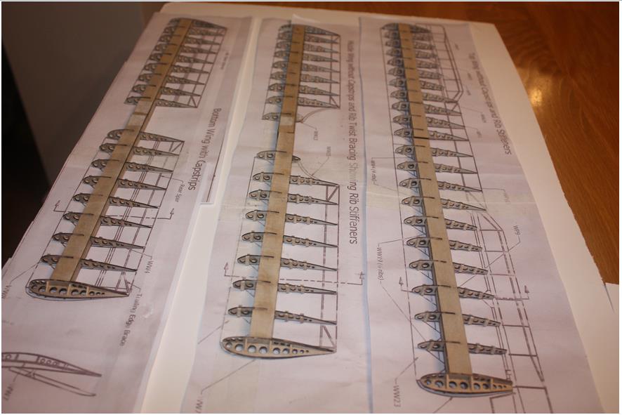

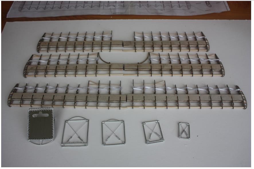

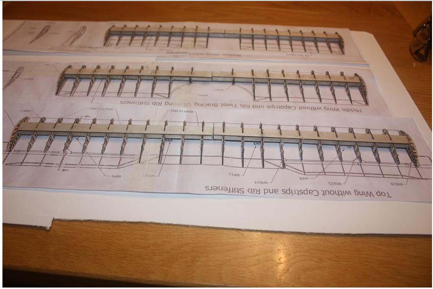

Finally got started
Stage one. Started on the three wings. Have assembled the wings as far as the basic skeleton, more to add to them next. I am drawing from my experience from when I built the Hachette Fokker which does help. Have to be careful as the parts are fragile.
Pictures attached

Location: Dorset
Had some trouble in forming the leading edge covers for the wings. They are made of .4mm of ply which need to be bent into a semi circular shape. May have to rethink this part of the build. The structure of the wings is fragile so I have added some additional spars along the length of each wing. Utilising the holes in the provided spars I have inserted some spars along the whole length of each wing. I was looking for some 3mm dowel, but found some kebab sticks in my BBQ kit which fit the bill ThumpUp ThumpUp ThumpUp This is in addition to the rib bracing tape
Have now started on the fuselage, lots of cleaning up of the castings required. The parts are very malleable so are easy the reshape where necessary. Some are somewhat out of shape Slow progress on this build.

#19 Posted : 04 October 2021 18:56:19
Nice work with putting those delicate wings spars and ribs together Gil, all looking very neat and straight. With the troublesome 0.4mm ply leading edges, have you tried soaking the sheets in warm water first then when they are more soft and pliable, with less tendency to split, bend them slowly and carefully around the leading edges and clamp in place (or use lots of strong elastic bands, one per rib), leaving them until they have fully dried and retained the curved shape, and then glue in place? Be careful that the water isn't too hot when you soak them or you could soften the glue that binds the ply layers and it may end up delaminating?

#20 Posted : 04 October 2021 19:03:57
nice work.The biggest issues with this kit IMO is the soft metal fuselage sections.What I found was they bent out of shape very easily and it was virtually impossible to keep the fueslage straight as the parts would start to warp as soon as any pressure was placed on them. I ended up taping the sections to the wooden jig aft I had them as straight as possible and then use 5 min eposy on each joint
between the stringers and the fuselage sections. Styrene fuselage sectinos would be far superior.If I were to ever build this kit again I would cast the fuelage sections in resin or make them out of brass and solder them.
