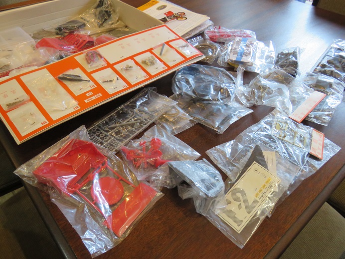

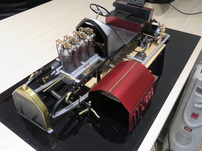

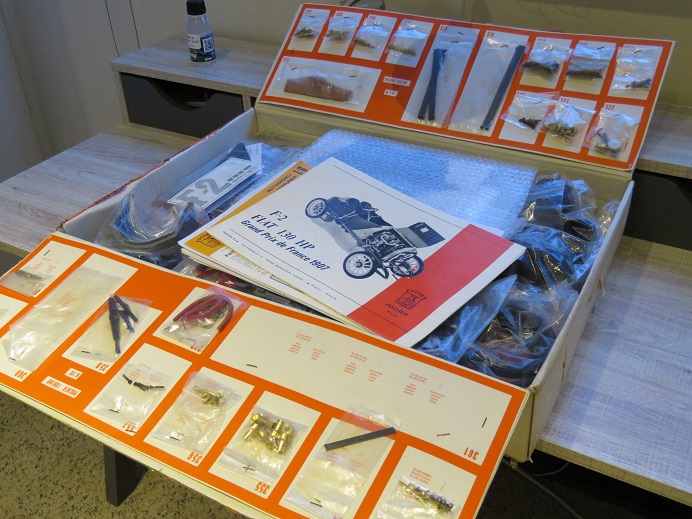

My first Pocher kit and my first non F1 build. I found this one on the net and it’s got a few little extra details. Not all the packets are intact some I’m hoping that everything is there. It’s the K70 kit from the States in the 1970’s.
The Fiat 130 HP F2 was a 1907 car that scooped up many of the major racing prizes of its day. Four cylinder 16.286 Litre… !!! Must have been quite a job to crank that over by hand.
I’m thinking of deviating from the red colour scheme and going for Black which I’ve seen done on a great build of this kit by Rick Levene featured on the Model Motorcars site.
https://www.modelmotorca...ck-levene-usa-1907fiat/

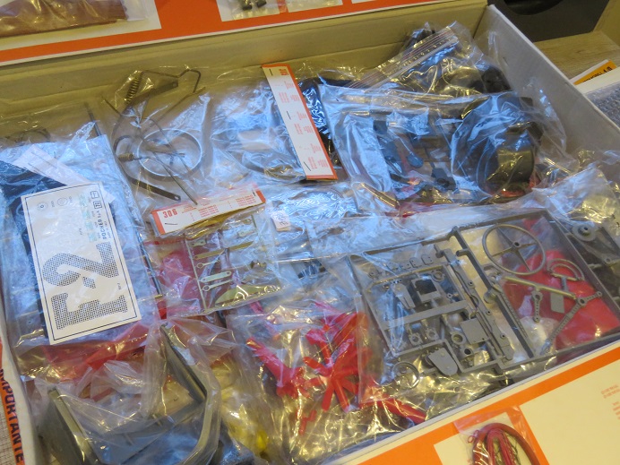

First job is to start identifying the parts. The numbering system is not exactly what I would call Intuitive…. Roy’s restoration build of this kit is going to be a great help.

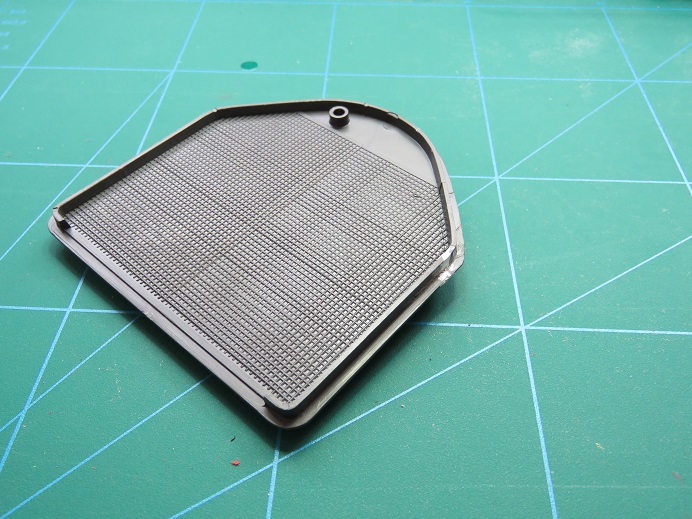

I'll be watching in.BigGrin

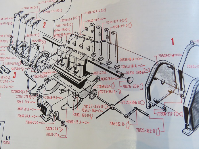

This is really a very awkward kind of a kit. I know it’s the best part of 50 years old but the quality of mouldings ( from material to assembly design ) leaves a lot to be desired and the “instructions” just complete the challenge. BigGrin
Here’s a picture of a typical assembly guide. Each part has a 5 digit code comprising the kit number ( K70 in this case ) and a 3 digit sequential number, then the 2 or 3 digit sprue or parts bag number, then a colour code and finally an assembly method icon ( glue, screw, press, hammer etc. ) .
The plastics tend to be quite poor mouldings with lots of flashing and can be brittle…

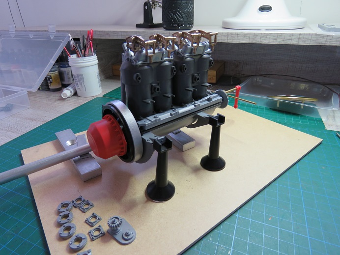

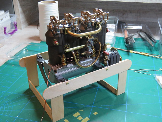

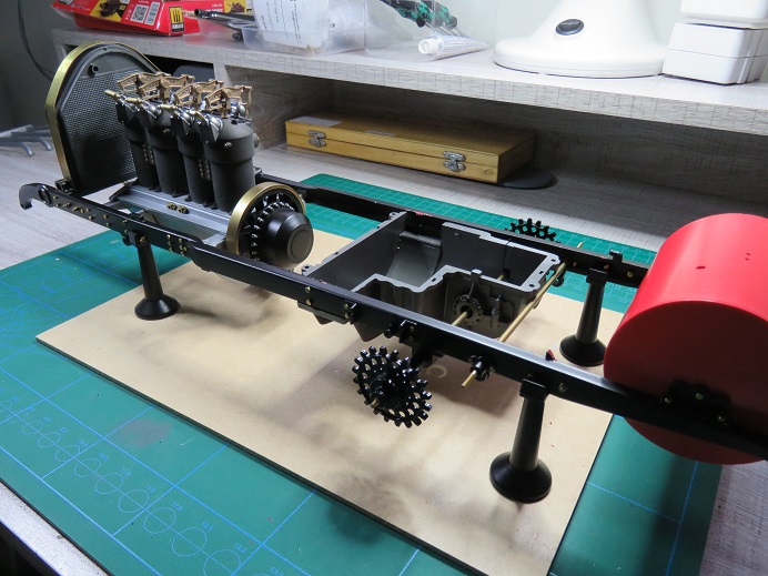

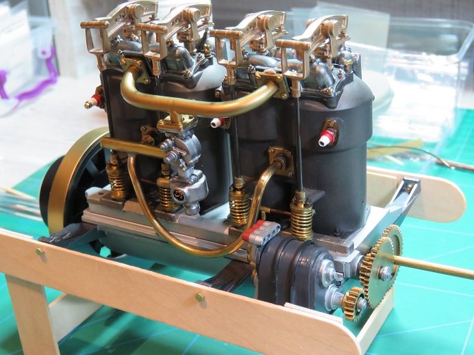

Made a start on the ICE...BigGrin

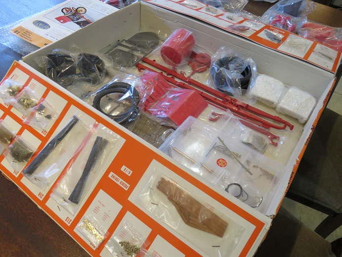

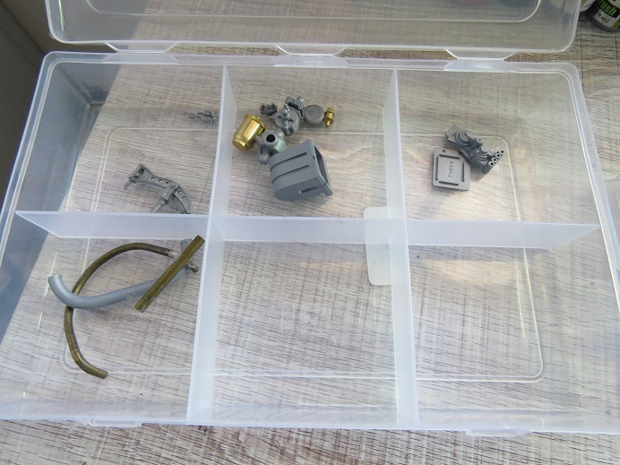

The kit that I obtained also has the Model Motorcars wooden wheels , brass Rockers and Seat upholstery extras.

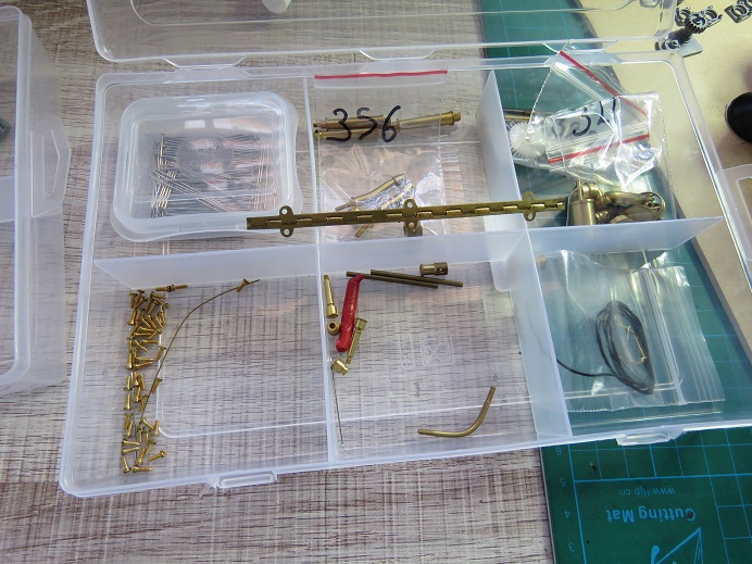

I’ve started to sort through and identify the parts, especially the brass pieces which have been mixed up a little by the previous owner. So far everything seems to be in the bo
x.

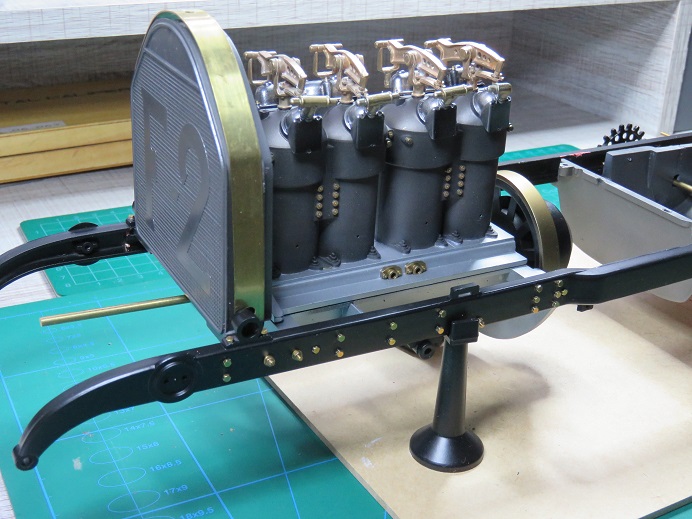

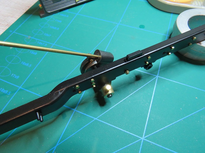

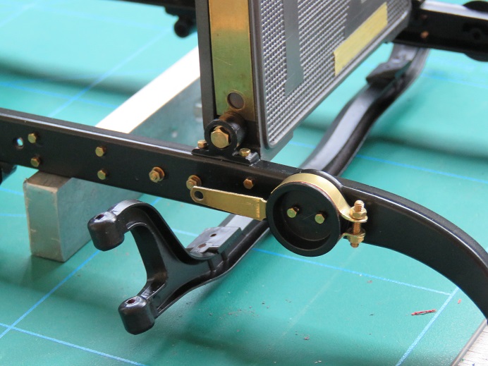

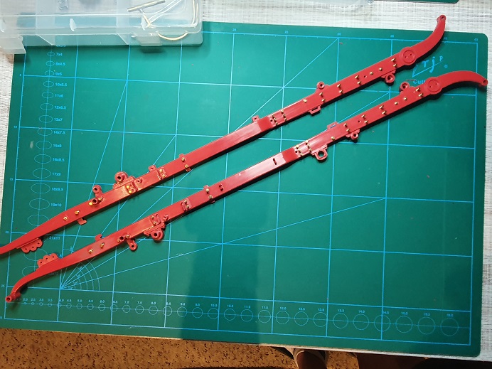

The two chassis rails have moulded on nuts and bolts which I’ve removed and replaced with Brass hex’ head bolts. I’m going with a more black colour finish so that the final build ( although maybe not so authentic ) will look less “plastic”.

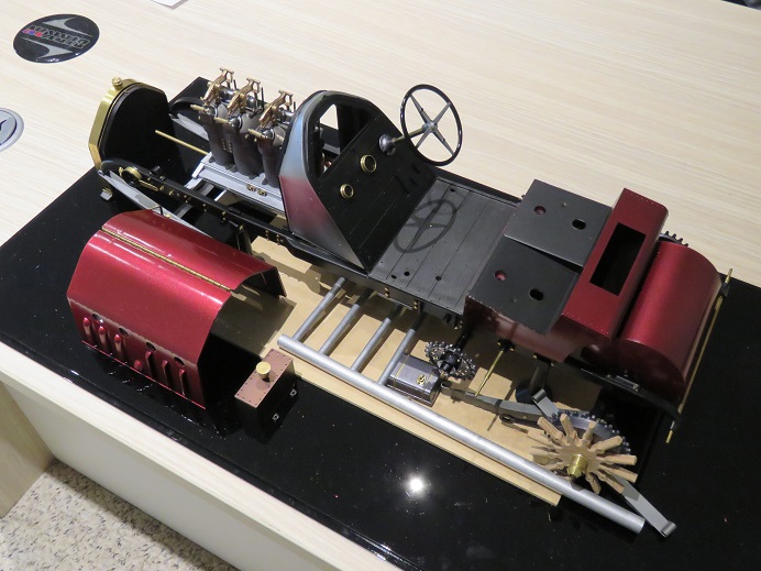

#14 Posted : 18 January 2022 13:20:32
Thanks Mark and Roy for looking in and commenting.

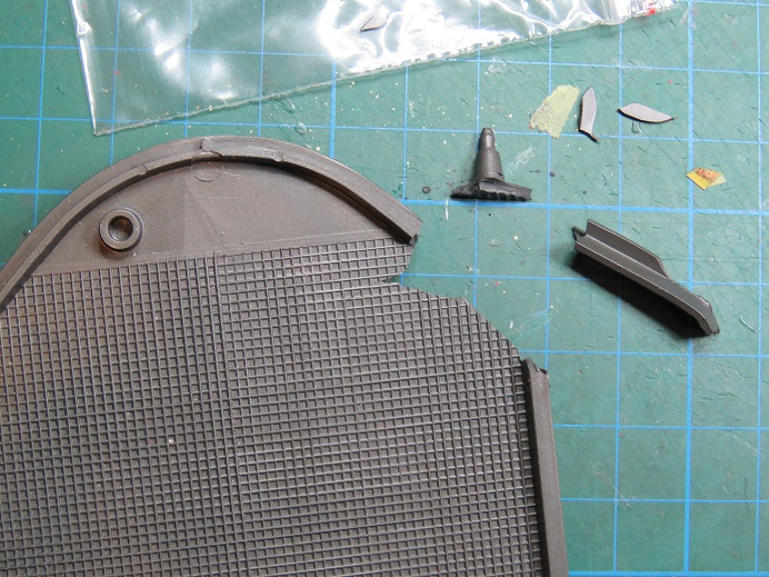

This kit is pretty old and although it appears complete there are a few damaged parts which will need attention.

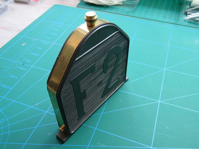

The radiator back plate had a corner broken out. Luckily the bits were still in the plastic bag and will be fine once painted. The Brass strip was partially formed and twisted and took some wrestling to get into shape.

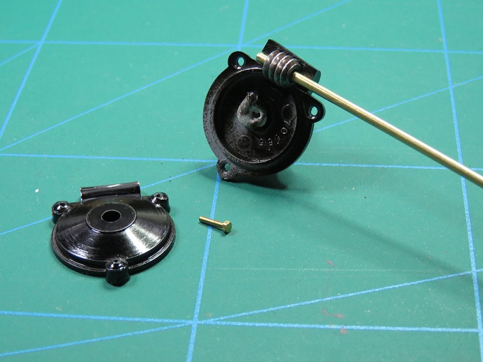

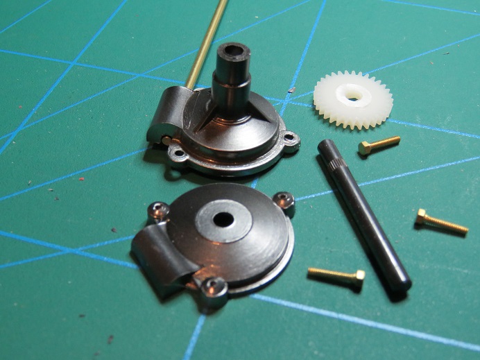

The steering box is a neat little assembly . The Main gear has to be pressed onto the shaft. I had to grind away clearance for the worm gear to turn freely. The 1.6mm Brass bolts replace the gluing together method of the kit and look better .BigGrin
bfam4t6

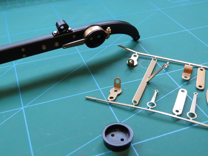

There aren't any photoetch parts in this kit but there is a sheet of Brass blankings ( shows the age of the kit I guess BigGrin ). These are partially formed and need some careful bending to get into the correct shapes such as Clevises and in this case the friction damper bands.

Excellent work as usual Malc, all looking very neat and tidy and a very skilful fix on that broken radiator back, very difficult to tell that it was even broken in the first place!
Keep up the good work Malc and I wish you every success with the rest of the build, I know you'll make a great job of it! Cool ThumpUp

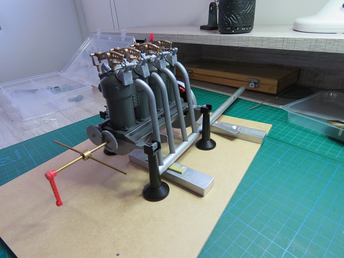

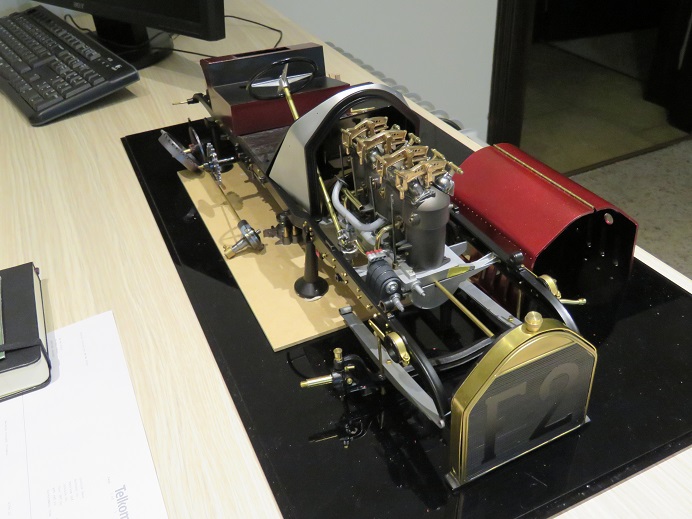

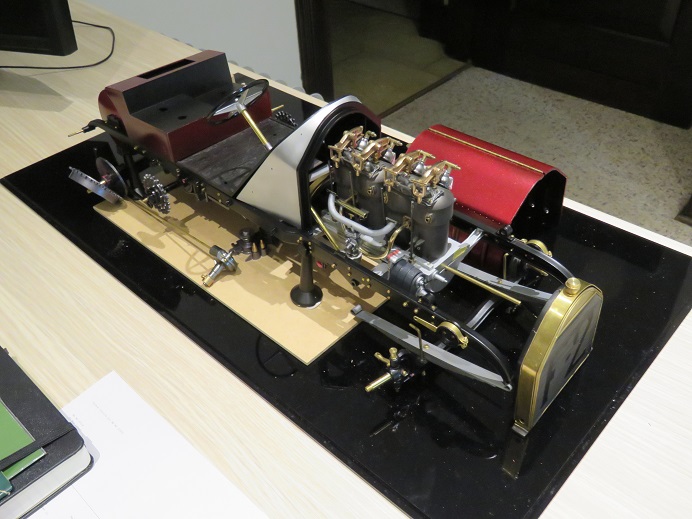

#19 Posted : 01 March 2022 12:08:22
Thanks for the comments Kev.
I've now identified and prepared a lot of the major pieces. Time to get cracking on the details and assembly.

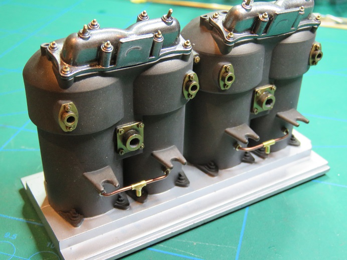

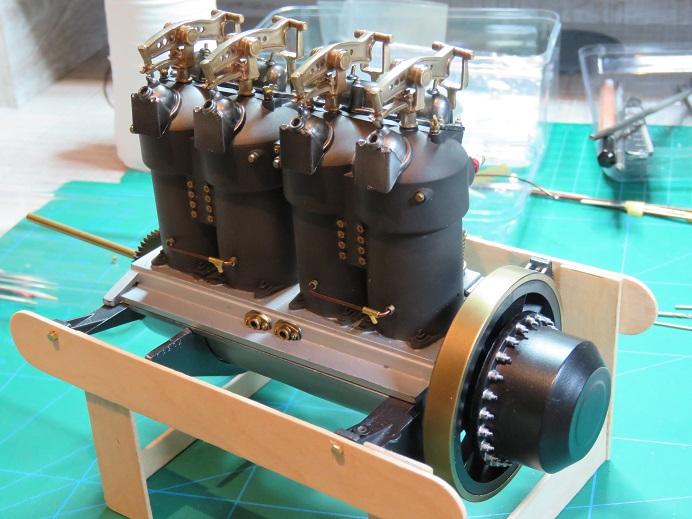

#20 Posted : 23 March 2022 09:42:21

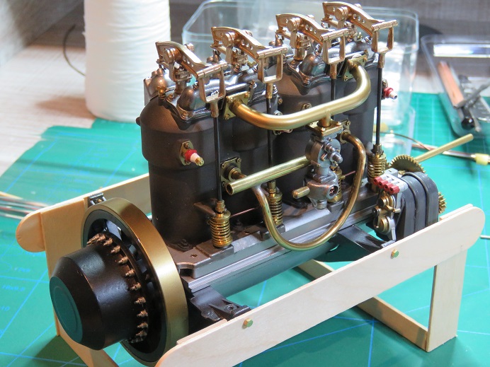

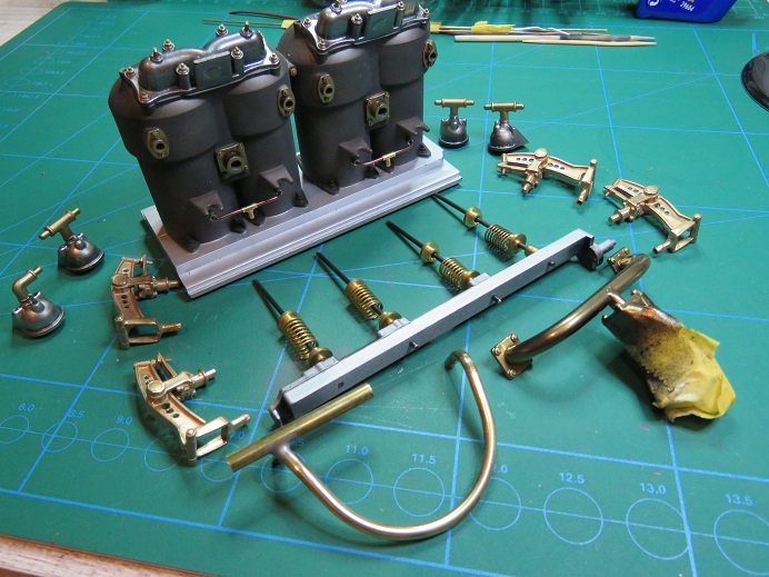

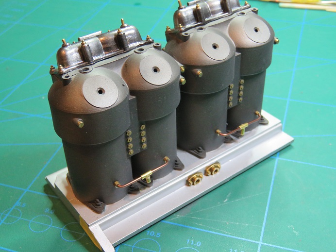

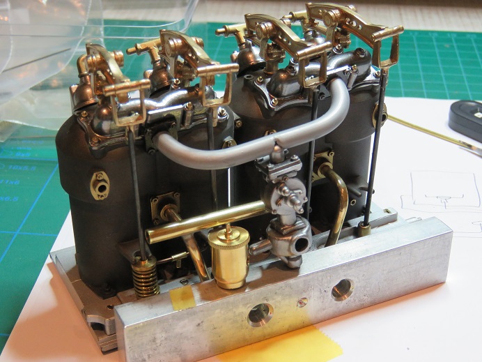

Trial fitting of the engine parts has given me a good idea of where everything goes and what I can add with extra details.
There’s a really ugly joint between the carburettor inlet pipe and the manifold. This will get filled and sanded smooth. I’m adding some oil pipe detail around the base of the cylinders. 1mm aluminium wire, copper coating will do the job ( Bonsai wire ) . The Tee pieces are from 1mm ID Brass tube. The oil lines will be routed into the underside of the Oil tank that sits behind the “dashboard”.
I’m adding M1.2 threaded rod and nuts to the spark plugs to secure the leads.
Alclad II polished Brass for the brass look everywhere.
