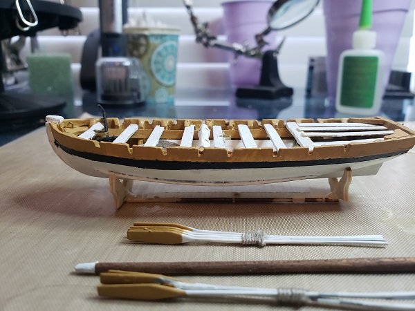

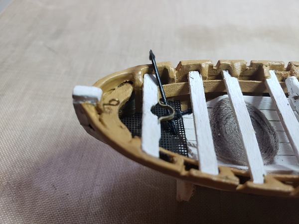

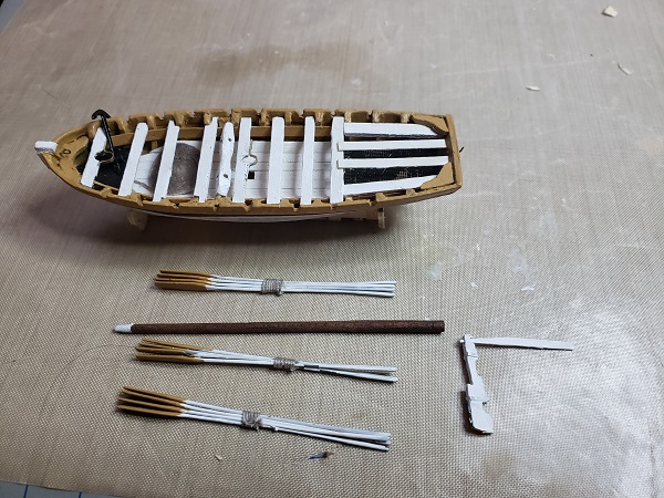

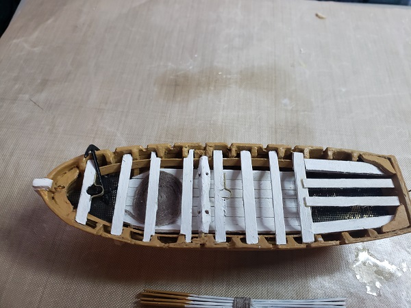

Hi All, I've been reading through your diary's as I've been getting Ye Olde Shipyard restarted to continue working on my Victory. I had started it a few years ago and then we moved and life has interfered with the process. I've now got a fairly functional work area and have restarted.
When I left off, I had all the ribs installed and the lower deck. I'm at the point of getting ready to start fairing the hull. Before I do it, I have some basswood pieces that I'm going to glue into the voids between the bow formers and between the last 2 ribs at the stern. I'd read an article on fairing that suggested it and it makes sense to me!
Before I start the fairing and planking, I decided to build the 4 small boats. I've finished the launch (pictures attached) and am priming the cutter, it's thwart supports, floorboards and thwarts---it's almost done. Once I've finished that I'll do the pinnace and barge. I figured these would give me a good introduction to planking. I'm not sure how much I've gleaned on planking with the small boats. I think planking them is a fairly different animal than planking the Victory!
For now, I have a few questions as I restart and continue on the small boats:
1. How do you paint the brass floorboards in the boats? I wasn't happy with whatever I did on the launch but it won't be seen when finished. For the other boats I'm thinking of trying to scuff up the brass with a sanding stick, then very lightly prime it with my airbrush. After that I'm on the fence about trying to brush paint them or airbrush them. My ears are open for suggestions!
2. Now that the launch is finished, and will sit with it's 3 brothers for quite a while, should I lacquer or varnish it? I'm also wondering about spraying them with Future floor polish. It's used quite often by plastic modelers to protect their finished work
3. What do you think of the Victory add ons from Woody's Modelworks
https://www.woodysmodelworks.co.uk ? Some of them have my interest including the Gallery, Bow Detail, Beakhead enhancement, Entry Ports, Cabins, buckets and Water Level markers (I'm going to tile my hull) kits
4. I've been using an electric plank bender for the small boats. I burnt myself once and found that I almost need 3 hands to use it with the form! Part of the solution may just be to put the form in a vice. I'm going to give that a try on the next boat. What has been your experience with the electric plank bender vs. the crimper with the razor blade?
5. Can you also please point me to any good discussions about the use of planking clamps, pins, binder clips etc. when doing the hull planking? I'm leaning towards binder clips and limited use of pins.
That's it for now, hopefully I can finish the cutter soon and get on to the other 2 boats. I actually think I might do an assembly line for the cannons and the anchors before heading over to the ship

Hi John, welcome back.. great to have you with us again. Looks like you're doing a great job on the ships boats, lovely work....Cool Cool Cool
I'll try to answer each of your questions in turn.
My method was to lightly sand the surface with fine grade sandpaper. Then brushed on a coat of Mr Hobby Mr Metal primer and left to cure for 2 days. Using my airbrush I then gave a fine dusting of matt black paint. Left to dry then fitted to the boats.
Either or... My preference was to use Vallejo matt and silk varnish applied with my airbrush. Would suggest you try painting and varnishing some test pieces to see if it turns out the way you want. Worked for me....
Have never tried any of them so would be unfair of me to comment except to say that some of them do look good...
I've used a number of methods to bend planks and have always reverted to using an electric plank bender. Find the strips will bend very easily when soaked in warm water until pliable. Once I have the necessary bend then I'll temporarily pin the plank in place and leave to dry, then shape and fit. There are many videos on the tube showing how to bend and fit strips, some very good viewing to be found there...
I don't like pinning directly through planking strips if I can help it, I prefer to use map pins, pinned to the side of the plank into the ribs then removing the pins when the glue has dried. I compiled a topic on this very subject that you may find interesting..
https://forum.model-spac...spx?g=posts&t=25807
Hope you find the answers useful.

Thank you Alan for taking the time to answer my questions, of course, I have a follow up or 2!
How long did you soak your planks for? On the boats I found that just running them under the tap for a few seconds did the job but am sure that won’t work for the ship’s planks!
Can you attach more than one row of planks at a time using the map pins? Won’t they introduce e a gap, though very small between the rows?
Can you think of any major gotchas that you or others have come across during your build? I’m thinking of things like the cannons on the upper deck and their gun ports not lining up vertically? Or doing certain tasks earlier than what the manual says due to easier access?
I think the first few lessons I’ve learnt is that the plank bender will burn you, don’t scrimp on a cheap set of calipers, manicure sticks are awesome, get a good set of micro drill bits, and making a drawing of where the thwarts and oar cutouts go relative to the ribs really helps and the Dremel tool used in moderation is your friend!
—John

No problem at all John, am happy to be of assistance whenever possible.
Soaking the planking strips - how long they should be soaked for really depends on the type of wood. I found the birch strips provided in the Victory kit would need to be soaked in warm water for some 20-30 minutes. I soak until the strips become pliable.
Map Pins - my method is to attach a strip and pin along the upper edge. By the time you have one row fitted and start fitting the next row the glue will have taken hold. This means I remove the pins as I go and refit the pins to hold the next row.
As for glitches, follow the Official Build Diary. This highlights any potential pitfalls that were identified during the course of the build and things that need to be looked out for. Lot of builders didn't ensure the stern ribs, rib 30 was fully seated. They didn't notice this rib is prone to moving especially if you turn the hull over before letting the glue set. Check the seating of these stern ribs often until they are firmly glued in place.
Hope this helps..

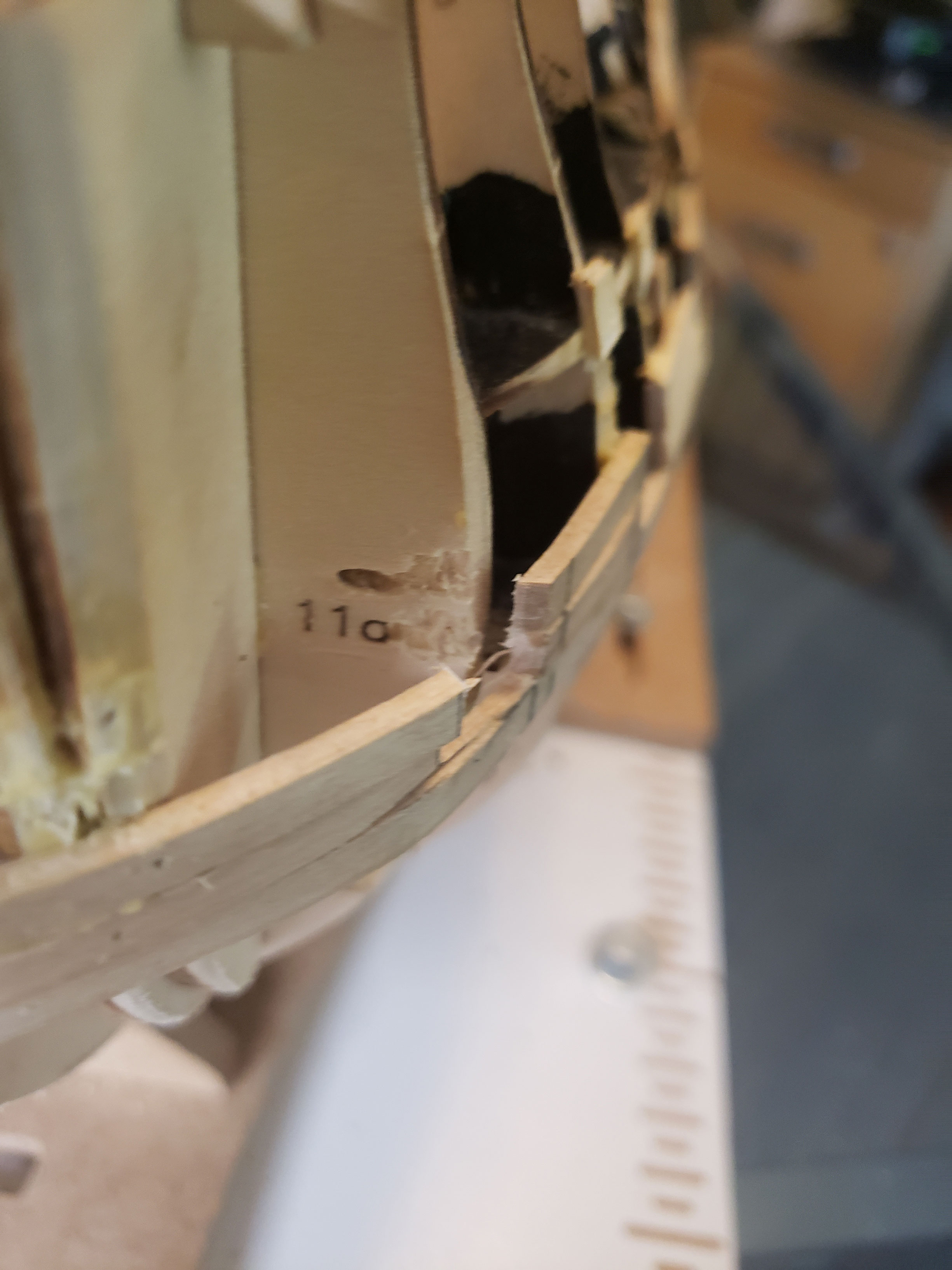

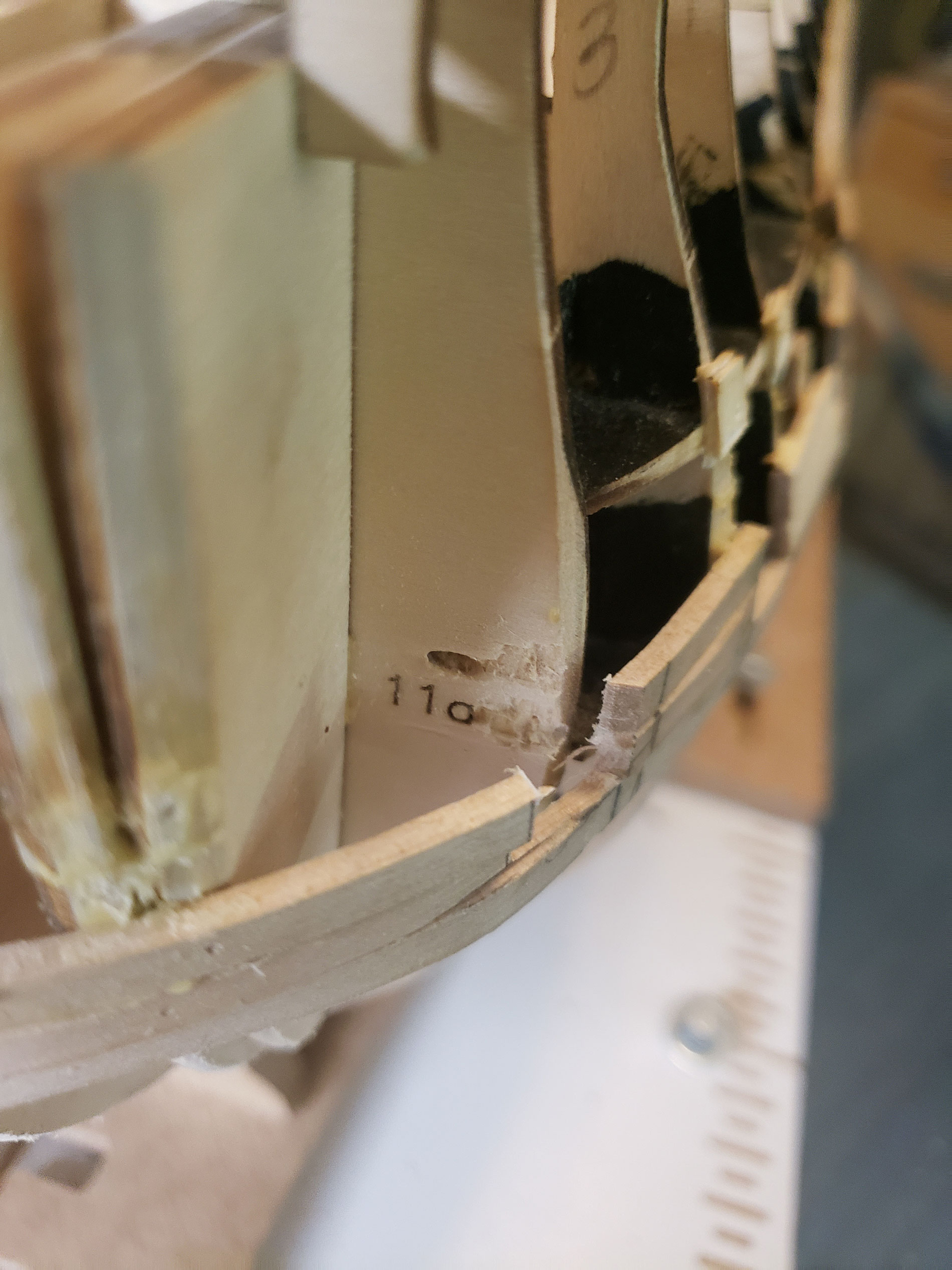

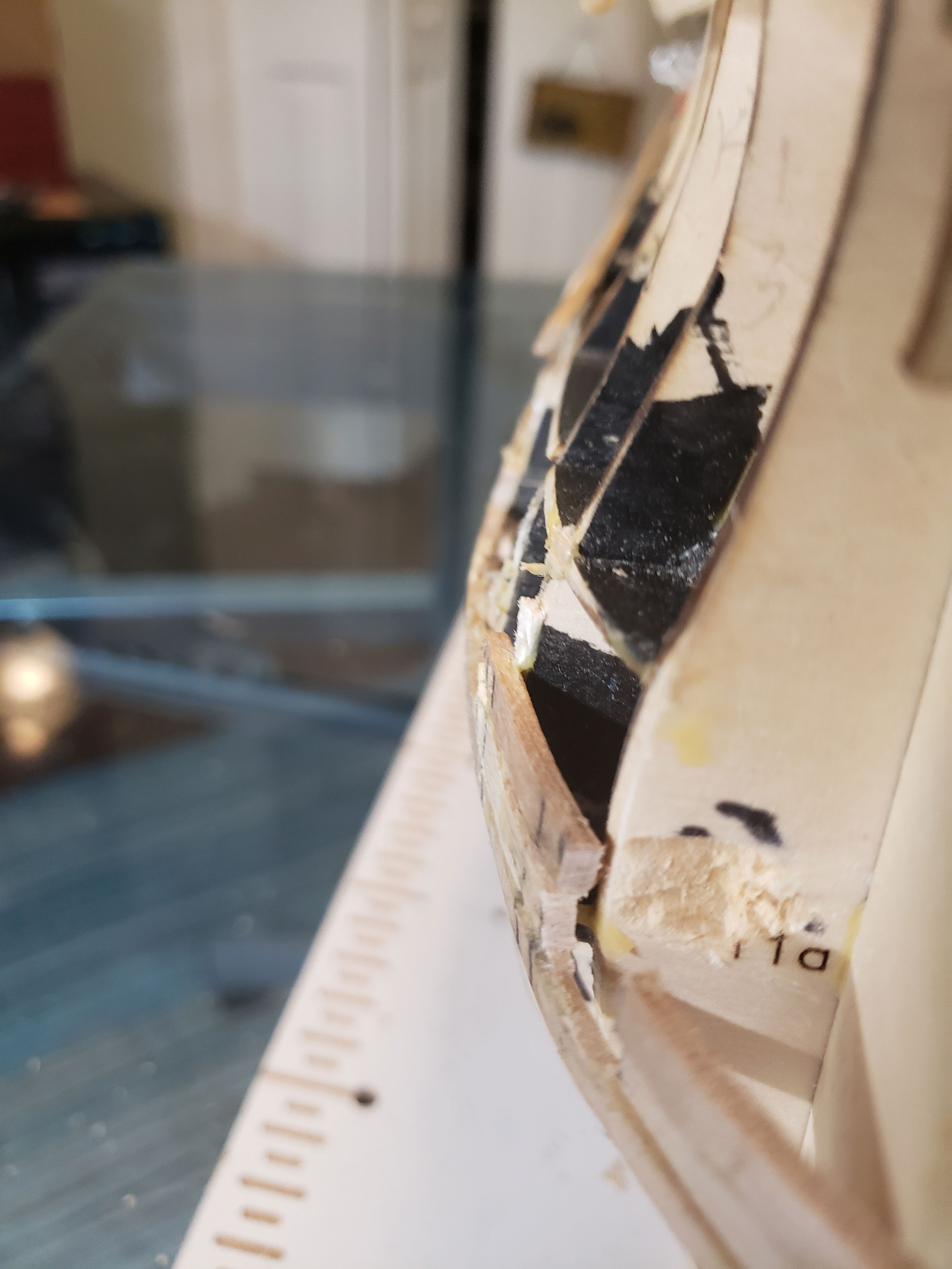

The part re: the stern plank for row 7 is in Issue 24, Page 138, step 2. I took a closer look at the picture and it does look like the end of the plank that butts up against the mid-ship plank at frame 24 is 5 mm and the end overhanging the stern appears to be tapered. I'm going to pull the plank off and try it again!
Speaking of tapering planks, how do you folks do it?
The bow plank tapering is discussed on the next page, 139 in steps 3 and 4. Here are a few pictures.
jmmx15 attached the following image(s):

Been a little difficult as this kit has been released several times with the instructions in different formats. I have the printed magazines and the downloads for double packs when the kit went to 12 months.
The stern plank for row 7 does indeed need to be tapered by 1mm. The plank runs from rib 24 to the stern and is trimmed at an angle by the stern using the template. Now, as the shape of the hull changes bow to stern and deck down to the keel or upwards, planks have to be tapered to keep them level with the decks. The stern plank on level 7 is one of these.
So you have fitted the centre plank from rib 17 to 24. The stern plank then will be full width where it butts to the mid plank at rib 24 and taper towards the stern. The full taper is on the underside of the plank. This allows the row 7 plank to follow the row 6 plank below it, without plank 7 rising too high. (It should remain roughly level with the first deck above it.
Hope this helps explain your question.

OK, I get it now for the stern planks. I also made a mistake with the layer 6 stern planks. I've popped off both the layer 6 and 7 stern planks and will replace them.
I'm still wondering what tools, techniques you folks use to taper the planks?
What do you think about my bow planks for layers 7 through 11? The layer 1 through 6 planks aren't rising so do I need to taper the 7 through 11 planks?

#19 Posted : 03 July 2024 12:31:28
Hi again John, BigGrin
Bow planking:
I downloaded your pic and expanded it as much as I could before the clarity went.
It looks pretty good to me from that pic.
Things to remember:
This is the first layer of planking and will be the basis for the finer second layer. You are at the mercy of the wood quality of thickness, but the good news is that there will be a major sanding job to do when you finish layer 1 and that could involve using some filler on low spots or small gaps and then more sanding. Its this process that will determine the quality of finish you get with layer 2.
When taking pictures, use the biggest pic size available on your camera (I use 4000 pixels width) and edit them down to 650 pixels width for the forum. That way if you post a pic on the forum it will appear at the maximum size and if its relevant to a question, it can be downloaded by the person viewing and expanded back to its original size without loss of quality.
Hope this clears up a few of your questions.

I decided to redo some of my bow planking. The bow planks for rows 4, 5 and 6 were not directly attached to ribs 11, 13 and 14. I used pieces of cardstock and plank scraps to create "shims" to sit between the planks and ribs. While it made my bow look very nice I suspected that it would cause me issues later. I decided to remove the 4, 5 and 6 bow planks and try again.
After I remove them, I noticed that the planks for rows 1, 2 and 3 were glued to 13 and 14 but not 11 (you can see this in the attached pictures from the port side of the bow). Is this going to cause me problems later? should I remove rows 1, 2 and 3 and redo them as well?
Thanks in advance,
