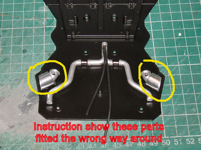

In pack 11, step 43, the instructions shows the brake cooling vent intakes mounted on the opposite sides to how they should fit.
They also refer to them as brake fluid brackets which clearly they are not.
Attached below is a picture of the correct installation.

The build guide has been updated, thanks to Roy and Andreas’ catch.

I'm working on Pack 11 right now and I thought that was an error! Glad I checked here to reinforce that I'm not going crazy! Blink
