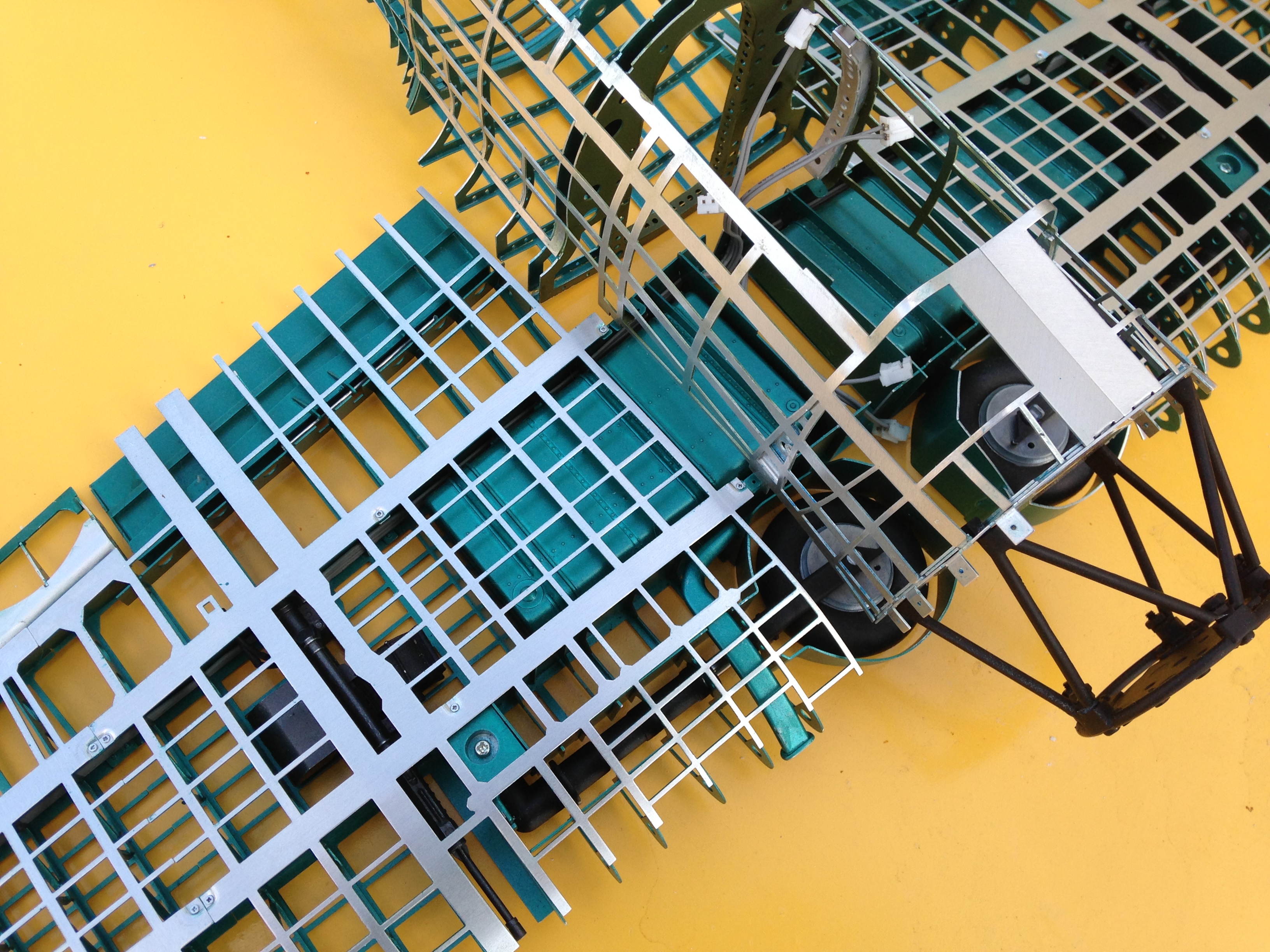

Thank heavens for those people who took the time to post their findings, opinions, and build experience. I've gotten on board the hard way, through ebay. That's another topic I've commented on, so I'll let it go. But there was no way the crown jewel of A6M2's was going to get away.
The postings here on the paint conundrum have been a real education. I think I'll do a scantily clad subject, enough to see what's on the outside, but the more important and visually stimulating, refined parts that aren't often on display, will be revealed. What has me really undecided is whether to paint the entire inner structure aotake blue or to leave it unadorned and just paint and detail the cockpit and engine. As the work has just begun, I'll be a constant visitor to read and reread the generous and informative experiences of you all. Many thanks.

For what it's worth, my own plan with regard to colouring is this: Info suggests that a lot of internal structure was left unpainted at all - with aotake being used only in areas that had some exposure to environment - such as in the cockpit / forward fuse area (with cockpit green painted over for the functional part of the cockpit), wheel wells and adjacent areas, flaps and tail wheel area. I think that might be more relevant to later in the war - but even for this model I'm planning to go with that description myself, as aotake everywhere seems a bit overkill. I'm also considering using a very light tint of aotake in otherwise clear for everywhere else with proper aotake in the areas I've described. And my personal take on aotake is a colour not unlike the green used in the "Post A Reply" bar above...

As a newbie, I sure don't want to appear at all contrary to any opinions I've read here, but please bear with me.
Experten's experience may cause some difference of opinion; he uses a (mild I suspect) solution of lye and water to etch the aluminum prior to painting. Reading a can of lye, however, warned against using it on aluminum. For my part I think I'll stay safe and use the vinegar/soapy water method. Since it appears everyone is painting their model with some variation of schemes and for general adhesion success some preparation of the bare metal is used, I wonder if there are any other comments.
Tailfirst's comment on the aotake overkill jibes with my feeling on the painting the entire frame aotake blue.
Great support community, especially for someone with my modest skills. Thanks again.

I suspect that the warning on the lye label is because when you immerse the aluminum in the solution, it gives off hydrogen gas. This can make life a bit exciting when done near a flame. When I do it, I do it outside! Other than that, no worries! Mostly, the reason I etched was to improve the glue adhesion.
See here:
http://en.wikipedia.org/wiki/Lye
As far as painting, I definitely agree with "Aotake overkill!" I went with a paint scheme of my own devising, in that everything that is exterior on the A/C I left aluminum, with the exception of the cowl. Thi sis black, and the maintenance areas are heavily chipped. The aerial mast I painted in natural wood, and used a woodgrain decal on it. I found a couple of pictures online where it appeared to be in a natural state, as if replaced.
