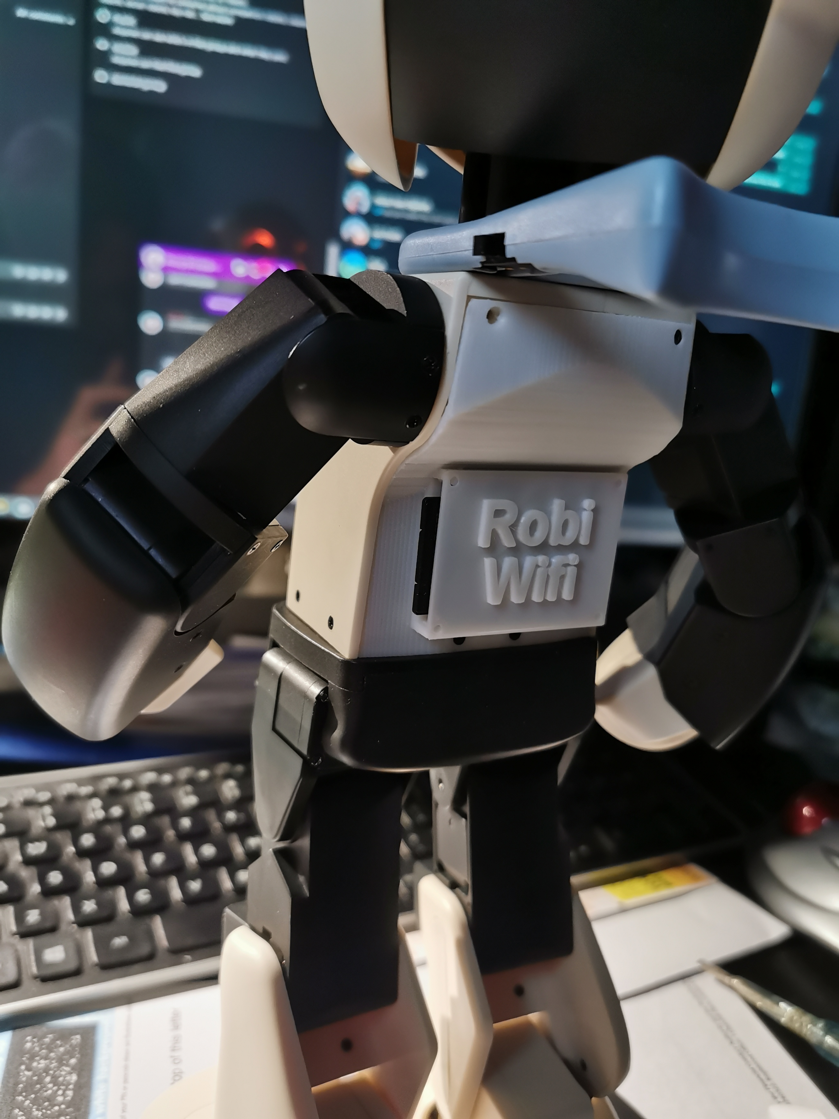

#11 Posted : 04 May 2021 16:06:10
Rank: Advanced Member
Joined: 17/04/2021
Posts: 34
Points: 105
Agreed - gotta keep him fairly well balanced.
I added the external card reader to his back, which hasn't changed his balance yet - Just got to be careful of the weight and placement I think.
Robi is not under warranty as he is very second hand (third hand in fact I think LOL).
Card reader pic below - it's meant for the Wi-Fi upgrade but works great for a standard 'Heart SD'
