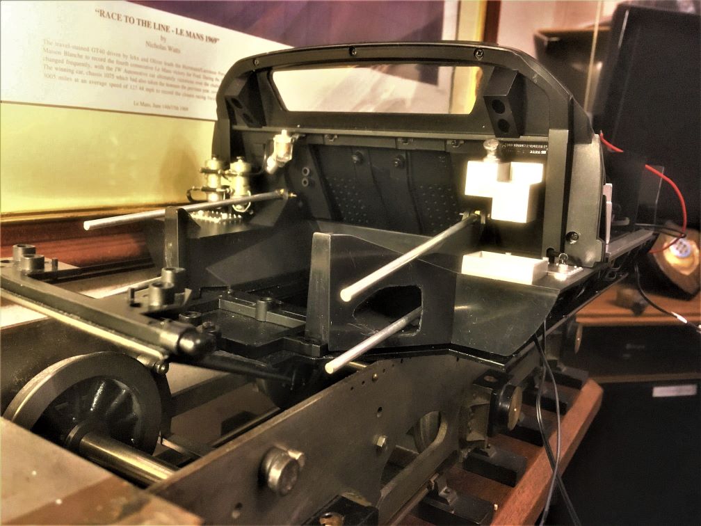

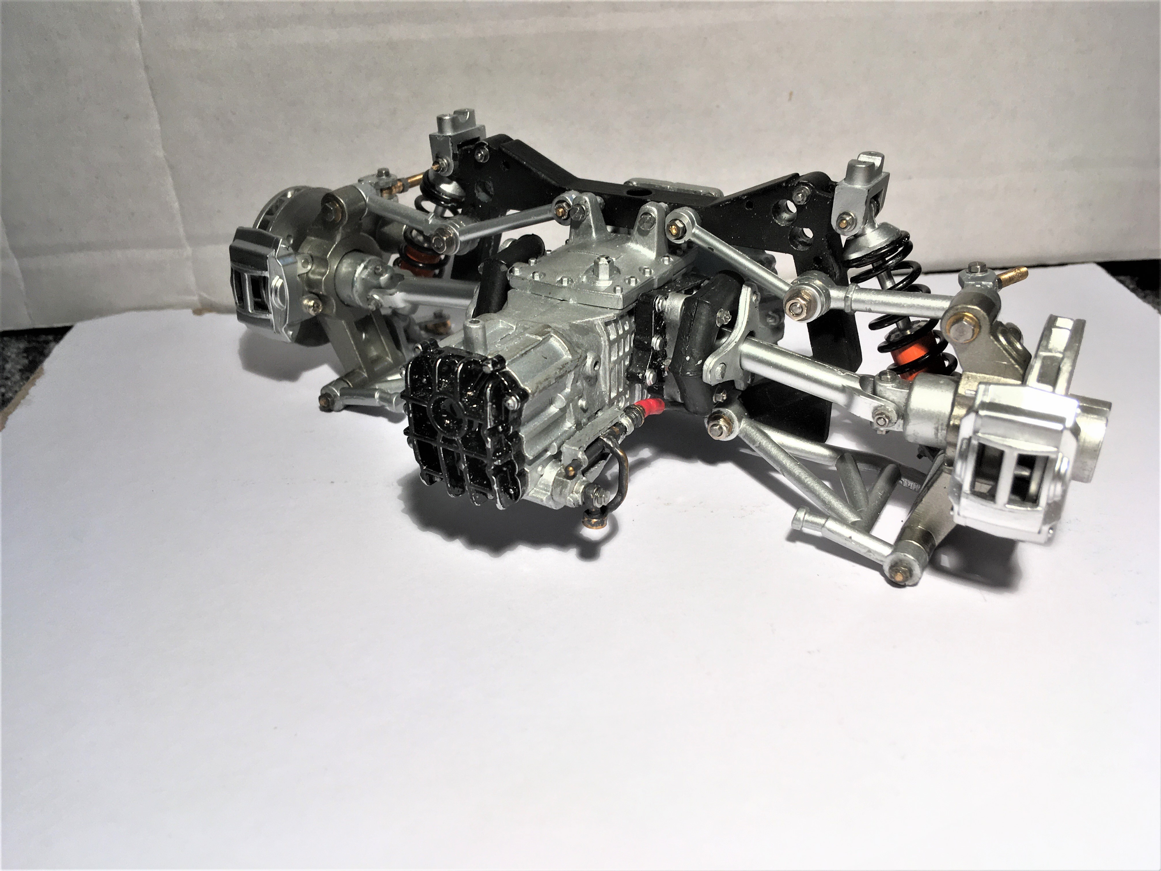

I have just part completed another modification to the GT40. I am not sure if you have noticed that the model has the lower radius rod has been omitted on the rear suspension. well I have managed to include the rods but I think the hardest part will be attaching them to the rear wheel uprights so I will have to cross that bridge when that pack arrives. It is difficult to plan these sort of modifications due to the lack of detail shown on the model overview. ]

Nicely done! I anticipate doing a lot of modding with this kit myself, so I look forward to seeing what you come up with to connect them.

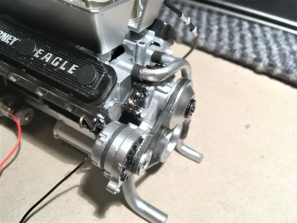

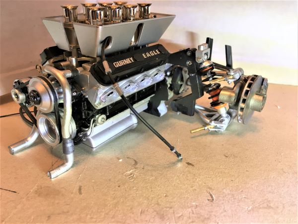

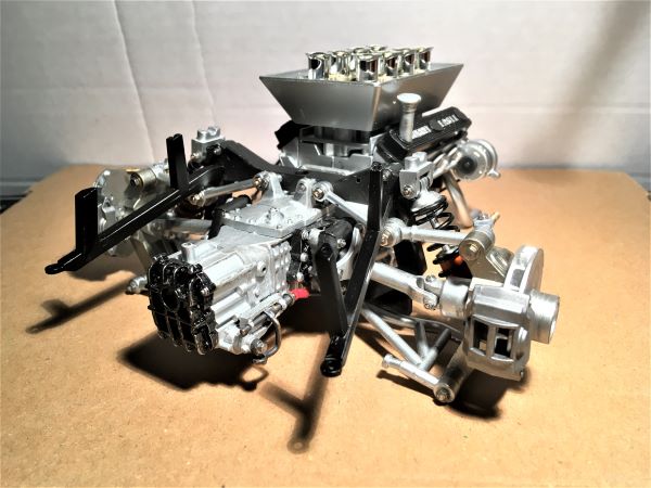

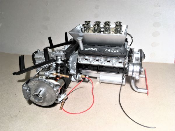

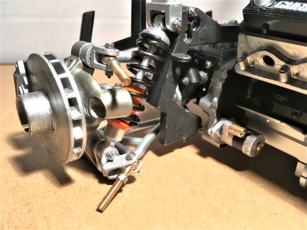

Just a few more small mods done. All the screws on the rear suspension changed for nuts and bolts, Gear change mechanism on gearbox now more realistic. Coil over shock absorbers altered, Starter motor made and fitted, Oil dip stick fitted, near side coolant water pipe removed and a "Y" pipe made up to run from the inlet manifold to the radiator and lastly a remote oil filter sandwich plate on the nearside of the engine block. I am also doing some modifications to the cylinder heads at the moment. It also looks as though I have an exhaust system to attempt to make as I can't believe what pack 19 will consists of. It is totally wrong to what was fitted to the original car and if I had known this when I ordered the model, I would not have gone ahead with it, so much for authenticity.

Could you please list the hardware sizes?

Jeff, as most of the attachment nuts used on the rear suspension 1/2" UNF and the dimension across the nut flats is .875" divided by 8 = .109 the nearest I could find to that 10 BA nut (.117") but the thread on the stud was to loose in the screw hole so I went down in size to 8 BA and made up small studs, screwed them into the chassis gear box mounting hoop to attache the top and bottom suspension arms, At the bottom of the hub upright I used a 12 BA threaded bar with a 12 BA nut at each end but it looked to small so I drilled an 8 BA nut out and glued it over the 12 BA nut. The top coil spring attachment is a 12 BA nut and bolt.
I have also used 12 BA nuts and bolts on the (6 off each side) Rotoflex couplings inner drive shafts.
The coil over shock absorbers I cut the piston rod off just below the upper spring seat drilled and tapped the upper portion 7 BA made a new piston rod up out of stainless steel and screwed it in to the upper portion and because this was now a much smaller diameter I made a alloy sleeve and glued it into the lower piston body and now they look as they should.
The oil filter/ cooler sandwich plate on the near side of the engine and the starter motor are both scratch built on the lathe the measurements I took from my own replica GT40 which may not be the same as 1075, and pipe work I used 12 BA nuts and 1.25mm piano wire and for the pipe work I used the outer casing of electrical wire with the copper strands removed, and lastly the modification I have done on the gear box cross shaft selector mechanism is as that type of gear box using the plastic part supplied and it is held on by a 12 BA nut and bolt.
I hope you can understand my ramblings Jeff but I used BA fasteners because I have plenty of them I am building a 3.5 Inch gauge Britannia class 7 steam locomotive 70013 OLIVER CROMWELL
Regards Brian.
