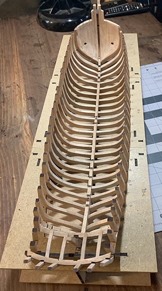

Haven't really had much in the way of complaints on this kit. The biggest issue I have found is that the drawings don't seem to be sized exactly correct. Each template has been just a tad oversized. The first couple times I thought it was a printing issue. But after the second fail I decided to open one of the templates with Adobe Illustrator and measure. Sure enough, the template was just a wee bit larger than reality. This was mostly noticeable when assembling the keel and stem. From bow to stern the template had gained 2.5mm over what the actual last cut pieces came out to be. Had there actually been a measuring guide on the templates, this could have easily been identified...print the template and measure the guide to ensure the print is correct. To get around this, I placed a 30mm guide in the template with Adobe Illustrator and then printed it again. Yep, the print out was good and the guide measured 30mm. But once again, the keel/stem length was oversized by 2.5mm.
I thought at first to adjust for this by adding 1mm filler in the keel joints. But then it dawned on me that I may be making things worse. Instead I checked the templates for the ribs and found the same issue existed. The width of the rib was about 1mm off and the height of the rib was about 1mm off. This is when I decided to go with what the laser cut parts were telling me...make things a wee bit smaller than the template. Five months later, and I am glad I did...things are fitting into place nicely.

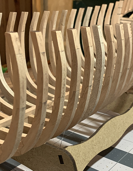

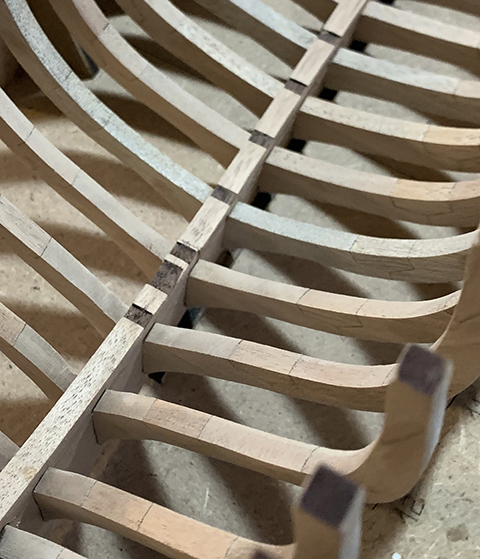

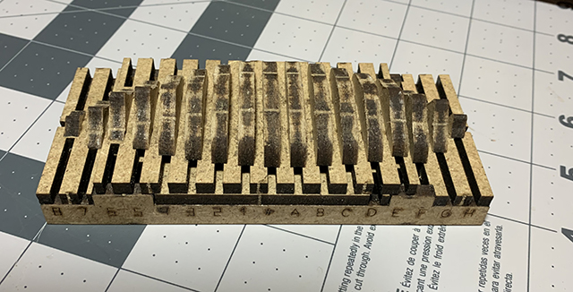

Overall, the past several months have been more repetitive than anything else. Don't get me wrong, enjoying it a lot as I find this sort of thing relaxing. Just mean that there isn't much in the way of "here is what I did" for the first few months since it is mostly building a dry dock and assembling a load of ribs.
Again, I was looking to really make this build stand out as there isn't much ability to hide anything as there is limited planking and the like. For each rib I was very meticulous in getting the pieces assembled and cleaned up as nicely as possible. This took quite a bit of time.
First off, I did not clean the char from the edges as I wanted the seams to come through a bit. In the few areas that I did need to clean the char I came back in with a pencil and added some color back.
Shaping was done with the paper template. The first one I adhered the paper to the rib but removing it was a pain...mostly ensuring all the adhesive was removed. Having learned from that first attempt, for all the remaining ribs that needed shaping I simply traced the template onto the rib...much better results.
To take the wood down to shape on the ribs I used a Dremel with a fine grit sanding drum (220). I didn't want to be too aggressive and instead let the drum do the work. Sure, it took a bit longer, but in the end there was less error as coarser sanding can get out of hand quite quickly. I also had the Dremel set to the lowest speed to make sure I retained full control.
After shaping I went back in with some 220 grit and hand sanded...using my fingertips to feel out any bumps or imperfections. Following that, I used 320 to get a nice clean finish. I think the ribs have turned out very well. I have not yet sanded the exterior of the ribs to perfect as I figure I will need to shape them once I place some test planks along the hull.

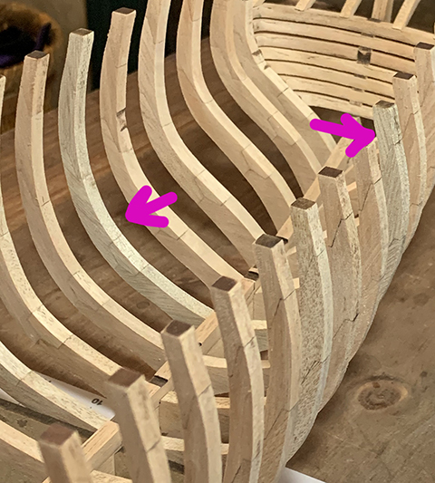

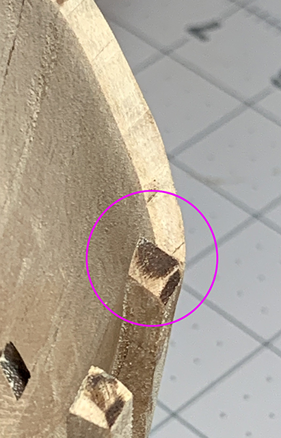

The supplied wood for the ribs has been pretty solid. There are a couple that have a graying tint and the grain is more speckled than the other ribs (arrows below). Not sure how this will turn out once I apply some wipe on poly, but after some thought figured I would go with it. Once all the ribs were in place it wasn't as distracting as I had originally thought.
tenderfoot attached the following image(s):

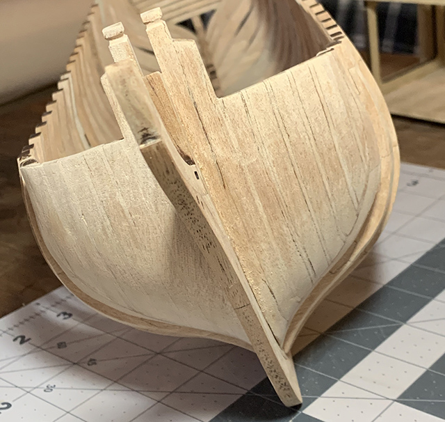

As I stated in Medric's HMS Bounty build diary (everyone should check it out), the hawse has been the most difficult part to date. I had already shaped Rib L and the starboard hawse when I read ahead in the instructions and learned that the two pieces marry up. When I dry fitted them I was not fortunate enough for such a marrying. However, it wasn't too bad. Instead of starting over on the hawse (not too keen on cutting all those pieces on a jigsaw) I decided to fudge it a bit, choosing to let the inside edge of the hawse not quite match with the rib, but ensuring the outside matched perfectly. After looking at images of the final build it became apparent that this portion of the inner hull will not be visible so little harm done. However, I, and everyone here, will know it isn't right...let's keep that our little secret.

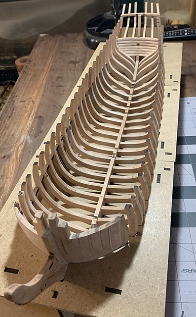

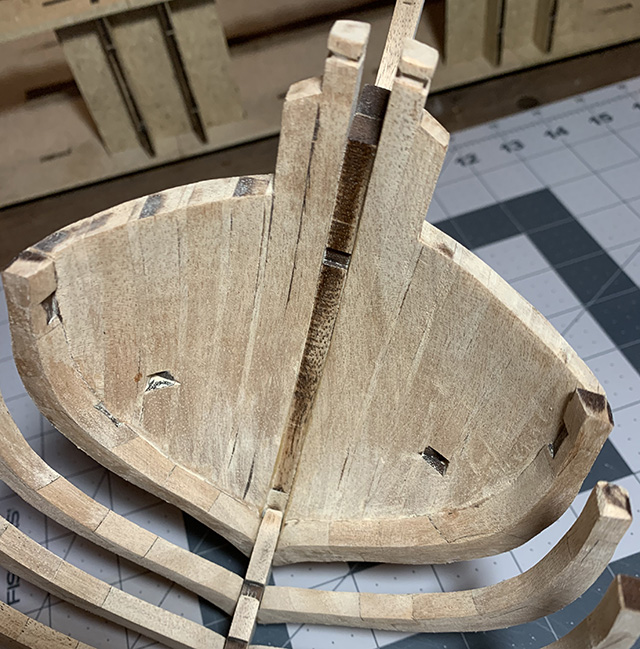

As for the rest of the bow section, it came out quite nicely. I still want to polish it up a bit with some 320 grit before I call it good, but here it is as it currently stands. I tend to eyeball the contours to ensure they are balanced on both ends rather than trying to measure in some complicated fashion. My eyeballs have served me well the last couple years when doing this. It is amazing how the eye can detect such small variances. Sometime I pick up differences that are less than 1mm. Got to enjoy that now as it is likely my eyesight will fade in the coming years - not that they have started, just know it is expected as one ages.

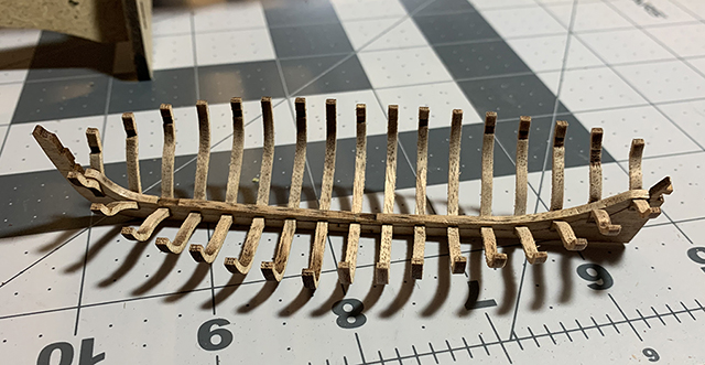

As I await the next subscription (will be a couple weeks) I decided to go ahead with the skiff, or whatever it's called (I'm still learning). My lord, the ribs are teeny little things. Trying to clean the char from the edges was quite a bit of work as you can't be aggressive at all...one wrong move and SNAP! Little bit goes flying and you find yourself crawling on the floor in the hopes of finding the bit before the dog does. The image below shows that although I was able to remove the char, about 10% or so remains. I must admit that no matter how careful I was I still managed to snap 3 ribs. Thankfully, they went back together quite easily. Because of their frail nature I decided not to try to get the char 100% off - basically calling it a win before I did some serious damage.

For the life of me I could not find any use for this thing. Found that it would take some modification to work effectively as the keel doesn't fit length wise - the keel slots at each end of the jig are just a wee bit further apart than the inside measure of the keel. Also, couple of the ribs just didn't line up quite right. In the end I assembled just as I would any keel and bulkhead build, just carefully glued each rib in place, ensuring it was square to the deck and eyeballed for accuracy. Honestly, it was easy enough to get the ribs in place that the jig is not needed. However, to each their own.

Your picture in post #10 is exactly what I needed to see. What a wonderful thing to have seen at this point. Oh, and by the way, expect your eyes to make a dramatic departure from normal, in the wrong direction, as you get older. Mine certainly have. I would be lost without my several different magnifying glasses. I have a Dremel and the temptation is strong but I have a tendency to get careless with it so I'm trying to keep myself in check. I can certainly see that you know how to use yours to good effect. Your HMS Bounty is exquisite.
