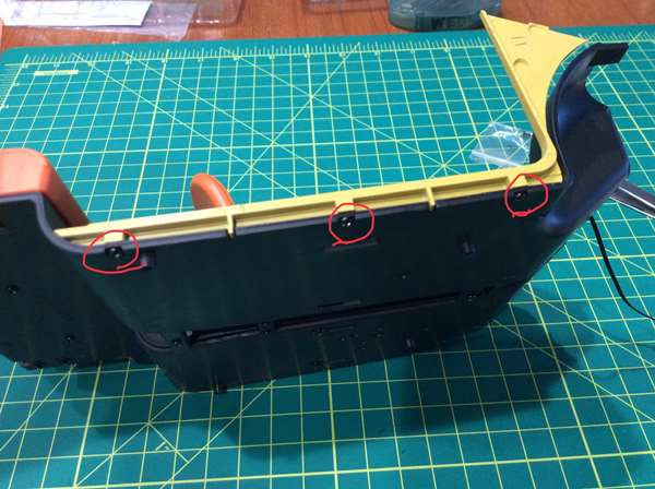

Stage 51; Left side inner trim
Mount the left inner trim with 3CP screws. Place the roof cover mount into position and secure with 2CP screws.

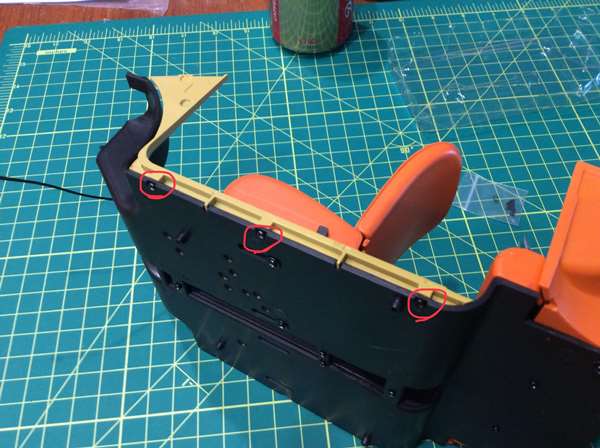

Stage 52 ;Right side inner trim
Mount the right side same as the left. Install the left front hinge as shown with a GP screw.

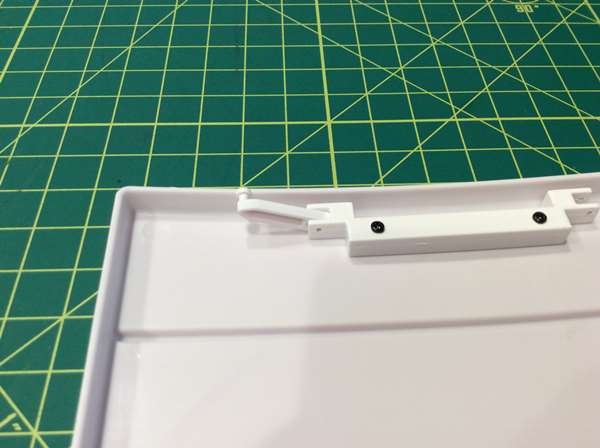

Stage 53; Boot opening lever
Join the boot lever and the boot hinge with a DP screw. Put the other roof cover on as shown with a GP screw.
Stage 54; Front bulkhead
Mount the lever hinge to the bulkhead with a KP screw from the underside. I decided to put the right hinge cover and the roof cover front hinge together, but I will tape it and the mounting screws to the Caravan top until the other front hinge is to be mounted in the next Pack.
