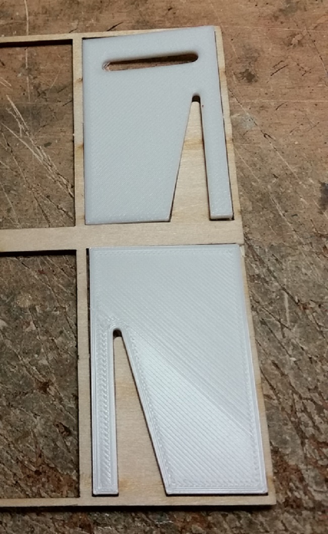

As a beginner to 3D printing and having just about got my head around the basics of the design process, I thought I`d try something a bit more complex.
I recently bought a ship modellers deadeye rigging jig made from ply (2mm thick) and wondered how well 3D printing could reproduce the same item.
Please note that this thread is just an explanation of how to change an item from being made in plywood to 3Dprinted PLA.
I have taken the measurements from the ply fret and made two of the twelve parts.
When/if I manage to make all the parts Blink , I have a plan to improve the strength/stability of the holding frame to avoid the overtightening of the rigging causing distortion issues of the jig.
If it all works then the only extra cost to me will be a square neck bolt, washer and wingnut.
The two parts made are not 100% bang on to the fret (99.9% Blushing ), but will not affect the operation of the jig.
So two pics:
1) The two parts laid on the fret.
2) The two parts laid in front of the ply jig.
Like I say this is the first attempt at something a little more than a basic shape, so will see how it comes out. Blink Blink

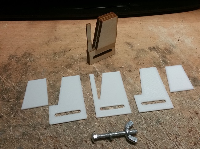

So today I made the next four parts. These are fixed either side of the first two parts. Obviously the slotted parts go either side of the first slotted parts and the same with the non-slotted parts.
I will do a construction of the full jig if/when I get all the parts made, but its looking good so far that I can complete the whole thing.Blink
Today`s progress is attached below.

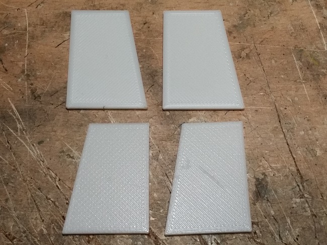

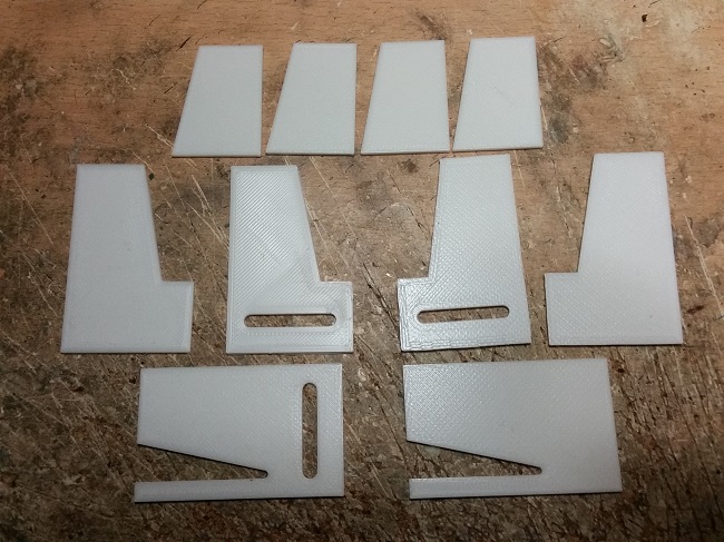

Thanks Alan/Trev for your comments, appreciated as always. Cool Cool Cool

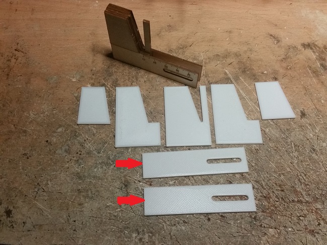

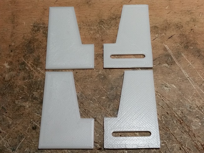

Today I`ve made four more parts. The great thing with this 3D printing thing is that if you need four identical parts (as in this case) you design one and load it four times into the slicer programme prior to printing and its job done. Four identical parts.ThumpUp ThumpUp
So ten parts down and two to go, then I can make my own extra parts to improve the design, so that when in use the jig will be more stable.
Pic 1: the four new parts
Pic 2: the ten out of twelve parts made so far.
So far an enjoyable project that has enhanced my understanding of 3D printing. May have to find something more technical for the next idea/project. Blink

#10 Posted : 23 March 2021 15:50:50
Thanks for looking in Goddo. BigGrin
So here`s the next update on the "Deadeye" jig.
I`ve now printed the last two main parts of the jig. (arrowed in the first pic)
The first pic shows the parts for one half of the jig and the second pic shows the other half.
You will note from the pics that the ply version has a measurement scale on it, where the 3D printed version does not. The reason will become apparent when I`ve assembled the jig parts and made the additional parts I will be printing.
More on that later.

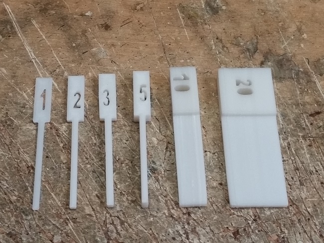

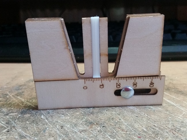

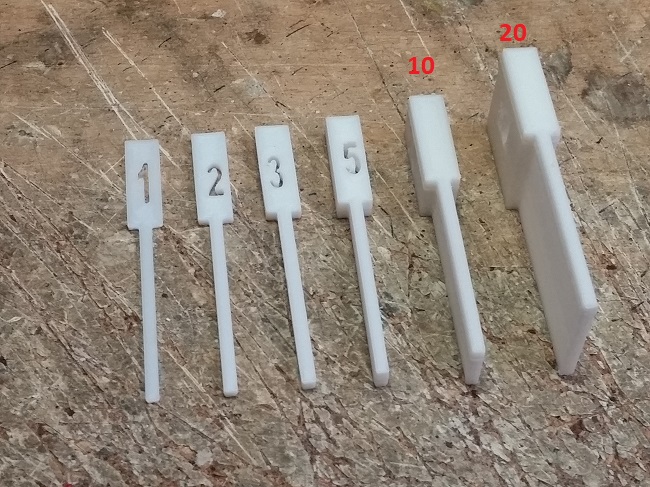

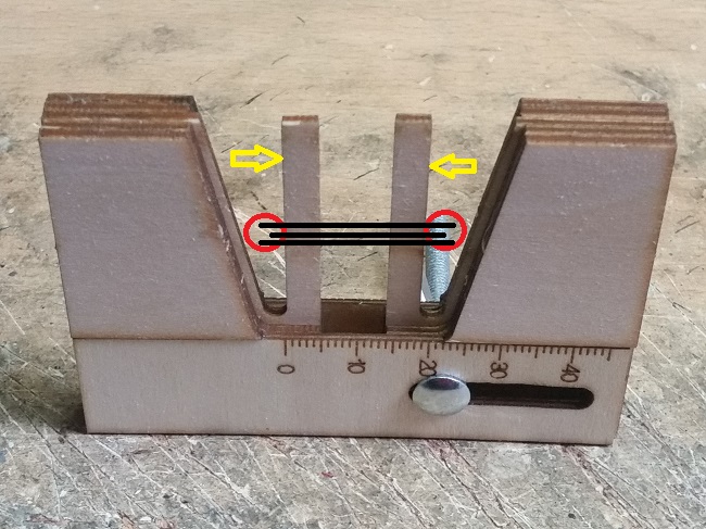

Having reproduced all the parts of the jig, I have turned my attention to the spacers so you can get a bigger gap between the dead eyes.
Pic 1: Shows the original plywood jig. Two red circles show where the deadeyes would sit and three black lines show the rigging thread. My concern was that if you pulled the rigging thread too tight you could put too much pressure on the jig as shown by the direction of the yellow arrows.
So my solution was to make solid spacers to stop the possibility of bending/snapping the central parts of the jig.
I calculated that there would be a need for 1mm, 2mm, 3mm, 5mm, 10mm and 20mm spacers so that with a combination of various spacers you could make any distance from 10mm to 40mm between two deadeyes.
Pic 2: Shows the spacers in their usable orientation.
Pic 3: Shows the spacers with their size numbers visible.
Pics 4 and 5: Show the 5mm and 20mm spacers in use.
Any questions, then with my limited knowledge of 3D printing I`ll try to help with an answer.
This has been a fun project in my learning curve to 3D printing.BigGrin

Next job is to assemble the new PLA printed jig.
As I`ve not perfected the art of 3D printing nuts and bolts (Yet) I`m waiting for a couple to arrive to complete the jig and then there`s a bit of a surprise coming. You`ll see what that is when it happens. (Will only be a short wait - I hope).

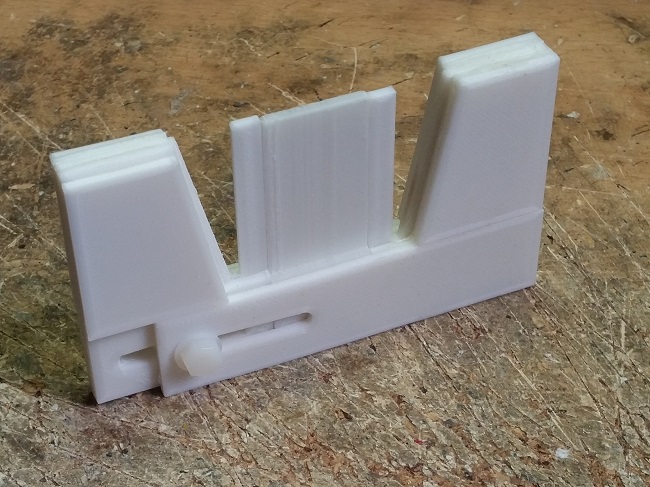

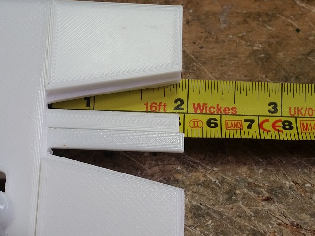

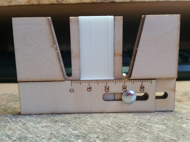

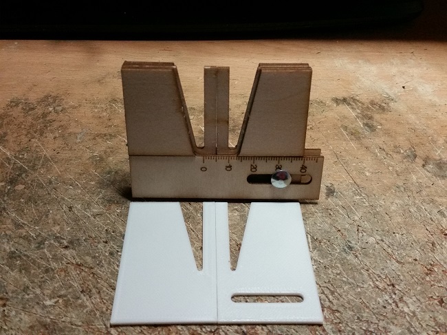

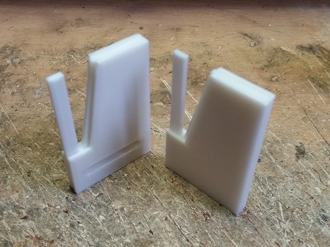

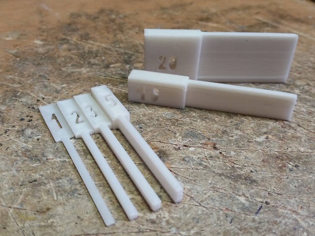

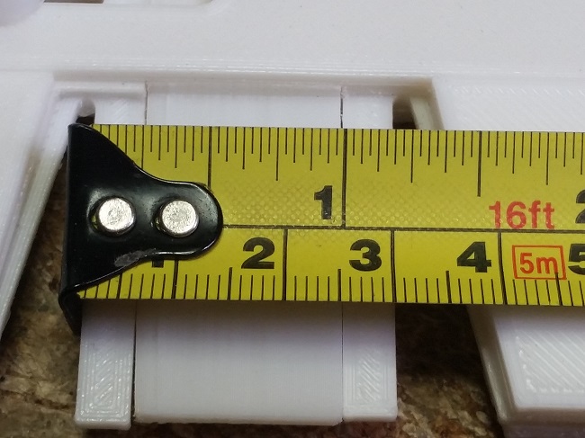

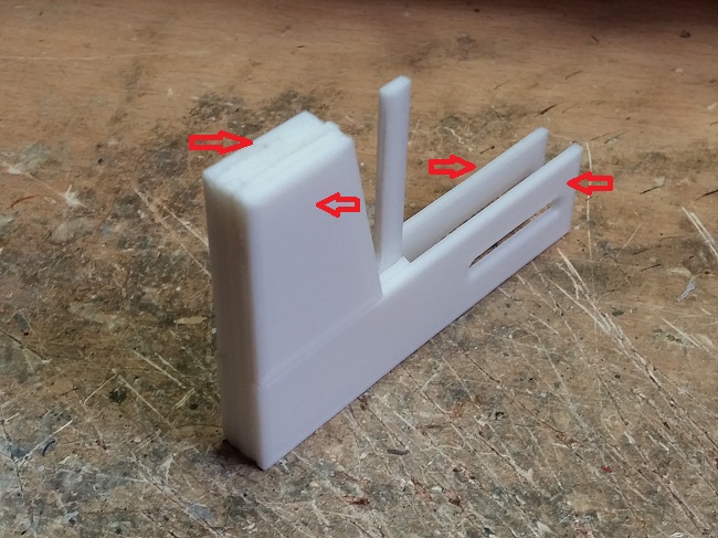

Well here`s the final episode from me. BigGrin
Pic 1: the construction begins with the three centre plates from each end glued together. (Super glue works just fine)
Pic 2: two long plates that hold the two ends together and two top side plates added.
Pic 3: Added the sliding end of the jig (not gluedLOL )
Pic 4: Blushing Blushing found an error in my measurements. A 1mm slip in the measurements for the slots, so the moving end of the jig sits 1mm higher than it should. I`ve left it as is, as I don`t think it will make a noticeable difference and it can be adjusted in the design stage if I were to ever print another one.
Pic 5: completed assembly with the 20mm spacer in situ.
Pic 6: nicely accurate. 20mm spacer and the the two 5mm vertical plates = 30mm.
Pic 7: all the included spacers.
So, apart from the small error in the slot location that`s a jig transformed from ply to PLA filament 3D printed.
The completed item is now on its way for an independent review from one of our forum ship builders, who has told me that a review will be posted.
I don`t have a ship at the rigging stage to test it, so I await the review with interest.
So that concludes my Ply to PLA test.
