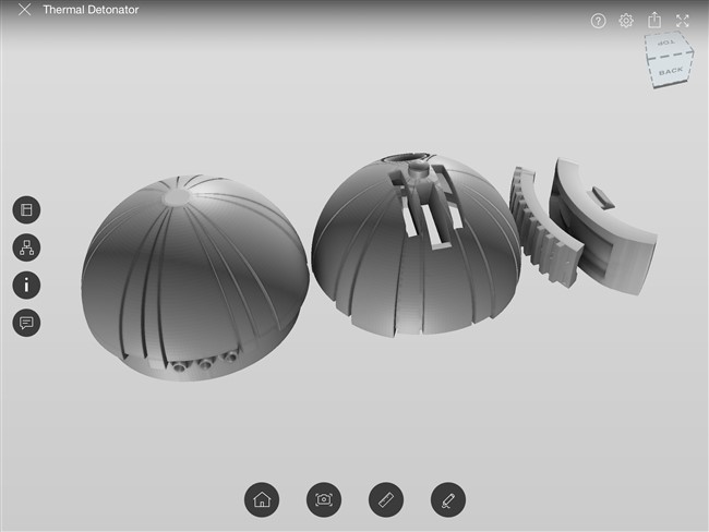

The 3D model I have shown is a file I found readily available on the internet to have a go at printing. I have downloaded a 3D modelling program on my computer, so I can delve at making and designing my own models.

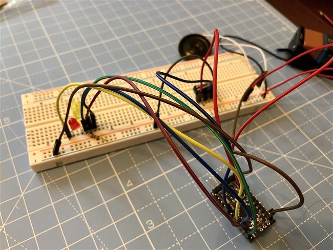

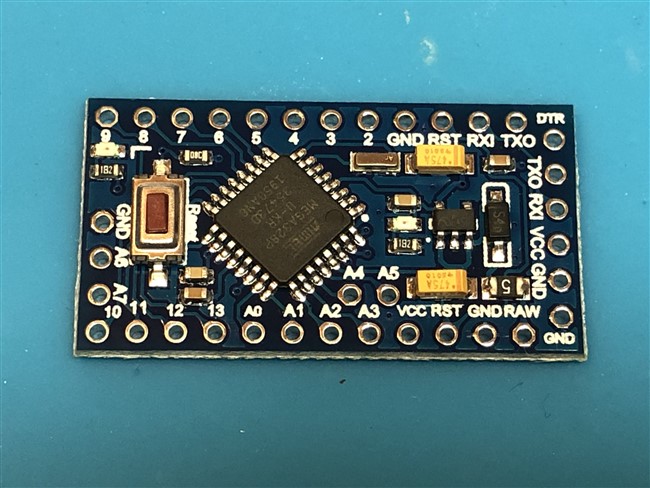

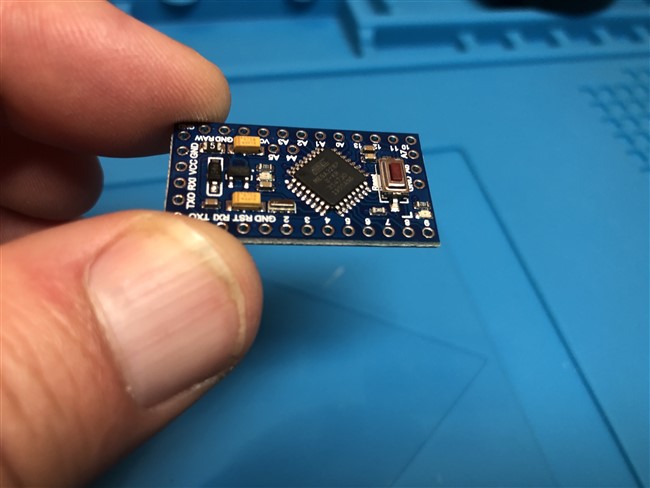

Anyway, to the project. I have finally after several days, loaded up a code to the Pro mini board to operate the sound and lighting. The board I chosen had to be small to fit into the model on its final assembly. I was going to use an Arduino nano, similar in size and easier to load the code, but found it would not handle the sound effects as it doesn’t have a DAC on board, Digital to Analog Convertor, whereas the pro mini does. If this sounds all to complicated, believe me, it was all gobbledegook to me too, but I learn fast.Flapper
The pictures show the board and the final test setup once the code was uploaded up to the Pro mini. I have also put a small video clip of it working.

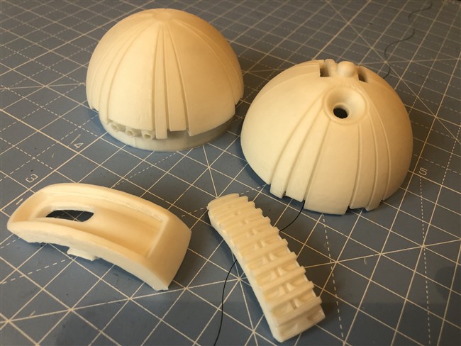

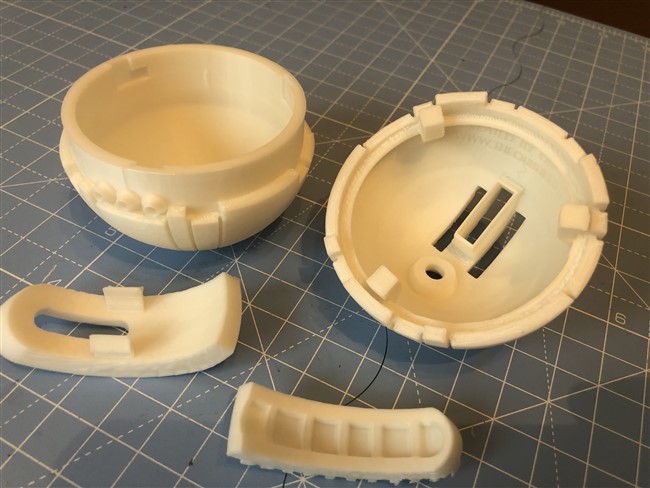

I have now made up the 3d printer and spent a day and a half sorting out the software to use after a little guidance from Andreas. I made some 3d prints from the memory stick that came with the printer to make sure I had everything setup okay. Then I decided to have ago myself through the software I downloaded. First, was a test print of baby Yoda (Grogu) from the Mandalorian. This was printed at a third of the original sized file. I couldn’t resist painting him afterwards and even added some hair from a cotton bud. Picture attached.
Anyway, as I said in my last post, I acquired some STL files for the thermal detonator after looking at all the different variants that are around.
It has taken a couple of days to print and I separated all the individual pieces on the original file as I thought it best to print them separately.
So, the detonator is all printed up, just some sanding down to make it very smooth, but first impressions are that the print quality is excellent.
Next, I will now attempt to design the inside to hold all the electronic in place and to hold a 9v rechargeable battery via USB.

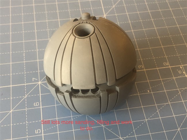

I have now started sanding down the domes. They will need a lot more sanding to be very smooth as these will be painted a nice shiny chrome colour. Before doing all of that, I have been designing some internal parts to fit all the electronics in. I wanted it all to fit neatly as well as being able to access the battery to change or re-charge. After drawing and measuring, I came up with these as shown in the pictures below. The speaker is on the bottom of the battery box and a kill switch on the side, this is to stop the battery draining when not in use. The top part is to hold the Arduino board in place as well as being removable to access the battery. One thing I did have to do was to dremel the locking taps out as the internal parts got in the way. It shouldn’t have an effect on the two halve fitting together as they are quite a tight fit anyway.
Now to start sanding the domes down to their nth degree.Cool

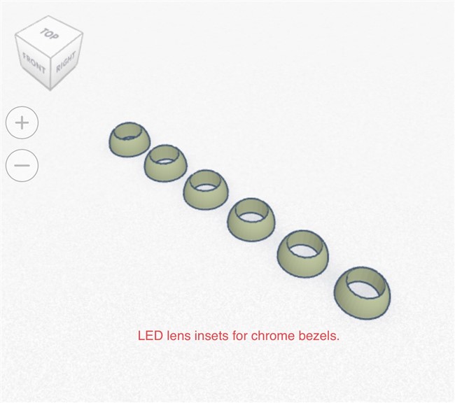

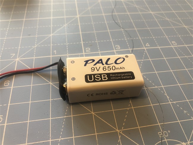

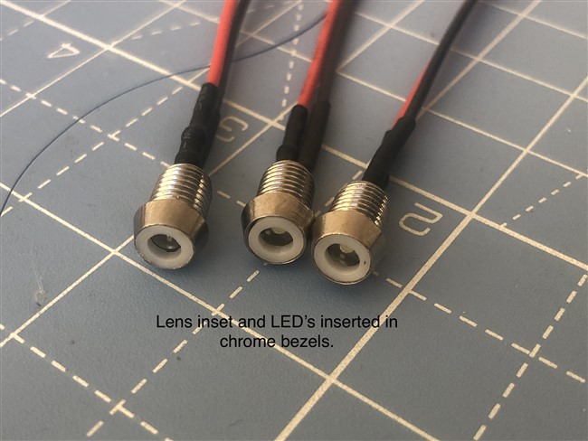

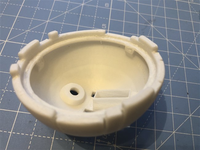

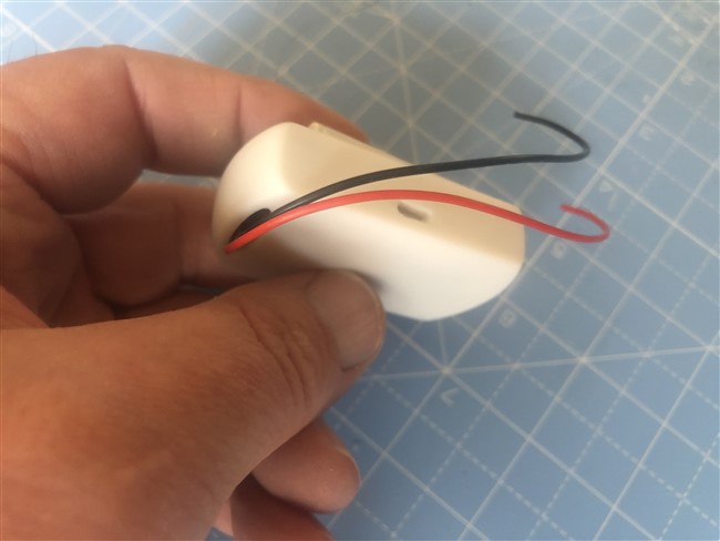

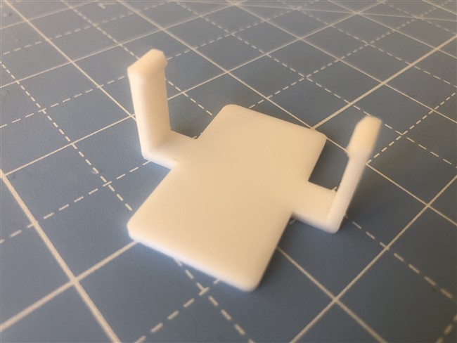

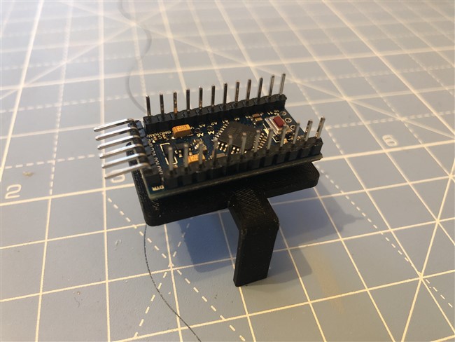

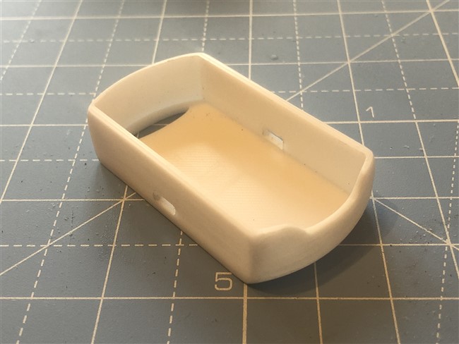

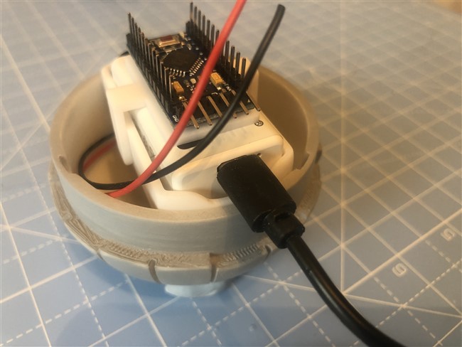

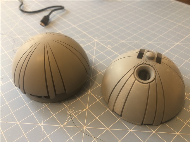

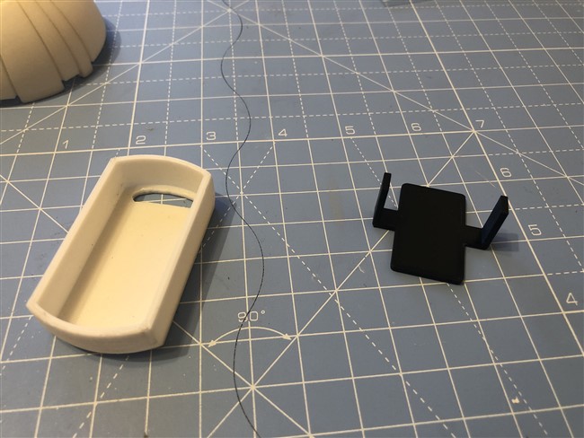

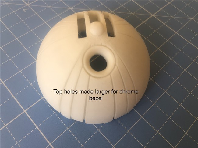

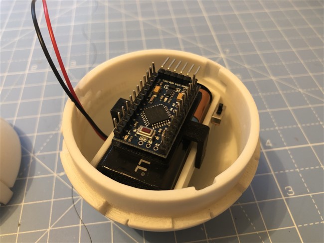

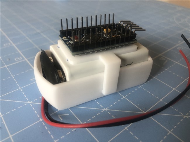

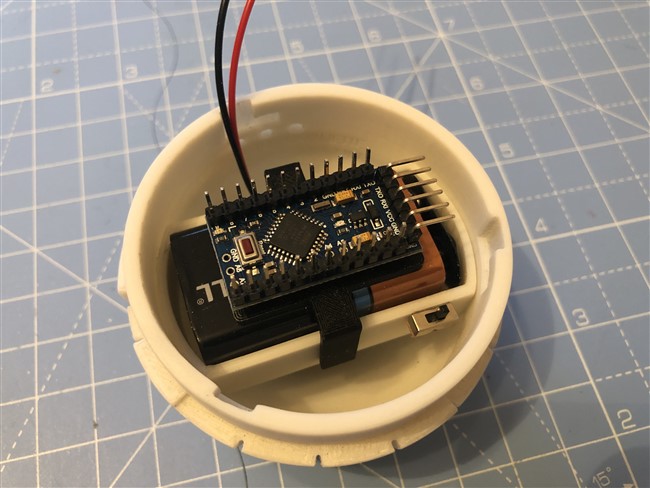

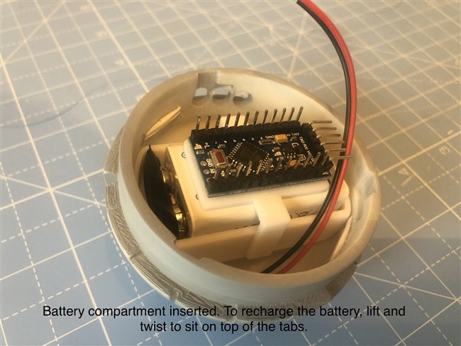

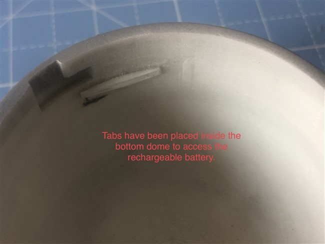

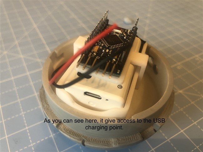

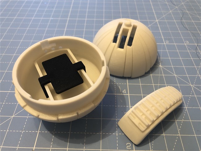

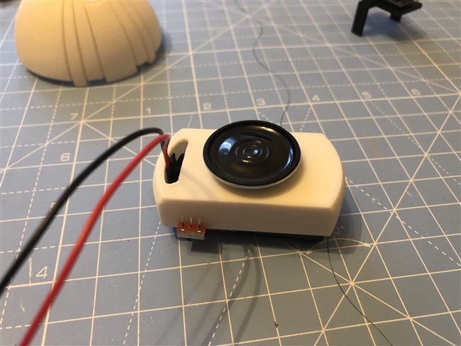

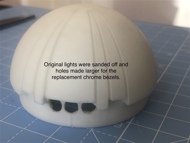

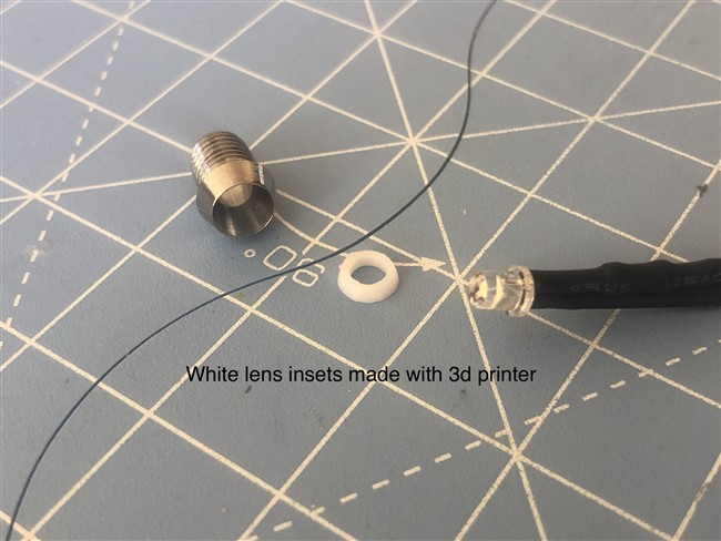

I have decided that the existing lights on the bottom dome didn’t look right to me, so I have sanded them off with a Dremel and made the holes larger. I will then insert some real metal chrome bezels that will give a more realistic feel and more accurate to the original screen version.
As you can see, I have been tinkering with the electronics holder. The battery compartment is version 4, now to accommodate a rechargeable battery that I will be using. The top cap now has locking tabs to hold everything in place. See the pictures below.
The main dome parts have had their initial sanding down and primed to see the areas that need filling. Shouldn’t need too much as the domes are pretty smooth already.
More soon.
