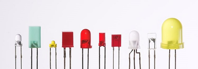

Through the hole LEDS

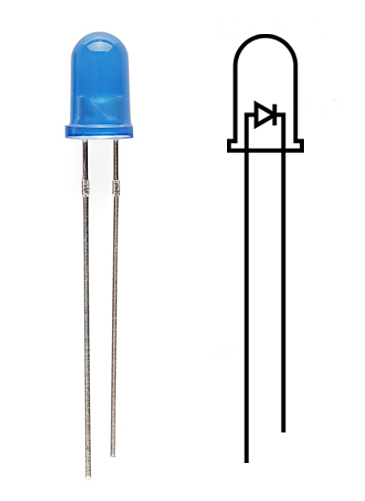

These are the commonest form of LED and the easiest to use.They come in a variety of sizes from 1.8 mm up to 10mm in diameter.The commonest shape is cylindrical, but there are other shapes such as rectangular and lighthouse. They come with a clear casing for non diffused LEDS and colored casing for diffused LEDs.For single color LEDs there are 2 wires coming out of ther LED.The longer wire is usually the anode (positive) and the shorter wire is the cathode (negative).
LEDs are current resisted which means you need to add a resistor to the anode of the LED to reduce the current flowing through the LED.The forward resistance of the LED is determined by thew size of the LED.The larger the LED the larger a forward current it can handle.The forward voltage of the LED is determined by the color of the led, not the size.Red LEDs have a low forward voltage (around 2v) and blue LEDS have a higher forward voltage (3.4v).
So every RED led has a forward voltage of 1.8-2.2V, but a 5mm red LED may have a forward current on 150ma wheras a 3mm red LED may have a forward current of 20ma.

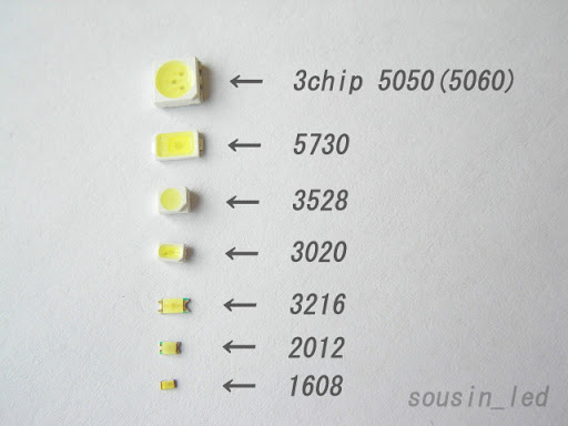

SMD (surface mount diode) LEDs
SMD LEDS were designed to be soldered directly onto printed circuit boards.They are very very small and bright.Thye are perfect for lighting models where you have very limited space. You can buy them in bulk with no wires , but be warned soldering wires onto SMD LEDs is quite challenging. The best opiton is to buy prewired SMD LEDS.
SMD LEDs some in a variety of sizes, but be warned it is VERY confusing with 2 different kinds of number classifications.Again the ones that are prewired are preferable and many vendors classify them according to size ranging from 0.6 mm to 5mm. Most of the prewired SMD LEDs have resistors already attached-You just have to select the ones with the correct voltage rating for your project.

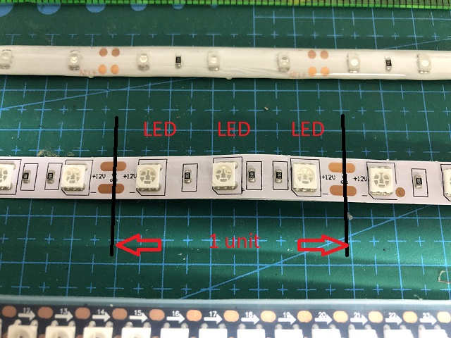

LED strips are basically a bunch of SMD LEDS wired together in parallel with resistors. They are great for lighting large areas and they are very efficient because you can connect many LEDs with just 2 wires. They usually require 12V DC.
A good use of LED strips would be to light the engine of the Millenium Falcon or light the interior of the secondary hull of the USS Enterprise.
There are tons of kinds of LED strips available.Some are designed to put on cars and some are for accent lighting.You want the ones that use DC current, not AC.They come in a variety of colors and brightness levels.As we already discussed SMD LED come in different sizes.If the LED strip is made from small SMD LEDs the strip wont be very bright.If they are made with large SMD LEDS they will be much brighter.
LED strips also come in different denisty of LEDs. They are usually labelled as the number of SMD LEDS per meter. The standard LED strips have 30 SMD LEDS per metre.High denisty LED strips have 60 SMD LEDS per meter.Obivously the high density LED strips provide far more light because you have twice as many SMD LEDs per metre length.
LED strips usually come in 1 metre lengths, but they can be cut to size .However, there are only certain areas where you can cut the strip .Each LED strip is split into groups of 3 SMD LEDS with copper connectors to connect to the groups together.When you cut the strip you must cut at the copper connectors (black lines on the photo).This way you can cut the 1 metre strip into smaller parts.All you then need to do is solder a positive and negative wire to the copper tabs.
The major disadvantage of LED strips is power consumption.IF you have a long strip of SMD LEDs they will need quite a bit of current and may drain a battery (especially a 9v battery) very quickly. Thye also require 12V so you may need a voltage regulator to step up the incoming voltage to power.

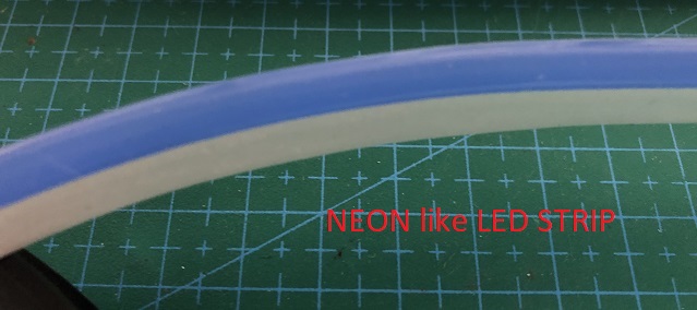

The third photo shows a picture of a LED strip that has a diffuser incorporated into the backing strip.These are meant to simulate NEON lights and are really good if you need a diffused light source. When you light up an LED strip you will see the individual SMD LEDs as ppoints of light.If you then put this into a model like a nacelle on a USS Enterprise you wont see a uniform glow, but several hot spots of light.There are techniques to diffuse the light as Mark already showed and I will show some more when I build a Star trek Deep Sapce Nine Runabout.However, if you use the LED strips with the diffuser cover you will get a smooth uniform light source you wont need to diffuse the strip.

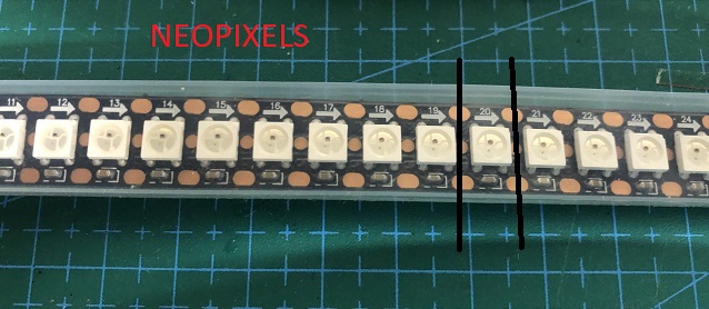

Finally I want to mention NEOPIXELS.There are a special form of LED strip.With a regular LED strip when you power up the strip all of the leds light up.With a neopixel strip you can light each LED individually and even control the color and brightness of each LED.The individual SMD LED are addressible.This means that with a microcontroller you can turn individual LEDs off and on and make sophisticaed lighting effects. A good use for neopixels would be to make the light on the fornt of the KITT car from Knightrider, or the Cylon raider helmet.
NEOPIXELS are quite expensive and they are complicated to program and they require a LOT of current

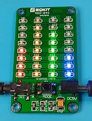

RGB LEDS
These are basically 3LEDs in one casing .They have 4 wires.One for each of the red,green and blue cathodes and a common anode.You can vary the brightness of each individual color to make any color you want.RGB LEDs usually require a microcontroller to control them.

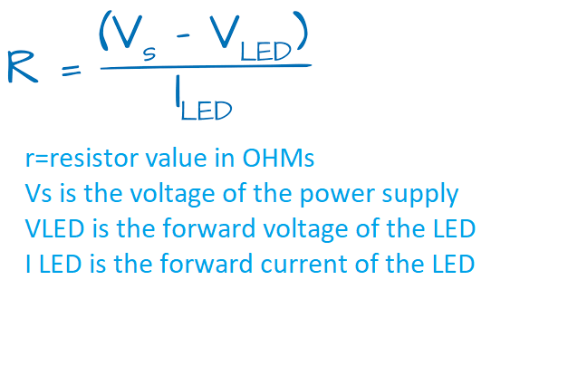

Current limiting resistors
Regardless of which type of circuit you use you will also need to put current limiting resistors into your circuit to drop the current output of the power supply to the forward resistance of the LED. You can simply buy LEDS that have resistors prewired.IF you want to do it yourself you will need to use a calculator to determine the resistor value .There are tons of calculators online. The equation you use is based on Ohms law. here is a link to the calculation;
https://ohmslawcalculato...led-resistor-calculator
Ohms law states that the value of the resistor is the voltage of the power supply- the forward voltage of the LED divided by the forward resistance of the LED.

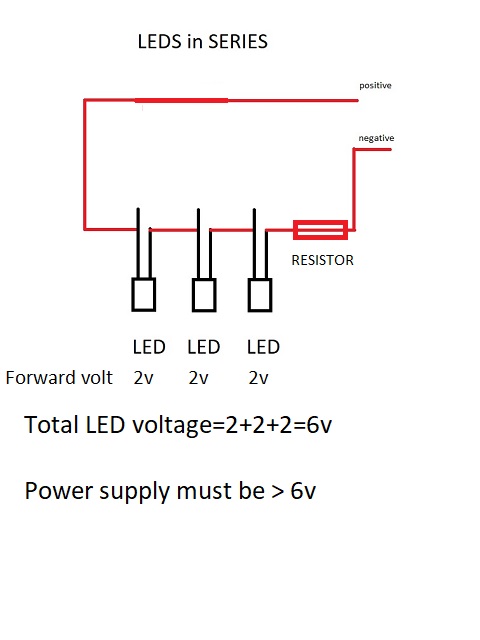

Wiring LEDs in series is very simple.You connect the anode of the first led to the positive from the power supply.You then connect the cathode from the first LED to the anode of the second LED and so on.... LEDS in series are great for very tight spaces where you dont have much room for wires.You need to add the current resisting resitor to the circuit.It doesnt matter if you put the resistor on the anode side or cathode side of the circuit.
In series ciruits each LED gets the same current so they will all be the same brightness.The voltage is divided between the LEDS. The practical upshot of this is that the power supply voltage MUST be larger than the sum of the forward voltages of the LEDs.This is a significant problem in many cases because generally we use fairly low voltage pwoer supplies for models.Even if you use a 12V DC pwoer supply you cannot use more than 6 red LEDS in the series circuit because when we add the forward voltage of the 6 leds we get 12V.

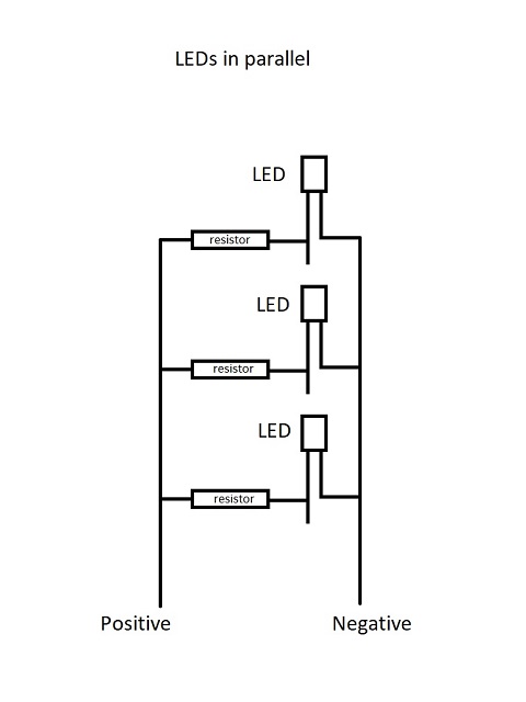

LEDS in parallel
Wiring LEDS in parallel is a bit more complicated and you need more wires because each LED has to be connected to the positive and negative. In parallel circuits all of the LEDs receive the same voltage and the current is divided between the LEDs.This the opposite of series circuits.
You also still need current limiting resistors.In parallel circuits each LED should have its own resistor .You may be tempted to just put one current limiting resistor like in the series circuit.It may work, but you will get current fluctuations between the LED and varying brightness of the individual LEDs.
The main benefit of the parallel circuit is you can have many more LEDs than with a series circuit. Since we are dividing current and each LED only draws 20ma we can potentially add far more LEDS. Even if you use a 9V battery with 750maH current rating you could power 37 LEDs for 1 one hour (750mah/20ma).
In some large models you may have several dozen LEDs and/or LED strips.You may not have enough current for all of these LEDs.In this situation you can use a circuit called an LED driver board.LED driver boards can manage hundreds of LEDs and they draw much less current than parallel circuits.
I almost always use LEDs is parallel for my lighting circuits.
