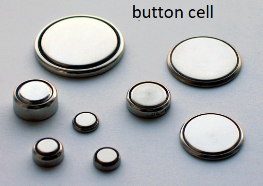

Button cell batteries provide 3v output and carying current from 25mA up to more than 1000 mA.Thye are perfect for very small models and circuits that dont draw a lot of current.

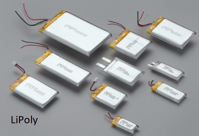

Lipoly batteries
The newest kind of battery are the lipoly and Li-ion batteries.These are very popular in RC models because they have a very high capacity and can provide a lot of current.They can be quite dangerous though if not handled properly and can even set on fire if they are damaged.They also require special chargers and you need to monitor their volatge very carefully because if you let tghe volatge get too low you wont be able to recharge them.Unless you need a very high current discharge rate or you need a powerful battery in a small model I would not use a Lipo battery.

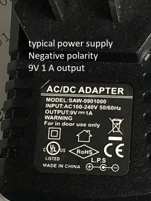

In USA you can look at the back of the power supply for some symbols to help.I am not sure if it is the same in UK, but if it isnt you can use the second method .

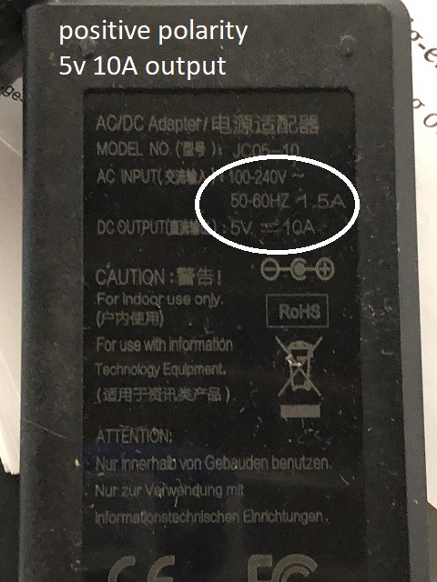

The back of the power supply will have the input voltage (100-240V) ;

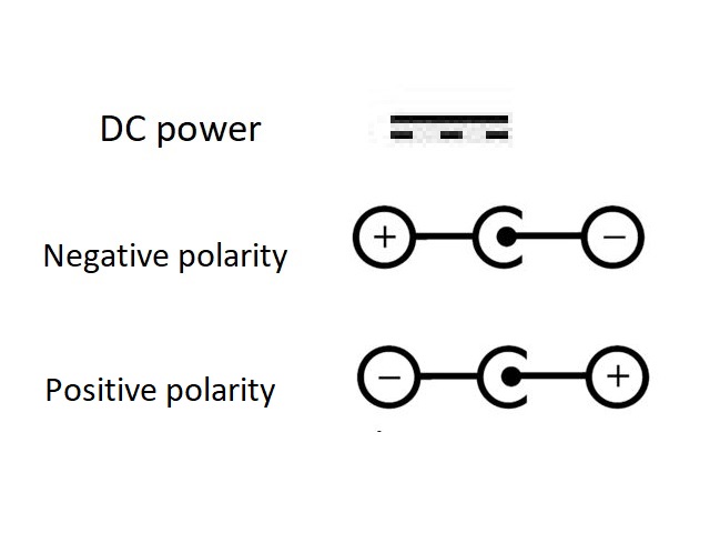

Underneath that should be the OUTPUT voltage and max current (CD +12v 5A).The symbol for DC power is a long line with 3 shorter lines underneath.
The next symbol consists of 3 circles.There is a dot in the center circle and a "-" in one circle and a "+" in the other.This symbol tells you the polarity of the power supply.IF the plus is in the right circle the power supply is positive polarity.

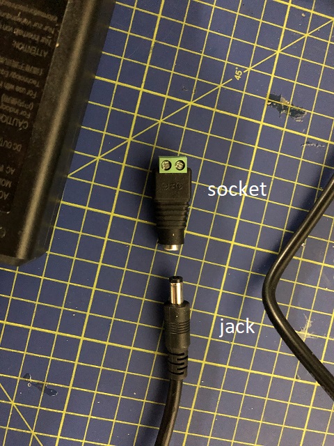

When we say positive polarity what that means is the tip of the output jack is positive and the barrel of the output jack is negative.So when you solder the socket that the jack plugs into to your circuit you know that the center of the socket will get the positive feed and the outside ring on the socket will get the negative output.
In many cases you can buy a power supply that has the corresponding socket with the connectors labelled for you.

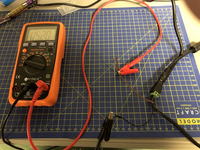

The second way to check polarity is to use a multimeter.

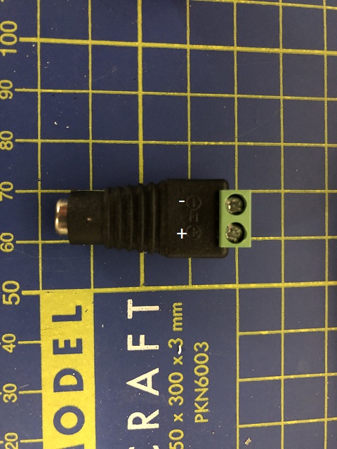

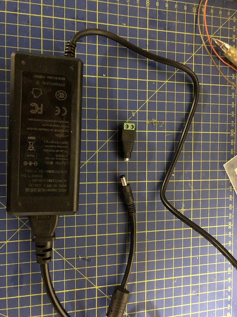

This is a power supply I bought for a project.It came with a socket to plug the jack into.The socket has the 2 terminals marked as + and -. This is a center positive polarity DC power supply that provides 5v output with 10A current.
So in theory All I need to do is connect the socket to ther circuit with the positive of the socket going to the positive side of the circuit and the negative from the socket going to the negative or ground of the circuit.
Now this supply has a lot of current output.It would surely damage any circuit if it was not correctly wired.

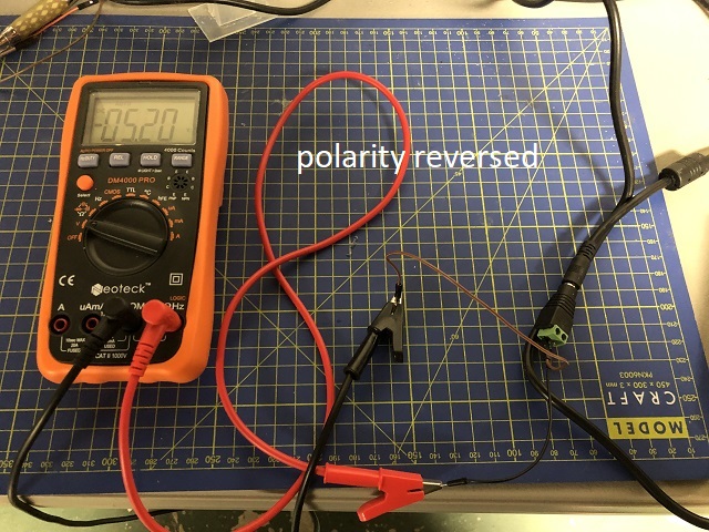

So I tested the power supply with the multimeter.Here is the procedure step by step;
1.Switch the multimeter to V.
2.Connect the wire coming out of the positive terminal of the socket to the red probe of the multimeter.
3.Connect the wire coming out of the negative terminal of the socket to the black wire of the multimeter.
4.Plug in the power supply to the socket and then into the mains power.
5.The voltage on the multimeter reads 5V.
So this tells me the power supply is indeed center positive and the labelling on the socket is correct.
But what would happen if the power supply was mislabelled or the socket was the wrong type.

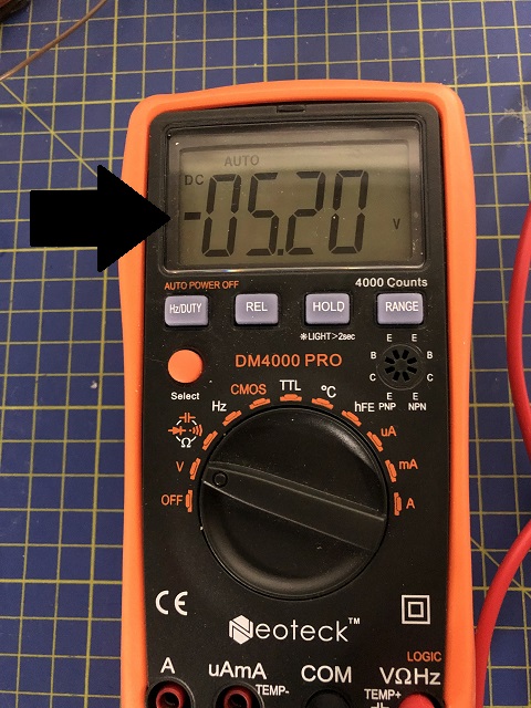

I connected the positive output from the socket to the negative (black probe) of the multimeter and I connected the negative output from the socket to the positive (red probe) of the multimeter.When I plugged in the power supply this time the multimeter it reads -5v.Them minus sign tells you that the polarity is reversed.
So once you have tested your power supply and socket you should know the polarity of the power supply and which terminal of the socket is the positive and which is the negative.
I always recommend testing the polarity of your dc power supply.They are not all the same in my experience and the last thing you want to do is destroy your circuit.
