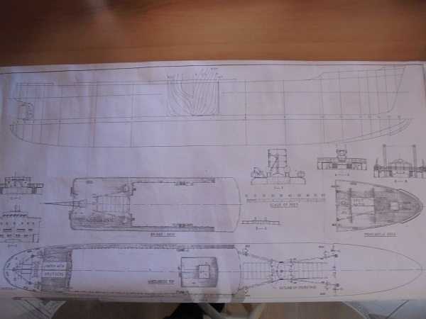

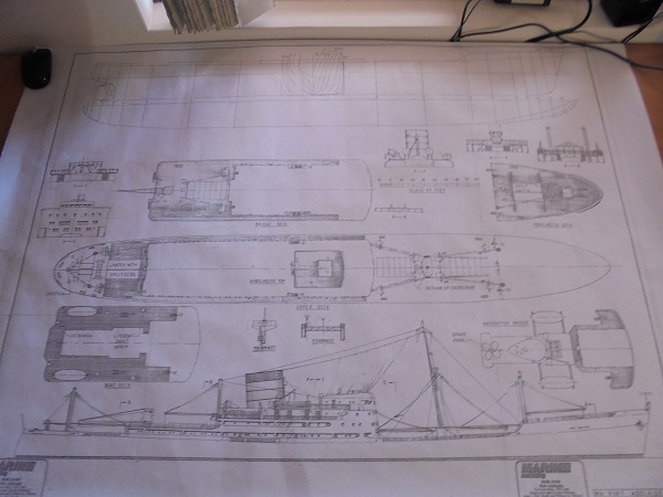

I have decided to start another project - a scratch build of MV Port Adelaide...BigGrin
Here is some information....Cool

The drawing is scaled 1:160 so things are going to be pretty small....Cool
Most fittings such as windlass, cargo winches, davits, cranes, derricks and samson posts will have to be made...Cool
I have started building, using 3mm MDF for the Keel and Hull Frames. I will also use 2mm "bendy" ply and 1mm balsa for plating...Cool

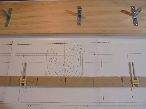

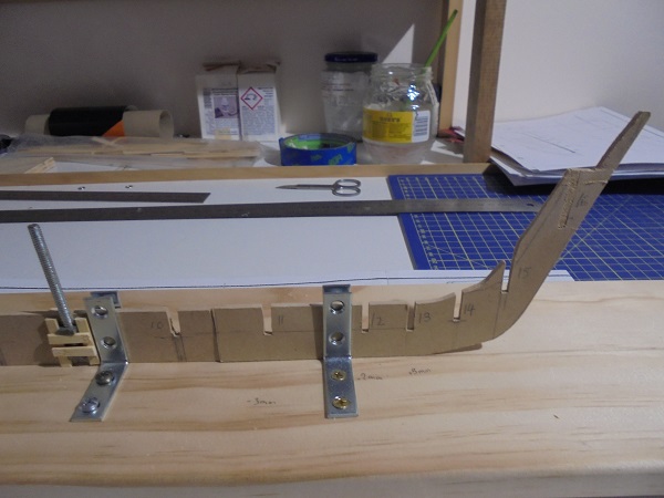

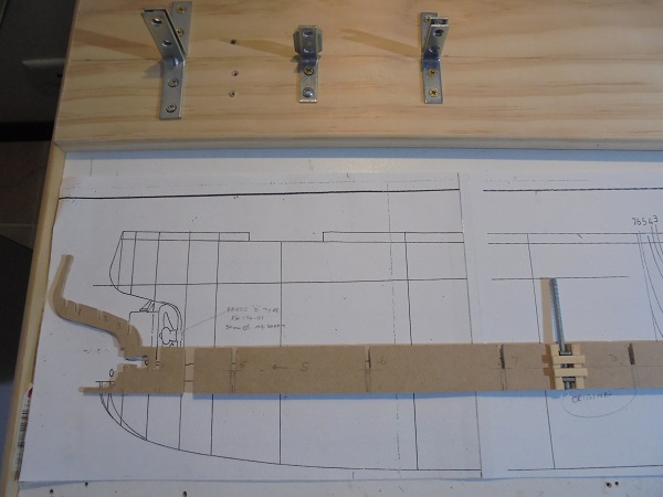

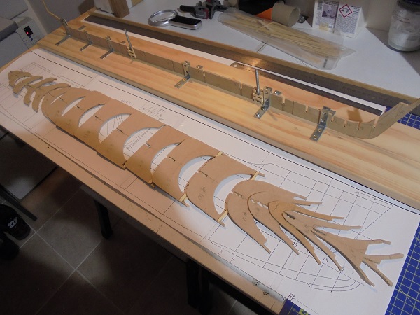

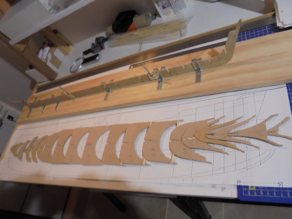

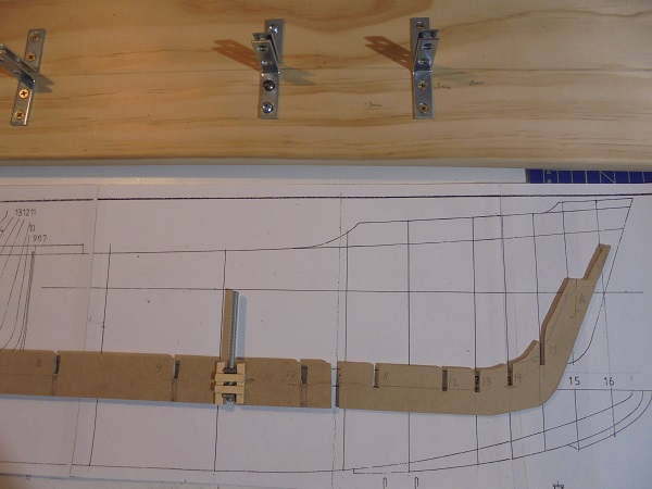

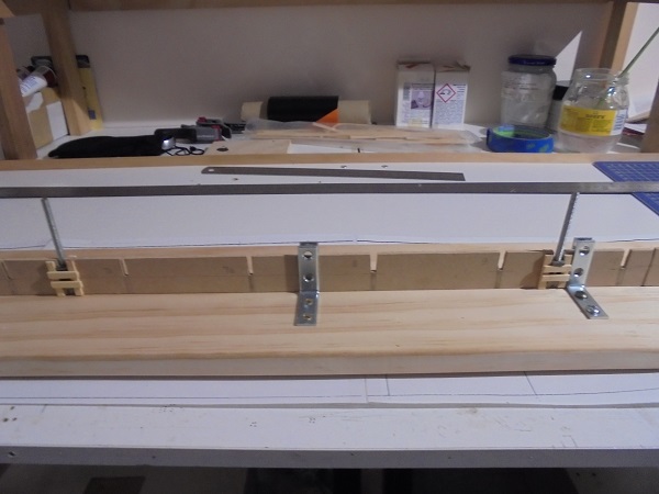

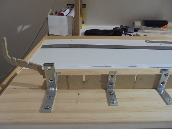

I have the keel marked and cut out, using 3mm MDF which is quite easy to work with - so long as you're careful...Cool
I'm trying the old slotted method as used on SotS and hope it works out...Blink
JohnP

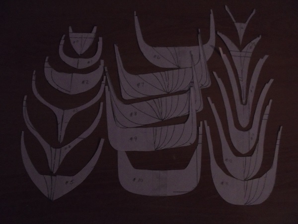

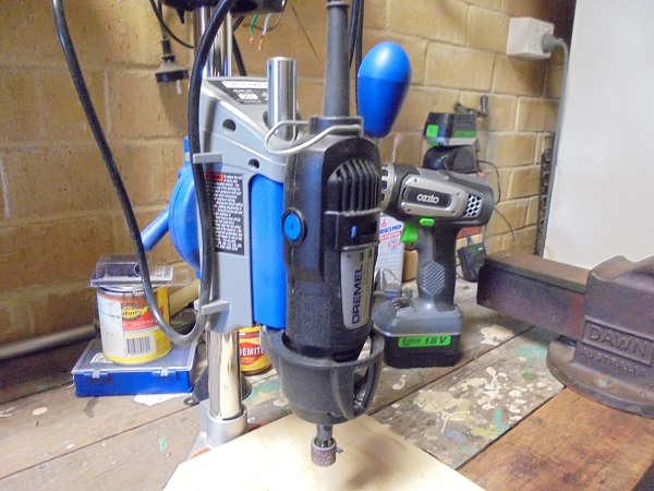

I made paper templates ( 2 for each profile ) then after taping together to form the total rib frame, I transposed to the MDF before cutting the rough shape with a coping saw...BigGrin Then I fine shaped initially with metal files - round and half round coarse cut and sanding....This proved very tiring so I splashed out on a Dremel...BigGrin
JohnP

The first 6 (bow frames) are going to need a lot of tickly fine tuning as they don't quite match the deck plans - some are too wide and some too narrow but all cut precisely to the frame plans...Blink
JohnP

Noticed you have strips going across the frames is that for supporting the deck
Also noticed you have cut out middle of frames are you thinking of r/c or is it just to keep the weight down and assist with planking

The strips serve 2 purposes, strengthening and forming of the deck plates which are concave from the centreline to scupper each side to allow water draining...Cool Pics below...
What's r/c? The cutouts were made by cutting smaller frames from the inside the bigger ones...BigGrin

Yes, there is a lot of trial and error going on...BigGrin I only have the one simple A0 size line drawing and the 2 photos to work from - plus a lot of detail stored in my memories of my seafareing days...BigGrin
