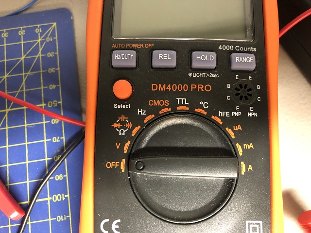

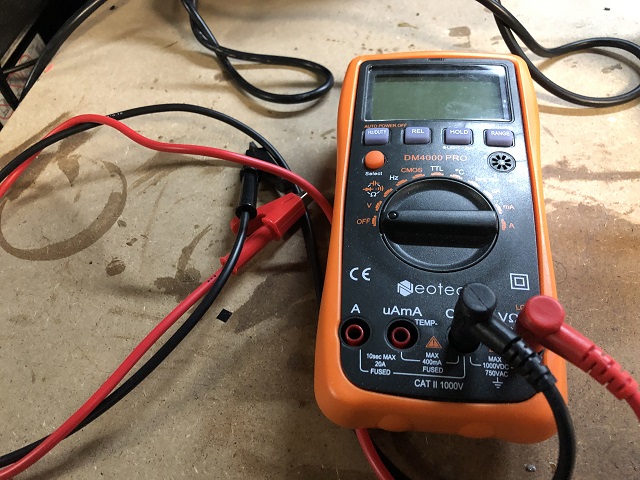

A multimeter is a very versatile tool.There are tons of different ones to choose from.You dont need to spend a lot of money.Mine was $15. They all have the same basic set up. A display screen, a selector for the different functions, and some sockets for the probes you attach to your circuits.
Here is my multimeter. The selector has a bunch of options.You can measure voltage,resistance,current,continuity and some other less commonly used functions. You use this selector to tell the multimeter what you want to measure.

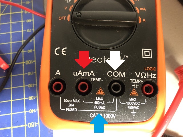

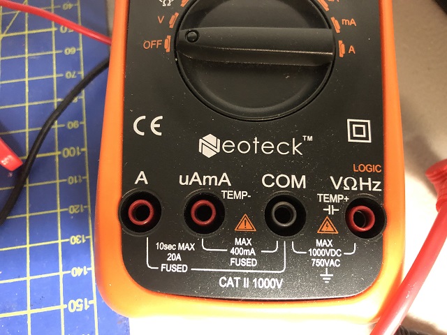

The bottom of the meter has 4 sockets to plug in probes.

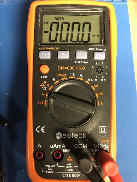

#2 Posted : 23 November 2020 03:23:36

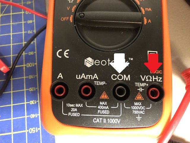

My multimeter has 4 probe sockets. The black probe is the ground (or common-COM) and the red probe is the positive.
If you are measuring voltage or resistance or frequency you plug the black probe into the COM socket (white arrow) and the red probe into the far right socket (red arrow) .
#3 Posted : 23 November 2020 03:30:55
If you are measuring current the black probe plugs into the COM socket (white arrow).
The red probe gets plugged into one of the 2 left sockets marked A and uAmA.
IF you are expecting current of less than 400ma you would use the right of the 2 red sockets (red arrow). This socket has a maximum of 400ma current based on the writing under the socket (blue arrow). you meter may have a different maximum current. THis socket has a fuse.If you attach this to a current load higher than 400ma it will likely blow the fuse and damage the meter.
If you are expecting current over 400ma you plug the red probe into the leftmosts socket (labelled A). For my meter there is a maximum of 20A current for no more than 10 seconds.If you leave the meter plugged in for longer than that the fuse will blow and the meter will be damaged.

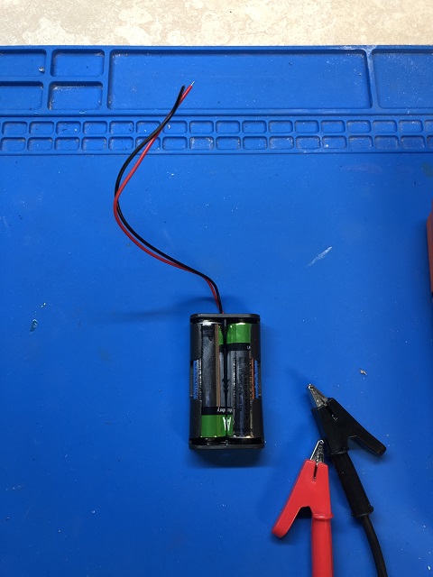

Here I have a battery pack with 2 AA batteries in it.Now I am guessing this will give me 3v of voltage output.How do I check?

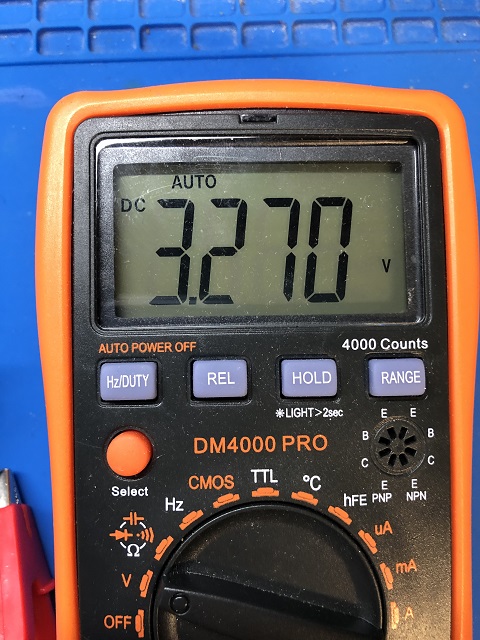

I use the multimeter with the probes plugged into COM and the V sockets and then attach the V probe to the positive output of the battery pack and the COM probe to the ground of the battery pack.I move the selector to V.On some meters you have to select a range of voltages you expect and some meters auto detect the voltage range. I get a reading of 3.2V.

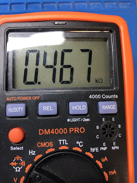

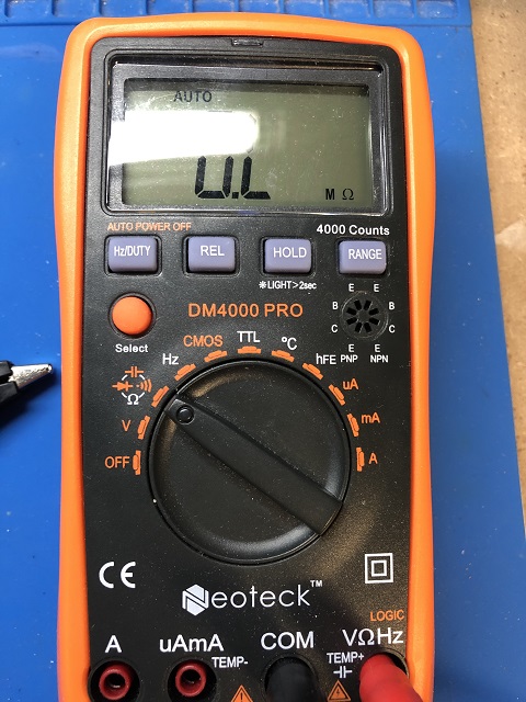

Measuring resistance

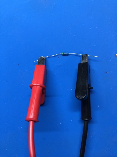

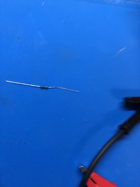

I have a resistor on my bench .I think it is 470 ohm, but I am too lazy to go online and check the color band coding.So I hook up the probes in the same way as measuring voltage and then switch the selector to resistance.I then connect one probe to one end of the resistor and the second probe to the other end (doesnt matter which way round) and I get 470 ohms. I always check my resistors especially if I am soldering them onto a circuit board because desoldering is a pain.

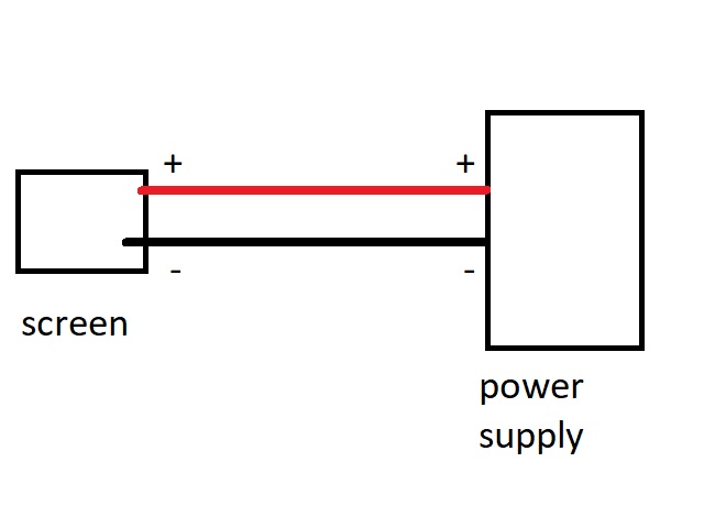

Measuring current.

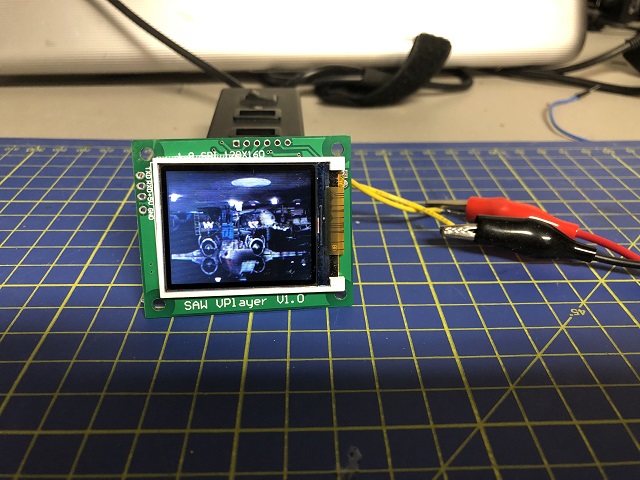

I made a small LCD screen that plays video clips.I want to use it inside a model.But I dont know how much current it draws so I am not sure how to power it.I know it needs 12v, but since this is a custom designed circuit there is no posted current draw.
Measuring current is a bit more complicated.Basically you have to make the multimeter part of the circuit for it to measure the current draw.
I am using a benchtop power to test the current draw. (we will ignore the fact that the benchtop power supply actually measure the current).

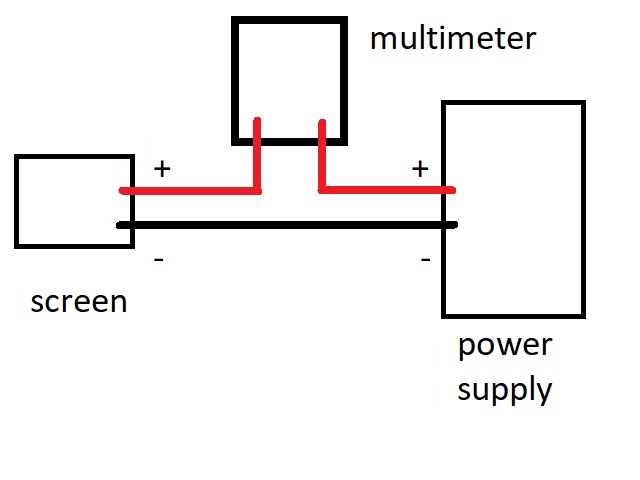

Here is the basic circuit
#8 Posted : 23 November 2020 04:21:25
To use the multimeter it has to be connected in series to the circuit.Here is the modified circuit with the multimeter incorporated.

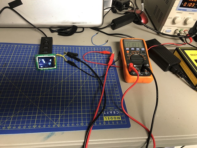

#9 Posted : 23 November 2020 04:23:02
So here is the set up.The screen is playing video with the benchtop pwoer supply providing 12V DC.

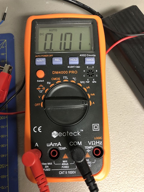

#10 Posted : 23 November 2020 04:35:40

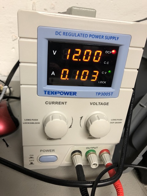

The positive wire from the power supply is attached to the black probe plugged into the COM socket.The red probe is now plugged into the A socket (far left). When you are not sure how much current will be drawn it is safer to use the higher rated plug because remember the uAmA socket has a 400ma limit. The red probe is then connected to the positive input to the lcd screen.Current passes from the power supply through the multimeter and into the screen. The ground from the pwoer supply still goes to the ground of the screen.
So the power supply is saying 103ma and the multimeter is saying 101ma.Pretty close.
Now I know the screen draws about 100ma of current.So if I want to put it in a hand held prop like a Star Trek Tricorder or Space 1999 communicator I need a battery that can provide 12v with at least 200ma current (remember double the current draw).If I use a boost power converter and a lipoly battery rated at 800mah I could power the screen for several hours.
