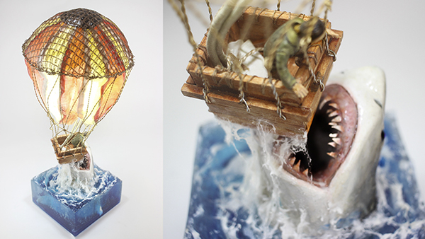

Hello everyone!
This is my first post here. I hope you like my latest diorama.
It is the third that I do and I would like to show you the process and the problems that I have had.

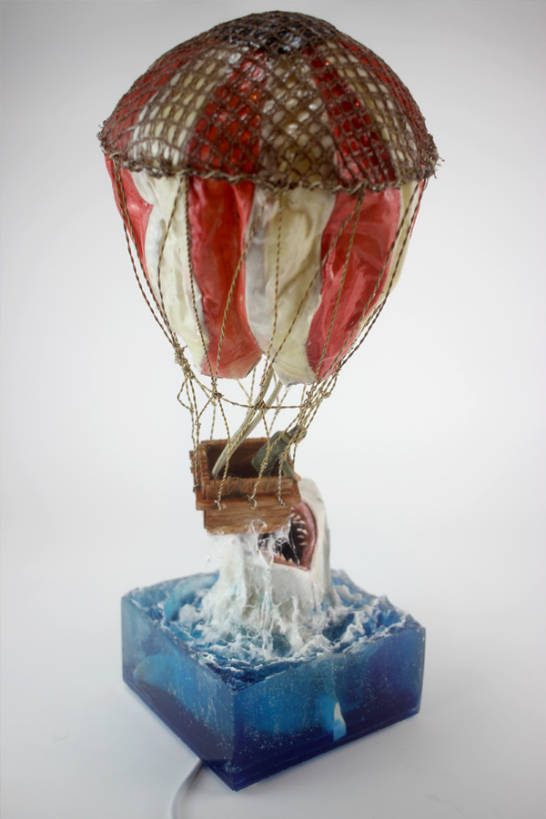

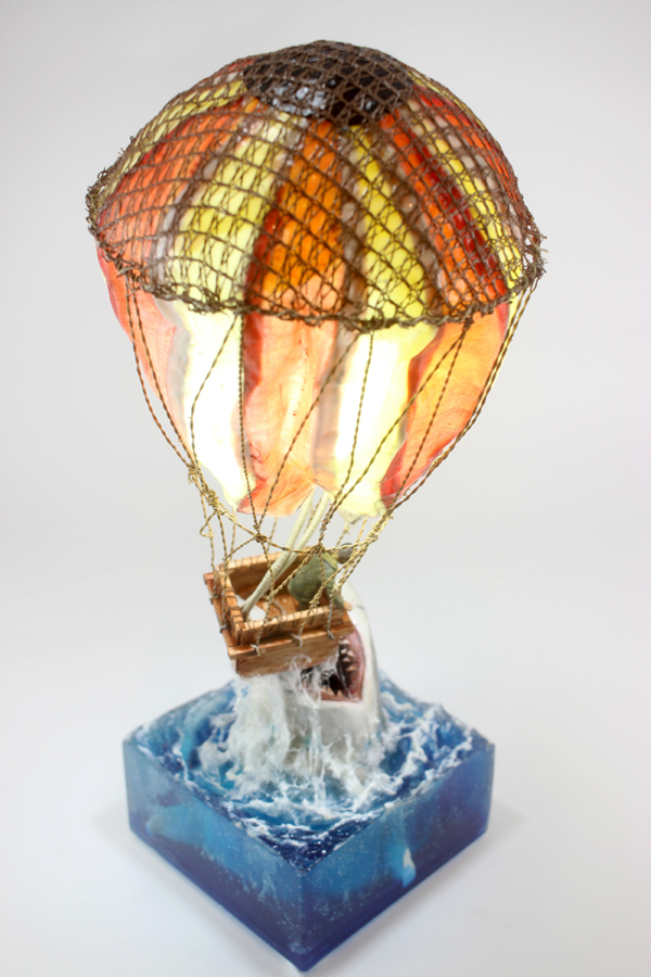

I really liked the idea of creating a dynamic diorama, representing the precise moment in which the action occurs.
Also, I wanted the diorama to be a lamp (it's a gift for my nephew).
In the previous dioramas I have used a rather horizontal proportion but in this one I was looking for something more vertical.
It has been a longer process than I thought and at some points I have encountered problems that in the end I have been able to solve.

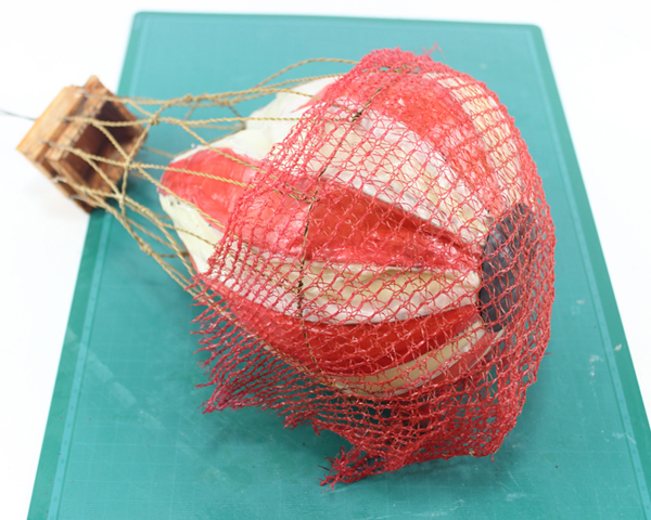

The idea of ​​making a hot air balloon that is suspended in the air and that is not noticeable is very nice but it is more difficult than I thought.

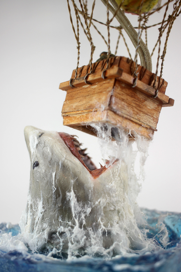

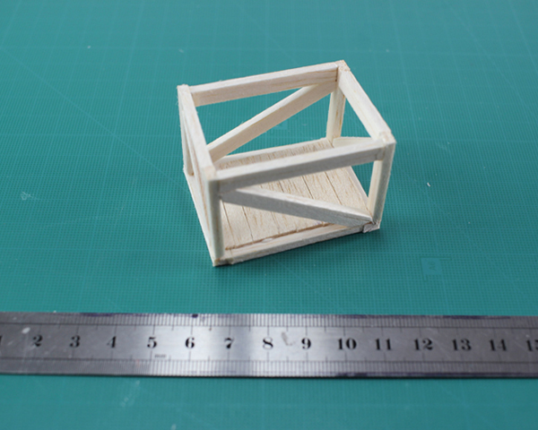

On the one hand, the basket of the hot air balloon is made with balsa wood to weigh less but at the same time it is a problem to hold the envelope.

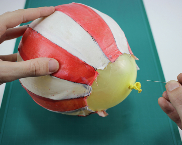

For the balloon shape I used an air balloon and Mod Podge. I thought that several layers of Mod Podge would be enough but no, I had to put some resin inside a balloon to harden the shape of the envelope a little more.
As you can see it has not been completely uniform but I like the way it has been because it seems that it is being moved suddenly.
To join the envelope with the basket I have used wire. I've been experimenting with rope and epoxy but they weren't strong enough. The wire is strong but balsa wood is not, so I had to reinforce the box with stronger wood.

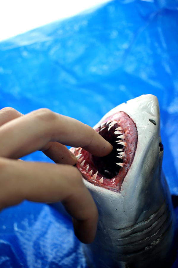

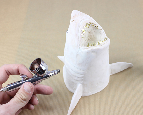

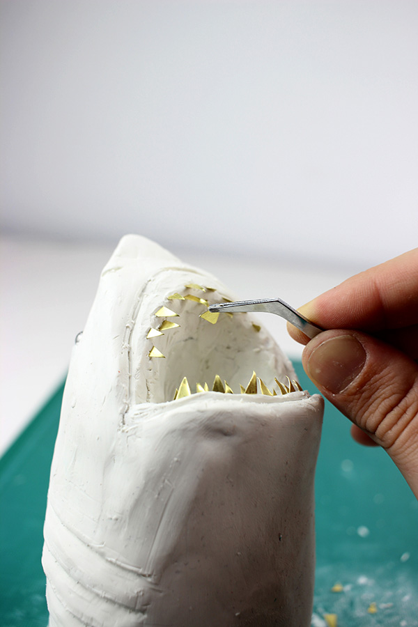

The figures of the diorama, the white shark and the person, are made with Sculpey polymer clay. I am not an expert in sculpture but I think the figures have not been bad at all.
The shark has been much easier than the human, due to the shape and size of the figure. As you can see in the video, the sculpture of the human is a bit burned. I think that the temperature indicator on my oven does not work perfectly and that is why it has burned a little more.

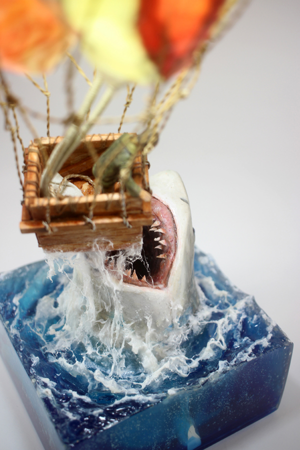

I have used epoxy resin in my previous dioramas and once again, the use of epoxy resin has not been easy. I wanted to make the waves with epoxy so I thought about doing the inverted waves in the forex. The result has not been 100% as I wanted but I do not dislike it. When closing the resin I created many bubbles, it was not the effect I wanted but it does not look bad since it is the moment when the shark comes out of the water. There is also some forex in the resin and that is why I have to clean it with the dremel in the video.

Fantastic diorama! Love this!Love
#8 Posted : 19 November 2020 13:01:02
Posts: 5,183
Points: 15,698
That is just SO clever.
Love it!Love
#9 Posted : 19 November 2020 15:41:35
beautiful work.The water effect on the shark is very realistic and a very creative idea.Please post more of your work for us to admire.
