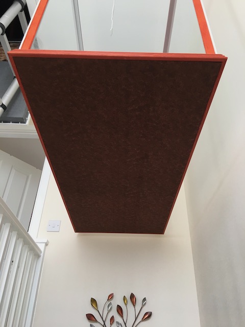

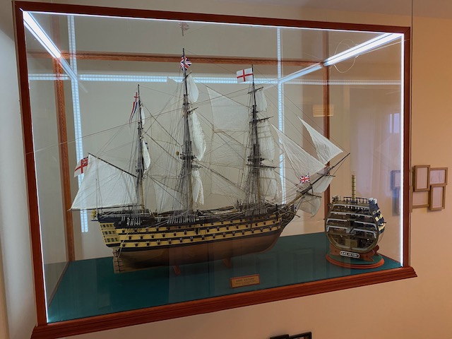

I don't need it for modelling purposes but for my HMS Victory display cabinet.

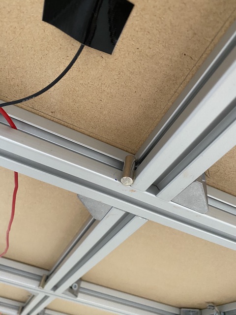

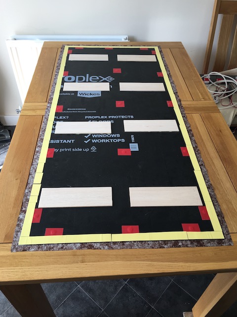

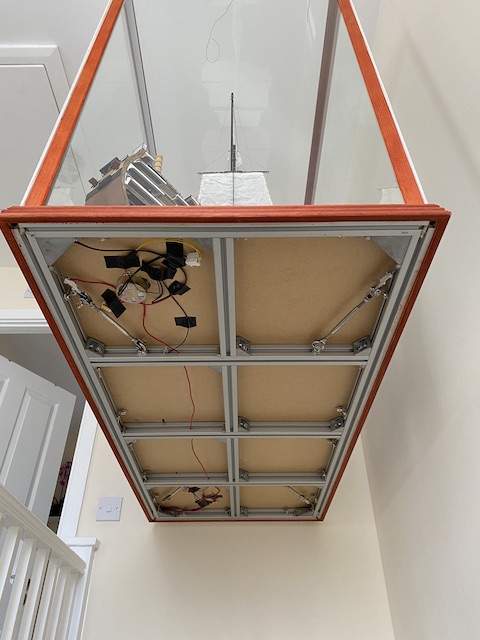

My cabinet is hanging from the loft through the ceiling above the staircase hence I need a decorative cover onto the bottom side.
Previously I bought a sheet which used as underlay for laminate flooring.
I covered one side with a decorative fabric.
It was fixed to the frame by magnets (glued to the frame) and washers (sticked to the sheet).

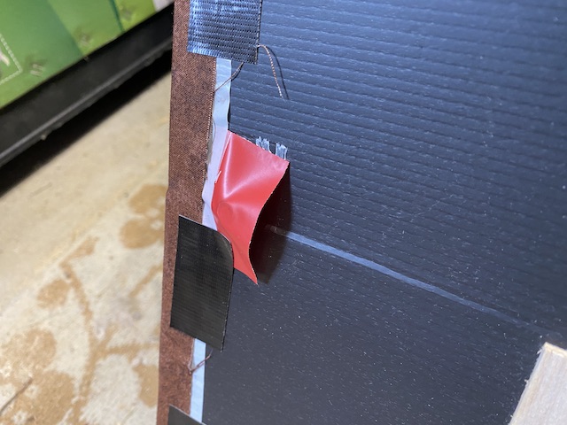

However I had problems to glue the washers to this plastic sheet, even with superglue, gorilla glue and others I tried. All the glues sticked to the washer OK but easily peeled off from the sheet. As a final resort I used strong duct tape but over time these also started to unstuck from the sheet.

See photos below, the magnets are located at the frame 'junctions', each red sticker on the sheet covers one washer.
I'm also open to any other alternative fixing methods instead of the magnet-washer method but it needs to be kept in mind that the total thickness of the cover sheet shouldn't be more than 2-3mm otherwise it wouldn't be flush with the wooden moulding around the frame and of course it needs to be removable without damage and no visible fixings underneath.

As you can see on the third photo, the base frame of my cabinet made of aluminium profiles where I can stick magnetic tape or something to it and metal strip to the cover sheet, but the areas between the profiles are 'empty' hence the cover must be rigid enough not to bulge downwards. That's what I tried to do with the underlay material I had already but nothing was sticking to it permanently. Therefore I'm looking for alternative materials.
