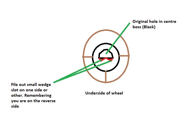

Hi Slimguy, BigGrin
Working along the same vein as Roy`s suggestion, but something that will give you a bit more control, here`s another idea.
If my memory serves me well the wheel is made from an alloy so should file gently making the job easier.
I have attached below a very amateurish sketch of the reverse side of the wheel and indicated how you can change the shape of the half circular hole in the wheel underside to turn the wheel in the direction you require. This will allow you to make very small changes at a time, but will still need the addition of glue.
Should you try either method without success PM me your address and I`ll post you a replacement wheel and horn push FOC as I have a spare.

slimguy
#9 Posted : 03 October 2020 19:47:13
Rank: Amateur Level 1
Joined: 02/08/2020
Posts: 33
Points: 99
Location: California
Hello Derek. Thank you for the diagram. Definitely food for thought. Let me noodle through this as well as Roy's suggestion. I will update the post once I de ode which road to take. I am studying the partial disassembly of the front end to see how many items I need to tear down to get clear access to the steering box. If it appears to be to many I will look carefully about taking apart the steering wheel assembly and attacking it from that end. Hopefully I can get it to work. If push comes to shove, since the model will be static in a case I just may have to settle for no active steering.
#10 Posted : 03 October 2020 19:55:34
Take your time and go the way that suits you best. Should you try adjusting the wheel by whichever method (Roy`s or Mine) and it turns out bad then my offer of the replacement wheel still stands.BigGrin
