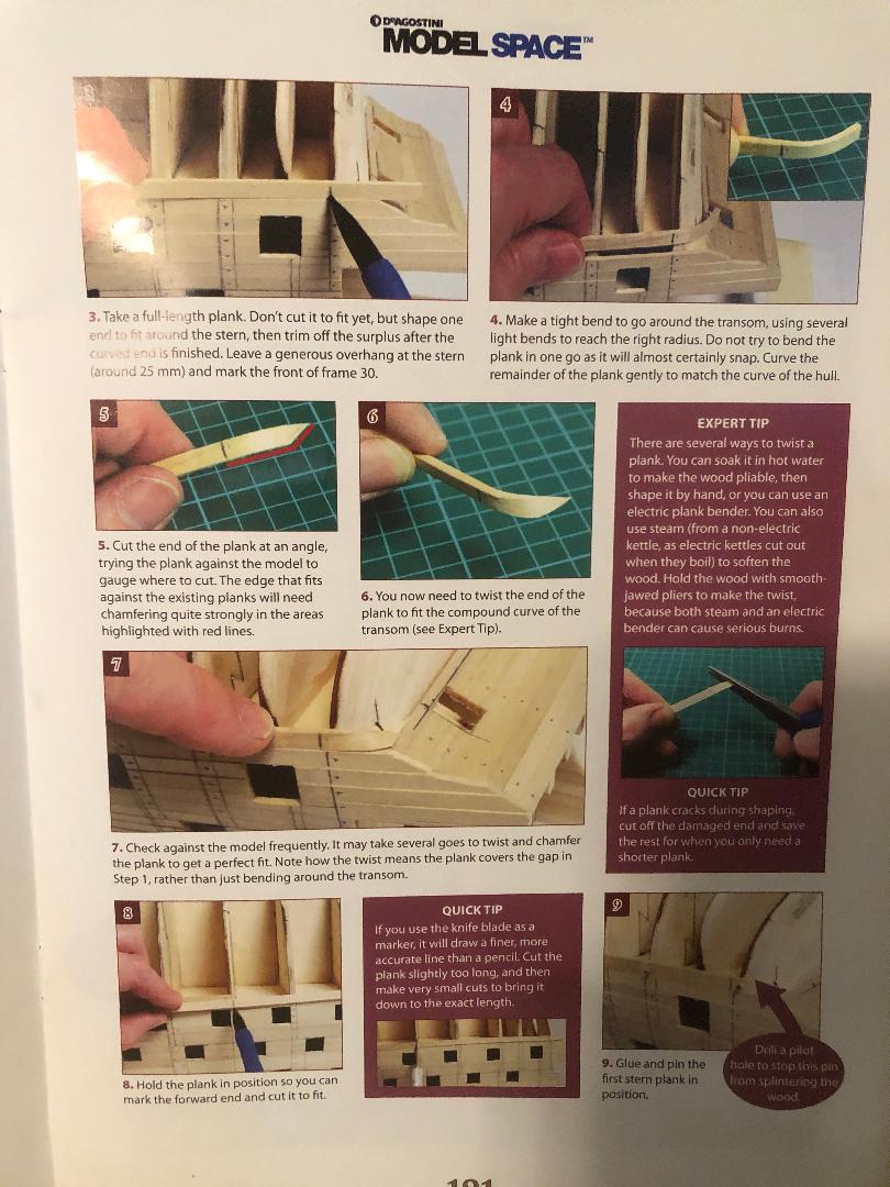

Hi Ronald,
I believe the mark what the instruction mentions is only there to make sure that during the bending/trying/bending/trying process you always align the plank at the same (e.g. the forward edge of the rib) location.
Once you happy with the bend and it nicely follows the stern then you can cut the forward end of this plank to size.
I hope it helps.
Happy building!
Laszlo

ok thanks Laszlo
it helps some but how do I mark that area that the instructions ask me to do
in part 3 how many MM from the end of the stern or from the center of the false
keel that is what I want to know plus can you tell from the bottom photo part
if the edge of the angle cut is inline with the mark it looks that to me just
want your opinion
Ronald

Hi Ronald hold the plank in position then where the plank passes over the front edge of rib 30 this is where you make the Mark. This is also where the sharp bend should begin.

ok thanks Nightwisher I wish you had a name, but anyway are you talking about the mark I cycled in photo in part 7 or the side view of the stern where you off 25MM from the end of the plank, if you are referring the mark I cycled and where the edge of the angled cut is. how do I locate that mark. thank you

Oh yeah I didn't even notice that Mark I don't think it's anything to do with the instructions. I did draw some lines on my stern at equal distances from the middle to try and keep the planks symmetrical. Regards Tom

#7 Posted : 02 October 2020 09:05:48
Hi Ron, personally I wouldn't worry too much about the marks in the instructions as all builds are different. Just get the first plank going around the stern right and all the other planks will follow. Also the planks very in with ,plus or minus a tiny bit so some people will get to the kell in 8 and some in 10 and so on . Hope this helps

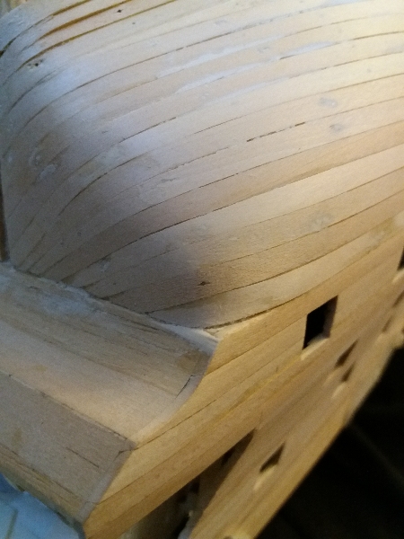

nightwisher
#9 Posted : 02 October 2020 19:41:49
Joined: 09/12/2013
Posts: 577
Points: 1,748
Location: smethwick england
Ronald I got to the keel with my eighth plank here's a pic not my best work but I'm not too bothered about being neat below the waterline as I plan on copper tiling .

ronald305
#12 Posted : 02 October 2020 22:35:24
Joined: 08/02/2015
Posts: 426
Points: 1,259
Location: Louisiana
ok thanks Tom
will try again tomorrow for some reason my planks keep splitting at the ends
some how I can get the bend right but when I start to twist it starts splitting
also I never know where to cut the angle at but then I looked at the photo you
sent me and notice the angle cut is right at the bend, and also I notice Alan's
bend and twist and bends in his build video on you tube looks a lot different
and easier then the instructions do and he makes using the crimpers easy foe
which I have trouble with over the iron your thought P.S.- I will look in to
getting a kettle
Ronald

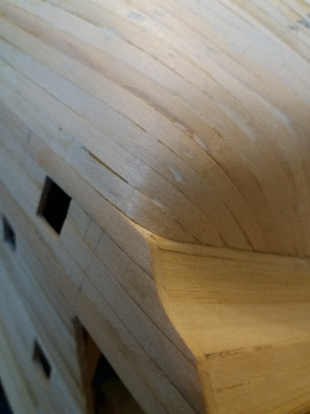

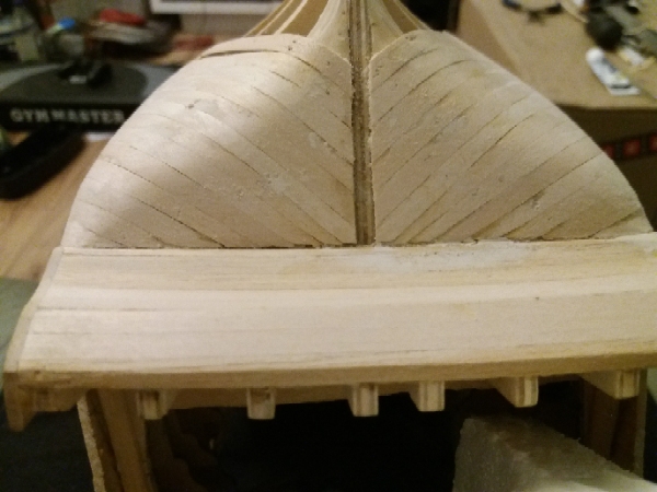

nightwisher
#19 Posted : 16 October 2020 18:26:12
Joined: 09/12/2013
Posts: 577
Points: 1,748
Hello Ronald just got in from work and saw your post. Sorry go hear your still having trouble with this part of the build, I have never used a crimper so I can't offer anything on that one. As for the angle cut I made the bend
And twist first then just kept trimming bits off the end and trying it against the frame until I got a nice fit. As for soaking the wood in my humble opinion once it's soaked for a couple of hours it ain't gonna get any wetter. Here's a few more pics hope they help.

ronald305
#20 Posted : 16 October 2020 18:44:46
Joined: 08/02/2015
Posts: 426
Points: 1,259
Location: Louisiana
ok thanks Tom for more photos
that is what I am talking about your first stern plank looks so neat
and the ends are not splitting like mine do, will try just the iron this
time and also try to bend the plank a tad more inward so it will stay in L
shape or almost like a wider V shape so I can work on the angle and twist as I
mentioned before
Ronald
