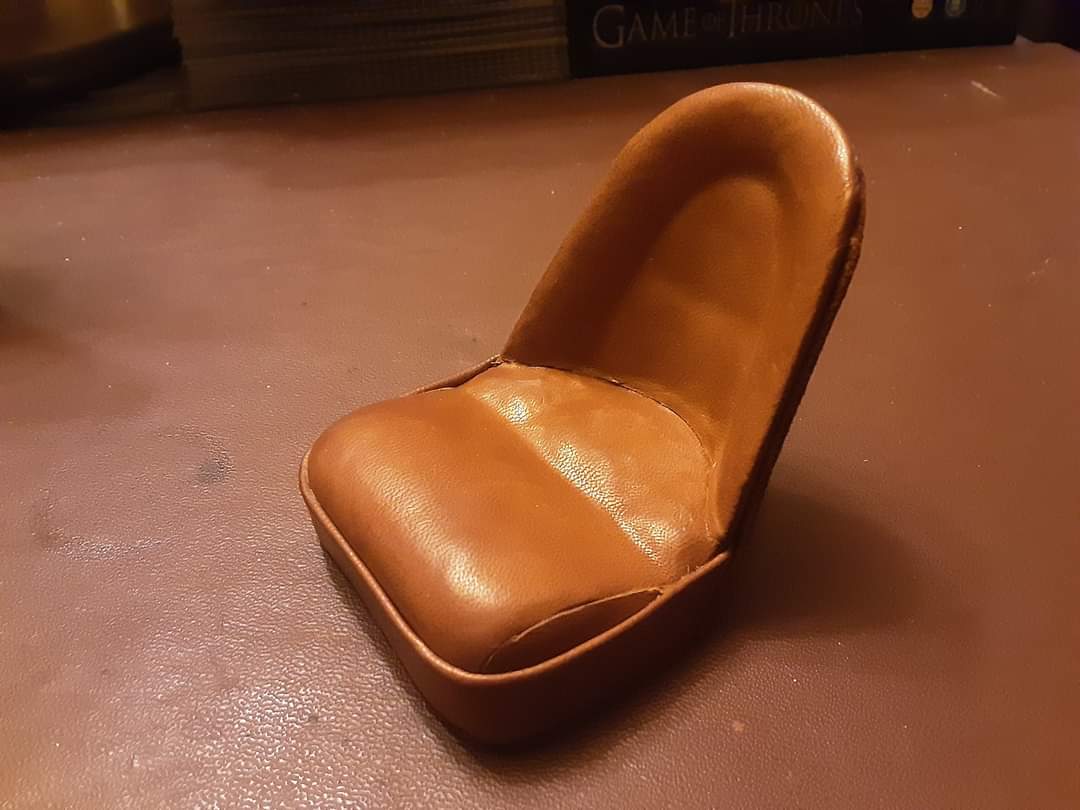

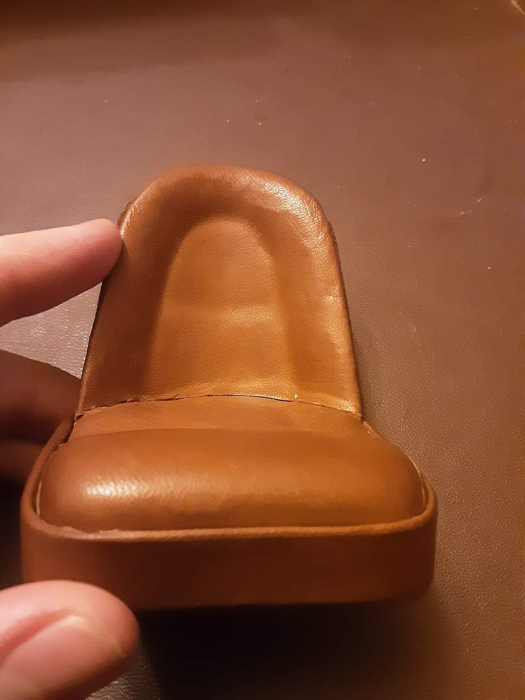

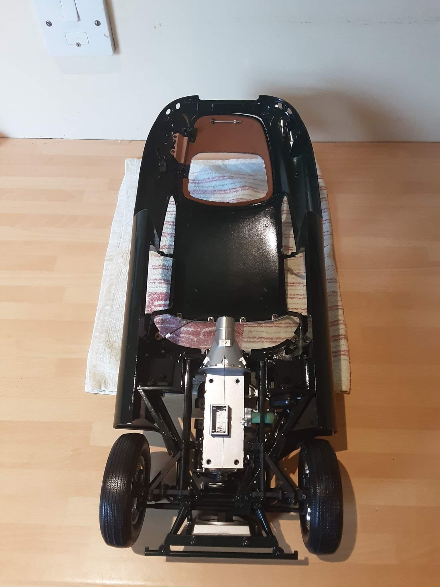

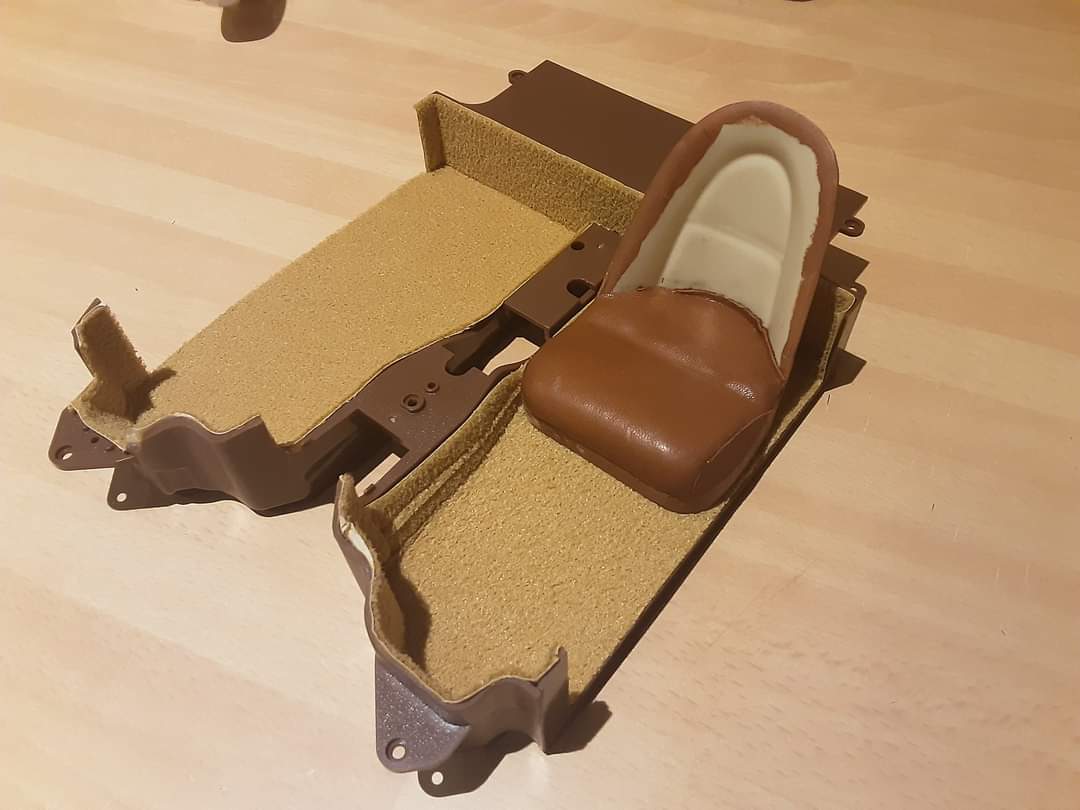

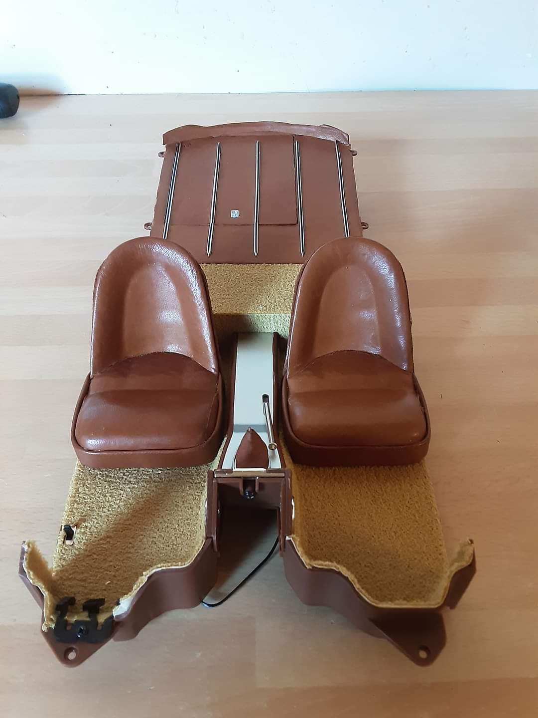

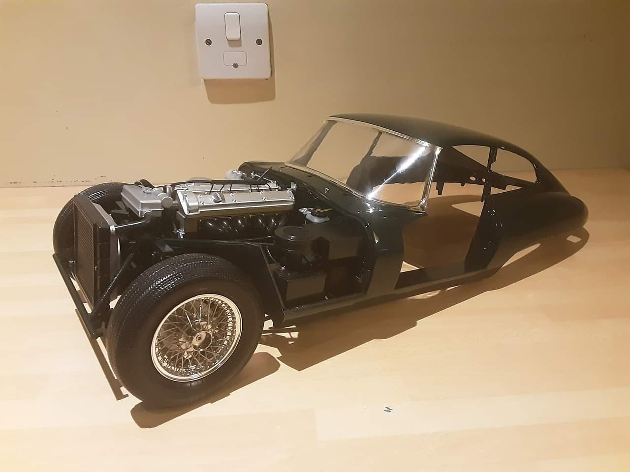

Beginning to just look like a real one

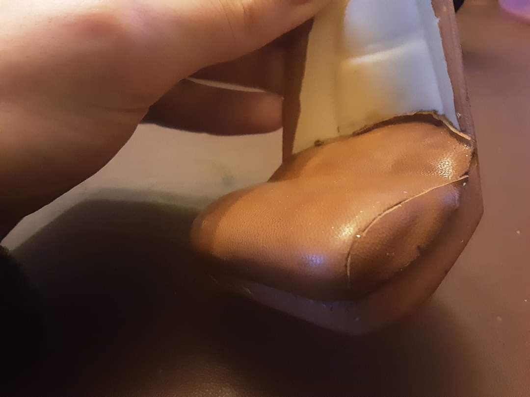

Thanks Roy for the seats and leather

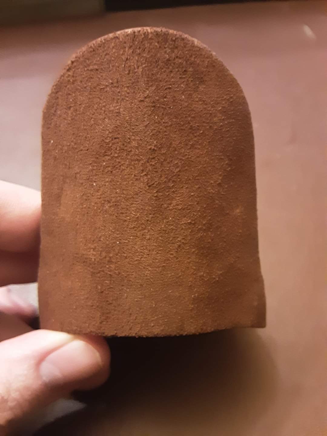

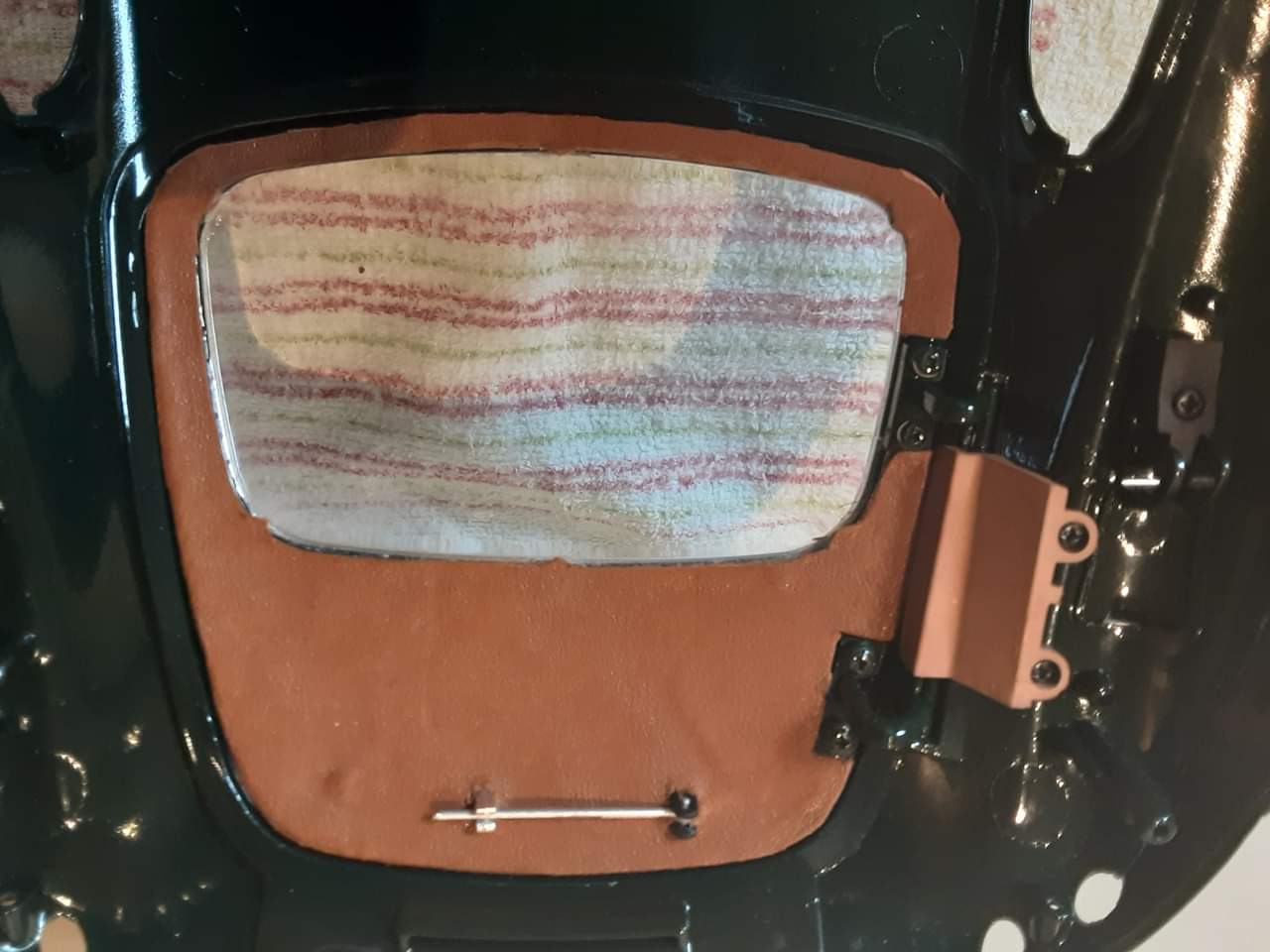

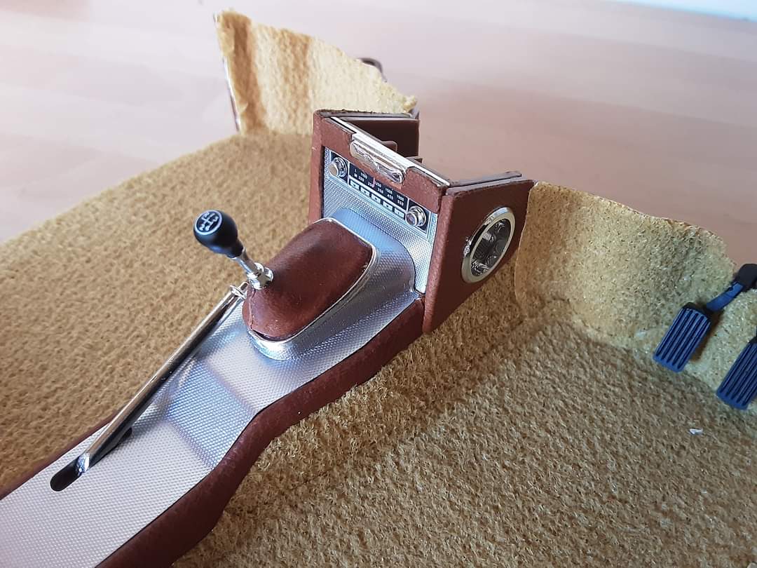

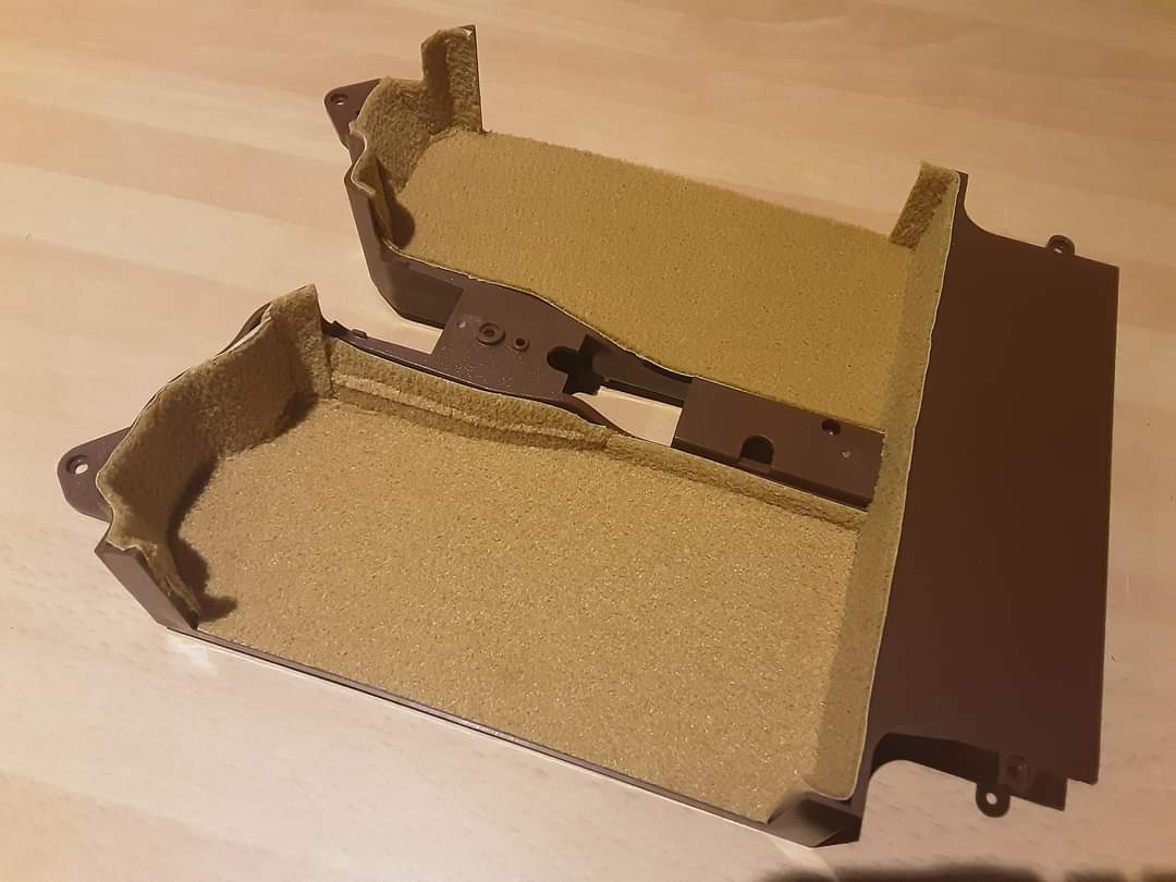

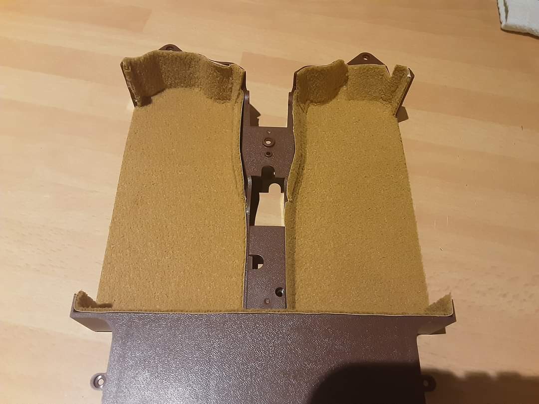

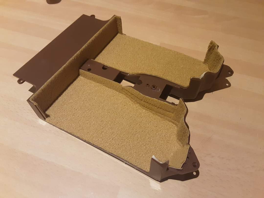

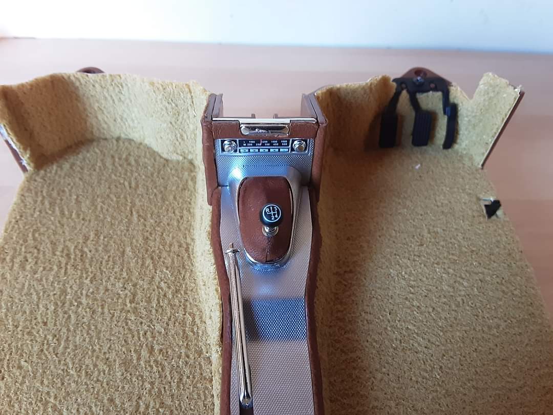

The carpet mod supply by Roy
William Wardale attached the following image(s):

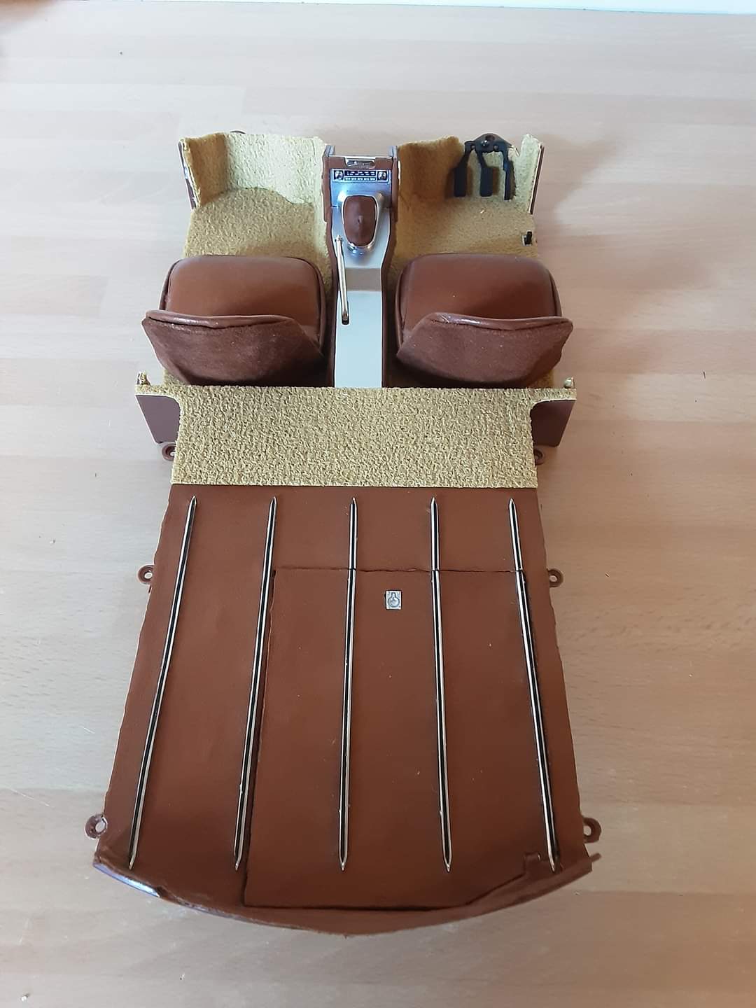

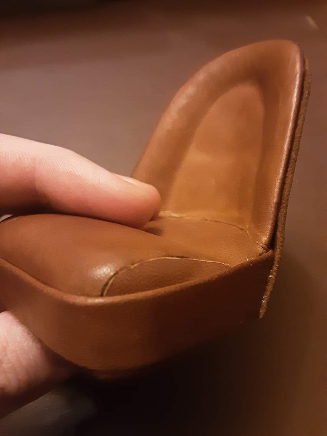

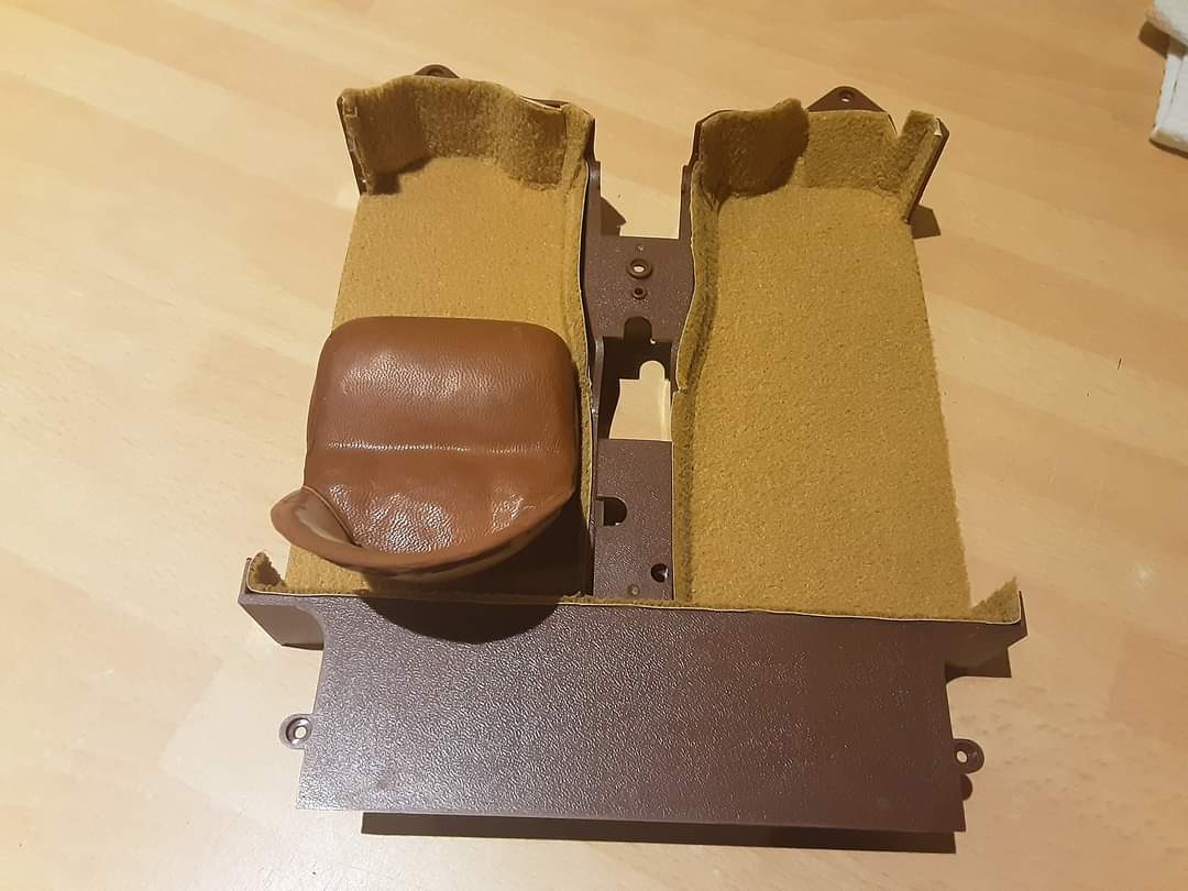

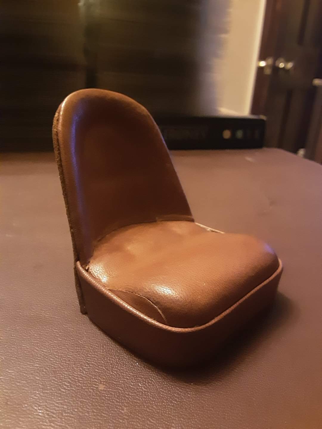

One seat down one to go

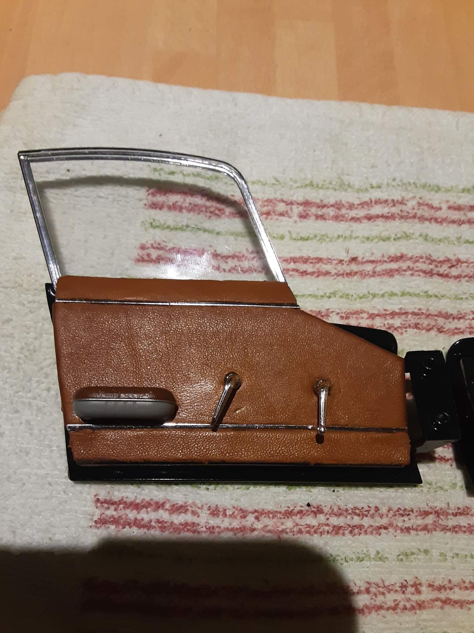

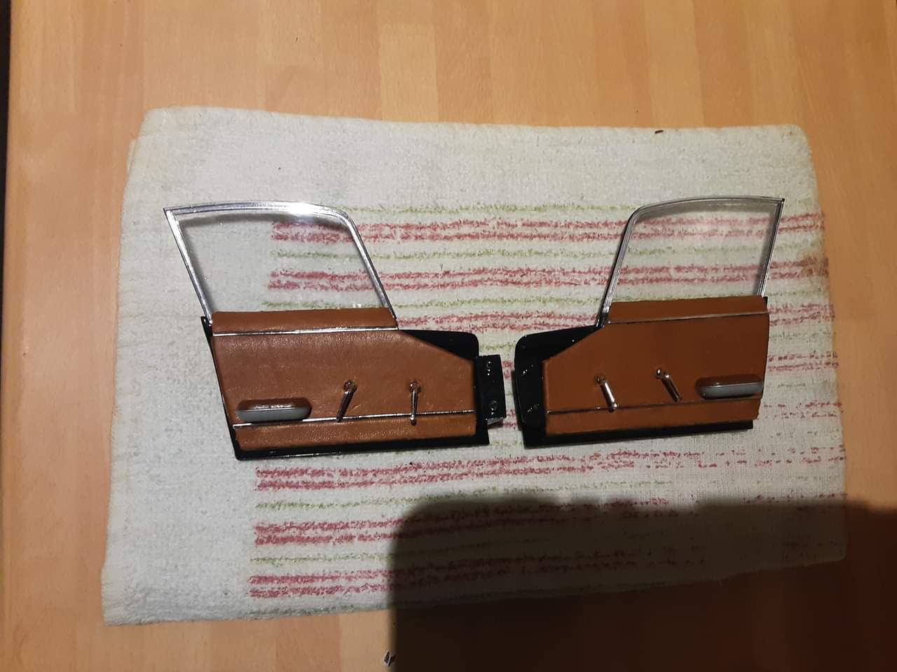

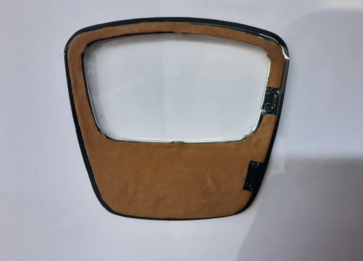

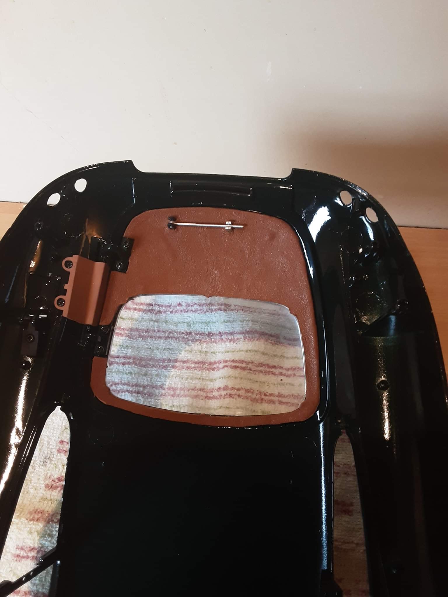

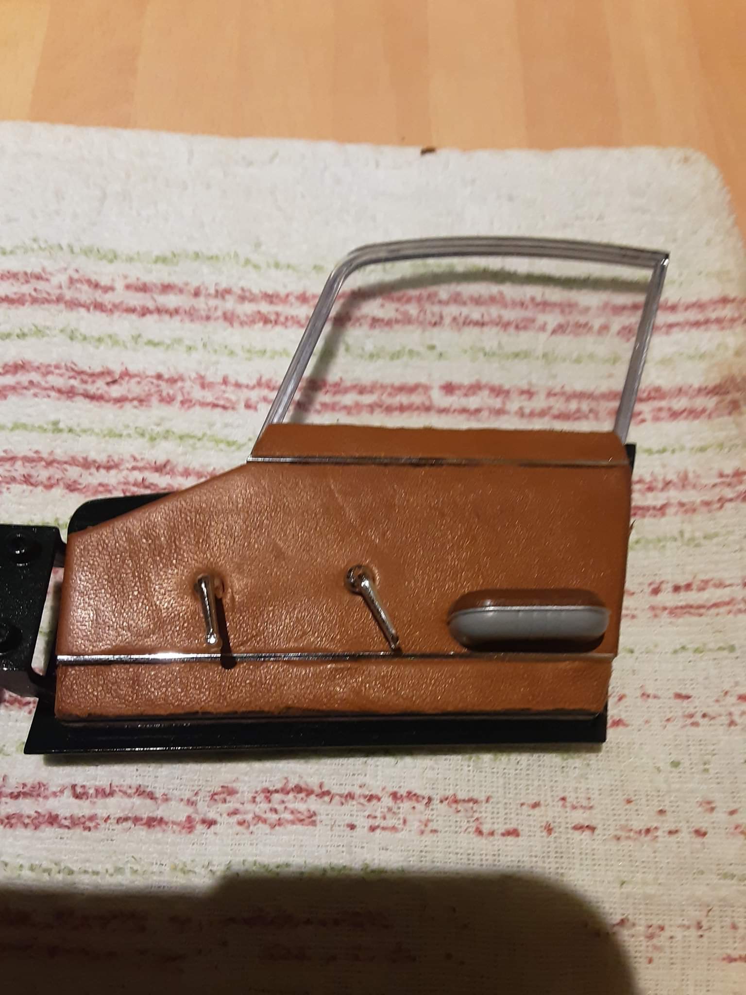

I have decided to leather the rear door interior panel I am very pleased on the end result as you can see no screws are showing
wwardale
#7 Posted : 03 October 2020 17:36:59
Nice additional touch.
Cool Cool Cool
#8 Posted : 03 October 2020 17:50:04
Posts: 5,188
Points: 15,713
Good one.
A mod definitely worth doing.BigGrin

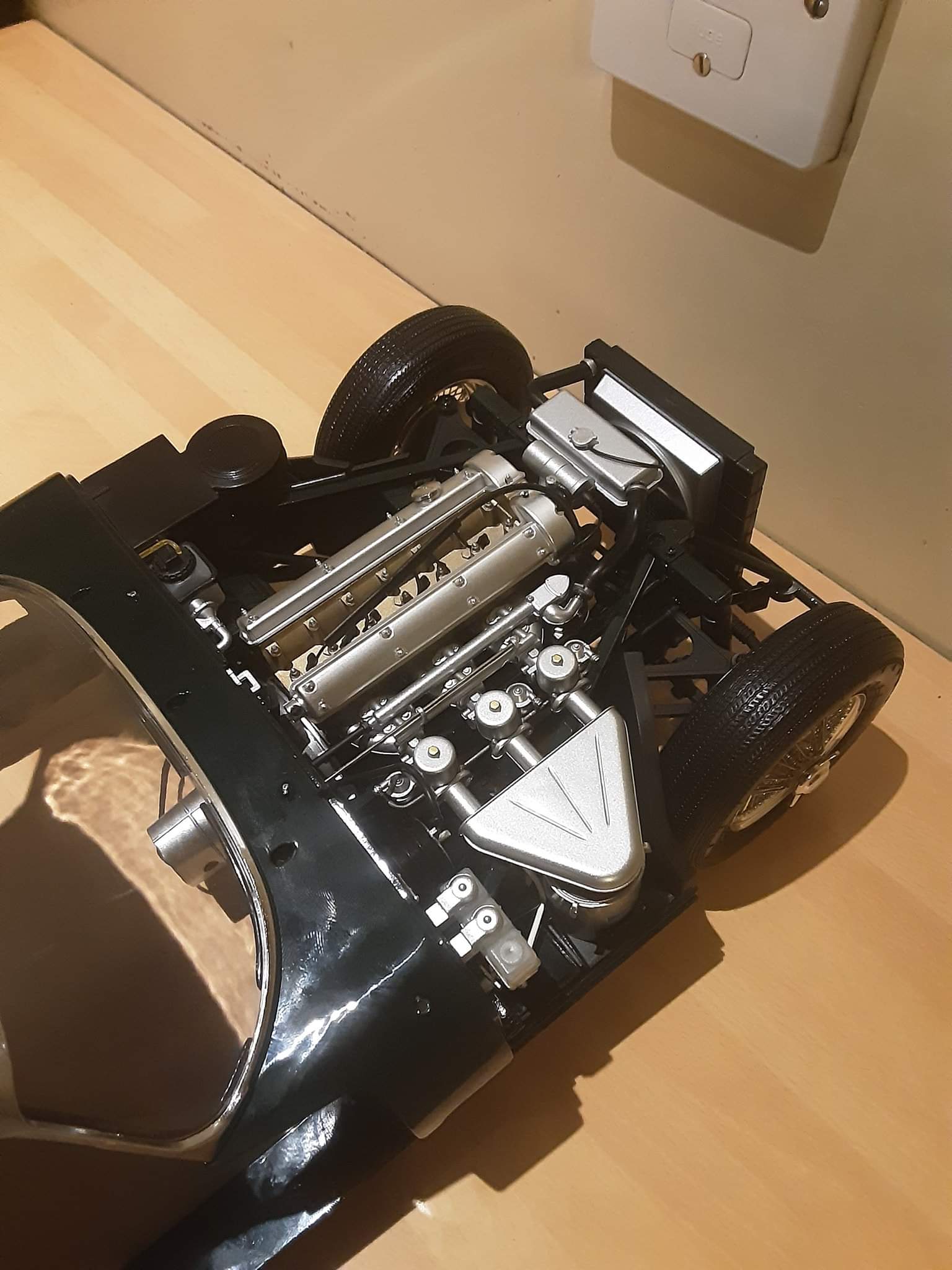

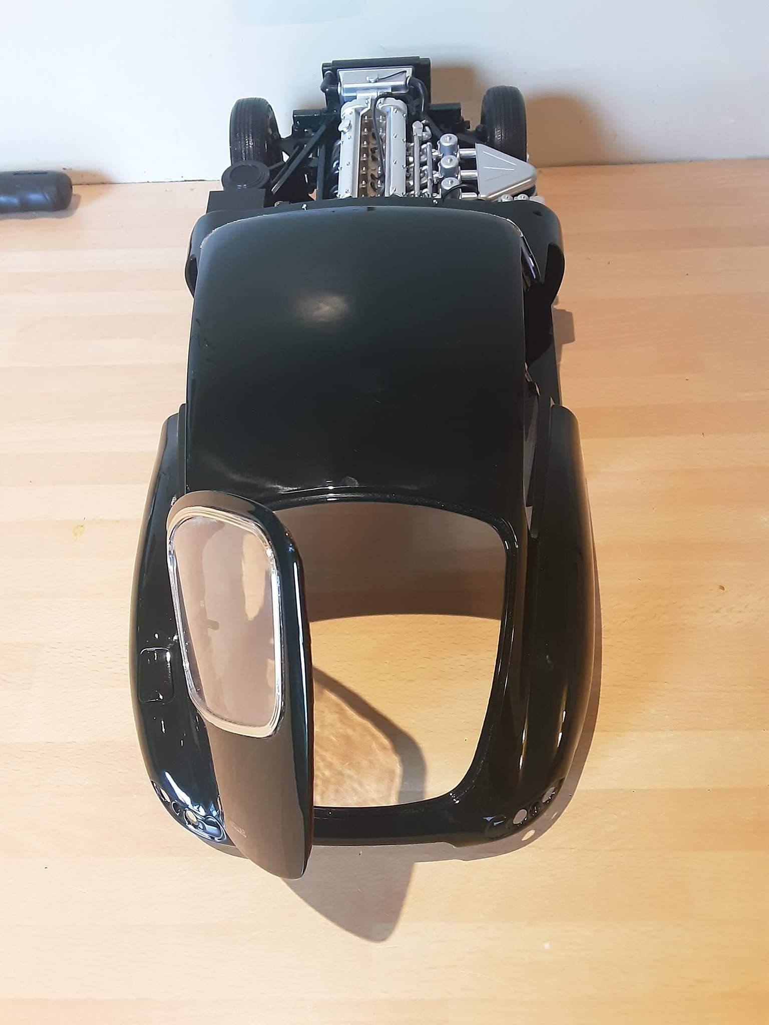

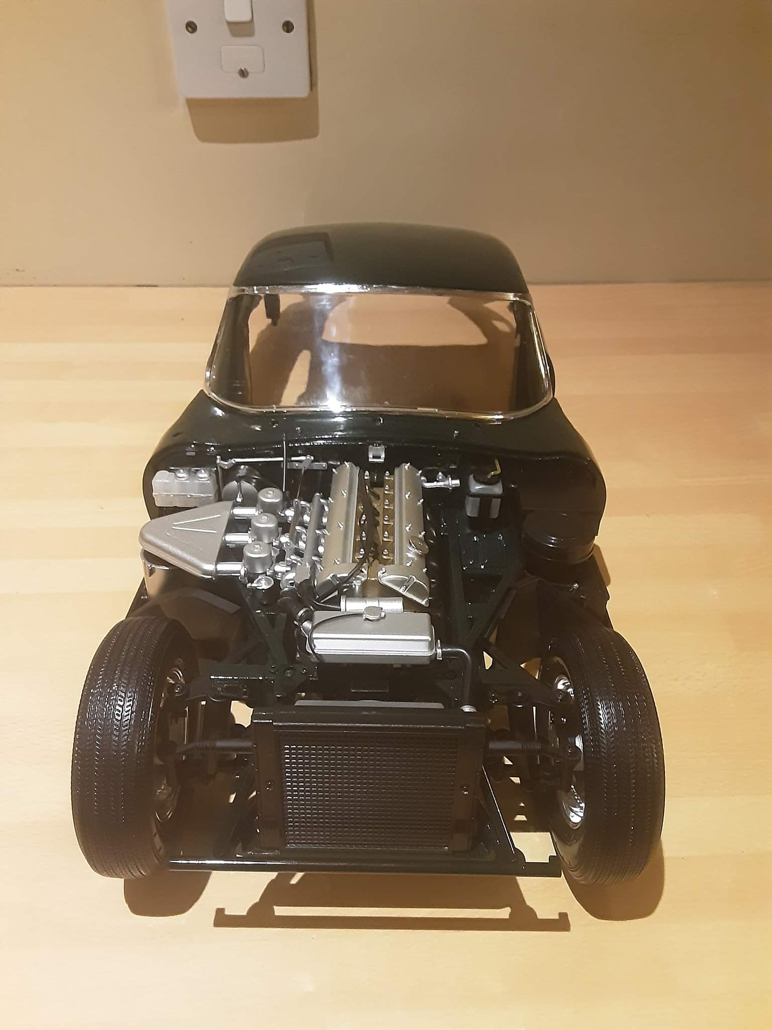

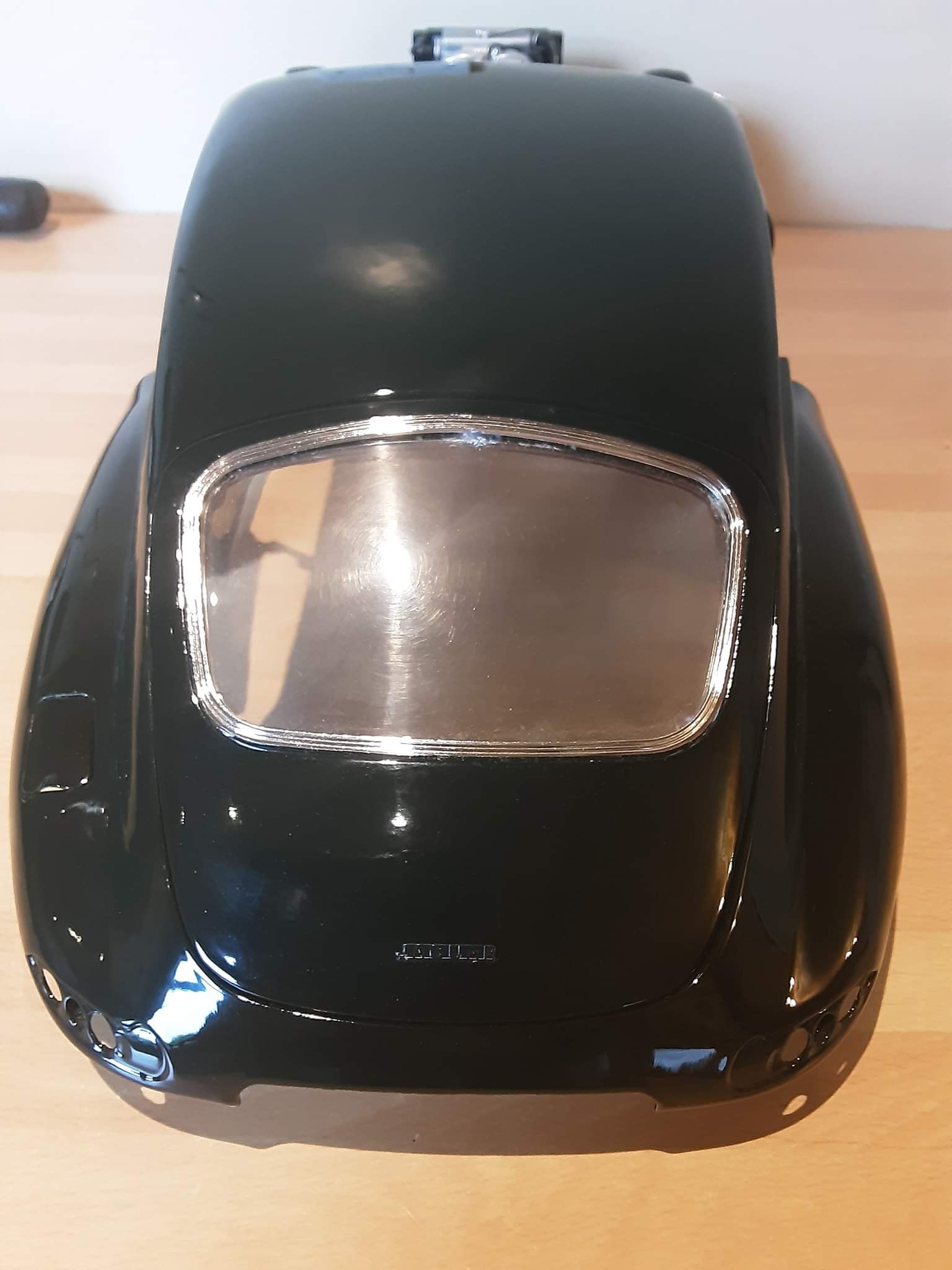

The boot door is now attached to the body

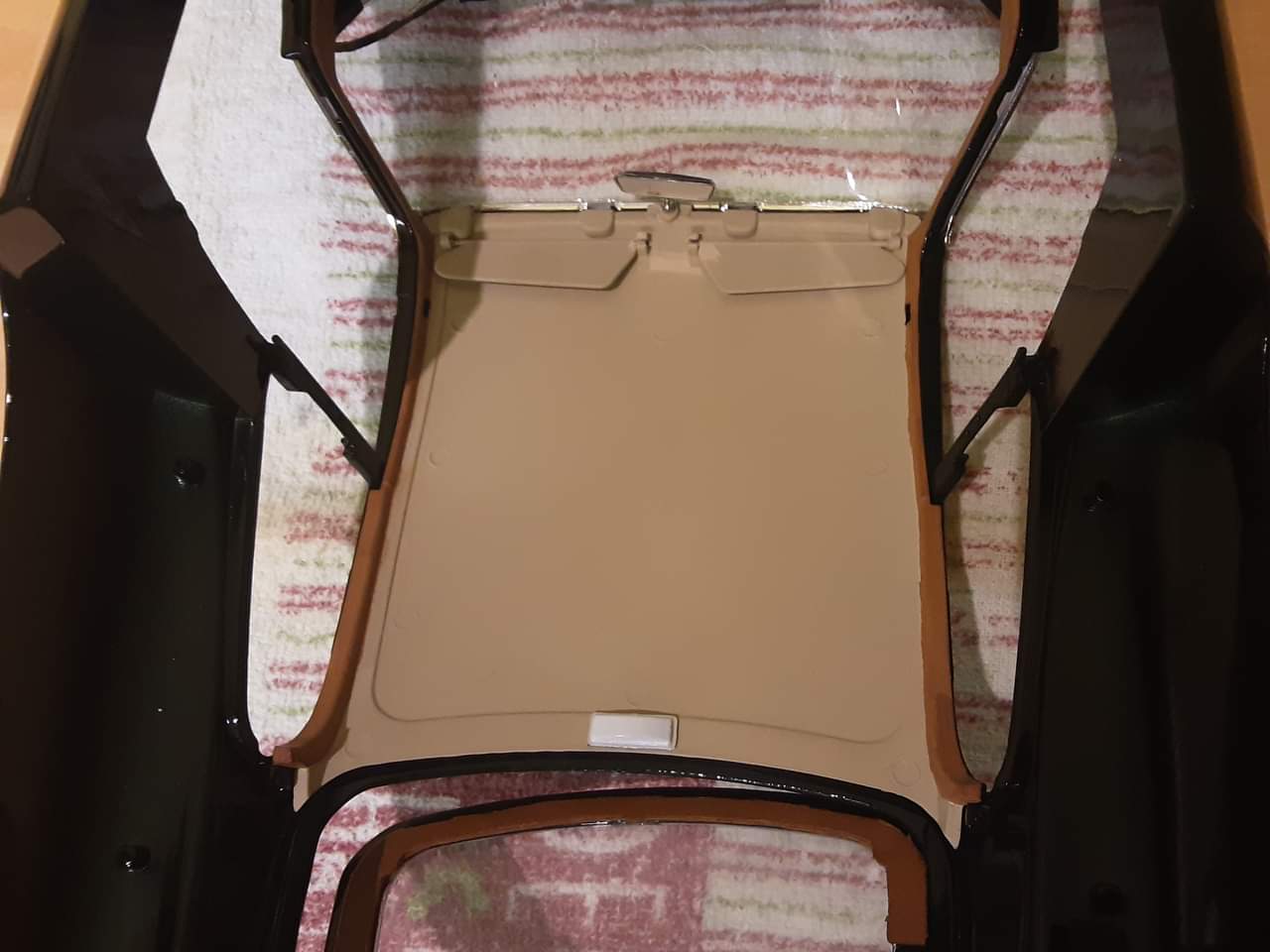

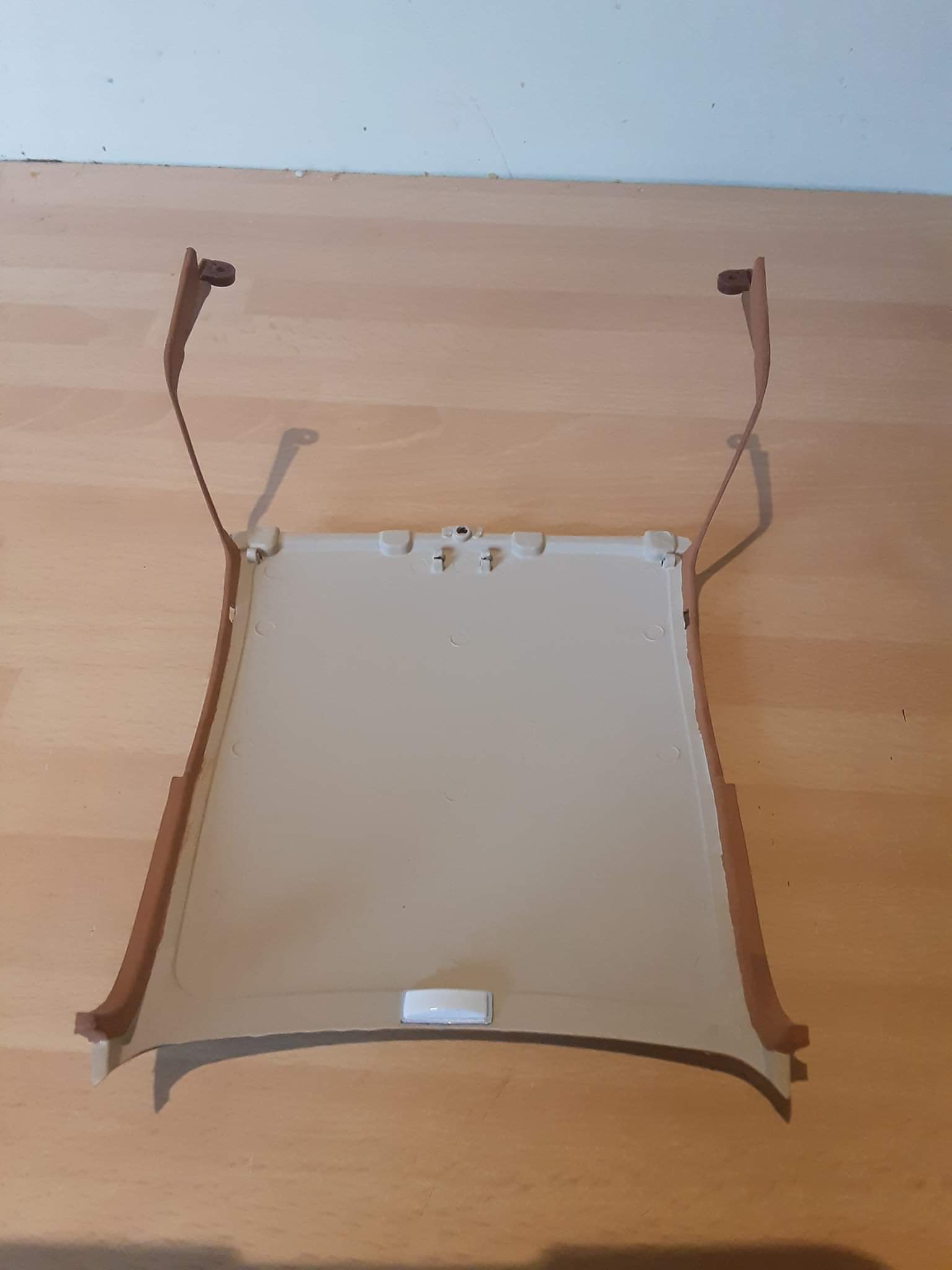

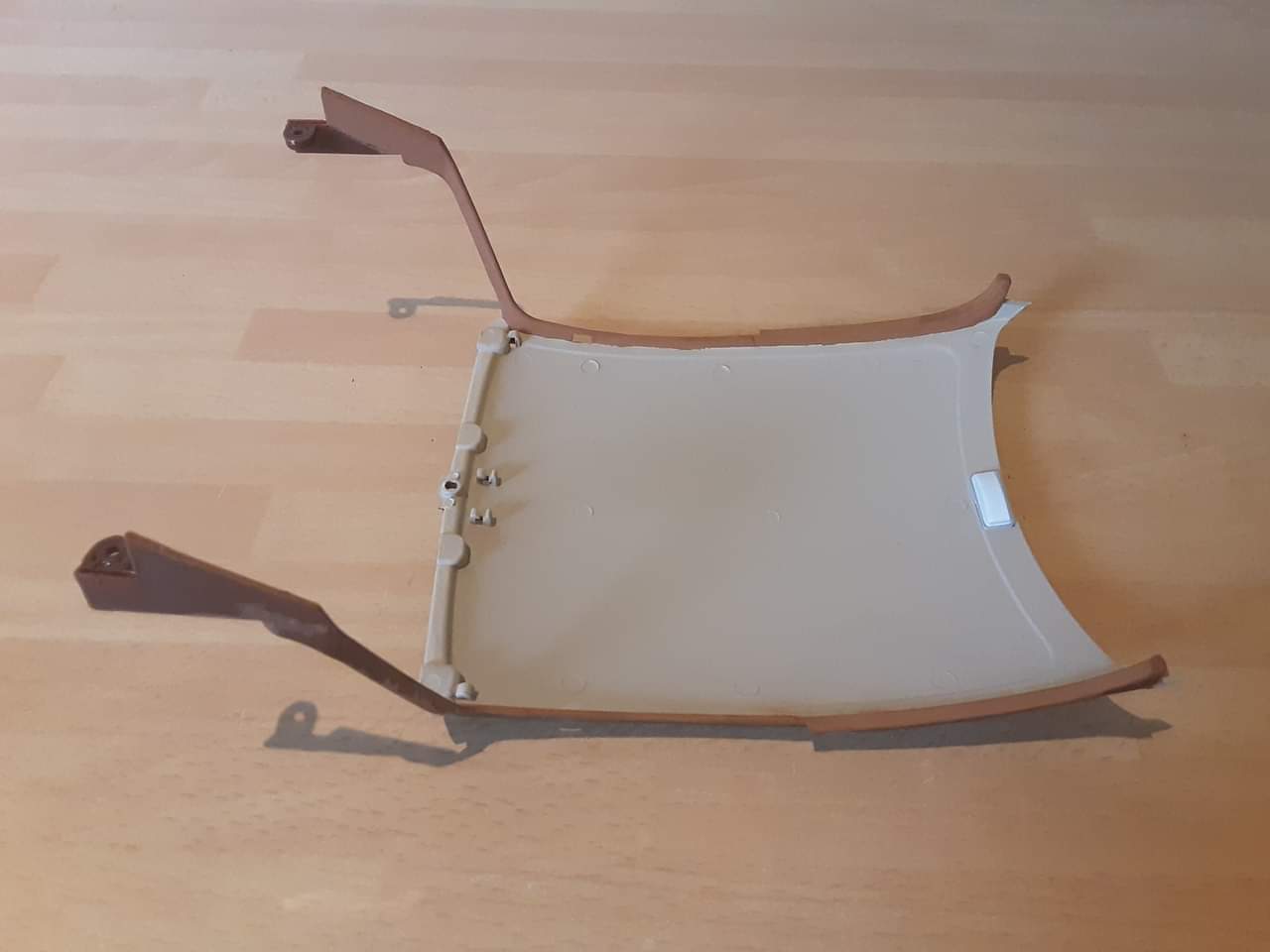

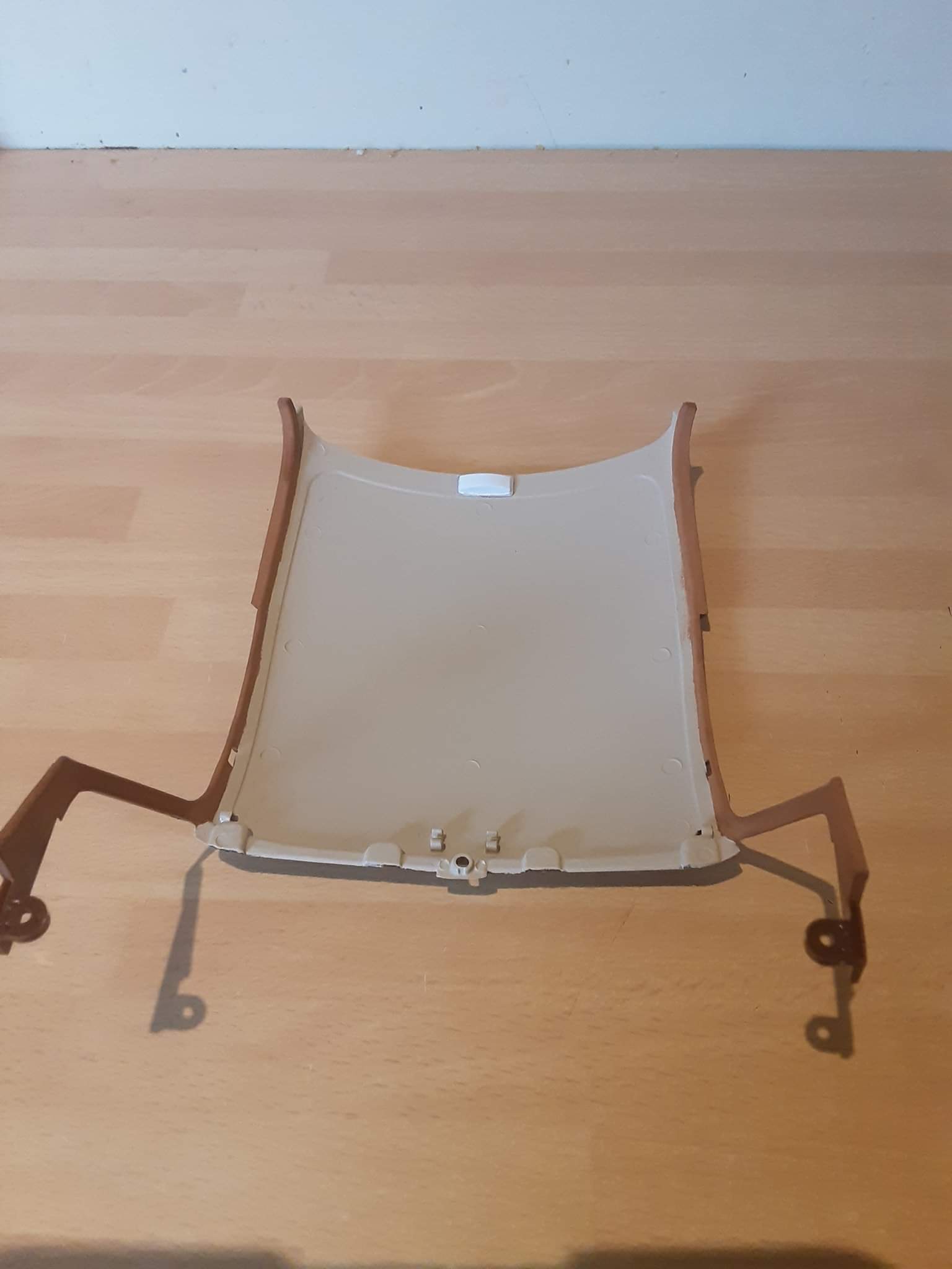

Roof lining has been painted

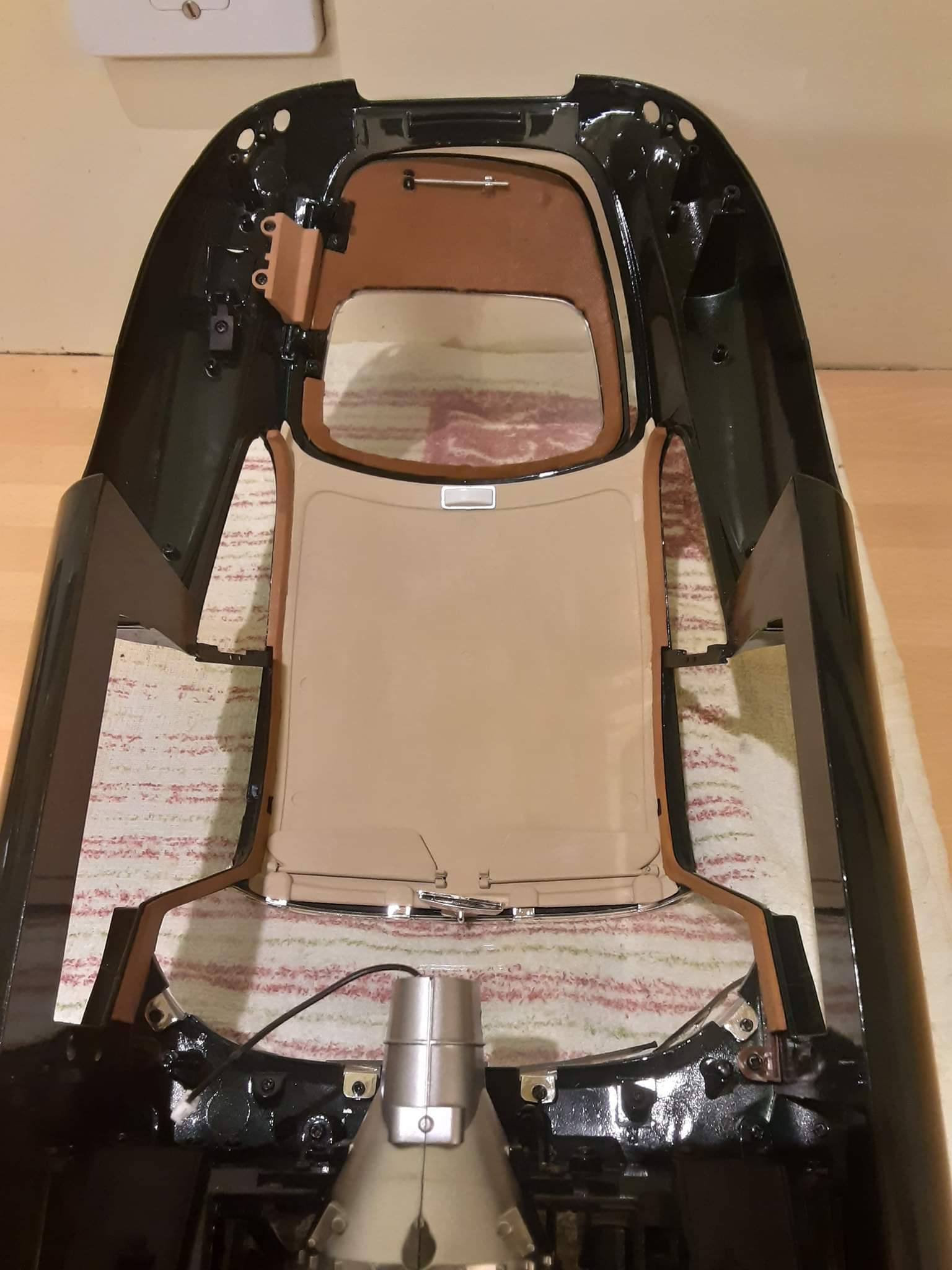

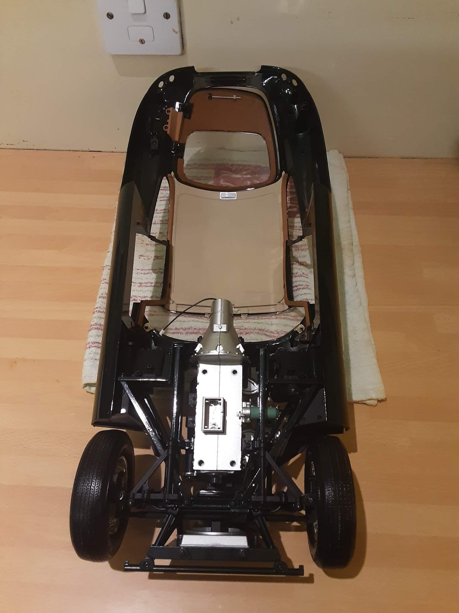

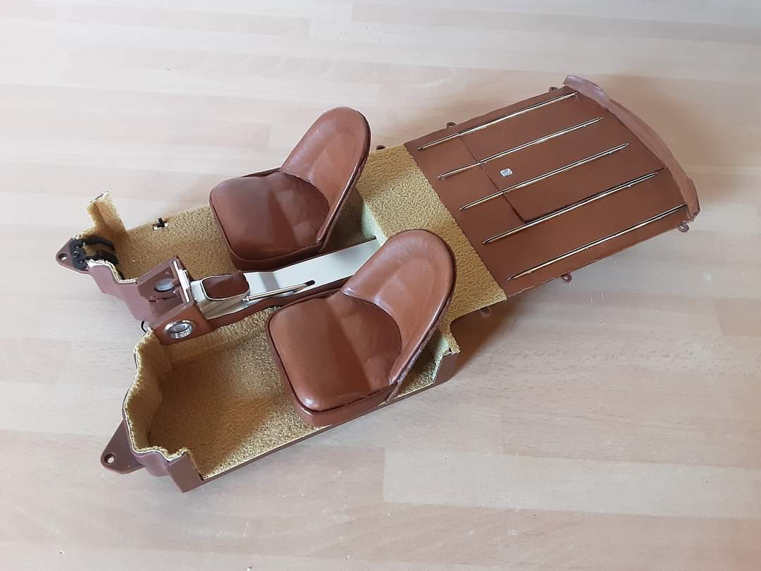

Roof lining now attached to body

Both doors are now done
wwardale

#17 Posted : 30 December 2020 21:16:49
Joined: 25/12/2019
Posts: 218
Points: 659
Location: Manhattan, NY
Very nice! Did you remove any material to account for the thickness of the leather? I have all the leather to wrap my interior too, but I haven’t started yet. I’m thinking that trying to shave off .5mm evenly will likely just result in an uneven surface. But the other issue I want to solve before I start gluing is what to do with the leather edges. I really don’t want the rough edge exposed, so my thought is I’ll try to router a small indent all the way around the perimeter, and tuck the edge of the leather into the created ridge, hopefully making it appear wrapped, the way it would appear on the real door card.
-Dustin
-Leonardo Da Vinci
Currently Building:
Porsche 2.7 RS
Currently Collecting
#18 Posted : 31 December 2020 11:20:33
Very nicely done.Love Love
#19 Posted : 31 December 2020 13:38:25
Posts: 5,188
Points: 15,713
When I built my E Type I trimmed all the interior in leather including the door steps/sills. It made no difference to the operation of the doors as the leather was so thin it didn't matter.
To get over the possible pough edge of the cut leather, I applied mine using industrial D/S tape on the back of the leather. The leather was cut bigger than required, and then stuck to the door panel and pressed firmly down.
Then, turn the door panel face down and gut around it with a new blade.
The leather will then have a razor-sharp edge.
To hide the edge of the plastic I just mixed up a paint colour that matched the leather and painted the edges of the panel.
Simples...
BTW - Great work going on with this build.

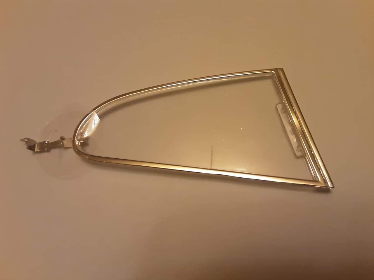

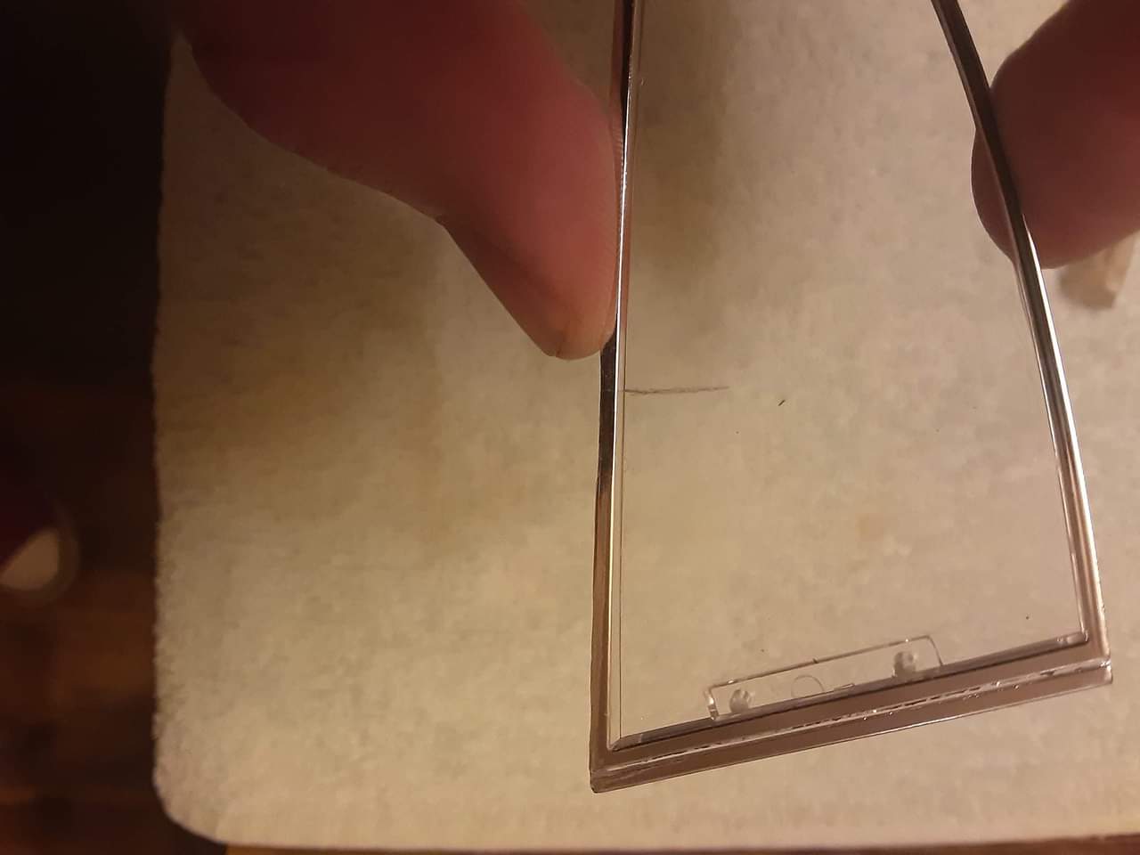

I'm currently on issue number 94 unfortunately the right quarterlight window has a scratch on it would anyone have a spare I could have.
I have contacted model space they want nothing to do with it apparently I bought it from deagostini.I have been given this email address to contact Deagostini the email address is support@econovix.net
Its been over two weeks and still no respond
