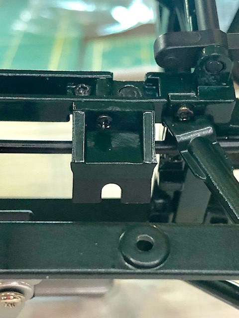

I am presently on issue 32 and I have reached an issue that I need some advice on. In step sequence 22 I can't seem to get the JP04 screw to bite deep enough into the steering rack mounting when securing the right hand lower brace. I have not stripped the hole in the steering rack mounting as I can start a JP04 screw directly into that hole and it will bite. The issue seems to be that the JP04 screw is not long enough to pass through the right-hand lower brace and still provide enough travel to bite into the steering rack mounting and thus secure both parts in place. I secured the steering rack mounting with another JP04 screw in step 23 so I feel that part is fully aligned correctly. It just feels like I need a longer screw for step 22. Any help or ideas about this? Can I use an alternate screw to secure the right hand lower brace? If so what might that be, or any other ideas on how to secure the right hand lower brace without any adverse impact to other steps down the road. Thanks

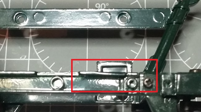

I had an issue at about this point in the build and it was caused by a distorted subframe from issue 23. I hadn`t noticed the problem until later on when I had trouble fitting another part. At the time (over two years ago) it appeared I was the only person with the problem and a replacement subframe cured the issue.
It may/may not be the problem in your case but its something worth checking.
I have attached a pic of my faulty subframe with the bad area indicated.
If you are still having an issue and the frame is ok, try and post some pics of the problem area as it may help others diagnose your problem.

Thank you Derek and Roy for the responses to my problem here. Derek, I did not notice anty obvious issues with the subframe and after spending another hour trying to secure this screw, Roy I feel I have the parts seated correctly. Albeit I realize the tolerances are small and my eyesight is not what it used to be. But even using the optivisor they look to be in alignment. I have attached a few pictures of the right hand lower brace which seems defect free to my eyes. I have attached a few pics of the right hand lower brace in place which seems to fit level . I have attached a few pictures of the steering rack mounting in place attached with the second JP04 screw which I am able to tighten down ( step 23). I have tried to get some pictures of the steering rack mounting hole that mates to the right hand lower brace, which looks to be level and flush with the subframe. Any help from you fellows would be really appreciated. Having spent two hours on this one screw has me at my wits end.
Some thoughts going through my mind are a longer screw, perhaps shaving the bottom portion of the right hand lower brace so that the JP04 screw does not have to travel so far, or even using epoxy to affix the right hand lower brace since the second screw in step 23 is securing the steering rack mounting in place. These fixes seem extreme and I am concerned of unintended consequences in later sections of the build when one deviates from the original engineered design.
