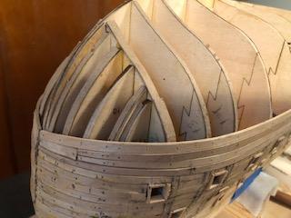

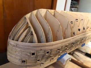

here are two different photos of the bow feel free to copy and cycle the area of
interest or what ever you call it
Ronald

Hi Ronald, I have removed the duplicate image for you and looking at your build so far I have to say it is looking good, well done... Now to get you back on track....
The instructions say to continue planking following the 'techniques' outlined in stages 32/33. So looking at your build I'd say your next step is to determine whether you need to fit a tapered plank at the bow or whether you need to fit a dropper. How to determine whether you can simply use a tapered plank is shown in Stage 32, steps 2-6. It is more than likely you would need to fit a dropper rather than a simple tapered plank.
If you find you need to fit a dropper than carry out the process outlined in stage 32 (Fitting Dropper Planks), start by fitting the two spacer planks between frames 17-19. When I did the Official Video Build, I found that stage 36 started with the need to fit another dropper plank and you see the next 3 rows of planks fitted, leaving the gap at the bow for the second dropper to be fitted. You also see the two temporary spacer planks having been fitted between frames 17-19 ready to start the process of fitting yet another dropper.
Hope this helps you out.... Have also sent you a PM...
