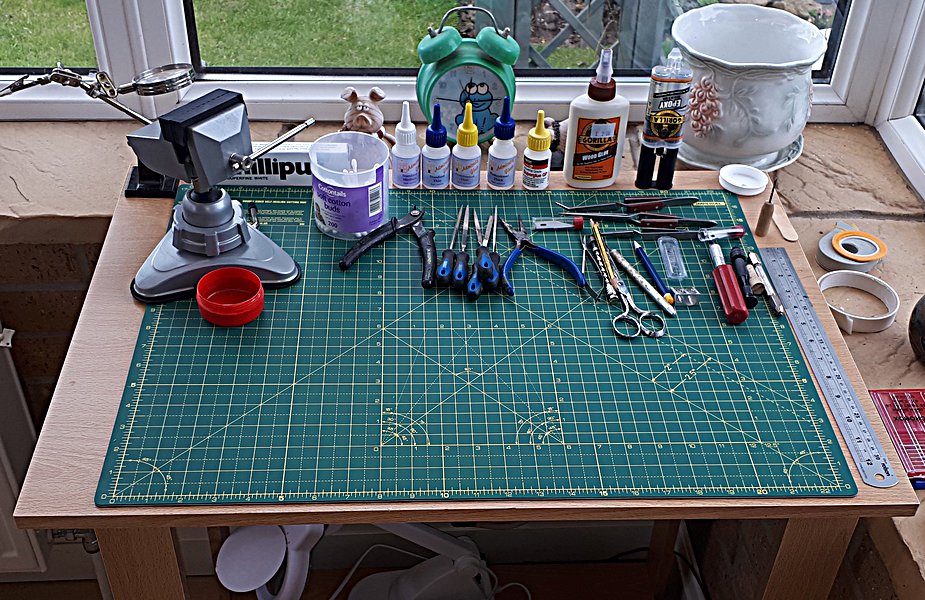

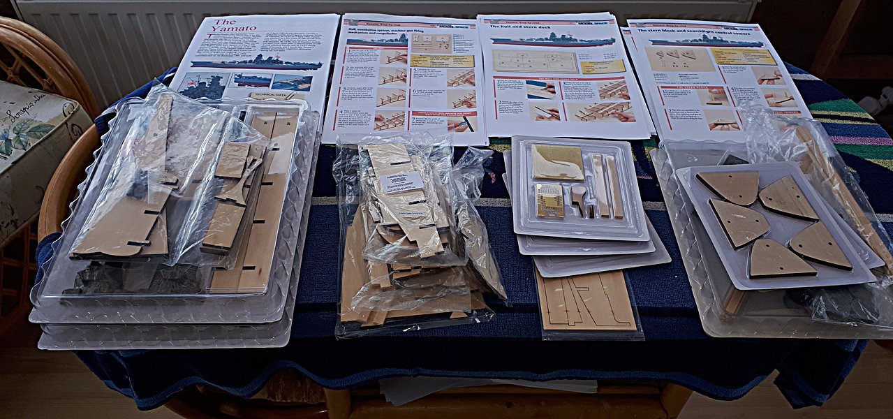

Received an unexpected delivery today, the full kit for the IJN Yamato.
It is taken a few hours to check through all the packs, but as far as I can tell all 90 packs have been included.
The only minor disappointment is there was not instruction manual, and I have to rely on using the on screen build manual. All the build manual files have been downloaded and I have printed out the first 12 documents.

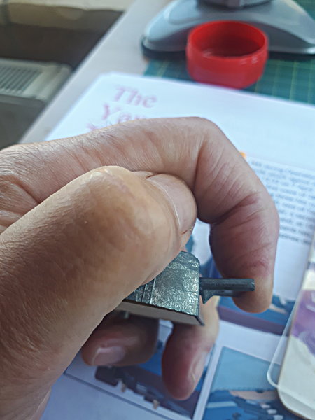

I have just noted the first problem with the bridge assembly in that the two parts do not line up, as can be seen in the attached photo. It is only a fraction out but I think it needs to be rectified.
I have a some ideas to resolve the issue, which include:
a) leave as is and file the different edges smooth
b) file a bit of the top edge of the locating pin to resolve the issue.
c) remove the front pin and see if it can be pivoted in place
d) remove both pins and align by eye.
I think I will try option b) first and if that does not work then I will move on to option c). Failing that I will resort to option d).
I plan to solder the joints for added strength so it will not be a problem if I need to remove the locating pins.

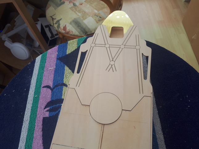

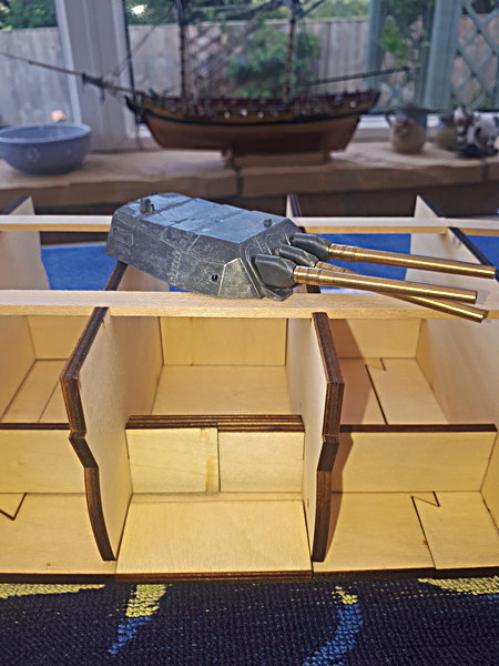

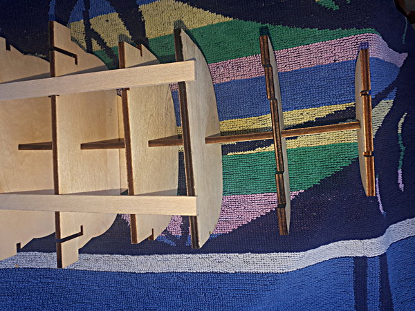

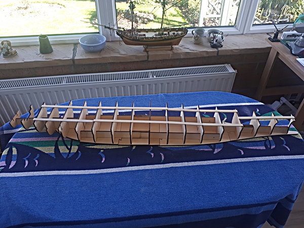

I have now started the build in earnest. My first task was to dry fit the hull assembly. No major issues but there are a couple of warped parts that will need some attention when I glue the parts. Pictures attached.
I also sorted out the bridge alignment issue. I just gave the two locating pins a light file and thankfully the parts then lined up perfectly and have now been glued together. Picture attached.

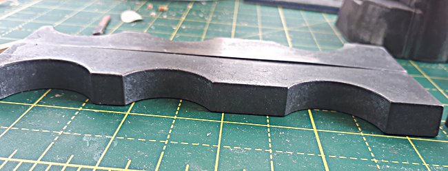

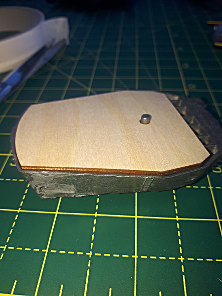

I have noted a couple of issues with the first big gun assembly. The wooden base plate needed trimming along two edges and one of the range finders will need a bit of filing as the locating slot is not deep enough. Pictures attached. I have attached a picture of the dry fit of the gun.

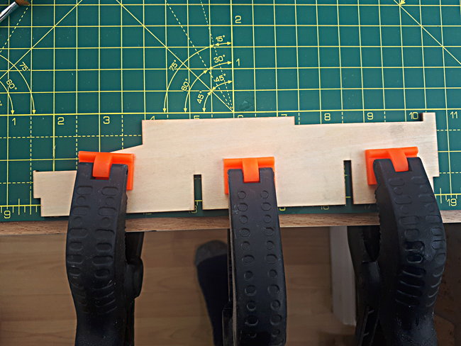

I made a little jig to aid the clamping of the signalling deck to the bridge. It worked a treat.
The range finders for the command post did not fit in the locating holes, but this was sorted with a bit of filing to the top edge of each range finder.
I have sorted out the warping issue with both the base plate and keel support

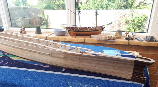

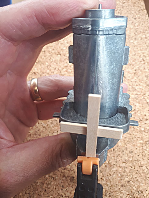

More work on the hull and bridge today. Most of the hull frame work is now complete. I am still sorting out a warp part issue with the keel support and will be this fitted tomorrow so I will then be ready to start adding the hull planking.
I have also added more parts to the bridge assembly. When adding two of the platforms I used a small wooden support strip to hold the part on place as the epoxy resin cured. I made the wooden support strip in 10mm long along one edge and 11mm along the other edge, as can be seen from the attached photo.

My build is progressing well and I have now started to plank the hull frame.
I have also continued to add parts the bridge assembly. In general I'm finding there is a lot of work required on the die cast parts before they can be fitted correctly.

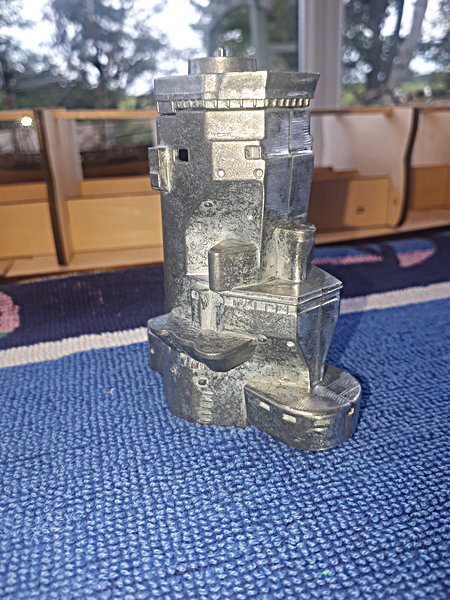

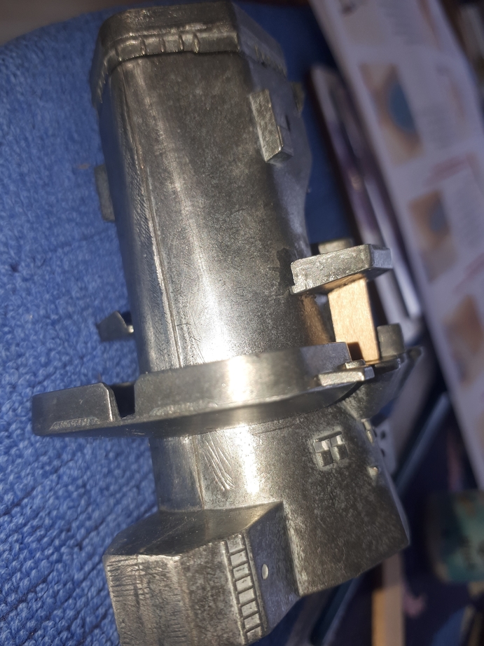

I have been disappointed with the quality of some of the die cast parts. One part, as can be seen in the attached photo, arrived badly warped where there is a 3mm displacement. It might have been possible to use it but it would require a lot of filing and filling with epoxy resin to resolve the manufacturing defect. Model Space have agreed to supply a new part so fingers crossed the new part is not misshapen.

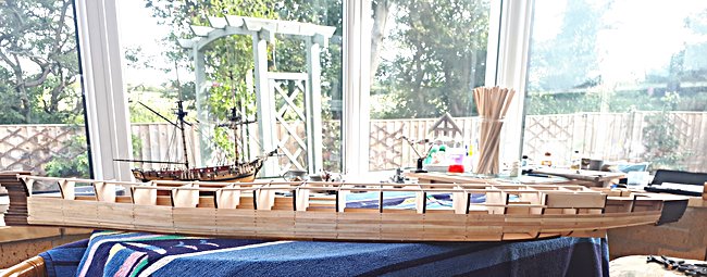

Nearly completed the hull planking. Stern area has now been completed.

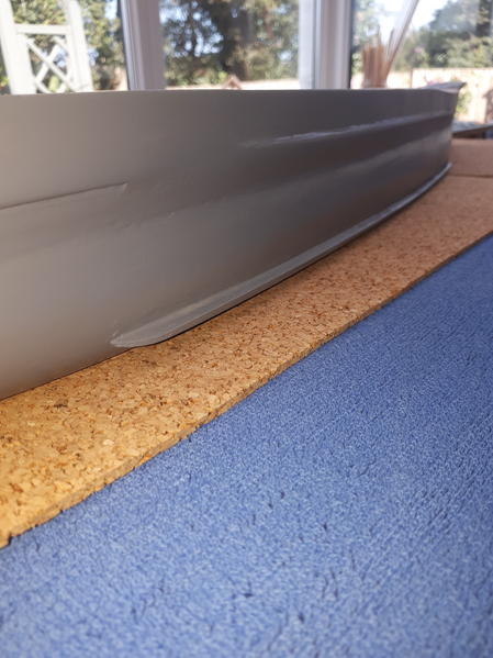

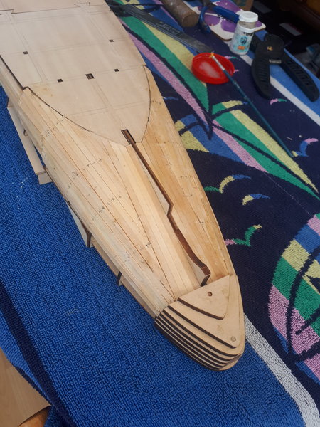

I have now completed adding the strakes to the starboard side of Yamato's hull framework. It looks a bit rough and uneven at the moment which is to be expected. I should be able to complete adding the remaining strakes to the port side in the next couple of days (or so).
Once I have added all the strakes the hull can then be marked out and sanded (and filled) smooth, using the various templates provided to ensure the correct profile along the length is achieved.
I think the sanding and filling process will take some time to get right.

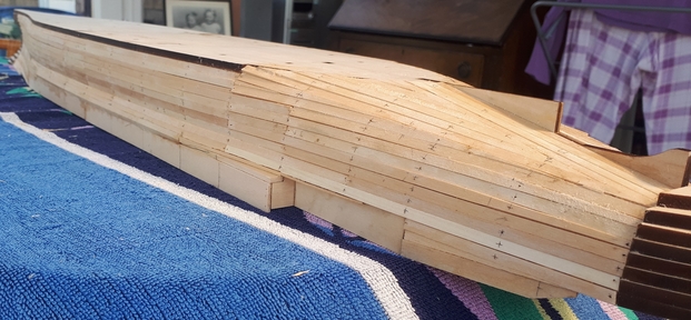

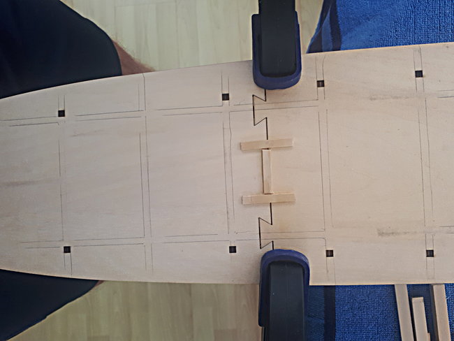

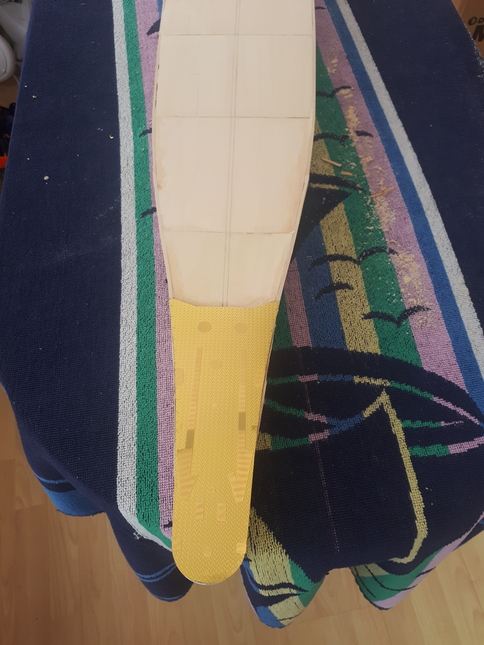

I decided to deviate from the instructions, which requires each deck part to be planked separately and installed at a much later stage. I think it is better to fit all the deck panels first and to then fit the deck planks later on (this is how it was done on the official build log as well). The photo etched parts are only dry fitted at the moment as is the final deck part, as the hanger deck will require painting prior to the fitting.
I found this method was much better for getting the hull profile to fit the sanding templates.

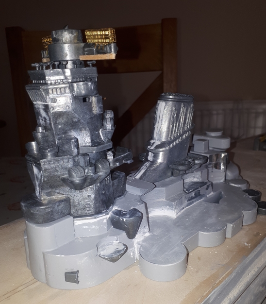

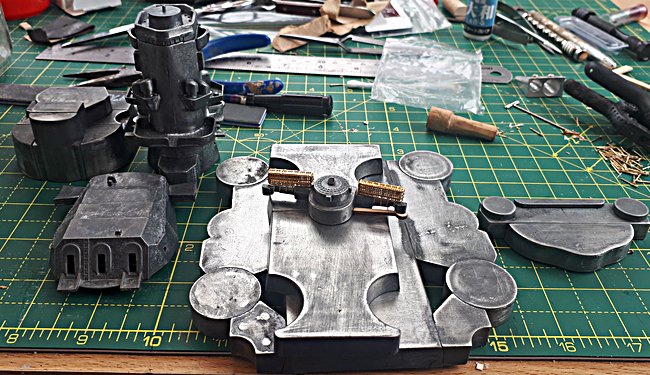

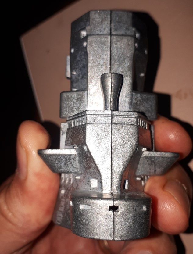

I have continued to work on the main superstructure assembly on my IJN Yamato build (1 / 250 scale).
It takes quite a bit of work due to the poor quality of some of the die cast parts which requires plenty of filing and putty to correct. I have added primer to some parts to help highlight some of the defects.
The main bridge and funnel assemblies have not been glued as yet, as there is still some more bits to add.
Glennard attached the following image(s):

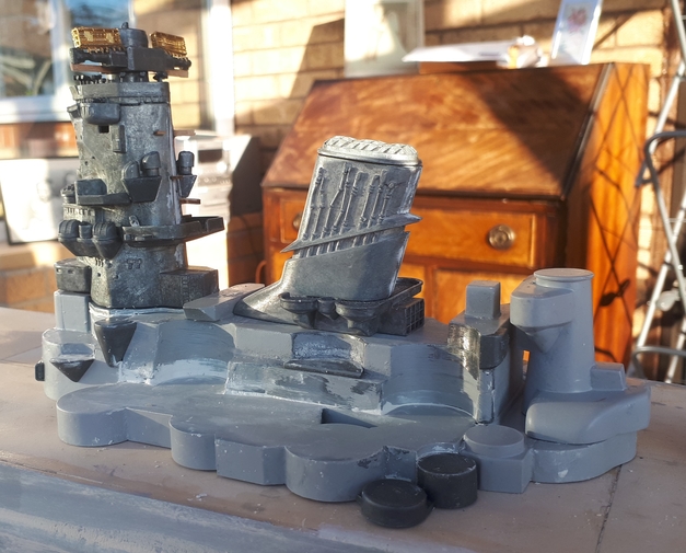

Glennard
#19 Posted : 24 August 2020 20:35:57
Rank: Amateur Level 1
Joined: 09/07/2020
Posts: 31
Points: 111
Another picture
Current WIP: IJN Yamato
Completed builds: Scottish Maid, HMS Victory (Caldercraft) & HM Sloop Brig Speedy (Vanguard Models)
Web: https://modelshipworld.c...-model-space-1250-scale/

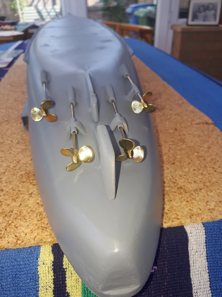

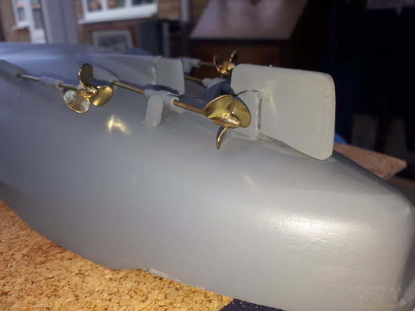

I have continued on with progress, today I added the rolling chocks, rudders and propellers. I have also built 12 off small machine gun assemblies.
