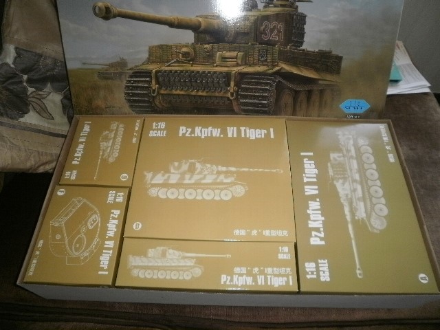

#7 Posted : 01 July 2020 10:59:08
The kit comes well packed and the parts in separate box`sCool

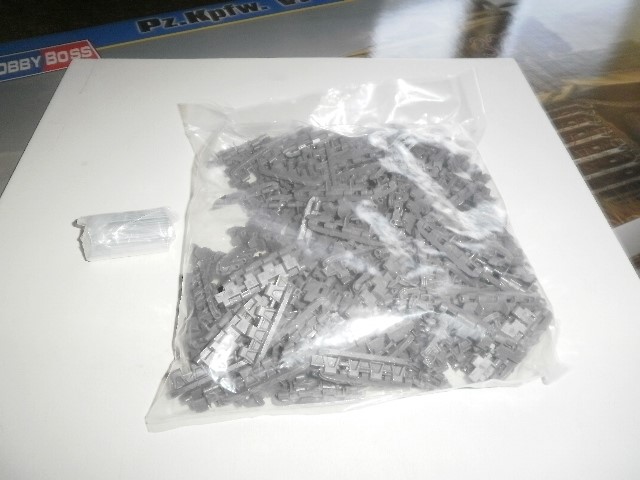

#8 Posted : 01 July 2020 11:01:29

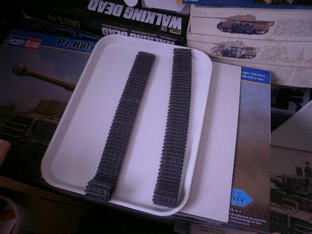

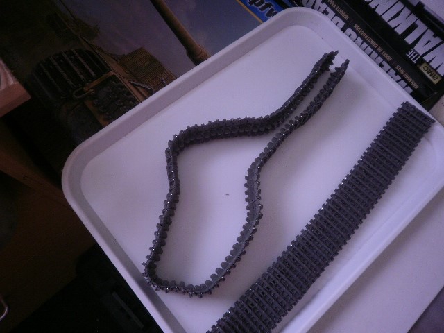

First up i did the tracks which are individual links held together by metal pinsCool

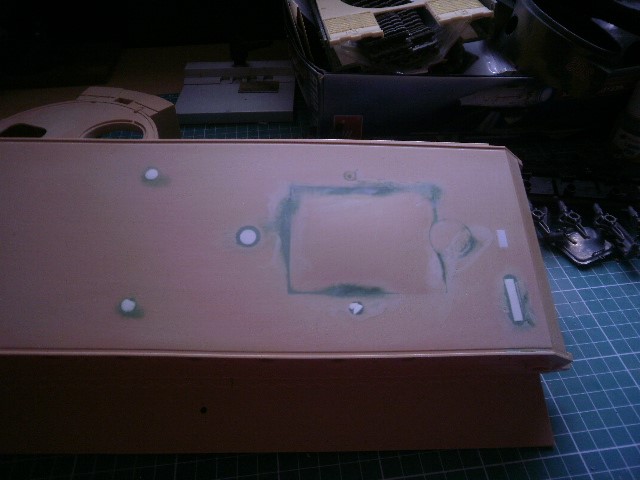

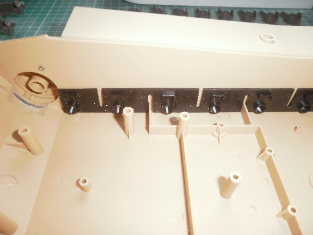

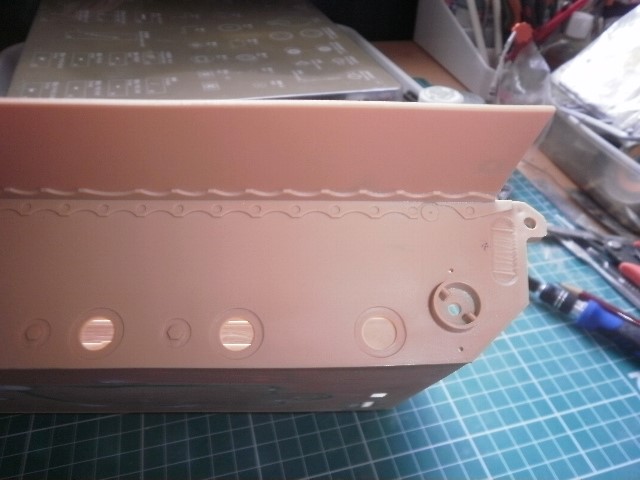

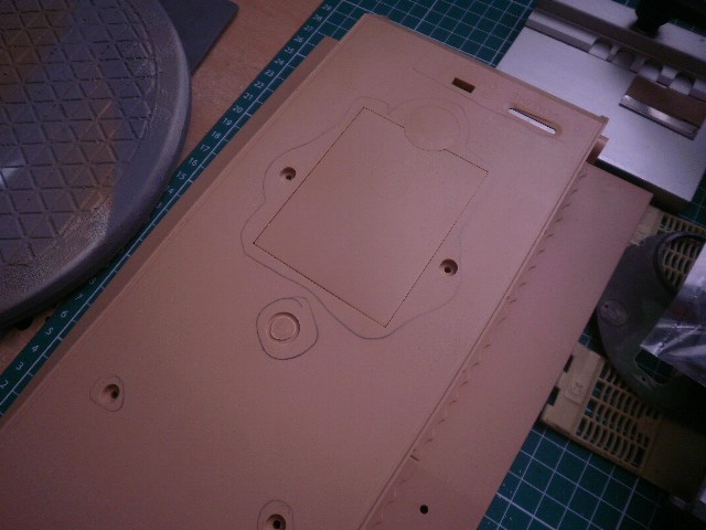

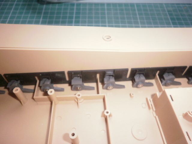

then moving on to the lower hull first i blanked off the R/C holes and filled the battery box edgesCool

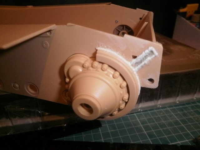

#11 Posted : 01 July 2020 11:11:11

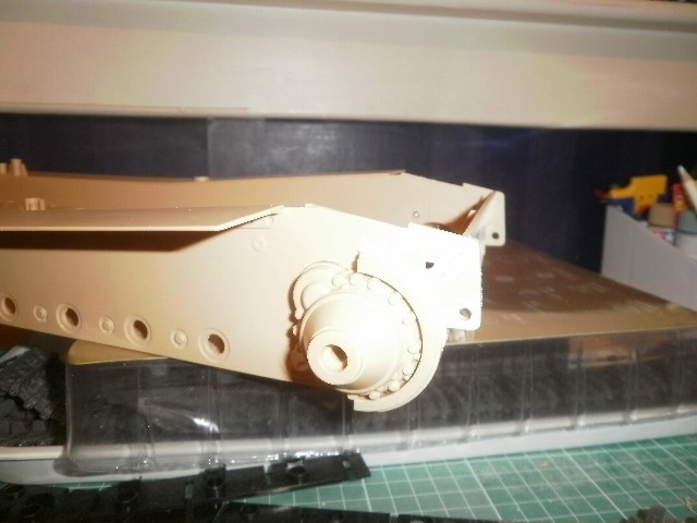

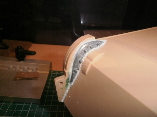

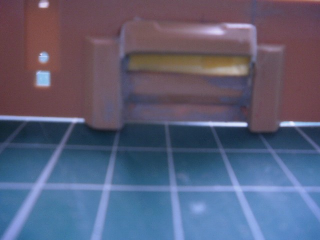

then moving to the front added weld beads to the drive sprocket housing and where the front plate attachesCool

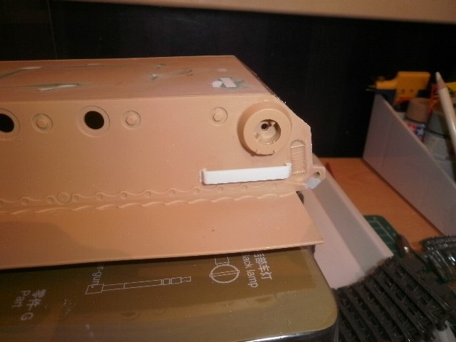

#12 Posted : 01 July 2020 11:18:14

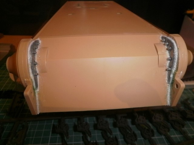

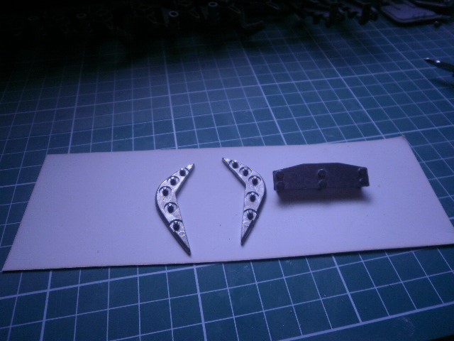

then added the armoured covers for the transmission which where missing from the kit ,these are white metal from Taigen which i got from a company in the uk are priced very reasonable and they stock everything for this scale of tank they are called ForgeBear tanks https://www.forgebeartan.../Featured_Products.html
i then added weld beads around theseCool

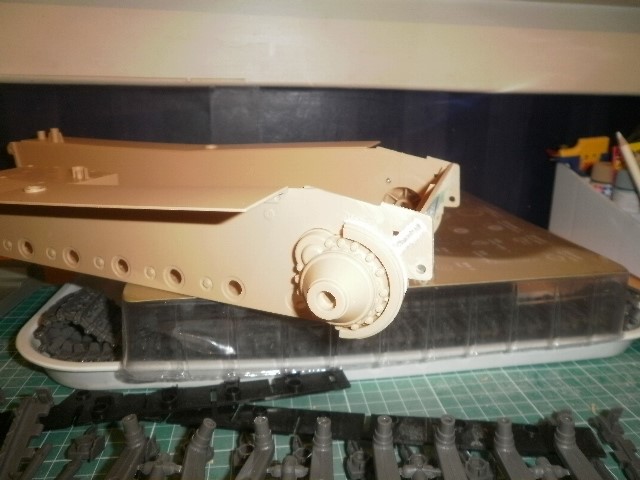

here are the armoured transmission plates before i installed themCool

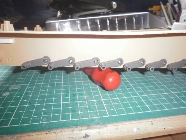

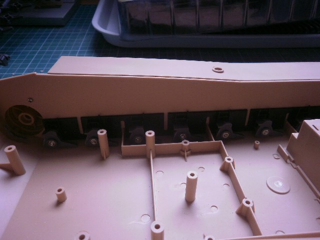

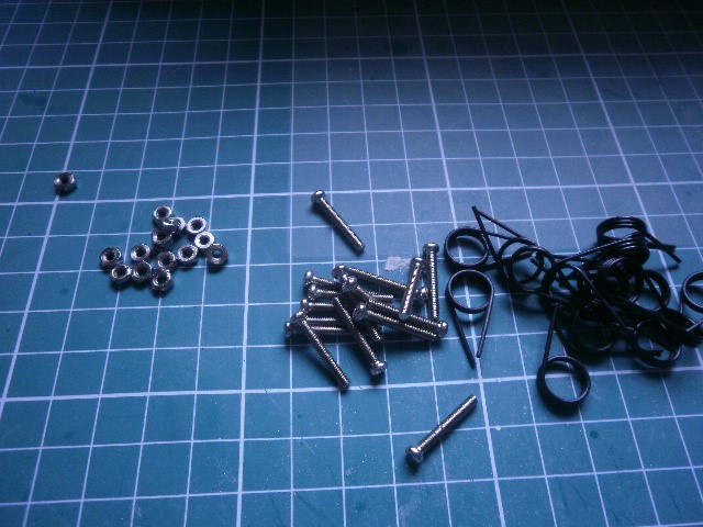

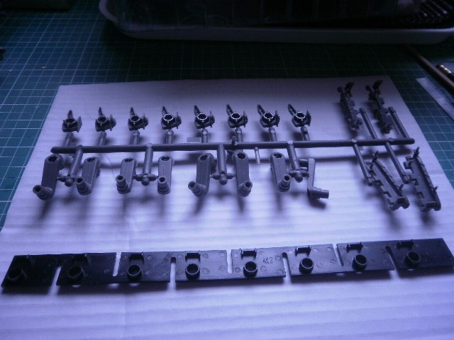

Next up was the swing arms ,which are anchored inside with springs and screws

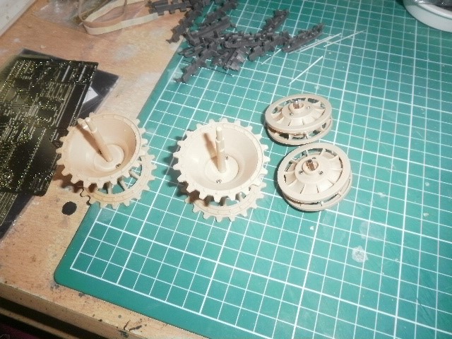

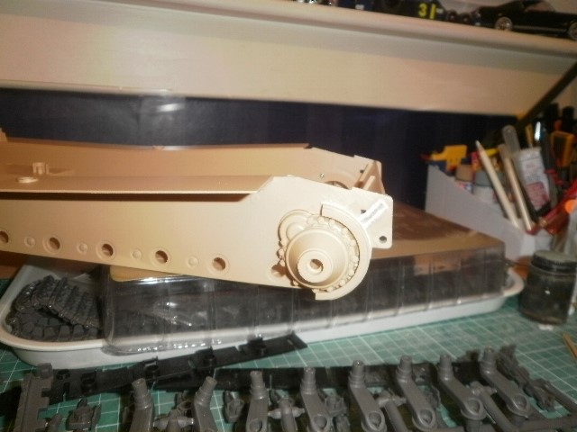

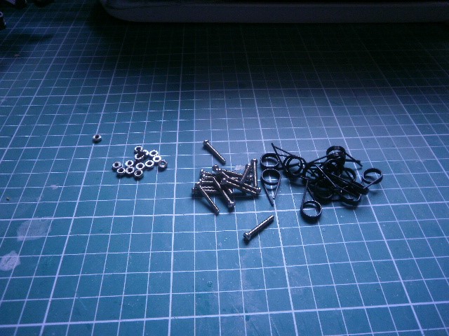

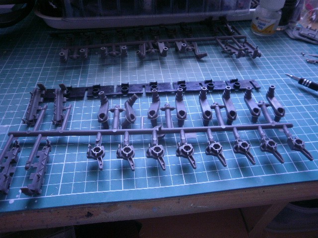

#15 Posted : 01 July 2020 14:18:01
and the idler swing arms screw in aswellCool
#16 Posted : 01 July 2020 14:19:13

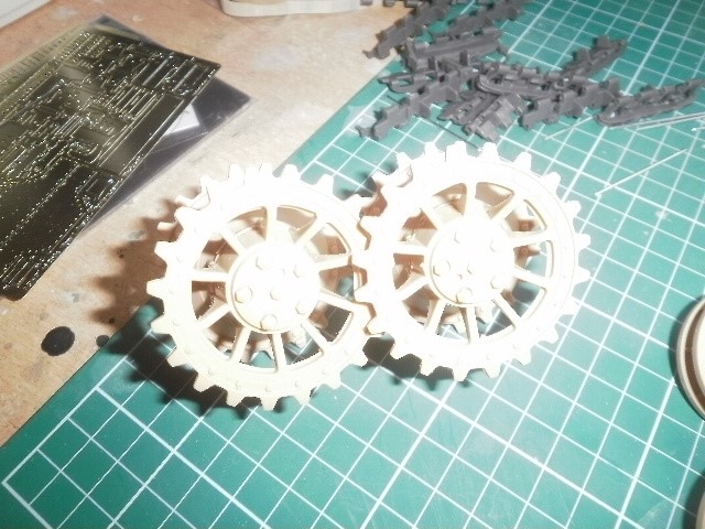

Drive sprockets idler wheels all screw togetherCool

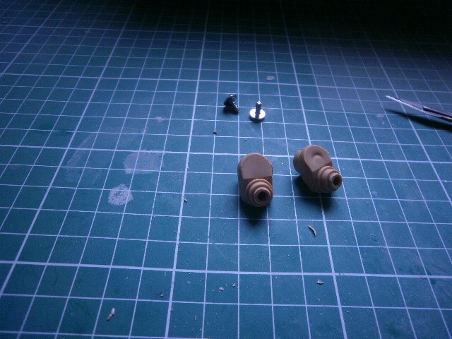

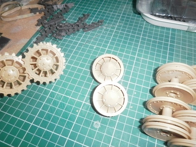

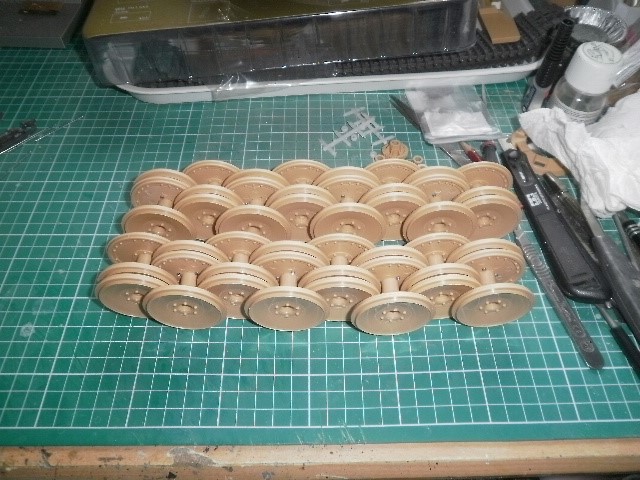

#17 Posted : 01 July 2020 14:22:54

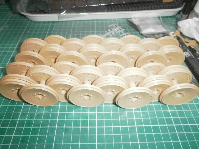

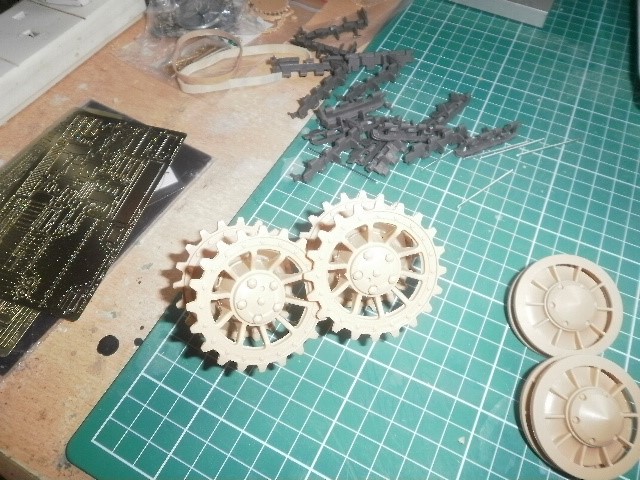

As do all the sets of wheels here shown built up the tyres are separate and are rubber which need to be sanded to rough them up and will be added once the wheels have been paintedCool

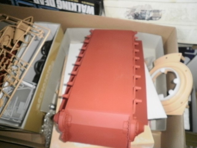

The lower hull was then primed in Halfords plastic red primerCool

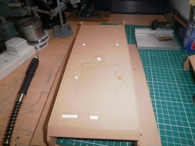

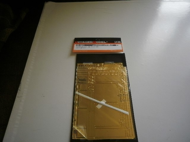

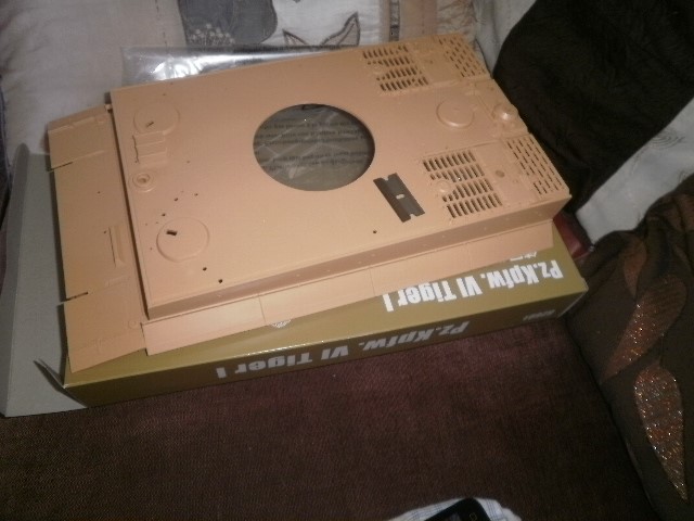

#19 Posted : 01 July 2020 14:30:28

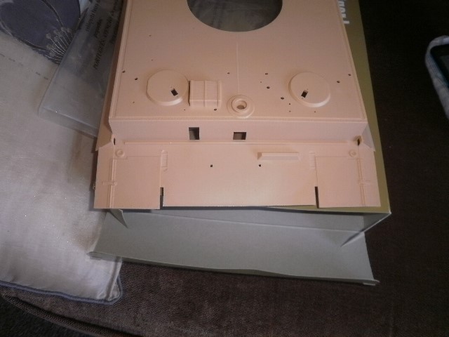

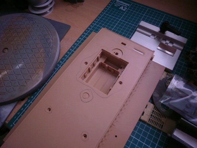

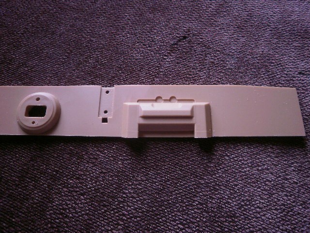

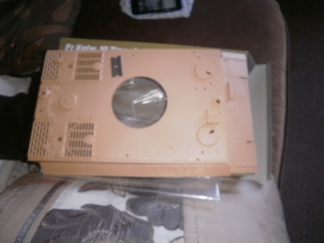

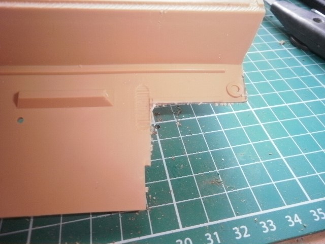

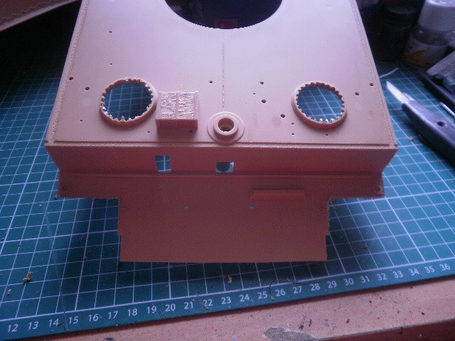

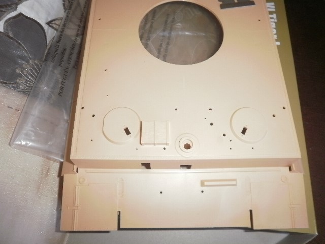

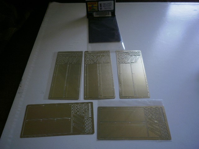

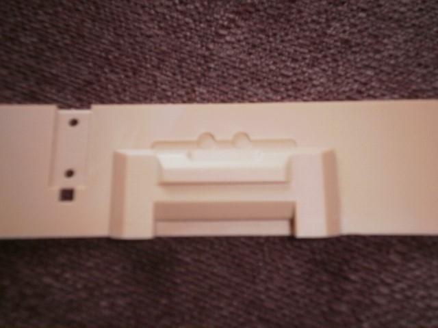

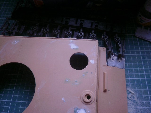

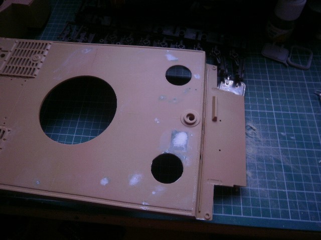

I then moved on to the upper hull and here`s where the fun really began, i wanted to add figures to the tank and the hatches for the driver and radio operator are moulded on as is the jacking block and side fenders along with the front fenders, all these were removed as i wanted to add more detail and Abber and voyager do replacement brass sets along with the Taigen white metal hatches Cool

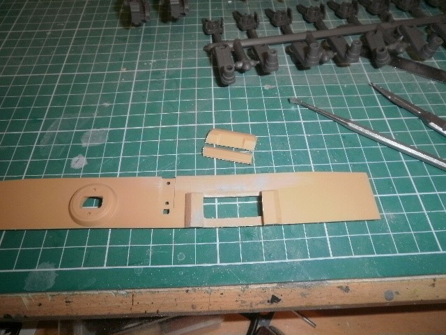

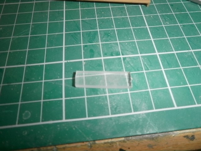

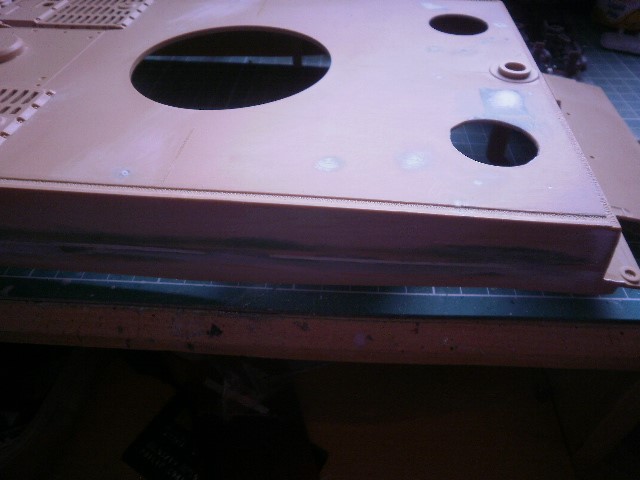

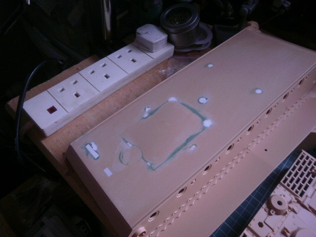

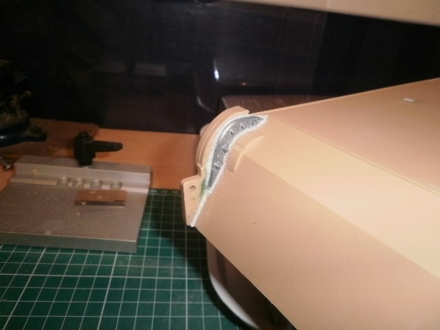

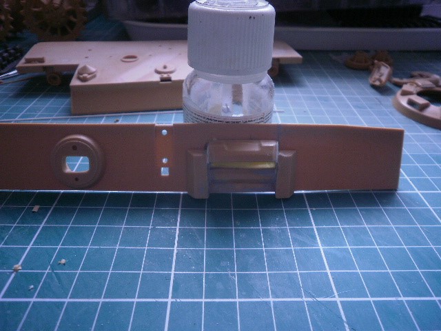

#20 Posted : 01 July 2020 14:42:56

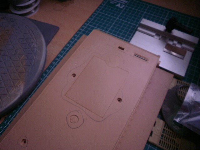

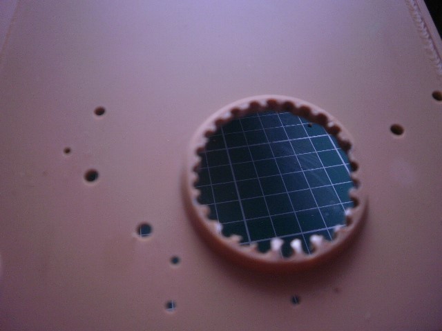

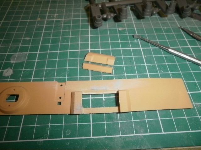

They are all filled and smoothed along with various holes for the tools and cables which will be replaced with the brassCool i turned my attention to the front plate where the drivers block and ball machine gun sits ,the drivers block is moulded shut which looked odd so i cut this out and separated the two halves and added a piece of perspex to it , i think it looks a lot better the gaps were filled with plastic card were the material was removed from the sawingCool
