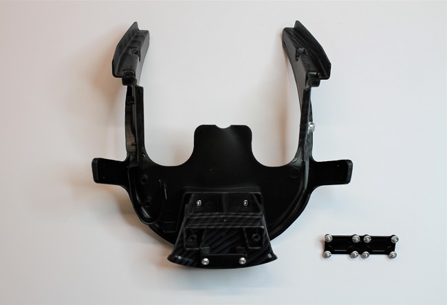

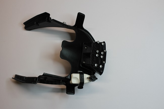

Pack 16 contains parts for stages 59-62

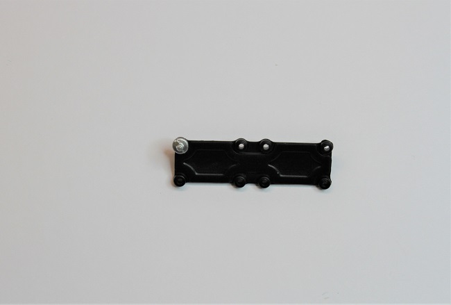

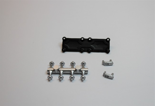

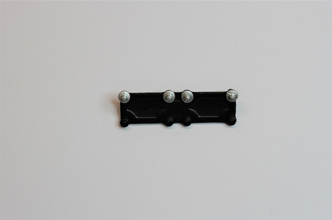

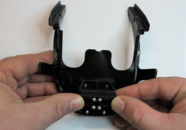

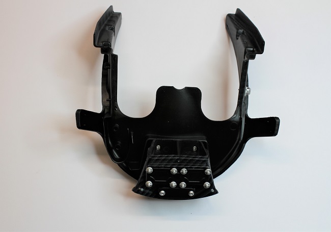

Stage 59
Contents: Air intake top plate, Parts fret, Stops x 2
Remove four of the parts from the fret and insert them into the holes in the plate, using a drop of glue if necessary. Repeat this with the remaining parts from the fret and insert them into the holes in the plate. Retrieve the subframe from Stage 58 and align the pins on the underside of the top plate with the holes in the intake pressing the plate into position.
#2 Posted : 06 June 2020 23:38:36

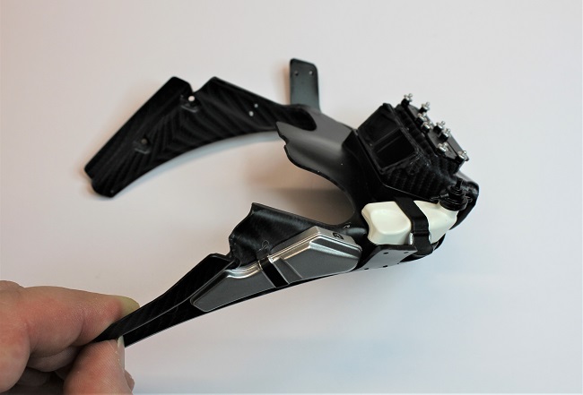

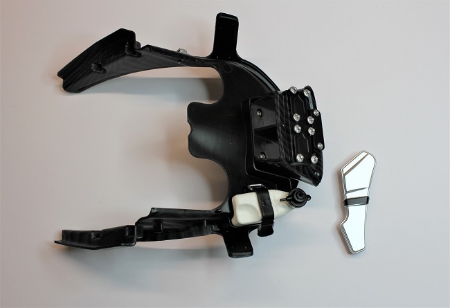

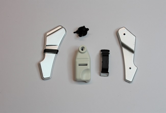

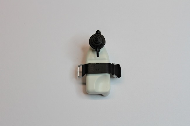

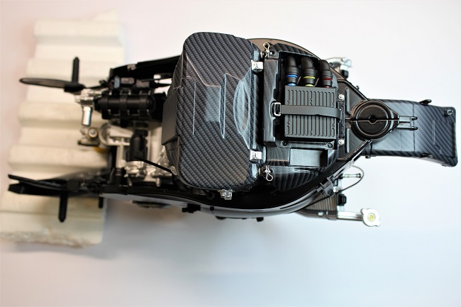

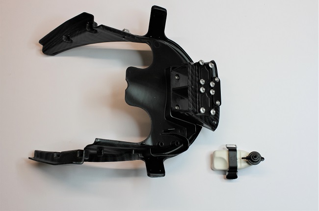

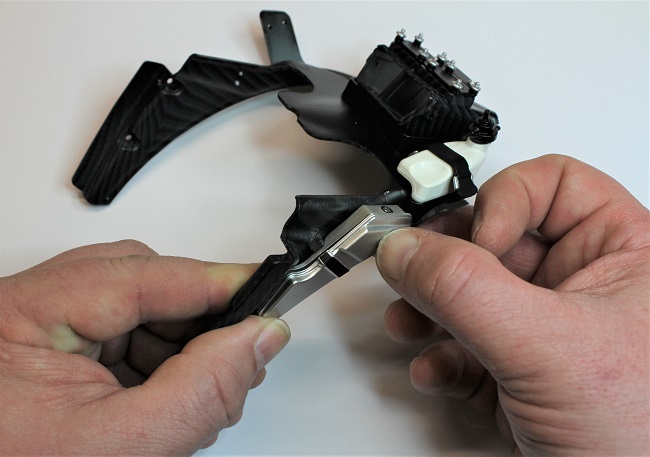

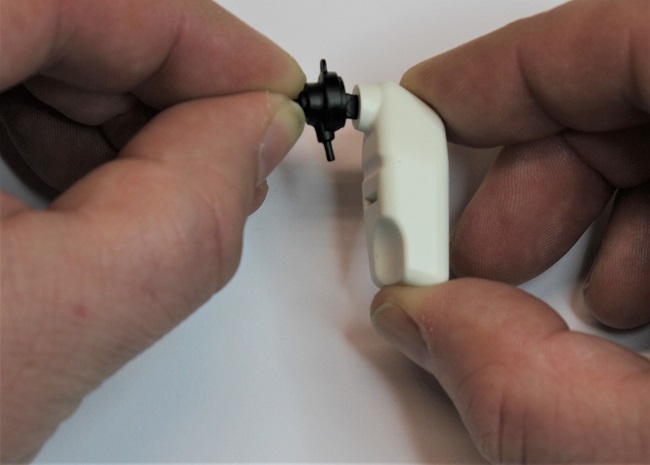

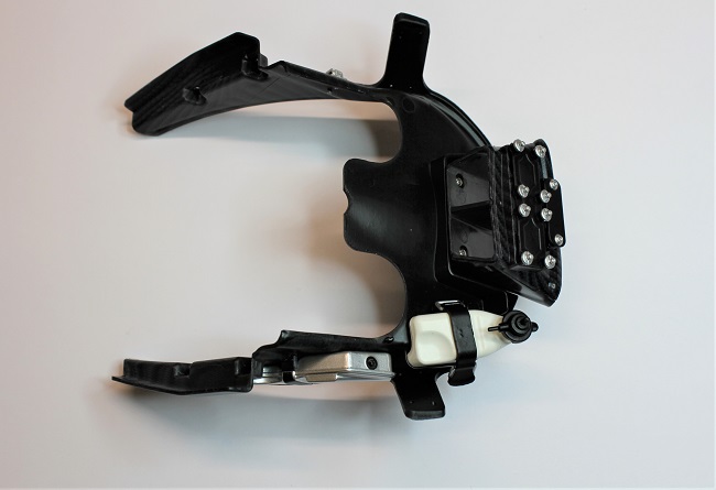

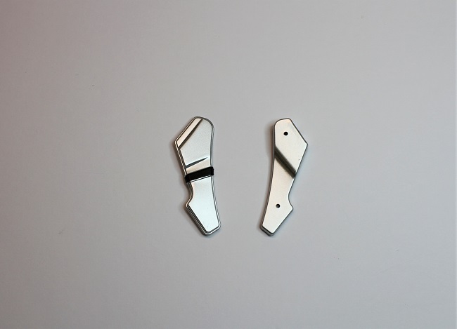

Stage 60

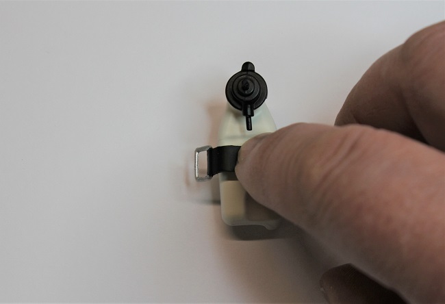

Contents: Coolant tank A, Oil tank, Tank cap, Strap, Coolant tank B
Insert the tank cap into the hole in the oil tank. The cap can only fit in one position. Press the strap into the slot in the oil tank, securing with glue if necessary.
Retrieve the subframe from the previous stage and fix the oil tank to the subframe in the position shown. Use glue if necessary. Join coolant tank A and B together and fix the tank into position on the subframe.
#3 Posted : 06 June 2020 23:41:19

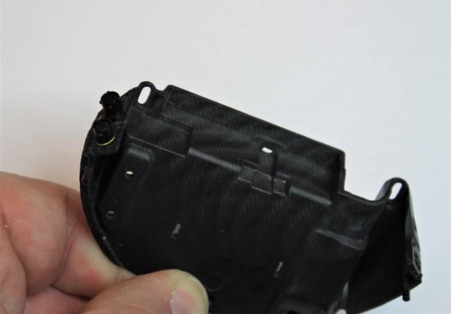

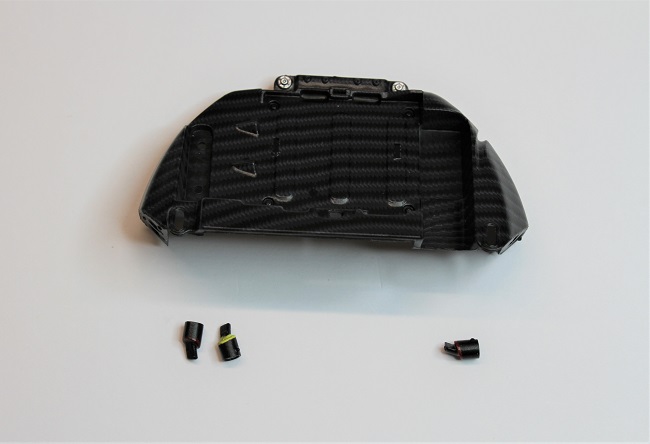

Stage 61
Contents: Control unit support, Yellow plug Red plugs x 2
Insert the yellow plug into the lower hole in the control unit support as shown. Insert a red plug into place above it and the second red plug into the hole on the opposite side of the control unit support.
#4 Posted : 06 June 2020 23:42:44

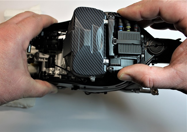

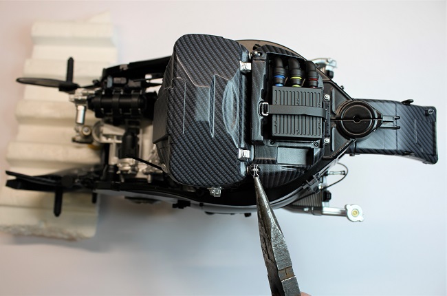

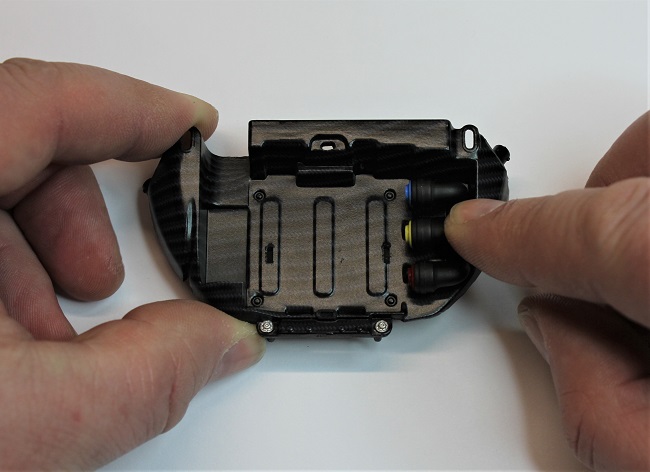

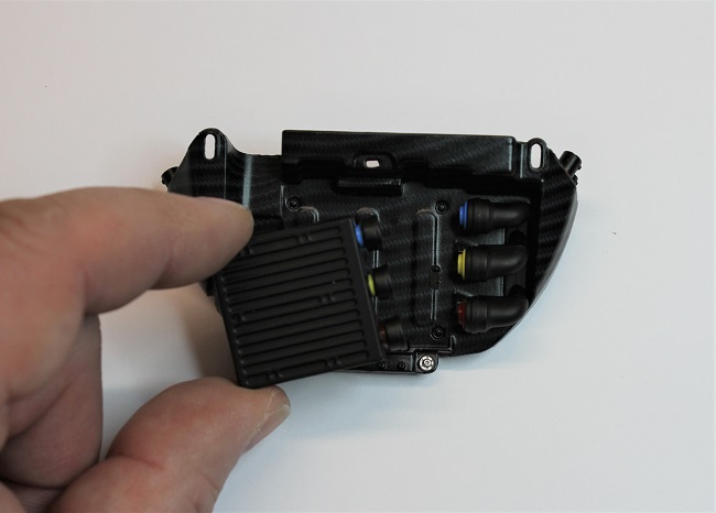

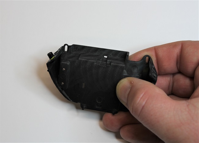

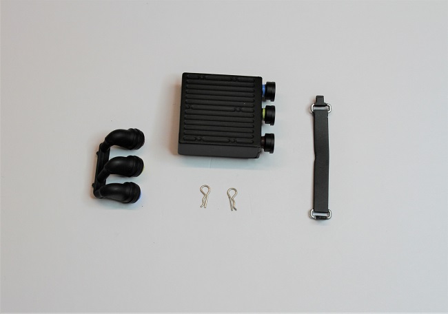

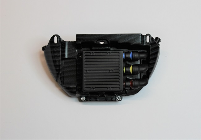

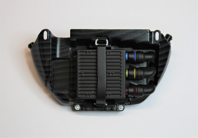

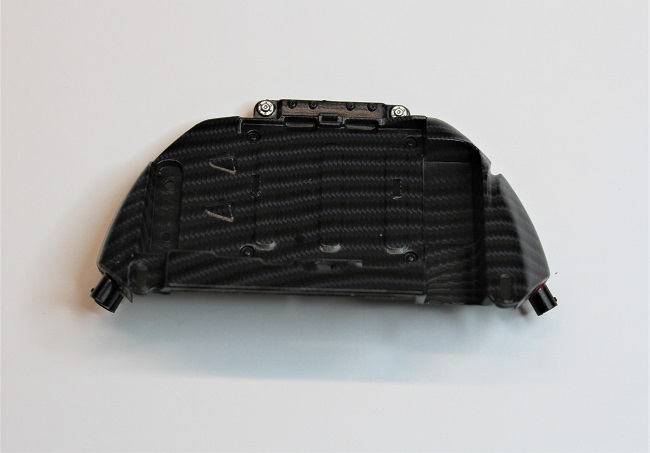

Stage 62
Contents: Electronic control unit, Control unit connectors, Strap, Clips x 2
Insert the two posts on the control unit connector into the holes on the control unit support. Fit the electronic control unit into place in the support and then fit the strap into place, using a little glue if necessary. Now align the circled pins on the underside of the support with the corresponding holes in the top of the frame and fit together.Insert the clips through the circled pins.
