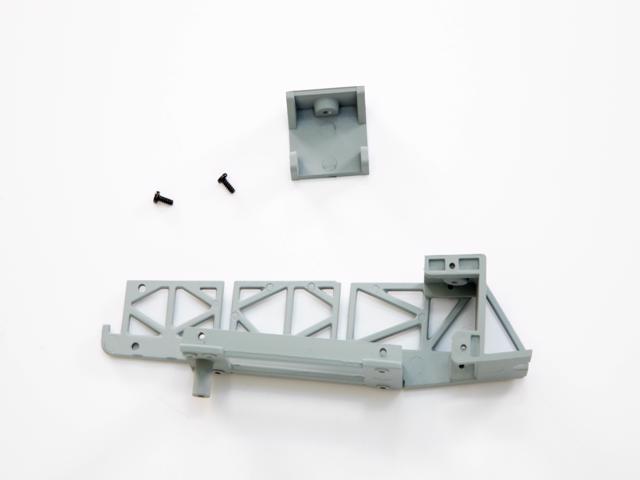

#1 Posted : 02 June 2020 20:05:59

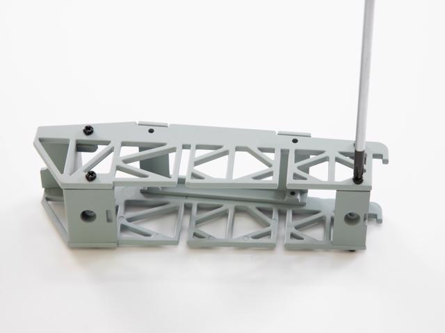

Pack 5

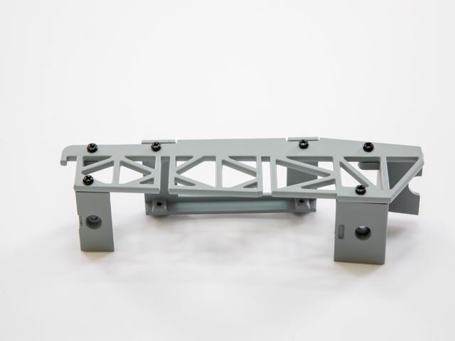

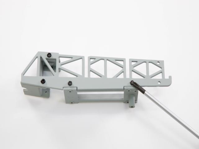

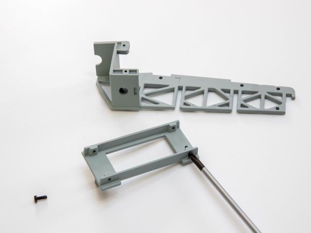

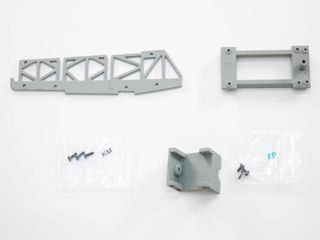

Stage 21: The Truss.
Stage 21 Contains:
Truss left, Truss bottom, Truss front, 3x FP screws, 3x KM screws.
Secure the truss front to the front of truss left with two FP screws. Locating the two notches, secure the truss bottom to the truss left with two KM screws. Here you might find that the screws go in better if you 'chase' the threads, i.e screw each one fully home and remove it before assembly, thereby removing any paint that may have gotten into the socket.
This completes Stage 21. Store any unused parts in a stage-labelled bag for future use.

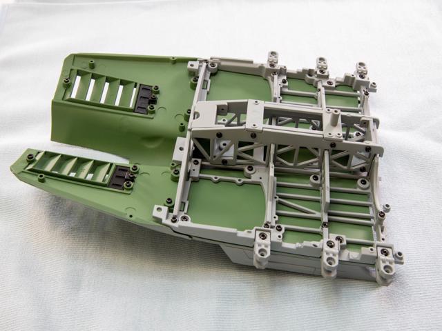

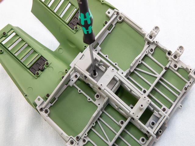

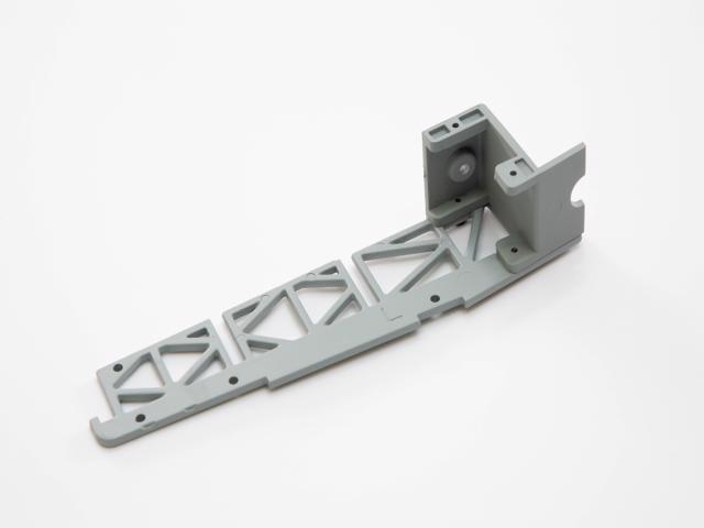

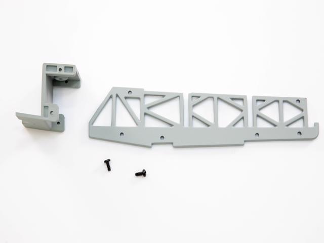

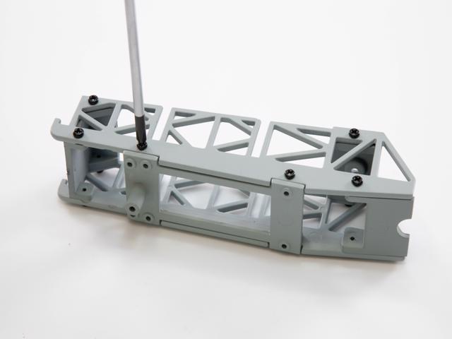

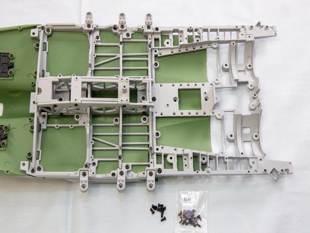

#2 Posted : 02 June 2020 20:27:59

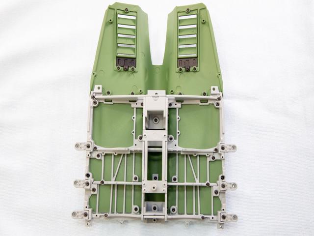

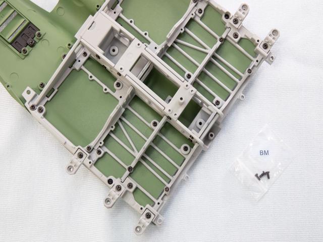

Stage 22: The Truss (continued).
Stage 22 Contains:
Truss rear, Truss right, 8x FP screws, 3x KM screws, 3x BM screws (NOT VM as stated in the build guide ).
Retrieving the truss assembly from the previous stage, fix the truss rear to the inside of the truss with two FP screws. Using four FP screws secure the right truss to the rear and front.

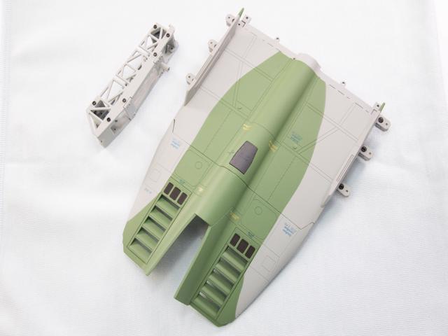

Fix the right truss to the truss bottom with two KM screws, and place the assembled truss between the frames on the inside of the fuselage top.
Aligning the two holes on the truss with the two on the fuselage, fix the truss to the fuselage with two BM screws.
This completes Stage 22. Store any unused or leftover parts in a stage-labelled bag for future use.

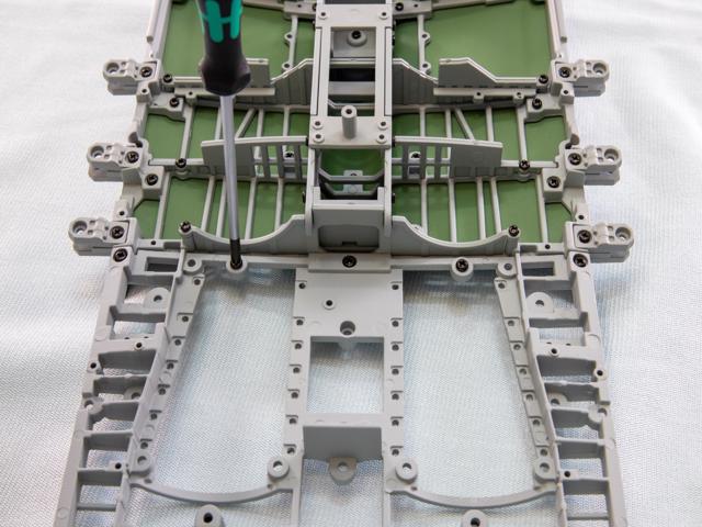

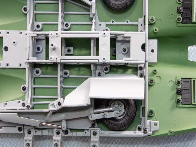

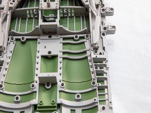

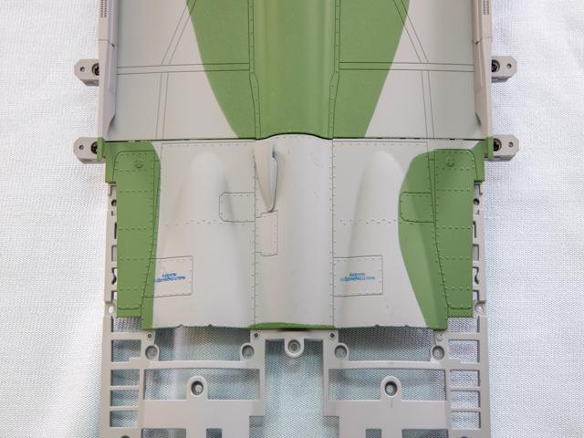

#3 Posted : 02 June 2020 20:51:36

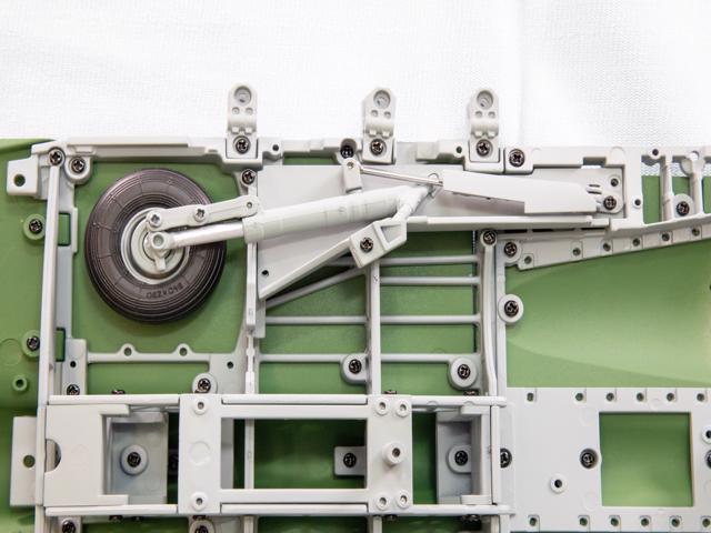

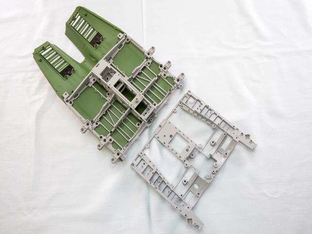

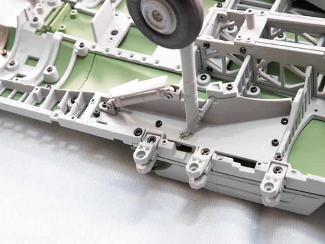

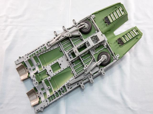

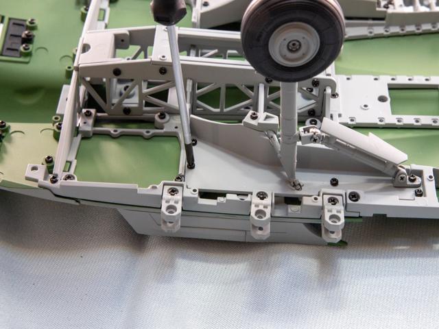

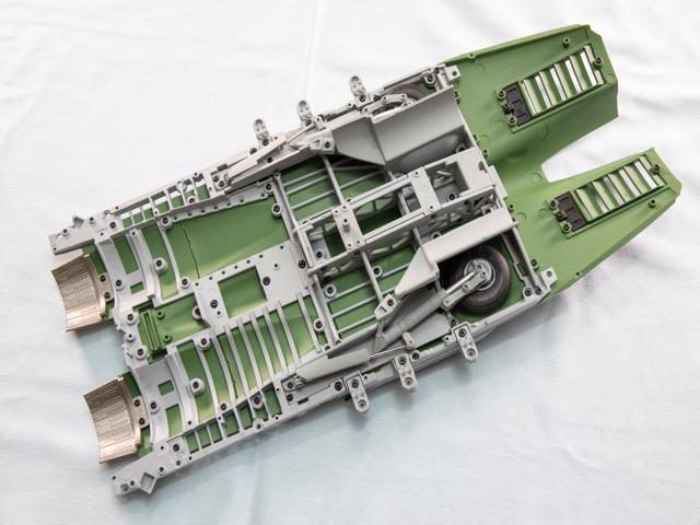

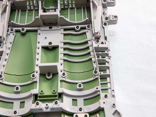

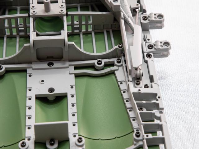

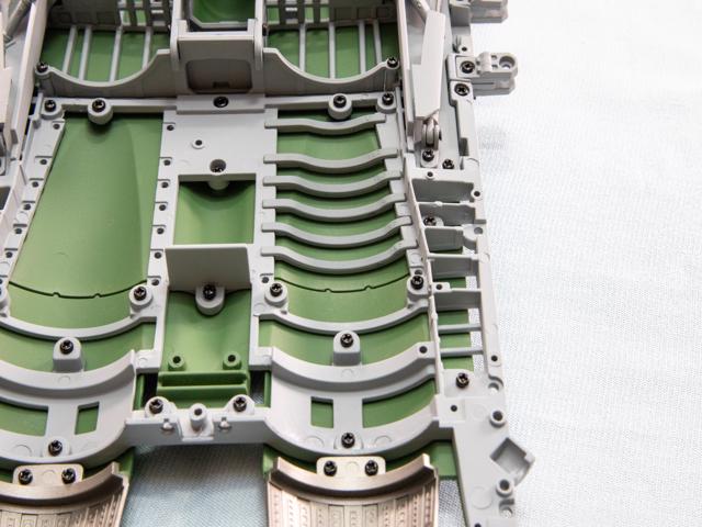

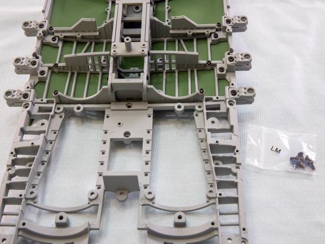

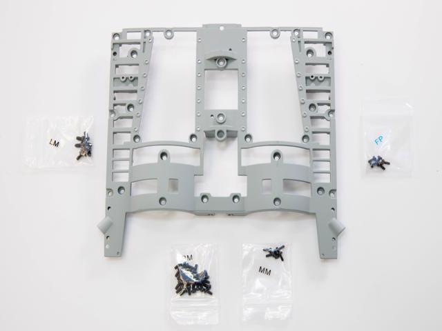

Stage 23: The Rear fuselage frame.
Stage 23 Contains:
Rear fuselage frame, 26x BM screws, 8x LM screws, 5x MM screws, 5x FP screws.
Take the fuselage assembly and landing gears assembled in Stages 17 & 19, and the tail upper fuselage sections from Stages 7 & 9. Connect the rear fuselage frame to the rest of the fuselage assembly and secure with five LM screws.

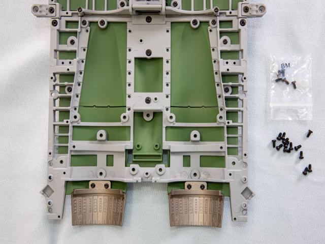

Place the tail upper fuselage section onto the frame and secure in position with eight BM screws. Fit the aft section of the tail upper fuselage section to the frame, securing with thirteen BM screws (leaving 5 spare).

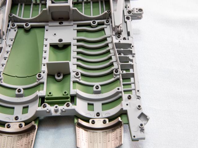

Place the mainwheel assemblies into the recesses in the frame, aligning the holes. Raise the wheels for better access, and secure with two MM screws in the rearmost holes, and two FP screws at the front.
This completes Stage 23. Store any unused or leftover parts in a stage-labelled bag for future use.

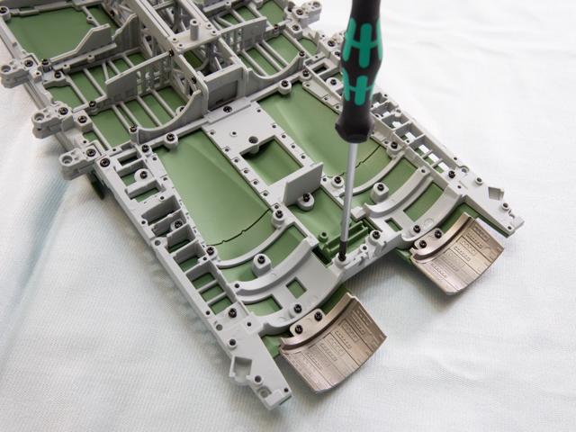

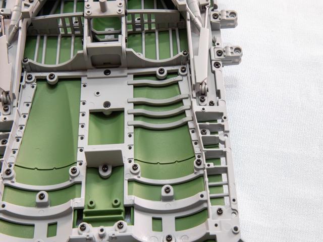

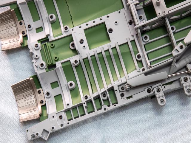

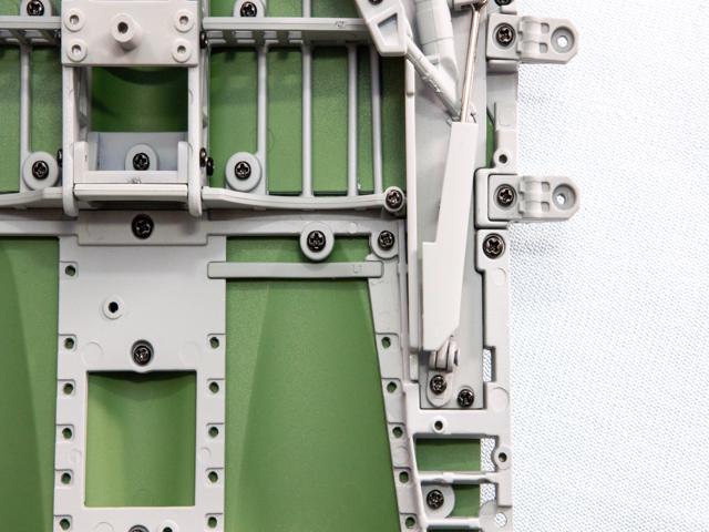

#4 Posted : 02 June 2020 20:59:34

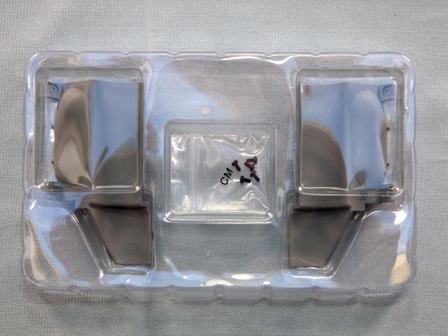

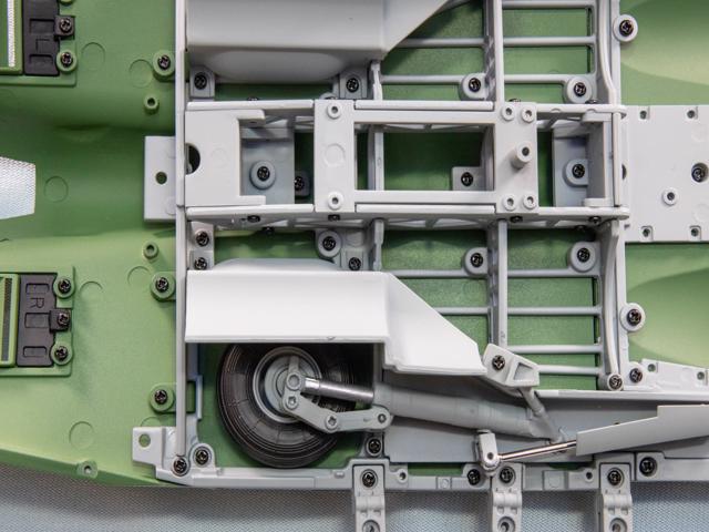

Stage 24: Mainwheel bays.
Stage 24 Contains:
Port mainwheel bay, Starboard mainwheel bay, 5x CM screws.
Place the port mainwheel bay into the fuselage, locating the two pins underneath with their respective holes. Secure in place with two CM screws. Repeat this process for the starboard side.
This completes Stage 24. Store any unused or leftover parts in a stage-labelled bag for future use.

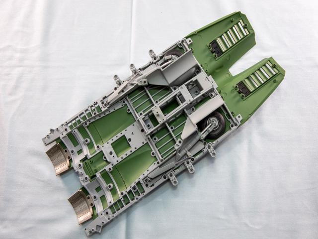

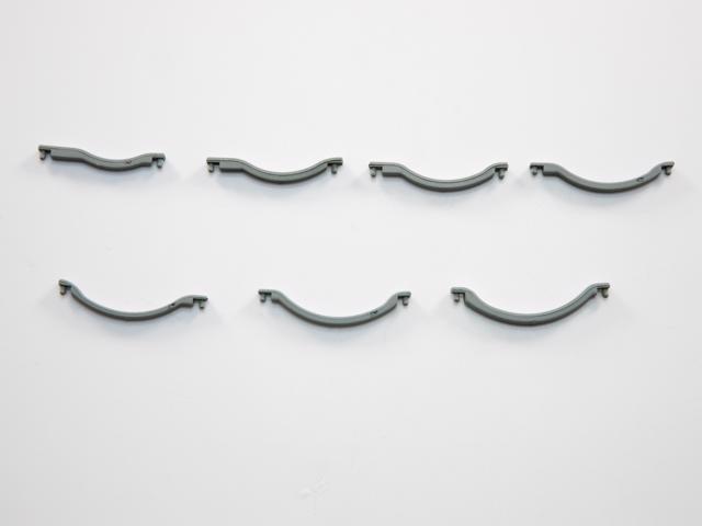

#5 Posted : 02 June 2020 21:06:36
Stage 25: Port engine frames.
Stage 25 Contains:
Frame L1, Frame L2, Frame L3, Frame L4, Frame L5, Frame L6, Frame L7.
Retrieve the upper fuselage assembly, and lay face down. All the frames supplied with this stage are labelled from L1 to L7. Carefully place these frames into the notches at the front of the engine compartment, with the numbered end outermost. Carefully press the end of the frame into place.
This completes Stage 25 and Pack 5. Store any unused or leftover parts in a stage-labelled bag for future use.
