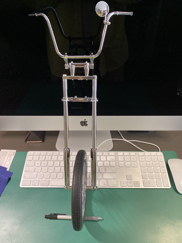

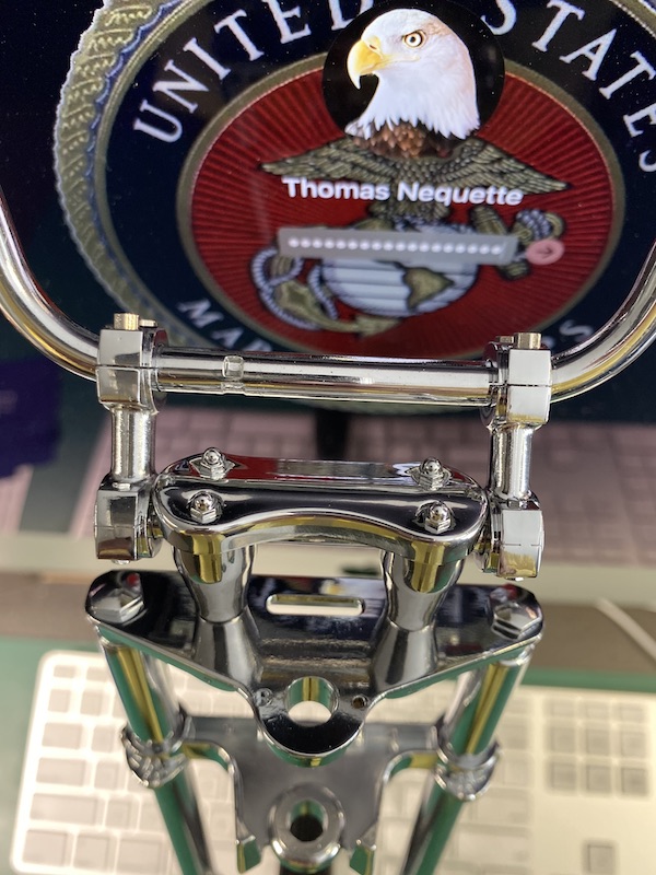

Let's jump in. So this has been a lot more fun than doing tassets on the Samurai!
Stages 1 and 2 were fairly straight foward. As I stated above, check the from wheel hub for chemical residue and brush it off.
Note that Stage 2, Parts 5 -A ( Part 2-5-A), the Handle Bar Mount is not symmetrical as it seems. There are two holes on the top. Be sure that the small hole in on the left. The pictures are correct but this tidbit is not mentioned. Confused Once you pride on the handlebar clamps, the aren't coming off, I know. Just keep that smaller hole to the left and all is fine.
Part 2-6-B, Handle Bar Mount Cover, fits with the dished out side to the rear of the mount. When you look at the underside of the cover, you will see pegs of two different sizes. These orient the cover correctly on the mount. Small pin into small hole on the mount. But if you do as I did, you will have to remove the big pin and and Gorrilla glue it to the top of the mount.Cursing
All the instructional pictures are correct.

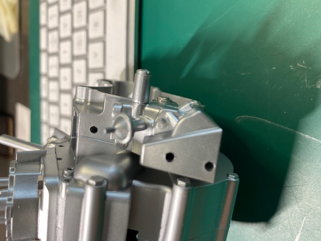

Some help please:
Note the Tappet Guide in Pack 5, Parts 24-B. The instruction pictures clearly two adjusting cap nuts inserted into the holes in the Guide. There is no reference to them. I have not been able to find these nuts nor do they show up in the official build nor on Marks or Graham's build pictures.
Parts never made? Not much of a problem to come up with a work-around.
Tom

mwb
#18 Posted : 19 May 2020 19:28:03
Joined: 22/02/2014
Posts: 201
Points: 589
Location: Big T
I just checked my almost finished chopper and you are right. Don't know how I missed that. Two holes plain as day. Will be interesting to see if there are parts available or do we have to improvise.
#19 Posted : 19 May 2020 20:57:47
tnequette wrote:
Mark,
Have ordered it. Still at impass as Museum is locked down and if(?) the is any detailing to do, I need to see the machine. Your oil wash was great! I do not handle frustration well but do not want to muck things up now.Huh
Tom
No detailing to do other than use the wash on the parts as you go. You will need some odourless turps to thin the oils and clean your brushes.
With regards to the part in pack 5, mine is the same, hadn’t even noticed it.
tnequette
#20 Posted : 19 May 2020 21:40:38
Joined: 22/12/2015
Posts: 246
Points: 776
Location: Birmingham, AL, USA
Believe these fell into cracks between prototypes and production. Plan on searching the spare parts bin towards the end. Still have a lot of Pocher hardware.
At least I am in good company. All is good.
