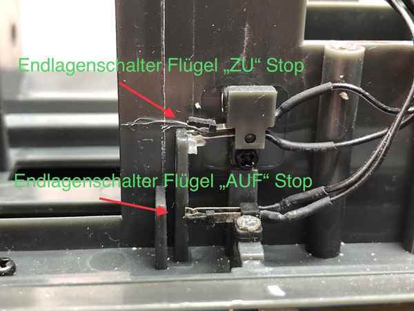

There are reports starting to come in about the motor for the wings not stopping, when the wings are closed. The problem lies with the limit switches, and is a result of the wings having a slight curvature. Wabie, over on the German ModelSpace forums has arrived at a solution, which is detailed below.

Hello everybody,

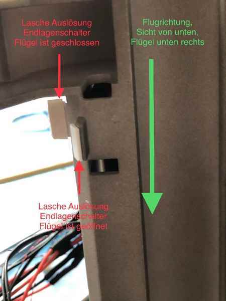

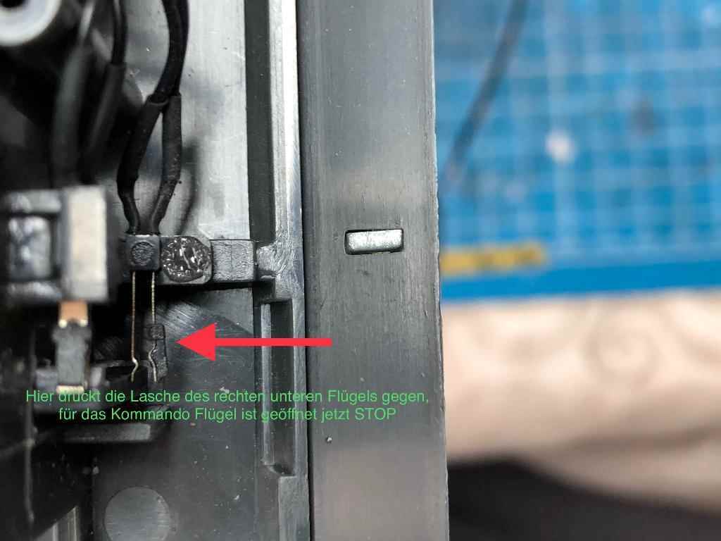

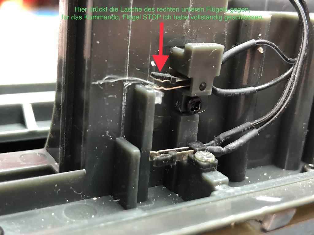

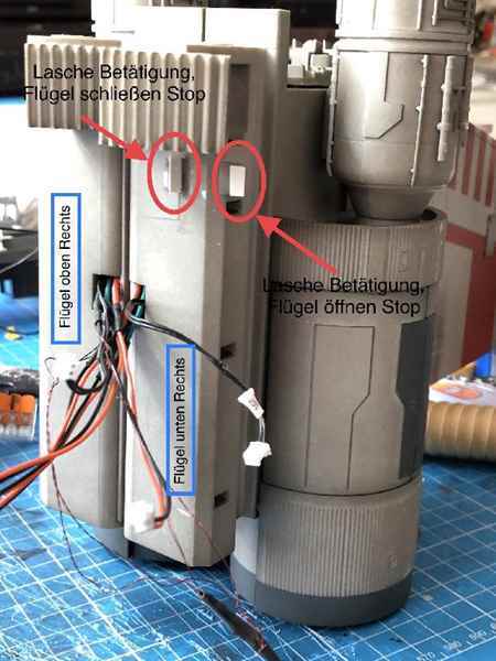

Here is a tutorial if the wings of your build do not do not switch off when closing. This is because the wings have a slight curvature and do not lie flat on top of each other, so the tab for stopping the motor does not come to the limit switch!
I have now labeled the pictures, I hope that you understand that now, by lining the tabs I have shortened the path that the wings cover during opening and closing. This means that the wings no longer open fully and no longer fully open.
https://forum.model-spac...tors/yafEditor/bold.gif
It is now a matter of discretion, how much should the wing open, depending on how much I glue under the flap.The same when closing, if I glue too much underneath, the wing always stays open a bit, everyone has to try it out for themselves.
Important!!!! If you adjust the closing, remember that the limit switch does not trigger, switch off the voltage immediately!!!

Photo caption Translations
Photo 1, from top to bottom: wing motor stop switch, Wing switch "open" stop switch
Photo 2, The tab of the lower right wing presses against this switch tab to stop the wing from opening further.
Photo 3: Here I have added a stop tab to switch the wing closing mechanism.
Photo 4, Captions read clockwise from the top: Wing closing limit tab, (This view is from below the right wing), This is the modified "Open" tab for the stop switch.
Photo 5: Read clockwise from the top left: Wing closing stop tab, Wing open stop tab, Lower right wing, Upper right wing

This fix works perfectly. All it took was a .030" plastic shim glued to the bottom of the tab. Now the wings close and stop when they're together with no gap.
