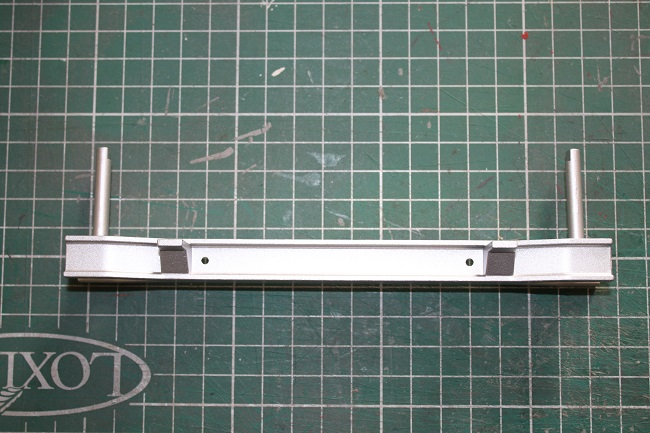

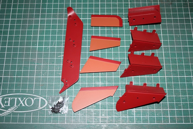

When this first came out it was one of those do I or do I not get it builds. To start with it was 1/12 scale and i usually only build the 1/8 cars, so it was a no. However after seeing a couple of these taking shape I changed my mind and after having done a bit of a look on ebay and Hachette I decided that it was feasible to get a lot of the early issues and start subscribing from issue 56. After purchasing the first 16 issues for a bargain price of £50 inc p+p last August, the build began.
When complete, early next year, it should measure 699mm in length, 203mm wide and 365mm high and be a fair old weight. it will also have the usual lights and sounds and also comes with several passengers which I may or may not use.

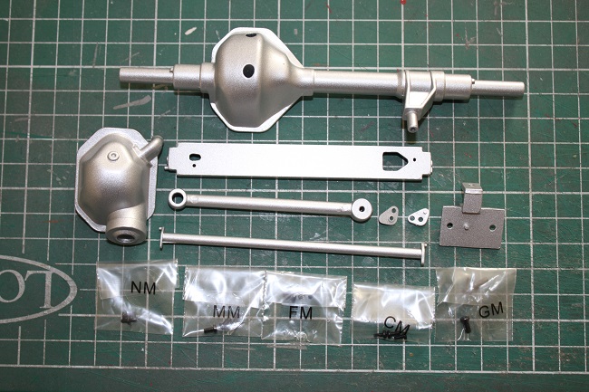

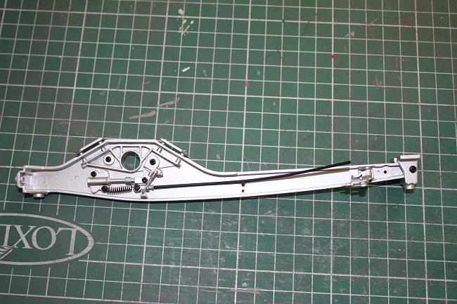

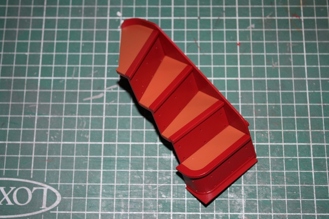

These first five stages consist of parts for the cab, rear stairwell and front axle.

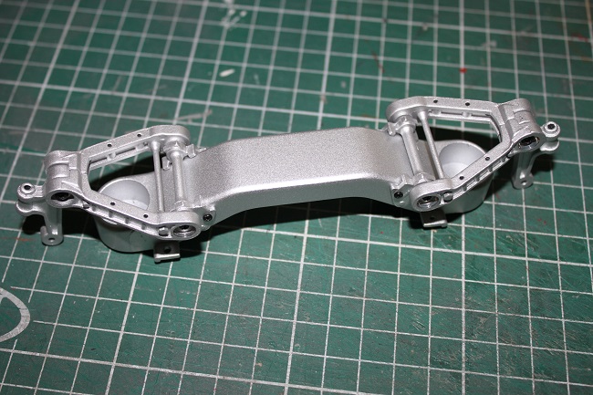

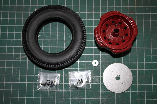

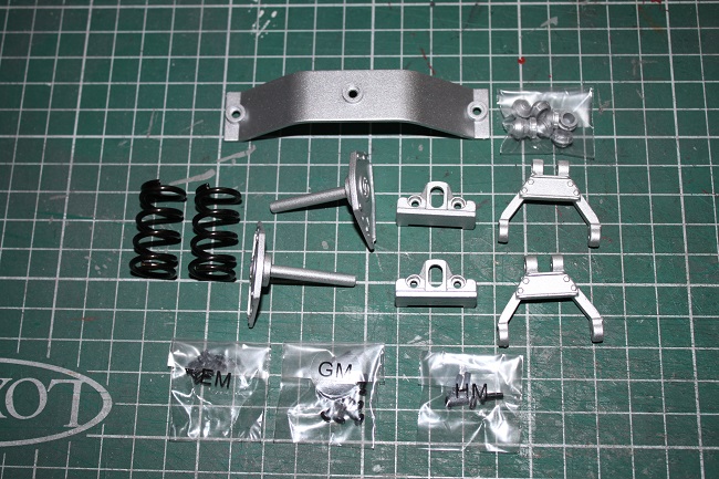

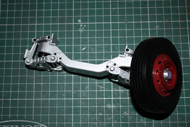

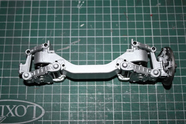

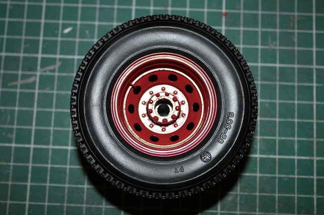

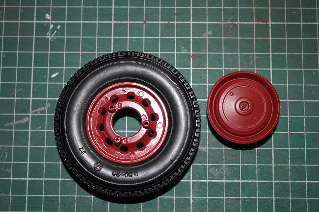

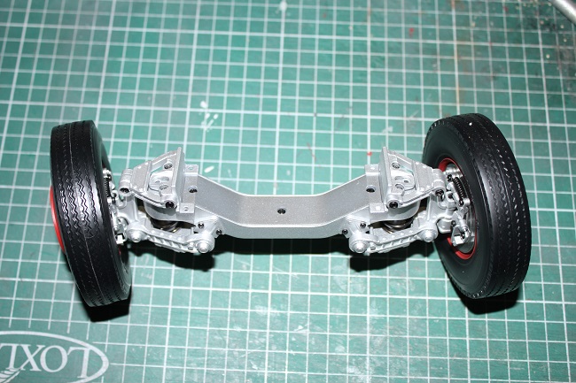

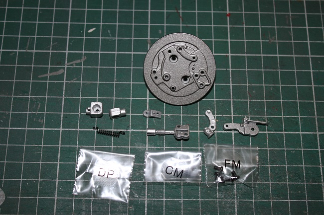

Issues 6-10

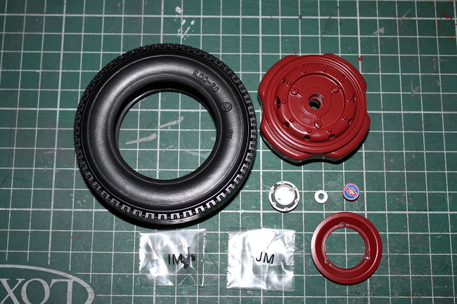

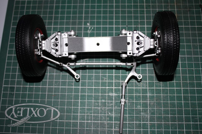

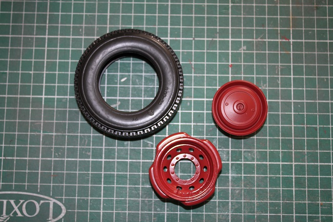

These issues contain parts to complete the front suspension and the front wheels.Each side of the suspension uses a spring which takes a bit of pressure to compress prior to getting it secure.Once the brake unit has been fitted the first of the wheels are constructed and fitted followed by the same on the other side.

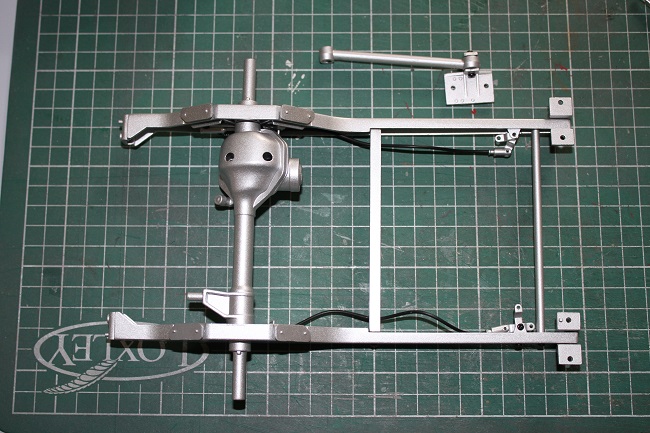

#3 Posted : 02 May 2020 12:36:54

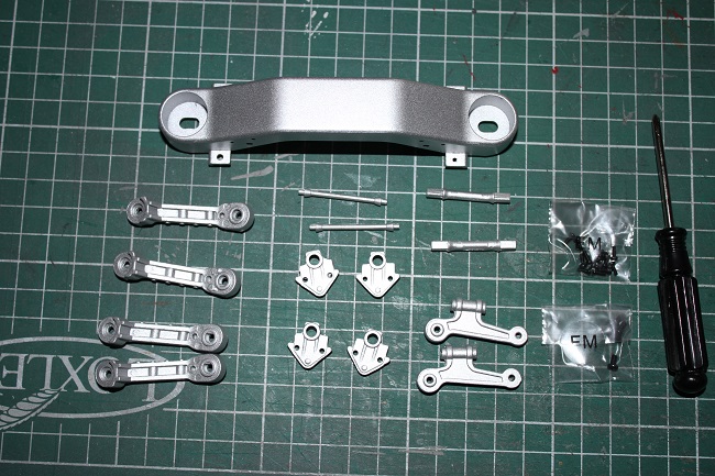

Issues 11-15

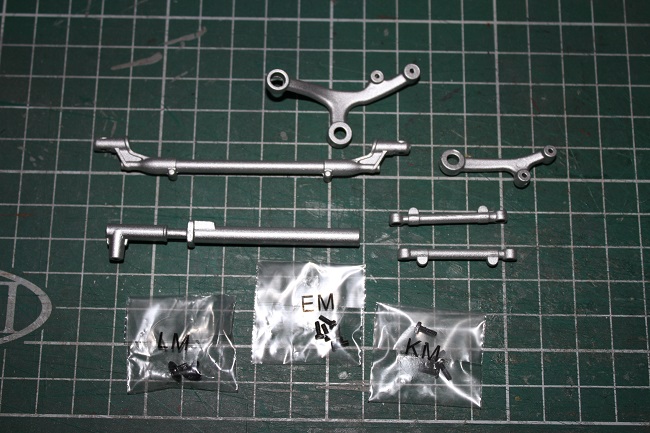

In these issues we start by tackling the steering and mounting the rods and linkages to the front suspension assembly. The steering is operable from the cab but it may be wise to only operate it with weight off the wheels using the 4 stands provided later in the build. The remaining issues deal with the rear suspension and linkages, cabling and rear axle.
#4 Posted : 02 May 2020 12:51:54

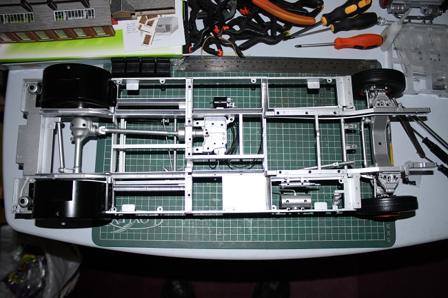

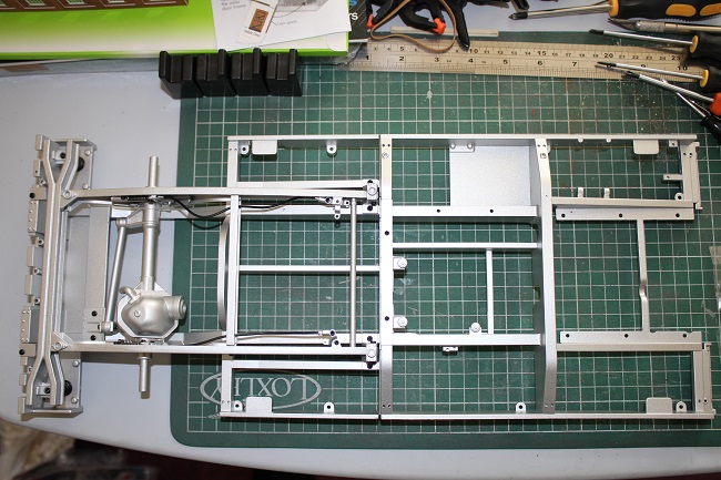

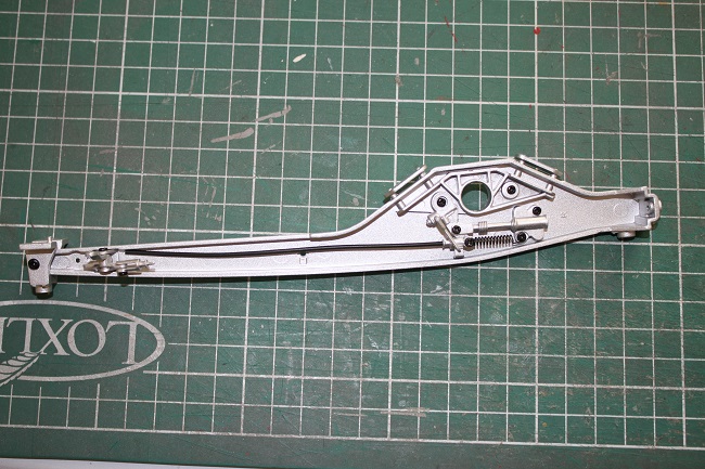

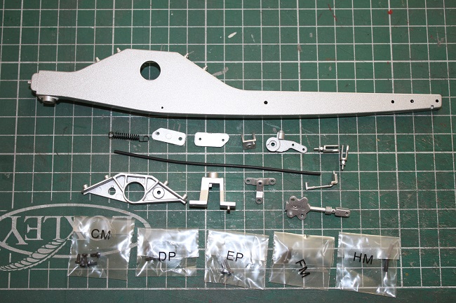

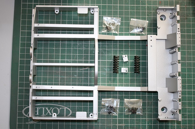

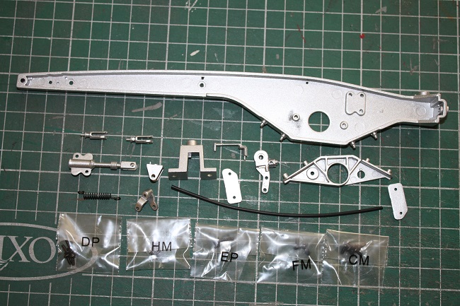

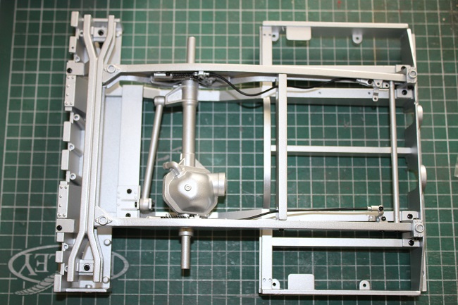

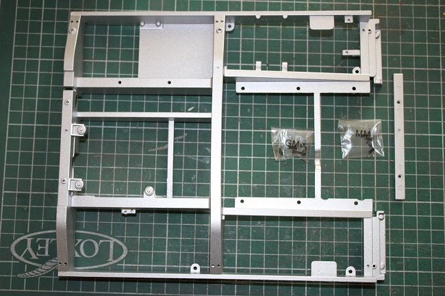

Issues 16-20

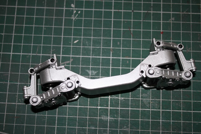

Its during these stages where you begin to realise how large and heavy the final product will be.We get the first of the main chassis frame and join the suspension components from the previous stage to it. Next the second of the chassis frames are added to the assembly. Then we make up the first pair of rear wheels which are then attached before starting the first wheel for the opposite side.

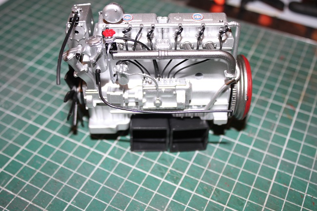

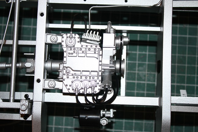

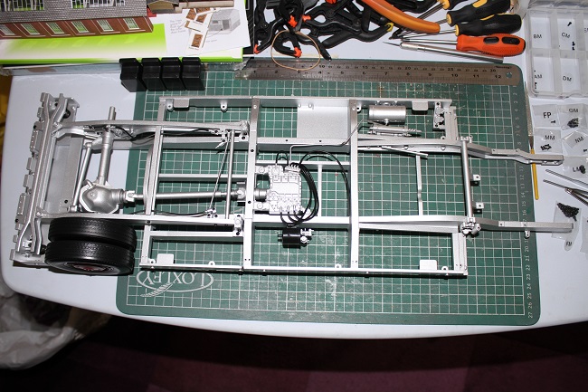

Issues 21-30

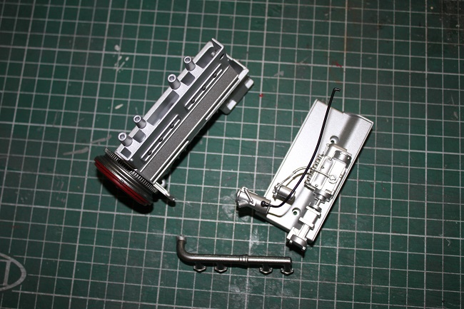

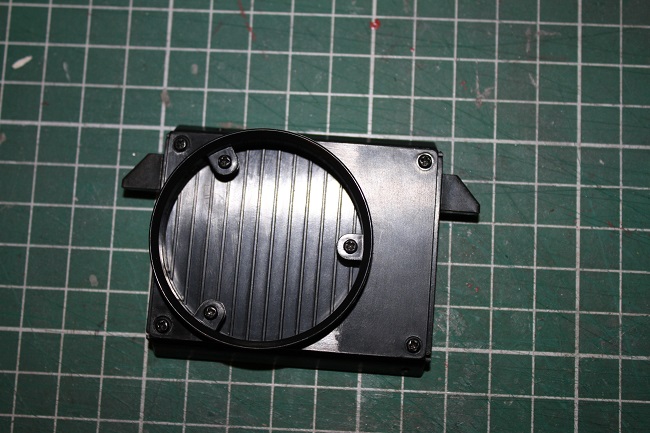

We start this by finishing the second set of rear wheels and putting the gearbox together and mounting it to the chassis.The next couple of stages cover the engine build which isn't too badly detailed considering hardly any of it will be seen.The forward frame rails are added in preparation of the front suspension and engine fitting. the radiator was then built and some more details added to the engine.

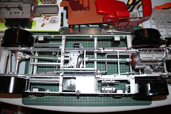

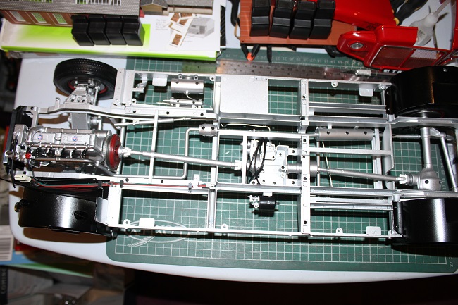

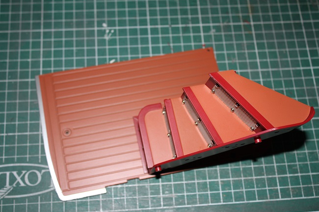

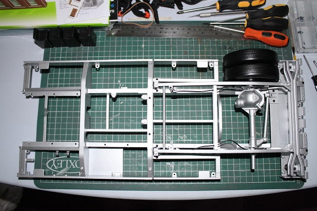

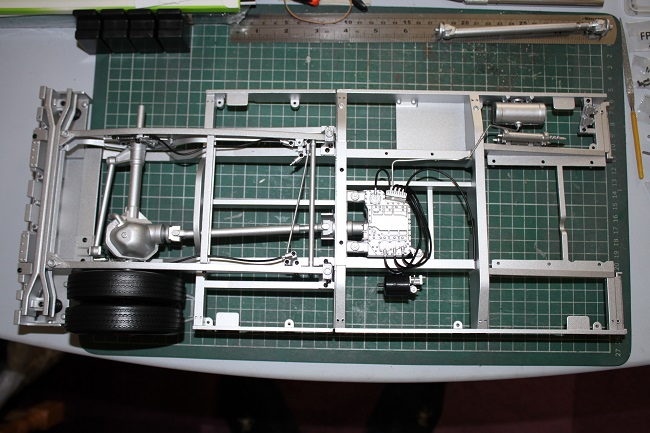

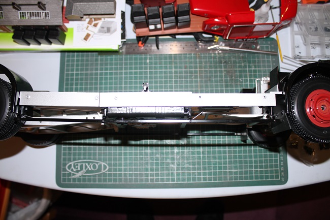

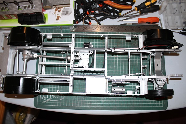

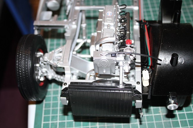

Issues 31-35
In this issue we start by attaching the front axle assembly and adding the rear mudguards.The front nearside mudguard is then added and care taken to route the wiring from one of the lights down the chassis. Now the engine is mounted together with the driveshaft and also the radiator.The exhaust is fitted and the fuel tank and filling point added along with the remaining mudguard.You can also see in pic 5 the stand blocks in position under there respective plates on the chassis taking the weight. The final pic shows the underguard rails fitted to the frame.
#15 Posted : 04 May 2020 13:01:39
That's looking good. Going to be a huge model !!
I didn't know that the Routemaster had a mid-chassis gearbox.

Nice work Al looking very good and as has already been said, should build into an impressively large (and weighty) model. I remember there was a lot of discussion when this was first released, about the way that the bodywork is held together with zillions of unsightly and overscale screws that made it look a little like the old 'Meccano' style of vehicle? Do you intend to go down the standard route with those and use what is supplied, or will you be trying to do away with them?
An interesting build Tony, thanks for sharing. Cool ThumpUp

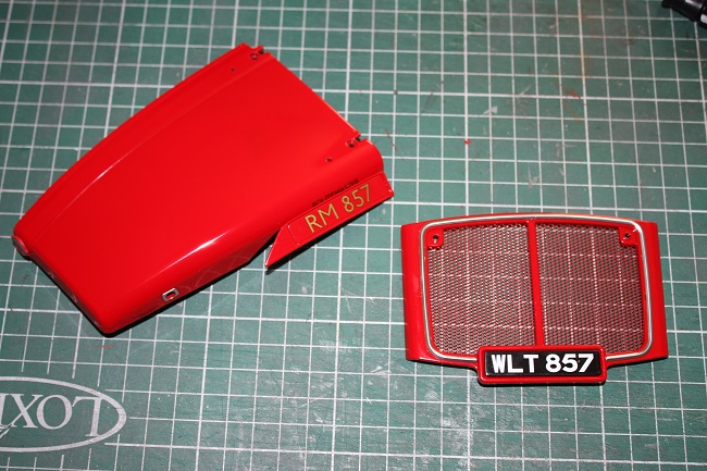

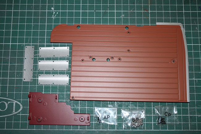

Kev, at the moment people a lot further along from me are divided on this subject,some have altered how the finished roof will look as they didn't like the pattern of screws joining the sections,as a frame has been put on the outside of the bus we are hoping that there will be a minimum amount of screws on show once the side panels are fitted. Some people are happy to leave them as they are and some have filled the screw heads to make them look like rivets. I am thinking of leaving them as they are but painting the heads once fitted as there has been cases of the red screws being differing shades, apparently from a few feet away you don't notice the screw headsLOL
Tony,its not too bad a kit, its been let down with some dodgy on/off switches and flimsy wiring to battery boxes compounded by instructions telling you to plug /unplug wires from the circuit board. Luckily for me being around 25 issues behind the latest issue I have had no problems so far and been able to use other peoples experiences to make it an easier build.

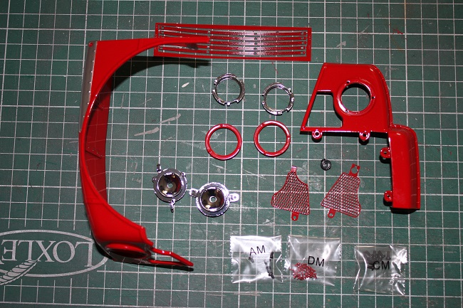

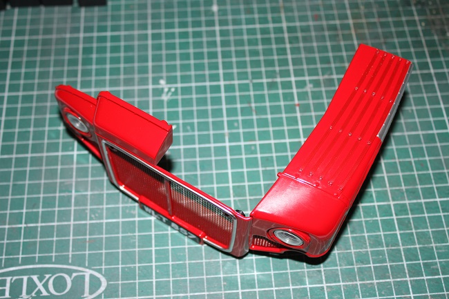

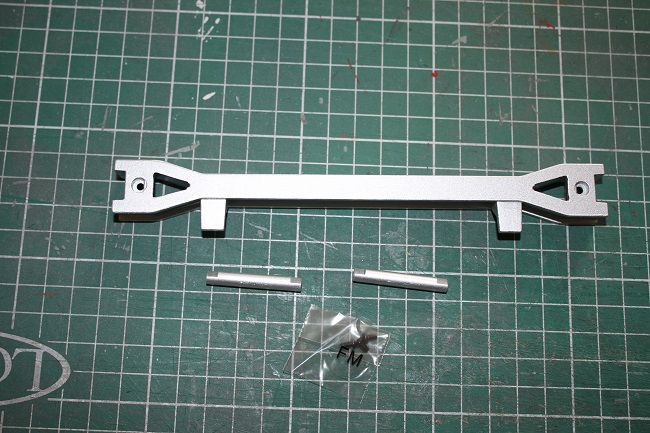

#20 Posted : 26 May 2020 21:09:13

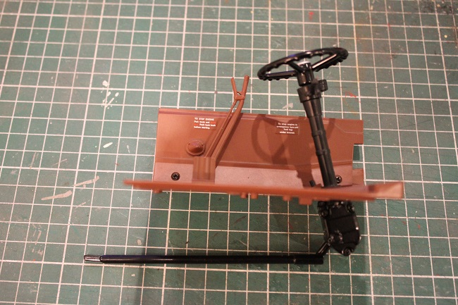

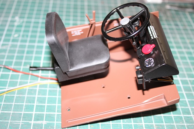

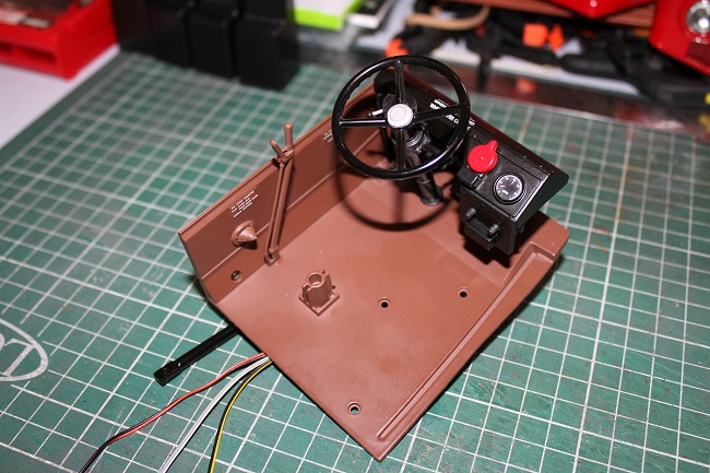

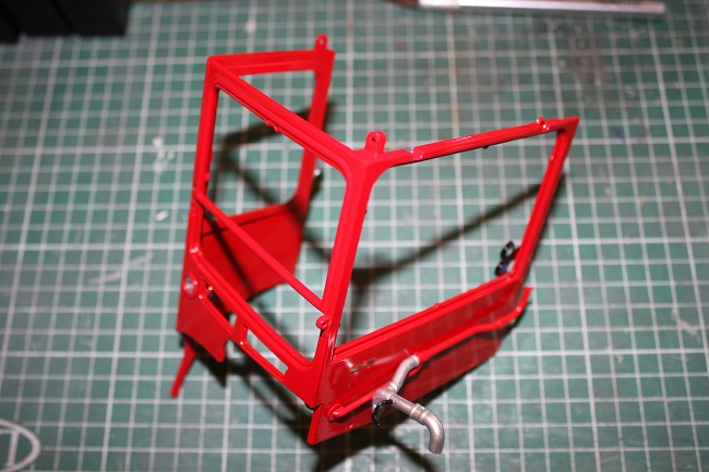

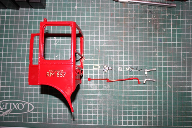

Issues 36-40

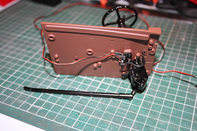

Here we start to assemble the steering column and link rod to the front wheel assembly.The handbrake is fitted and also the pedals, the brake pedal is wired to operate the brake lights.Having fitted the dashboard there are two more switches to wire up,one for the lights and if memory serves one for the horn.The seat is then installed and then we start to assemble the cab itself.
