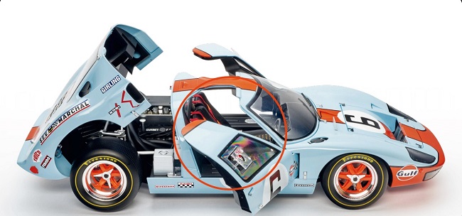

To me the parts look like a reverse of the first hinge which they would do, but as I don`t have access to the parts that is just my judgement.
Having looked through some more of the pdf`s I have come across the picture attached below that shows the doors in their open position. So from the info you have provided about how far the doors open relative to the hinge position it seems obvious that you need to fix it in the position that allows the door to open the widest.

What I think I'm going to do, is wait to finish both doors with the inner panel, keeping the panel NOT installed. When I get to the stage where I'm supposed to permanently install the doors, then I'll figure it out, then permanently install the inner panels. That way I can see what parts I need to attach the doors to and figure out if I want to take my Dremel out and smooth out that molded flat part of the hinge so the doors open and close all the way.
