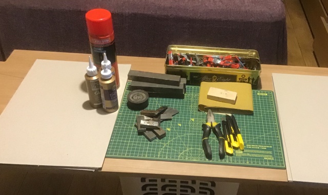

MY PREP
Build board
Carpet spray adhesive for gluing card templates to cardboard(cheaper than smaller cans of a well known spray brand)
Tacky glue for gluing cardboard (less wet than PVA- moisture and paper doesn't do well)
Snap blade knifes which I use free hand drawing along the lines.I can't cut 2mm thick card in one go.
Best to draw lightly along the line to provide a track for the blade to follow when applying slightly more pressure next few strokes to cut thru.
Swan Norton type blades I find are too thin and sharp and causes me to judder along the line as it cuts too deeply too quick.
Although I am comfortable using this knife you can still get blisters on your fingers if you try to cut out all the templates at once. There is a lot.
Pliers for snapping blade safely.
Minimum of 120 grit sand paper and block
Box of After Eights.Drool Drool
Thanks for lookin'

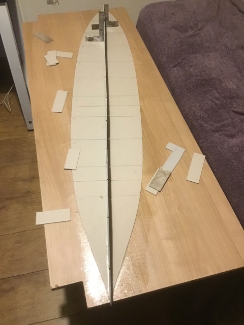

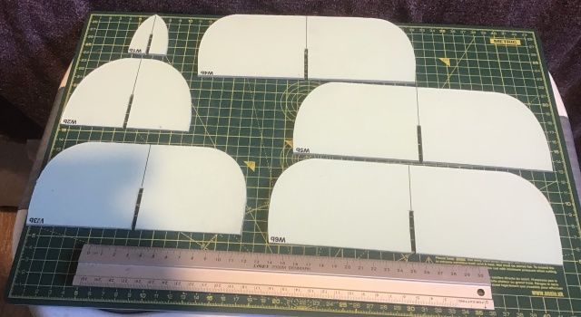

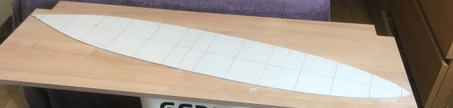

LOWER HULL
Will build as instructions doing the lower hull 1st
False Deck
Enlarged the templates supplied by 200% onto card.
Made adjustments as to where the joining of my templates would be and cut them out.
Using carpet spray I stuck them onto 2mm cardboard.
Using a large ruler I drew a straight line onto my build board on which to align my cut outs.
I then marked positions for the frames and a straight line down the centre of the false deck on the opposite side of the blue card..
Reason.
I do not want to glue the keel and frames on top of the blue card.The bluecard will start to lift away from the cardboard as we plod along.
But mainly as the false deck may lie flat to start with and with the help of weights will remain flat for a while BUT it will start to lift at some point.
Some people glue the card to the board to help keep it flat but what happens if you use too much glue and damage the deck when the time comes to remove it.
Hence I will glue the blue side down and it won't matter if the blue card tears away.
Using the carpet spray I glued and aligned the false deck to the build board and weighted it down with some old flat ceramic tiles till dry.
With the build board being of a shiny veneer I am sure that the false deck will come away quite wellCrying Crying
Thanks for lookin'

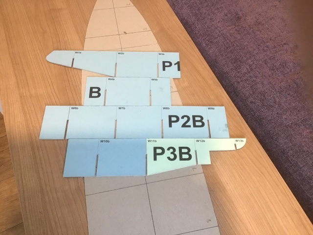

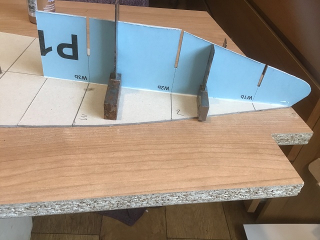

Location: Glenrothes

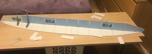

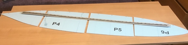

BigGrin Hello again Folks
Got quite a lot done today thanks to the poor weather keeping me indoorsCool
The below pics are off the lower keel coming together and joining up the seperate parts off the false deck and keel with scrap cardboard.
So it will be back to the chopping board for cutting out the framesCrying
budgie attached the following image(s):

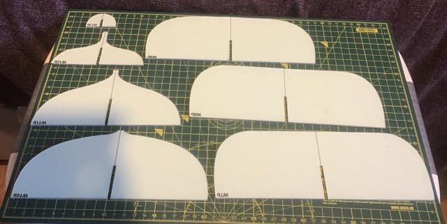

Finished cutting out the 13 frames and not a red fingerprint anywhereLOL
I think you are more likely to get a wee nick using a ruler than cutting freehand
The ruler I use when I need a straight edge has a trough along it to keep my fingers out of the way.
Also it is 4mm thick along the length on one side so there is minimal chance of your blade accidentaly sliding across the ruler, plus it also aides cutting straight down rather than at slight angle giving a bevelled edge.

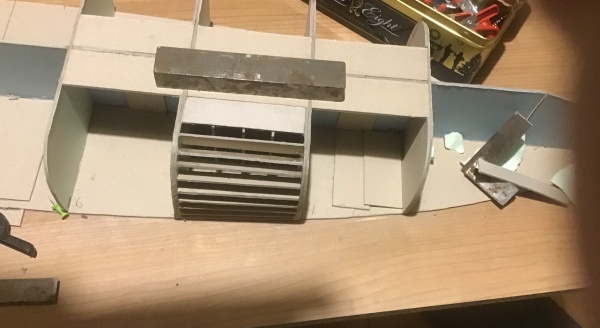

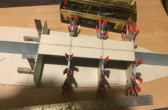

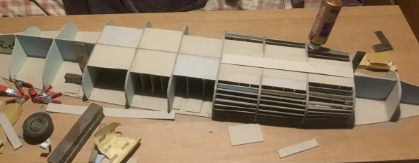

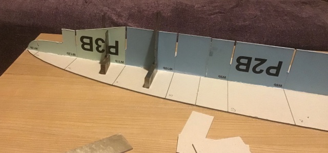

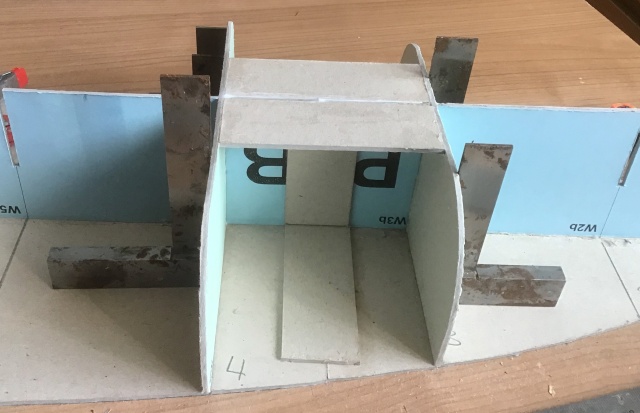

Made a start gluing the frames
I have been here before on previous attempts and found that after fitting all the frames to the keel it looked pretty good to me.
BUT: as there is quite a large gap between the frames it is advised to put some support between the frames to help prevent the "skin" from sagging and provide more surface area for the "skin" to stick too.
When I cut a piece out for the starboard side which fitted nice n neat between 2 frames it was too small or too big for the port side???
So I will be putting in supports as I plod along hopefully ensuring the space between frames is equal on both sides.

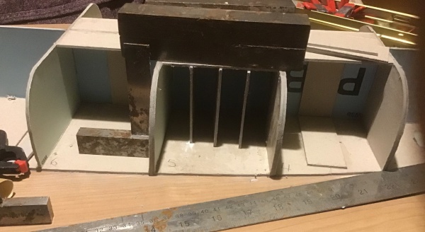

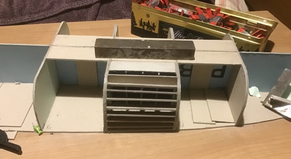

budgie

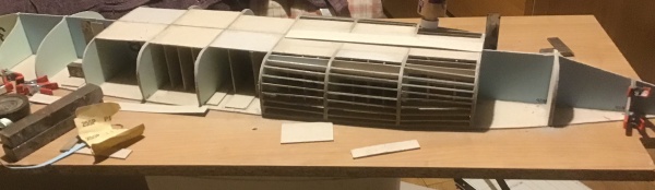

#12 Posted : 23 February 2020 20:18:08
Joined: 20/03/2010
Posts: 1,199
Points: 3,473
BigGrin Evening Folks
Not sure if I will be planking or have a go at using the hull templates as per card model.
Either way a larger area round the frame edge will be required
Best to do that now then before I put strengtheners between framesCool
Spare cardboard pressed against the frame, a pencil line drawn round the existing frame, cut out, glued and clamped ready for sanding once dried
Thanks for lookin'

Anyhoos sanded down the extra frames flush with the original and put in some vertical supports for the hull bottom.
Cut 1.5cm wide strips and cut lengths to fit between the 2 frames.
Placed those horizontal supports with a small amount protruding at each frame, then using a cardboard strip lined it up and pushed in at the frame edges ensuring that when planking the plank will touch all of the support.
Looks a bit messy as camera has better eyesight than meFlapper
Will do the other side next.

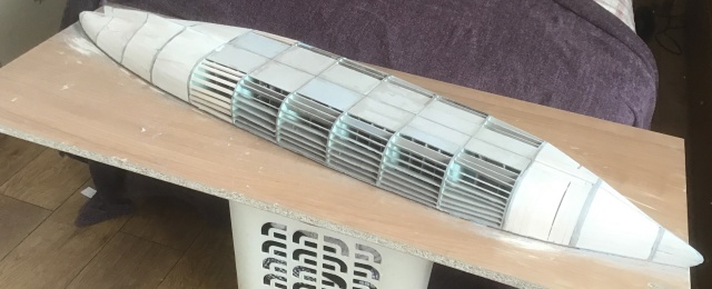

Finding this part of the build to be long and tedious.
Mind u a lot of time was spent waiting for the glue to reach the tip of the bottleCrying Crying
I eventually learnt to keep the bottle upside down when less than half fullLOL LOL
Progress so far

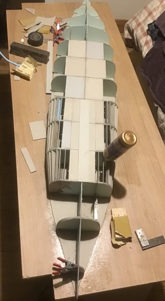

#20 Posted : 04 March 2020 17:17:22
Joined: 20/03/2010
Posts: 1,199
Points: 3,473
BigGrin Afternoon Folks

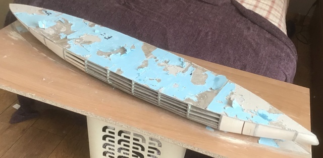

Working towards the rear and aft I found that my 2mm thick supports not enough of the edge would touch the frames.
I could spend a lot of the time working out the angles so decided to balsa instead.
First the frames were made thicker. This was to allow for sanding the bevelled edges.
2mm thick card will wobble when sanding,6mm is solid.
I then balsa'd between the frames at the bow and stern.
Out to the shed to get the mouse sander set up.
Too lazy to do it all by handFlapper
I have gone as close to the frames as I dare using the mouse and I will finish it off ONCE I find where I last put my fine permagrit sanding blockConfused

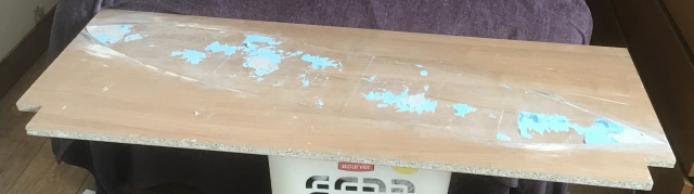

Decided to remove the lower hull from the build board before planking it.
Well I must say I did an EXCELLENT job off gluing it to the board to prevent it from curling upCrying
Using a swan Norton scalpel I sliced all the way round the hull between the false deck and the board.
Then using a flat metal ruler I managed to insert it in-between the card and the board and bashed the ruler thru to the other side with a hammer.
Continued doing this all the way round.
Not too much damage could have been worse.LOL LOL
TIP: TACK the false keel down with glue
