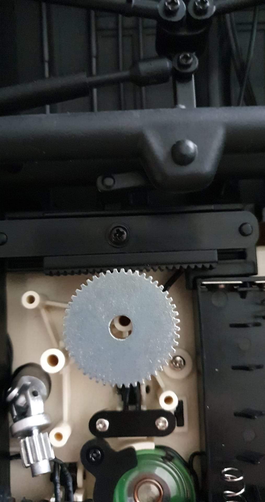

The large cog for the Samba steering mechanism is too big. It does not fit. Several people on these forums and FB are reporting this. Has none done a test build or has a wrong part been put in pack 12?

Looking at your picture that looks way out. As Spal said in his build it does need some gentle persuasion to go in place and that would keep the gears firmly together so not to slip.
I have today lined up the parts and agree that the fit would be snug, where as yours I think would need a crowbar (DON`T DO THATLOL ).
Could I respectfully request that you loosen all the screws that fit the chassis, inner floor and body shell together and see if you can get any movement of the chassis and inner floor toward the rear of the vehicle. Enough that would facilitate the fitting of the gear and if that is not successful could you please measure the outside diameter (at the widest part) of the gear that won`t fit so I can compare sizes.

Right, here we go. Cannot get any play from the inner and out floor pans. Cog is the correct size. If it were smaller it would not engage the other cogs. Therefore the only part that stops this working is the rack. This would need considerable modding as it not only has the guide screw in the middle and the plate over the top, it also runs in 2 slots. The rack would need to be remoulded by the manufacturer for a decent job.
That's it for me. Luckily I don't want to play brm brms round the carpet so I'll stick with non functional steering. It is a static model after all!

Derek have finished the Samba. I managed to get the large cog in place but as it is tight the steering wheel will not turn the wheels on the flat surface or if lifted up off its front wheels. When the plate to secure the cogs in place is screwed down it seems to tighten everything up. Will take apart and try again. Andy.

I heard back from Italy, and this is seemingly a unique problem. I suspect that it is cumulative error in the parts, as assembled. My own pack 12 won’t be here for a bit more though, so I can’t verify. It seems that Derek is on the right track though.

Have just taken apart the steering parts but unfortunately I have snapped the plastic shaft the large cog fits to. Will have to contact c/s for replacement but my thoughts are to do without in case it’s the same with a replacement part. The large cog was so tight to the steering rack trying to ease off snapped the shaft. Andy.
