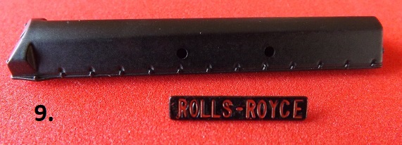

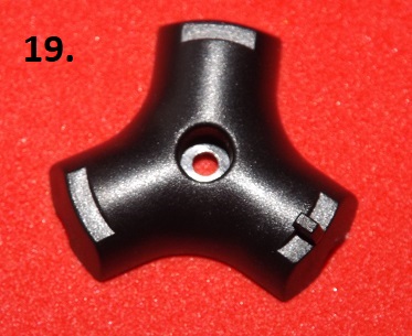

ISSUE 1
PICTURES 1 & 2

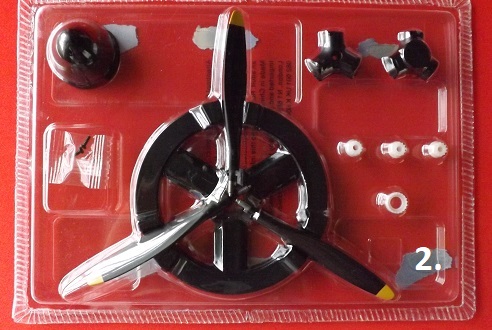

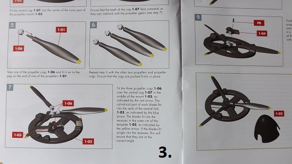

Issue 1 follows similar lines as many of the shop stocked part works with the Magazine and parts being presented on a large card background
PICTURE 2
The magazine instructions (based on this issue) appear to be clear and easy to follow.

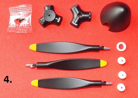

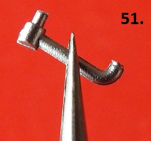

PICTURE 4
The parts supplied with this issue allow use to construct the propeller and while we do receive the propeller spinner this is not used at this stage.
Paint finish on the propeller blades appears to be very well done.

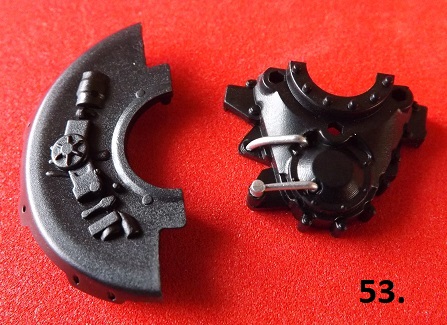

PICTURE 5

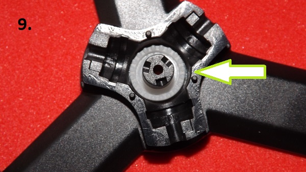

Very little to catch anyone out at this stage but just need to ensure we pick the “Inner Part” of the propeller mount (arrowed on the left of this picture)

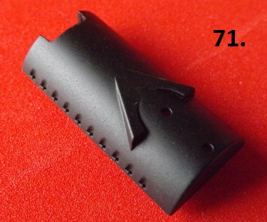

PICTURE 6

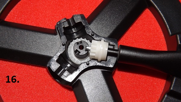

This little device is an assemble jig used to help align the propeller blades.
PICTURE 7
We place the Inner Part of the propeller mount into the jig.
PICTURES 8 & 9

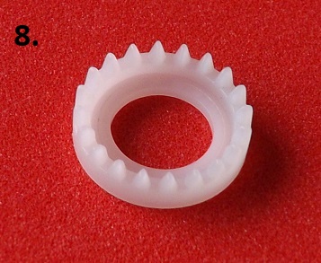

We then take the central cog (this will allow the propeller blades to “feather” in synch) and making sure the cog teeth are facing upwards, this is dropped into the centre of the propeller mount.
PICTURE 10

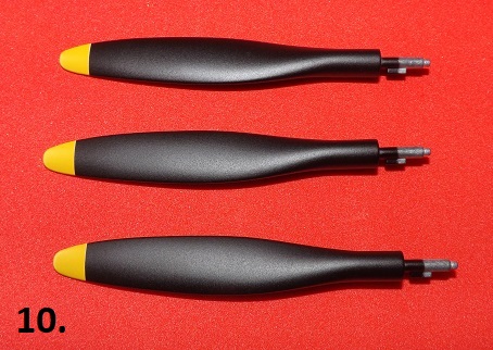

We then gather up the 3 propeller blades and ….
PICTURE 11

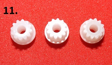

The 3 propeller cogs.
PICTURES 12 & 13
The rear face of the propeller cogs are “keyed” to take the spine (arrowed in pc 13) on each propeller blade.
PICTURE 14
We press fit the 3 cogs over the 3 propeller blades.

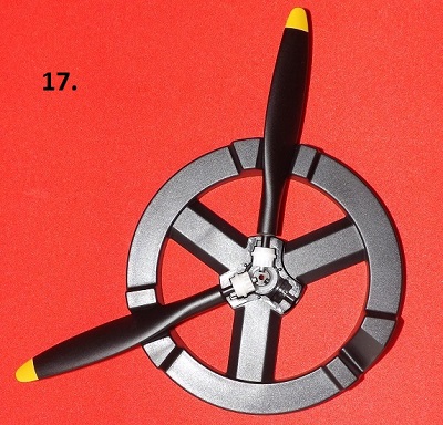

PICTURES 15 & 16
Each propeller blade is the placed in position with the jig keeping everything at the correct angle.
PICTURE 17
That is 2 blades in place
PICTURE 18

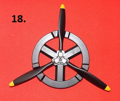

That is all 3 blades in place
PICTURE 19

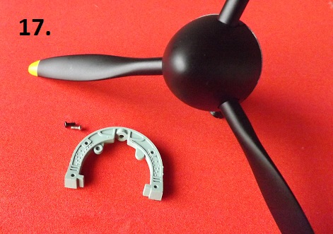

We then take the Propeller Mount (Outer Section) and one of the supplied 2.3 x 6mm screws (2 supplied with 1 being a spare).
PICTURE 20
The Outer part of the propeller mount is then screwed into place.
PICTURE 21
And while the propeller spinner is not used at this point, this is what the unit will eventually look like.

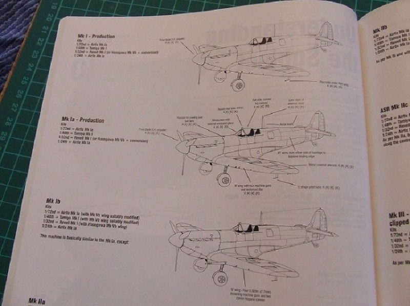

semaj wrote:
Part of me feels really tempted with this one as I love all the moving parts and motorised mechanics of it all but already having 4 on the go now I feel quite stretched.
Overall I think it does look a great model but 1 thing about it really bugs me - only 3 exhausts each side which is majorly incorrect as there should be 6 pipes each side. Big trademark of the spit imo
Hello James,
Just thought I might put your mind at rest and say that it was only Spitfires from the Mk.VII through to the PR Type A, plus the PR MkIX, PR Mk X and PR Mk XI, the Seafire MKII, along with the trainers TR Mk8 and Mk9 and the Spitfire Floatplane (MkIXb) that had six exhaust stubs. Everything else had the three stub system with each stub acting as a collector for two exhaust ports on each bank? All of the earlier Spitfires, of which the Mk1a in this kit is one, had the three stub exhaust system? I have attached a photo taken from a very reliable reference book on the subject.
It isn't "majorly incorrect" as you suggest and Hachette have got the correct design, so I hope that what I say helps you to decide to go for the kit if you wish and not to worry about a discrepancy that actually isn't there?
All the best and hope that helps,
P.S. - @ Tony - I hope I'm not hijacking your topic Tony? If you want it removed just ask and I'll do so? ThumpUp
Kev the Modeller attached the following image(s):

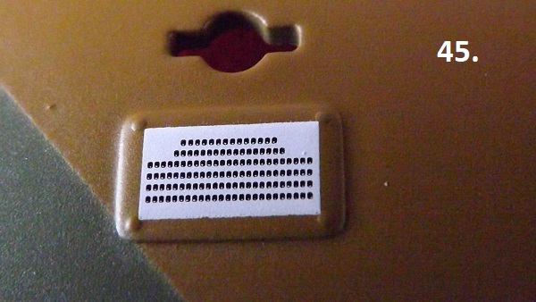

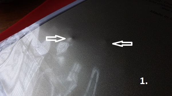

Well this is what the tin plate poster looks like.
Big question has to be “why on earth” did this get put in a simple plastic mailing bad? Mine has arrived looking like it carries “authentic” WW2 bullet marks.
Its been in contact with something in the post that has left “ball bearing” shaped dents all over it, as well as being bent in the middle.
It may be possible to smooth out the “bullet holes” by laying over a sheet of kitchen paper and then rubbing over the surface with a spoon.
So that is an initial “niggle”.

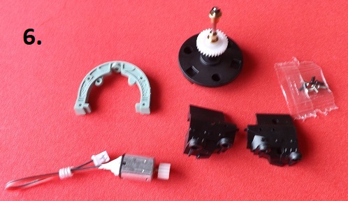

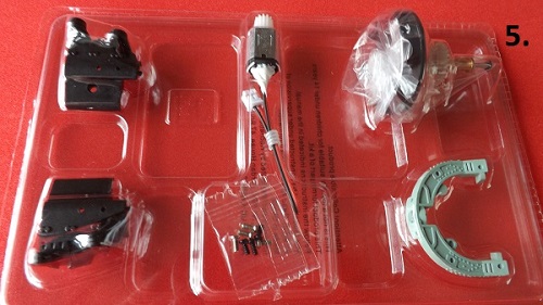

The parts for this issue are weld sealed in a plastic tray.
What I did notice (and the reason for the above “stinks” comment is that having cut around with plastic weld to free up the component parts there was a very strong and noticeable smell of “Dead Fish” (best way I can describe it).
Now “Tom” the cat to the best of my knowledge has not paid this mailing a visit as the postie handed this to me at the door today.

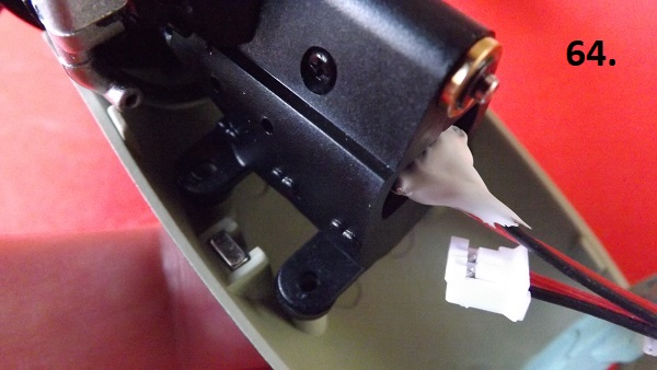

All I can think is the smell may originate from the sealant used on the wires to the motor.

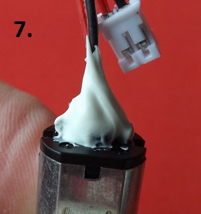

PICTURE 7
And here is that motor.
I can understand that is the wires to this motor are soldered onto tags at the end of the motor they need to protect that join so that the wires do not some adrift, but I ask you, does that really look the neatest way of doing things?
Going back to that Odour (which did seem to disappear fairly quickly) all I can think is this sealant was possible wet when the motor was sealed in this pack, and its some sort of smell from that which I detected.

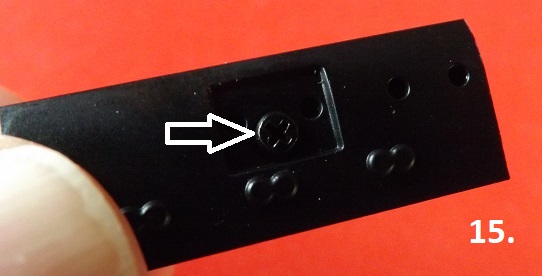

PICTURES 8, 9 & 10

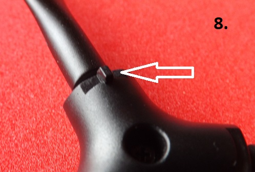

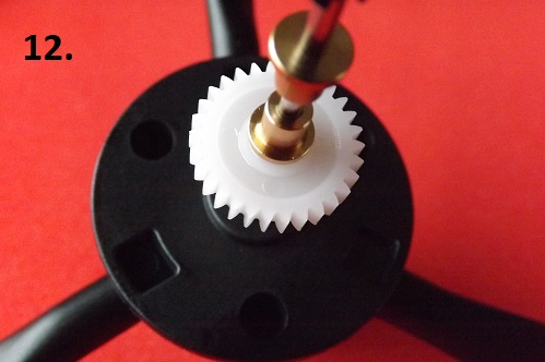

So, to begin the assemble we need to recover the propeller and spinner cover from issue 1.

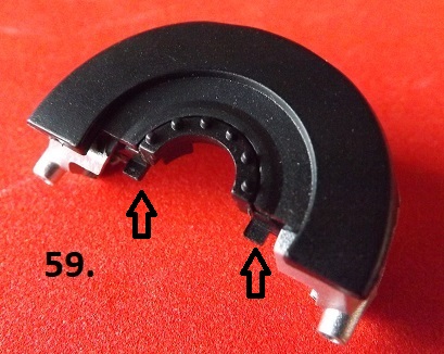

On the propeller hub there is a locating tab (arrowed in pic 8) that fits into a matching slot in the spinner cap (arrowed in pic 9 & 10).
PICTURE 11
Insert the propeller into the spinner minding that the tab and slot fit together.
PICTURE 12
We then place the Propeller Gear Set over this assemble.

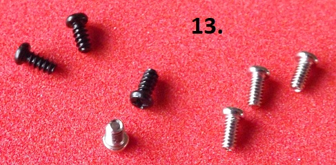

Using 3 of 4 supplied 2 x 4 PM screws we secure these parts together.

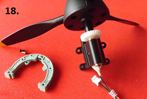

PICTURE 14

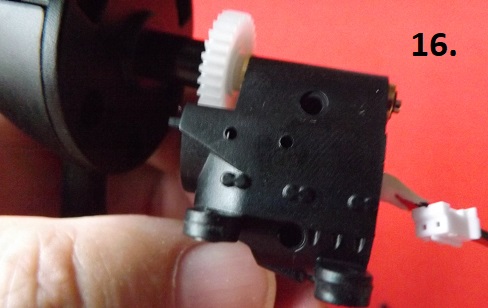

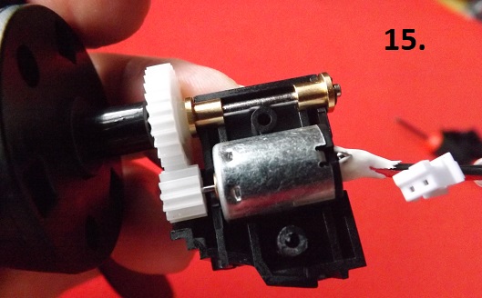

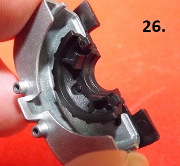

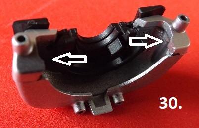

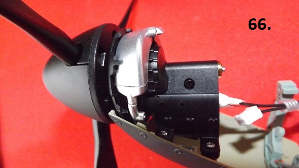

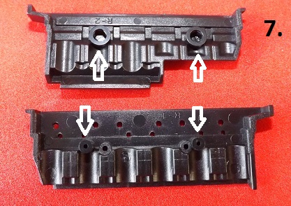

We then take one half of the Motor Housing and ensuring the 2 brass ferrules are located as per the arrows in this picture, we insert the Propeller Gear Set.
PICTURE 15

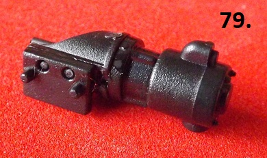

Exercising some care so the whole assemble does not fall apart at this stage, we then insert the motor into the motor housing.
You cannot really get this bit wrong as the motor drops into a pre-moulded space and the gear on the motor engages the gear on the Propeller Gear Set.
PICTURE 16
We then place the second part of the motor housing in place and secure this assemble together using 2 of the 3 2 x 4 PB screws.
PICTURES 17 & 18
And this is what we are left with after completing this stage.
Part 2-05 Lower Fuselage Frame is stored until called out in some future issue.
We also have the propeller now attached to its drive motor.

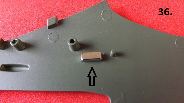

1. What is obvious is that when the propeller motor is in place its going to be near impossible to replace it should it fail.
What would have been useful might have been a small tester so that builders could make sure the motor they have actually works.
Providing you are careful, and know what you are doing it is possible to test the motor using the likes of some jumper leads, the sort that you might get in an Arduino set for instance.

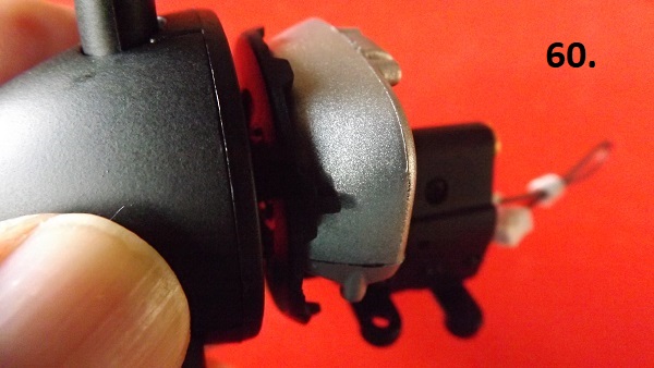

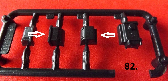

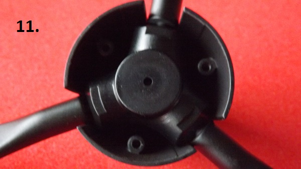

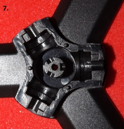

2. Also picked on some issues facebook builders have been posting. Seems some of the propeller spinners that were supplied did not have the slots the blades sit in filed out deep enough.
Net result spinner and propeller base do not sit flush and therefore the screws do not engage to hold the 2 parts together.
I understand Hachette are looking to replace this part for those with the issue.

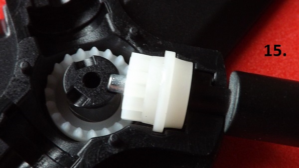

RE-WORK

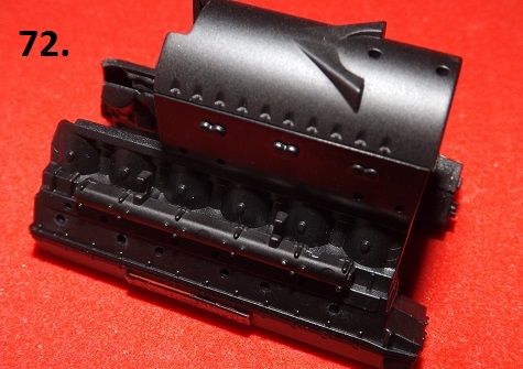

Having looked at how the engine goes together its not going to be accessible at a later time some before beginning the new issues I decided to take the propeller apart and grease the parts.

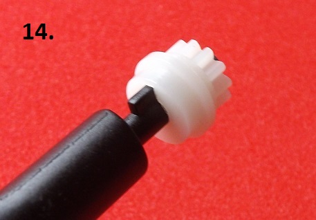

PICTURES 1 Through 4

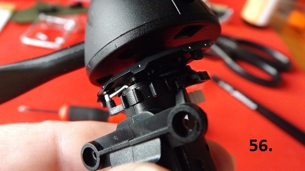

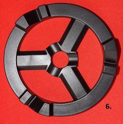

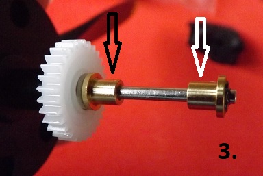

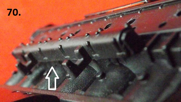

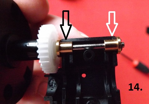

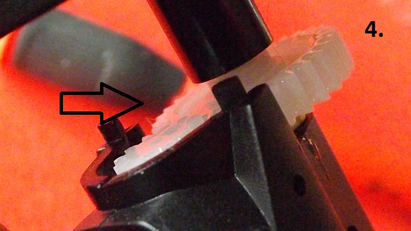

I decided to use this silicone-based grease that, according to the box, should be safe to use on plastic.
Its quite a thin grease so used sparingly.
I have greased the 3 cogs on the propeller blades as well as the slots they sit in.
The propeller drive shaft (Pic 3) and the 2 cogs attached to the motor (Pic 4)

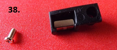

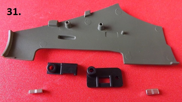

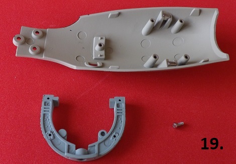

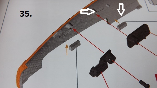

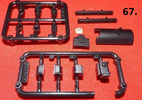

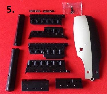

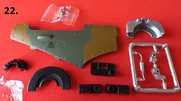

ISSUE 3 – ENGINE BLOCK AND FUSELAGE
PARTS CHECKLIST – PICTURE 5
3-01 Fuselage (below engine)
3-02 Top of Engine Block
3-03 Engine Block (outer)

PICTURE 5A
It seems there will be quite a few parts that have to be glued together.
The instructions call for super glue but were I can (in the case of plastic to plastic surfaces) I will me using my “old faithful” Plastic Weld.

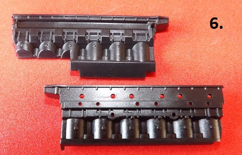

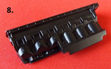

PCTURES 6, 7 & 8
We start by fixing together the 2 engine block halves. PIC 7 there are 2 pegs on 1 half and matching location holes on the other half.
You are told to apply superglue to the pegs but I have used plastic weld on these areas and along each mating surface.

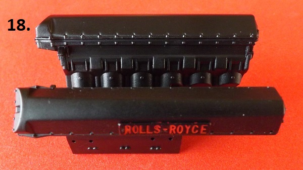

PICTURES 9 & 10
We then take the engine block tops and the name plates.
These name plates are a push fit, but very tight, so care needed when putting together.

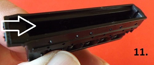

PICTURE 11
These engine block tops are made of metal and they will locate into the cut out shown here.
So, this will be a plastic to metal join and superglue (as much as I hate the stuff (will have to be used.

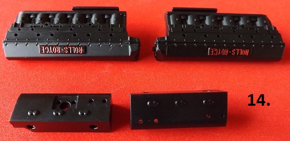

I just have a dread feeling that to many super glued parts could all end up parting company when this thing eventually gets powered up.
So, on that basis I have decided to use Power Flex by Loctite. Its supposed to produce a join that has a slight flex in the glue rather that the glue being brittle which you do find with many superglues.
PICTURE 14

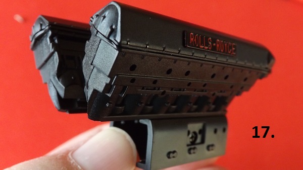

We then take the 2 engine block halves along with the 2 block bases.

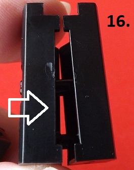

PICTURES 15 & 16
This is quite a tricky assembly section as you have to get both engine block halves between the base parts and then screw all of this together.
Easiest way of doing this (PIC 15) is to start the screw off in the 2 base parts.
This allows the slot to open slightly and its then easier to get the upper block pieces in place.
PICTURES 17 & 18
When screwed together the block halves are held nice and tight in place and this is what this section now looks like.

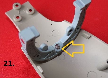

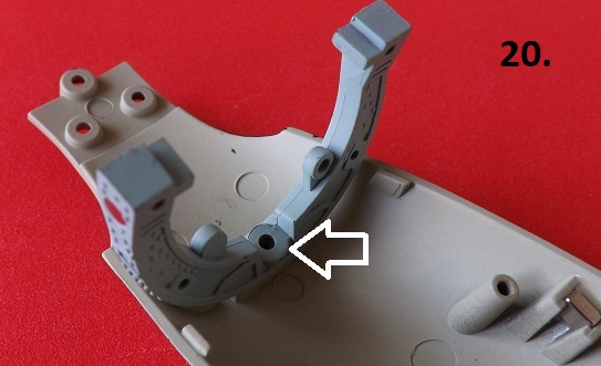

PICTURES 19, 20 & 21
The final part of this build section is to take the Lower Fuselage Frame from issue 2 and the Lower Fuselage supplied in this section.
The frame part can only be fitted 1 way around on the fuselage section.
Its held in place using 1 x 2 x 4 Screw. It looks to be that the metal sections have been pre-tapped as the screws go in very easily.
#17 Posted : 21 March 2020 21:02:41
ISSUE 4 – ENGINE COVER PANEL AND ENGINE HOUSING
PARTS CHECKLIST – PICTURE 22
4-01 Engine Cover Panel (Left)
4-02 Magnet Fixture (L1)
4-03 Magnet Fixture (R1)
4-04 Magnet Fixture (L2)
4-05 Engine Housing (Inner)
4-06 Engine Housing (Front)
4-07 Frame of Various Parts
4-08 Engine Housing (front)
4-09 Magnet (marked on wide side)
4-10 2 x Magnets (marked on narrow sides)
4-11 Seven 2 x 4mm PM screws (1 spare)
PICTURE 23

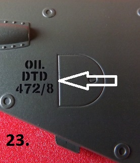

One of the things that stood out to me on the prototype model they used in the advertising was the “poor quality” of the decals with a great deal of decal silvering showing.
The panel has the first of the markings in place and it looks perfect.
If the rest of the markings look like this then I will have no problems continuing with this build.

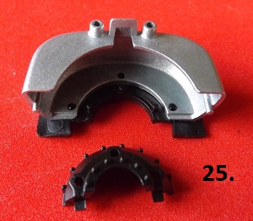

PICTURE 24

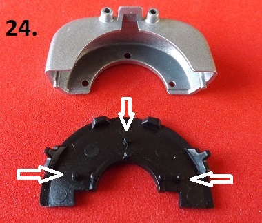

We start with these 2 engine parts. The silver is metal and the black part plastic.
They tell you to just apply a minimum of superglue to the 3 pegs on the plastic part.
I used a little extra on the flat face between the pegs as last thing we want is this parting compony when in place.
PICTURES 25, 26 & 27

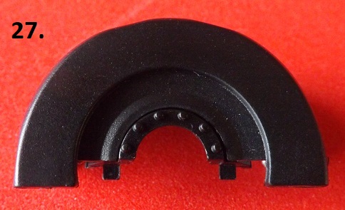

We then take the Inner Engine Housing and this is fixed in place in exactly the same way.
While you are not really going to see this, PIC 27 is the front face that the propeller will sit “on”.

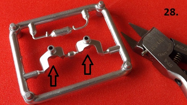

PICTURE 28

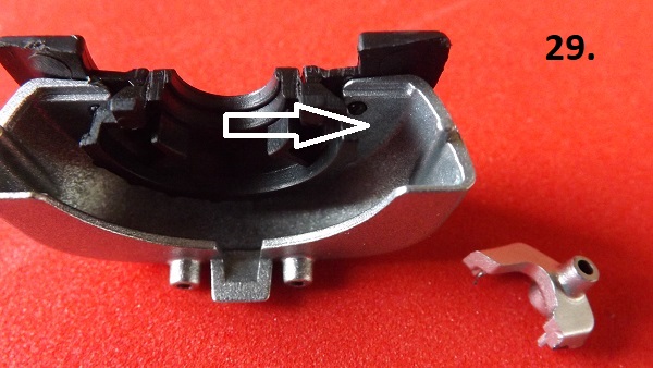

We then need the 2 injection moulded parts from the frame that you can see in this picture.
PICTURES 29 & 30
And these 2 parts are again super glued onto the engine mounting as shown here.

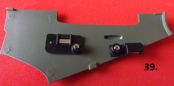

Next up we take the fuselage side panel, magnets and magnet housings.

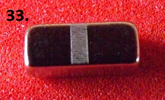

PICTURES 32, 33 & 34

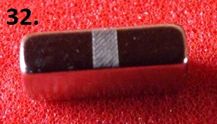

To ensure the magnets are installed with the polarity in the correct place, each magnet has a stripe on one side. Interesting that these are white but refer to the instructions (PIC 34) and it tells you to look out for the BLACK marking. Not a major issue but interesting.
PICTURES 35 & 36
One of the magnets has its own little slot to sit in on the frame side.

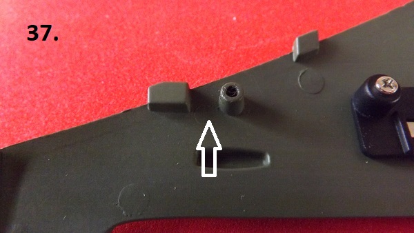

PICTURES 37 & 38
The other magnet is edge fitting so this one has to be pre-installed in the plastic support from. Fun doing that if you have “sausage Fingers” as it’s a tiny magnet and if you only have steel tweezers the task is made even “more fun”.
PICTURE 39
Once both magnets and magnet support frames are screwed into place this is what the part looks like.

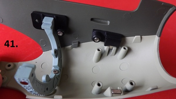

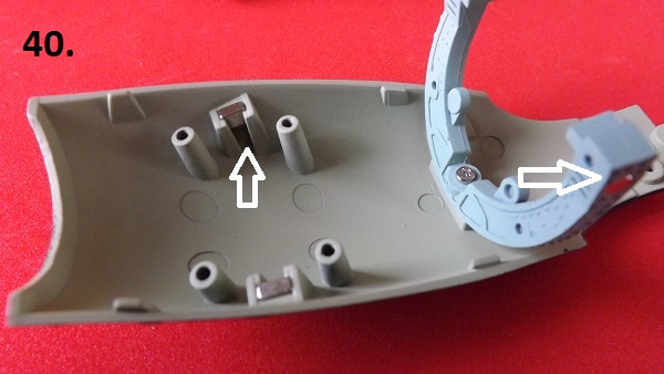

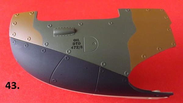

PICTURES 40, 41 & 43
In PIC 40 you can see the pre-installed magnets on place (arrowed) and I could not resist trying the side panel in place to see what it looks like.
The fit is really good and the magnets are strong enough to hold the panel in place but not so strong that you will need a crowbar to part the pieces.

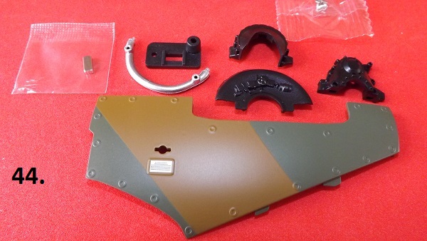

#18 Posted : 21 March 2020 21:09:50
ISSUE 5 – ENGINE COVER PANEL AND ENGINE HOUSING
PARTS CHECKLIST – PICTURE 44
5-01 Engine Cover Panel (right)
5-02 Magnet Fixture (R2)
5-03 Magnet (marked on the wide side)
5-04 Engine Housing
5-05 Engine Housing
5-06 Engine Housing Strut
5-07 Engine Housing
5-08 Three 2 x 4mm PM screws (1 Spare)
PICTURE 45
Another pre-applied marking that again looks absolutely fine.

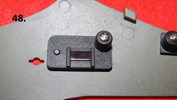

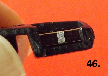

PICTURES 46, 47 & 48
Similar to the previous issue we first install the 2 magnets onto the fuselage side.

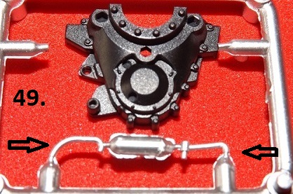

PICTURES 49, 50, 51 & 52

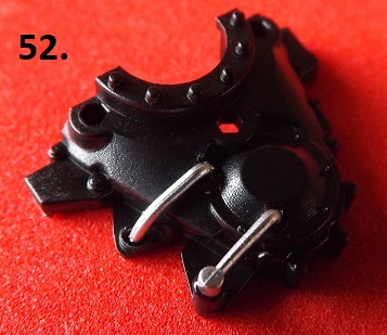

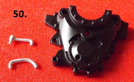

We then take the supplied engine housing and the 2 pipes from the fret.
Nice sharp pair of sprue cutters to remove these parts without breaking them.
The 2 pipes are very small so tweezers are a must to het these glued into place on the engine housing.

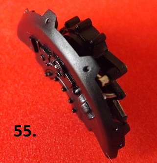

PICTURES 53, 54, 55 & 56
We then take the remaining engine housing section and this is superglued into place.
PICTURES 57 & 58
Next up is the section of engine housing that will “hide” the large drive cog on the motor.
This part is glued to the front engine housing as arrowed in PIC 58.
PICTURES 59 & 60
The other half section of the engine housing is then superglued into place.
The glue gets added just to the 2 arrowed pegs that you can see in PIC 59.
PICTURES 61 & 62

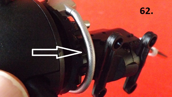

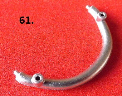

The silver pipe is referred to as an Engine Mounting Strut and this is glued in place as you can see here.

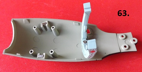

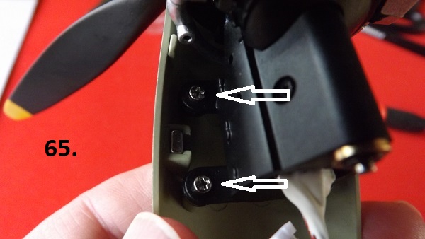

PICTURES 63 Through 66
Taking the lower fuselage part, we position the motor housing over the 4 holes in this part.
The motor is then secure into place using 4 x 2 x 4mm PM screws.
And that completes this build section.

ISSUE 6 – DETAILS TO ADD TO THE ENGINE
PARTS CHECKLIST – PICTURE 67
6-01 Engine Side Cover (Right)
6-02 Engine Side Cover (Left)
6-03 Oil Tank Base
6-04 Fuel Pump Base
6-05 Engine Accessories A-F
6-06 Engine Accessories G-I
6-07 Engine Starter Plug Cover

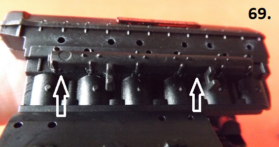

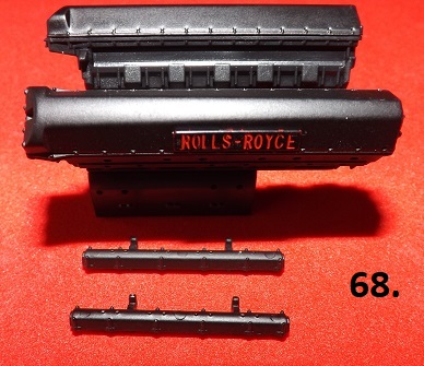

PICTURE 68, 69 & 70
We start with the 2 Engine Side Covers (not sure they have the correct name for these parts).
They are metal and designed to press fit into the engine block side.
They are a very tight fight and the instructions do mention that you might need to enlarge the holes in the engine block to get them to fit.

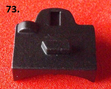

We then take the oil tank base and this is superglued to the bottom of the engine.

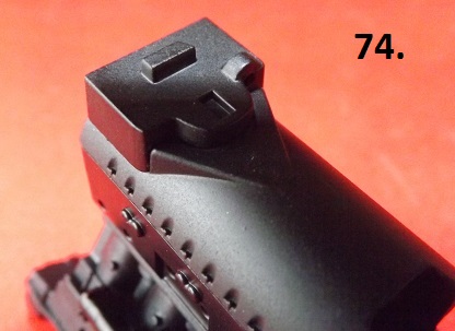

PICTURES 73 and 74
We then take the Oil Tank Base and this is again superglued into place.
As can be seen in PIC 74 the fit of these parts is really good even though a lot of this will never be seen in detail once in permanent place.

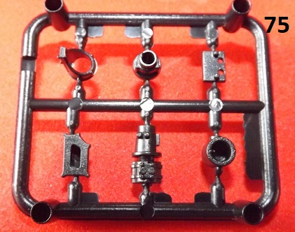

PICTURE 75

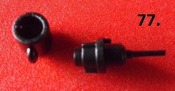

We now start using the parts from the fret that you can see here. Small parts so care needed in working with them.
PICTURES 77, 78 & 79
This part is made up of 4 sections. I used my Plastic Weld to put this together.

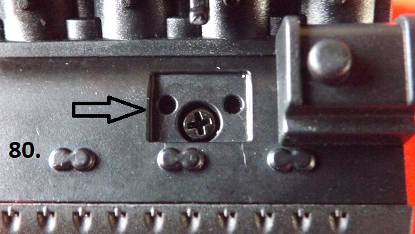

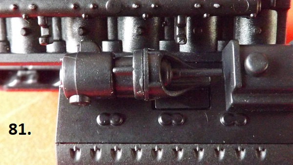

PICTURES 80 & 81
This part is then superglued onto this slot thereby hiding forever the screw that holds together the engine block.

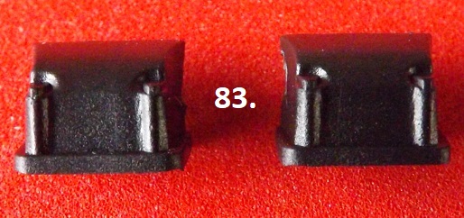

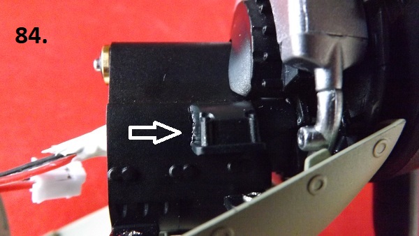

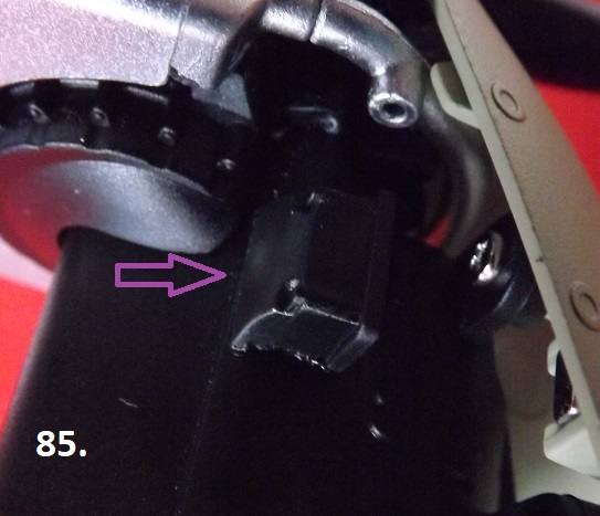

PICTURES 82, 83, 84 & 85
2 more small parts from the other plastic fret we get.
These are glued into place on the motor housing that we have already screwed into place on the lower fuselage part.

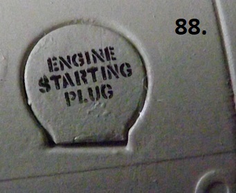

PICTURES 86, 87 & 88
Last part of this assemble section is to super glue this ting starting plug cover into the frame side.

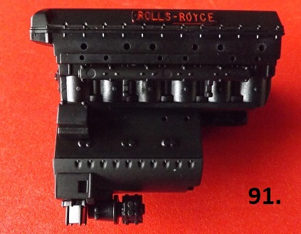

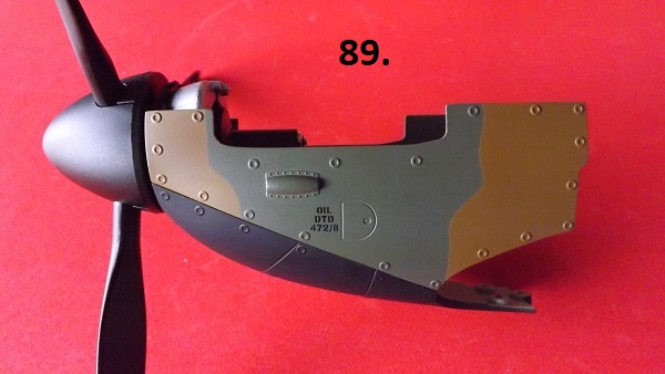

PICTURES 89, 90 & 91
And that completes these 4 issues.
What we end up with is shown is this last 3 pictures.
I am quite impressed with how it’s looking so far.
