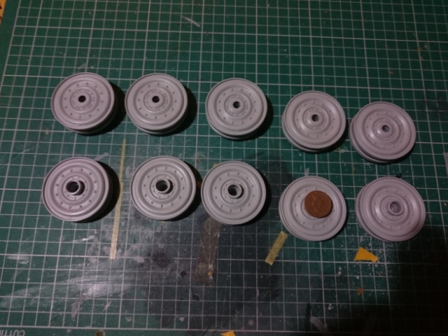

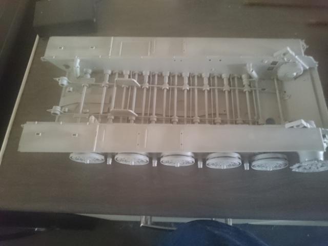

Hi managed to get the 10 Road wheels no 1 done, the fit on putting the 2 half's together was way to tight.so did them this way glue outer part on first side this has a bit of play on location but needs to be bang on central, use the other half to line it up,but this needs scraping with a knife on outside of location all way around to get lighter press fit,don't forget to put polycap in, so there bit of pain to do,take your time and don't try to force them together as they are you will just split the location,the joys of modelling eh. Penny on one to give idea of scale. Cheers mick BigGrin

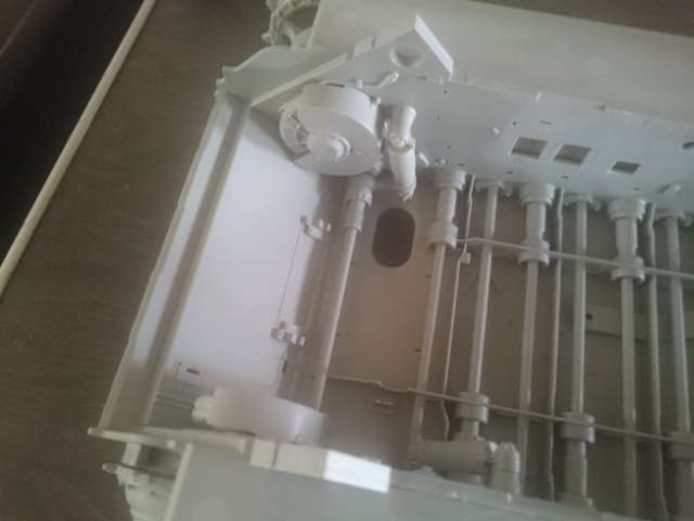

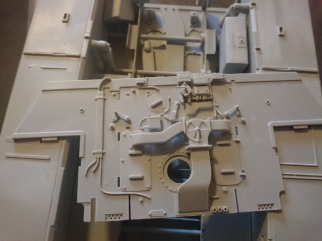

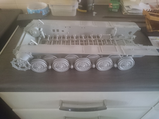

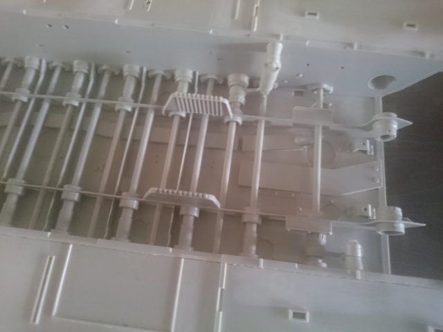

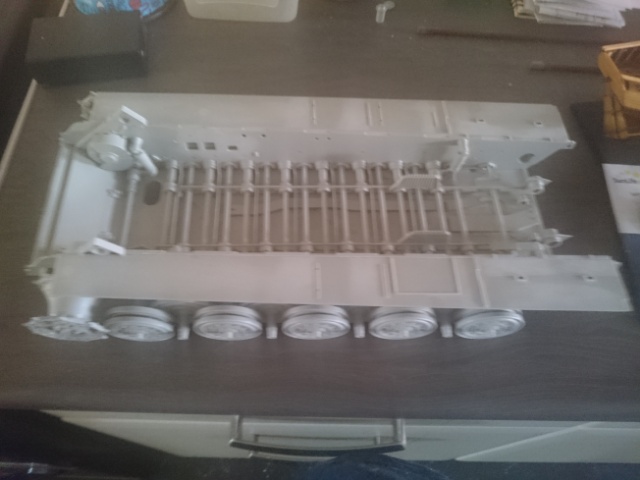

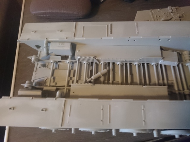

Bit more done on this. All the wheels bin put together, all ejector marks bin filled in, side plates added and suspension all built up, the holes in the side plates are where I have removed the episcope boxes as trumpeter used king tiger lower hull parts and there in the wrong place for a jagdtiger, also a fuse box bin removed as this is not fitted in a jagdtiger. These holes need filling in yet,then scratch build new episcope holders and put them in the right places. Cheers mick. BigGrin

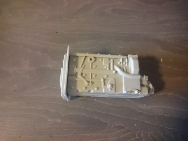

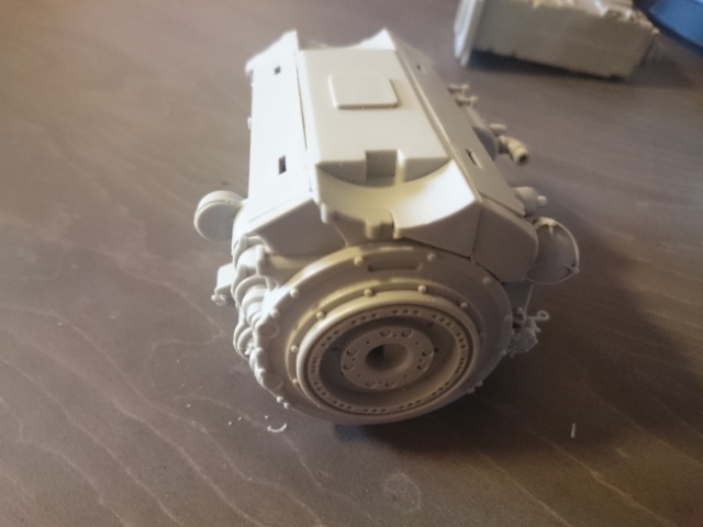

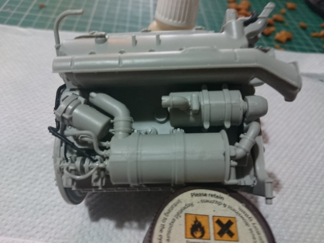

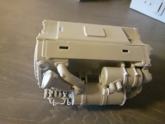

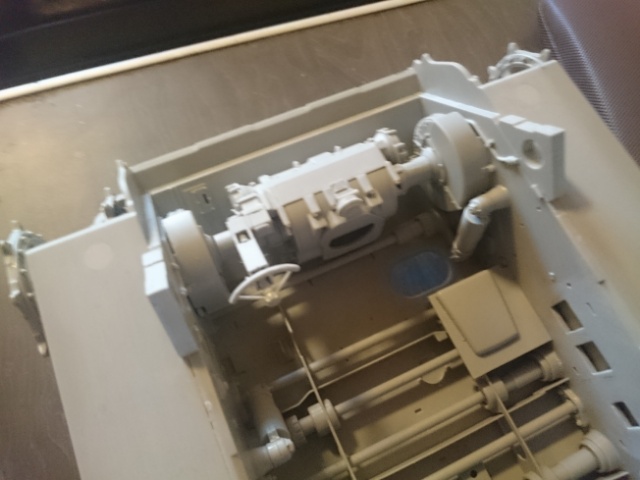

Hi thanks to all who looked in and left comments much appreciated, bit more done on this various tanks bin built up 2 large ones and 2 small ones in engine bay the firewall had various parts glued to it. The transmission at the front, gearbox and gearbox housing,you never see the gearbox once put in housing, but it's there and start of the engine,cheers mick. BigGrin

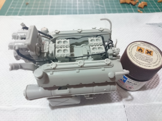

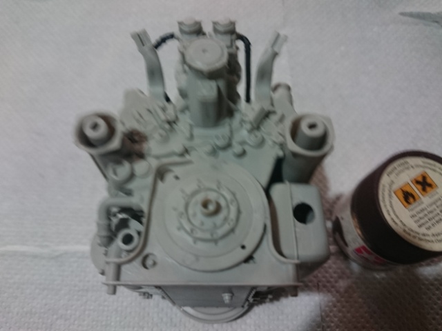

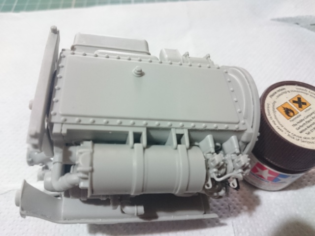

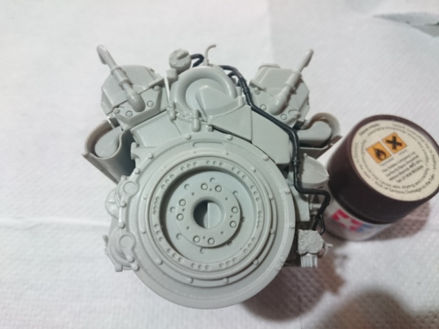

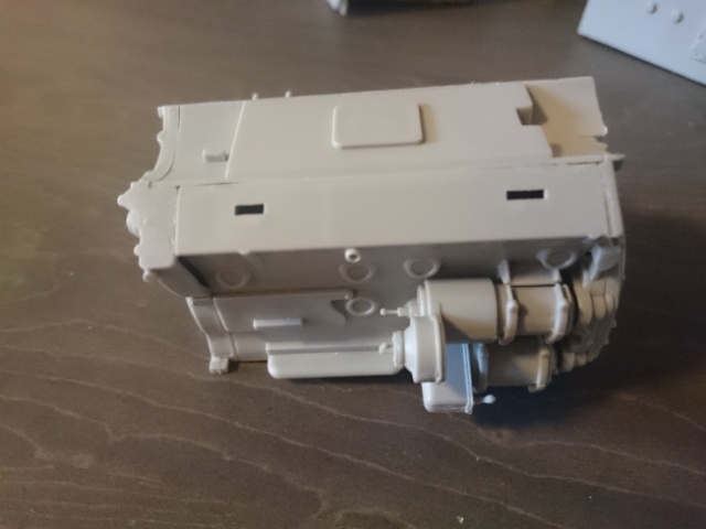

Hi thanks to all who looked in and left comments much appreciated, bit more done on the engine for this,there's a lot of parts to this still not finished yet, the vinyl plumbing is fiddly to say the least,the paint pot for scale. Cheers mick. BigGrin
