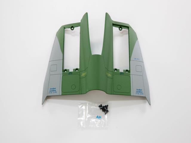

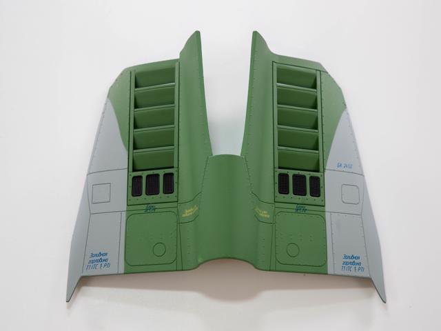

Pack 2

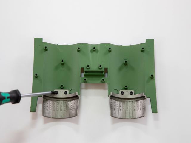

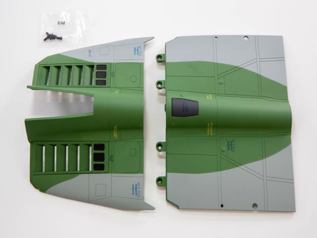

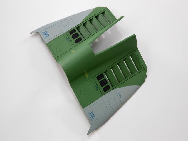

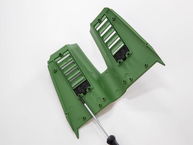

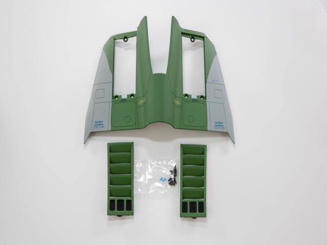

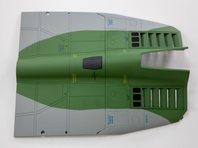

Stage 6.The Middle Upper Fuselage section (Forward section).
Stage 6 Contains:
Middle upper fuselage section, 8x AP Screws.
To avoid confusion, I have named this the ‘forward section’ of the middle upper fuselage section, as the next stage has a part of the same name.

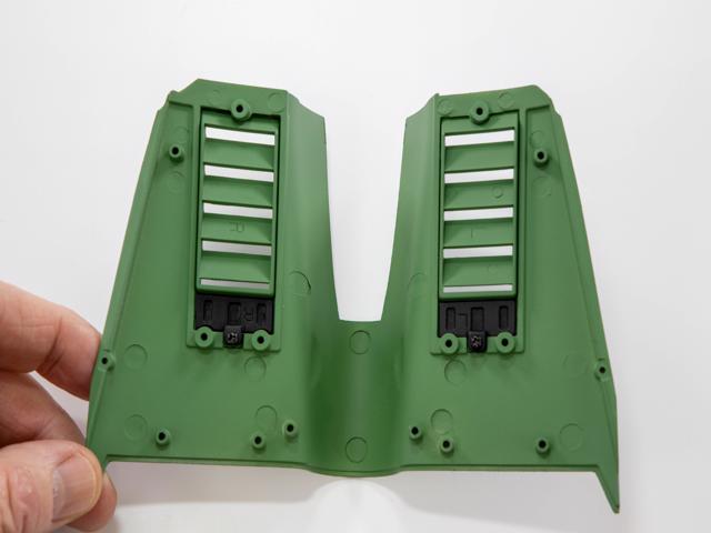

Retrieving the louvered air intakes from Stage 5, these are screwed into place on the forward section of the middle upper fuselage using the supplied AP screws. Take note that these are handed, left and right, so make sure you get them fitted on the correct side. If you look at photo 3, you can see where I mean.
This completes Stage 6. Store any unused parts in a stage-labelled bag for future use.

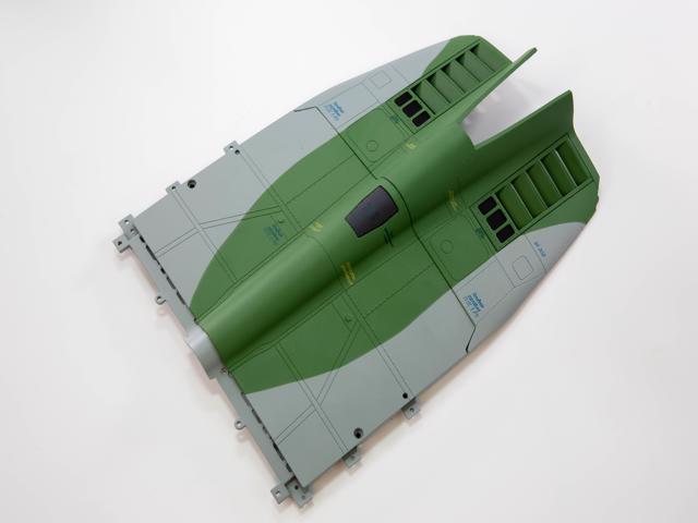

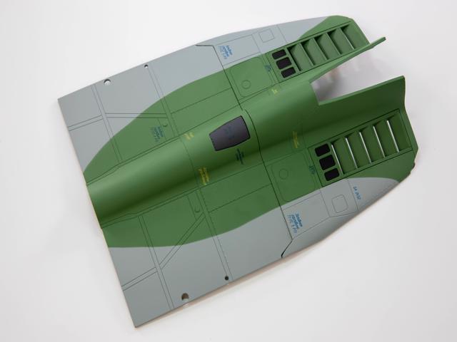

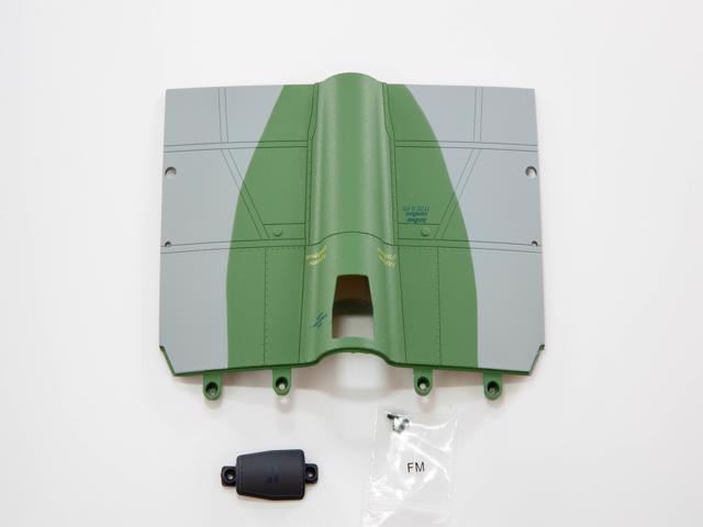

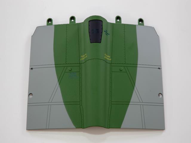

#2 Posted : 01 February 2020 19:52:46

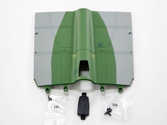

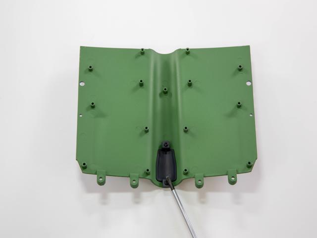

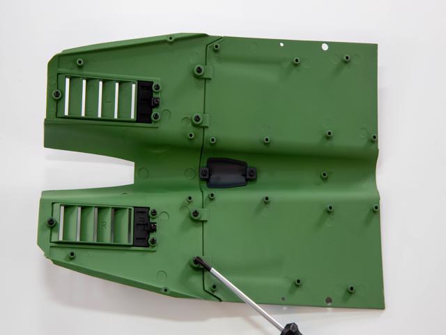

Stage 7.The Middle Upper Fuselage section.
Stage 7 Contains:
Middle upper fuselage section, ADF Antenna, 5x BP Screws, 3x FM Screws.
The ADF antenna is screwed into place using two FM screws. Retrieving the section from Stage 6, align the holes underneath with the fuselage section from this stage, and join the sections together with four BP screws.
This completes Stage 7. Store any unused parts in a stage-labelled bag for future use.

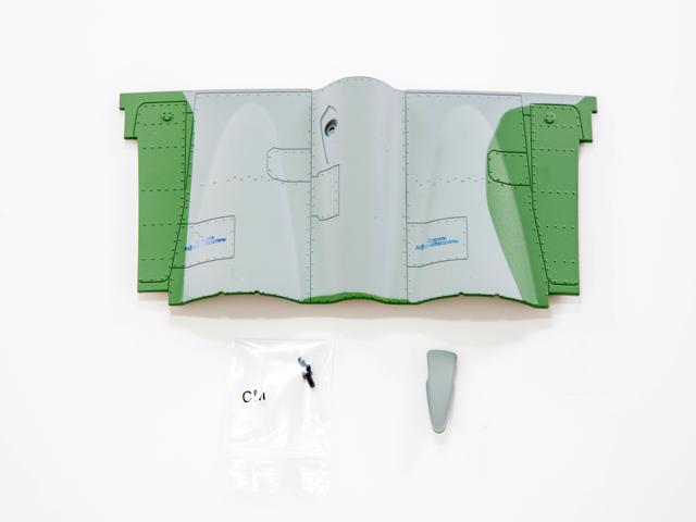

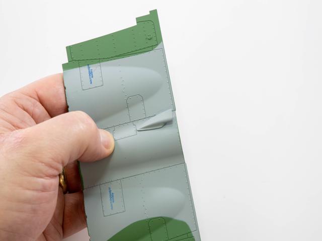

#3 Posted : 01 February 2020 19:58:31

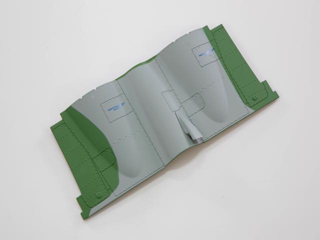

Stage 8.The Tail Upper Fuselage section (Forward section).
Stage 8 Contains:
Tail upper fuselage section, Cooling Air Intake, 2x CM Screws.
Again, i have named this the Forward section, to avoid confusion. This is another very short Stage, with little to do. Fit the cooling air intake to the tail upper fuselage forward section, and secure using one of the CM screws provided.
This completes Stage 8. Store any unused parts in a stage-labelled bag for future use.

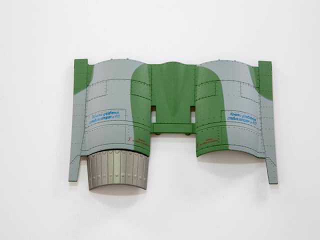

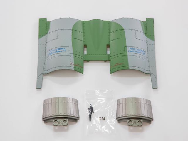

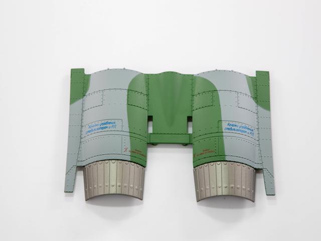

#4 Posted : 02 February 2020 12:54:42
Stage 9.The Tail Upper Fuselage section.
Stage 8 Contains:
Tail upper fuselage section, Port afterburner nozzle, Starboard afterburner nozzle, 5x CM Screws.
Attach the two afterburner nozzles to the tail upper fuselage section from underneath, so that the two locating rings sit over the screw holes. Secure each side with two CM screws.
This completes Stage 9. Store any unused parts in a stage-labelled bag for future use.

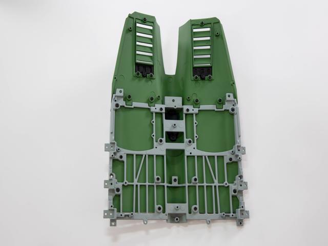

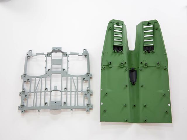

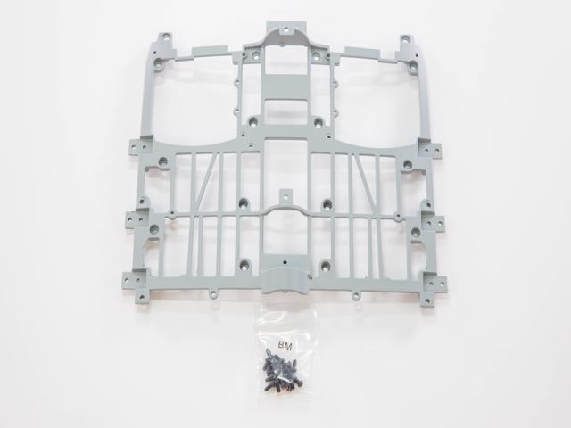

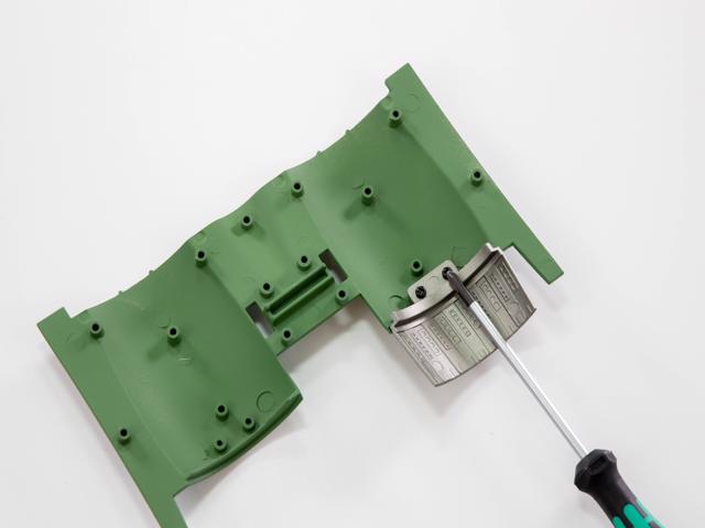

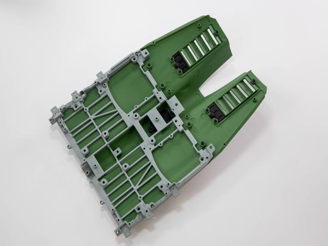

Stage 10.The Middle Upper Fuselage frame.
Stage 10 Contains:
Middle upper fuselage frame, 16x CM Screws.
Firstly, retrieve the middle upper section assembled in Stage 7. Lay it upside down to Expose the fixing holes. Fit the frame on top, so that the holes on both sections line up, and secure using fifteen DM screws.
NOTE: In the assembly instructions, the arrows on the top row do not point to fixing points. These are merely used to align the frame correctly.
This completes Stage 10, and Pack 2. Store any unused parts in a stage-labelled bag for future use.
