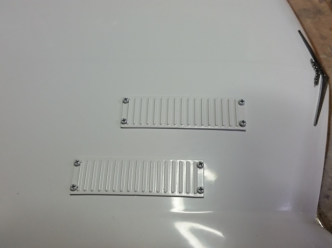

Issue 1
The bonnet.
This issue is obviously an 'attractor' issue, large component in nice, shiny, gloss white. In this, it certainly works. The shape of the front of the bonnet is immediately recognisable, and the chrome parts are already attached at the factory. There is very little to do in this issue.
You get the bonnet, a screwdriver (Which may or may not be any good. I used my own screwdrivers anyway,), two parts for the front of the vehicle, the number plate, the two grill/vent parts, screws, and a logo sticker which is not used anywhere on the build, but can be used to decorate anything else you may wish.
I am going to break with the printed instructions at this point as I have already ordered a replacement set of grills from Mike Lane Mods, these should be arriving before my next delivery, so will do an update on the vents at that time. It is nice to note, however, that for anyone using the supplied vents the screws to attach these to the bonnet have white painted heads so they are not so visible on the finished model.
So with the grills and screws placed to one side until then, I carried on with the trim pieces.
These are just connected with 4 "BM" screws at the back. I don't know if the BM screws from this build are the same BM screws from the Delorean, but it would make sense, and it's nice to see EM keeping to the system of using the last letter of the screw identification to let you know what it will be screwed into (i.e. BM screws into metal, BP into plastic)
So that is it for this issue. The logo isn't used, and I am not installing the vents until later, so on with Issue 2.

#11 Posted : 20 January 2020 23:21:13
oooh I will be watching this.it wont be out in USA for another couple of months.
Those hood scoops are awful.Why didnt they put the screws in underneath instead of on top of the part.I have read some people have had the screw heads snap off when they install them. You will needs MIkes mod definitely to get rid of those things.

Yes, I have heard the same about the screws for the grills on the World of Wayne channel on Youtube.
About the possibility of screwing them in from underneath, that would depend on what is happening with the underside of the bonnet. Given that it is pre-coloured, I suspect that there will nor be room for screws that are not planned by EM. However, as these parts are only ever going to be cosmetic and not structural, I can't understand why EM don't use double sided tape like Mike has done.

I bit the bullet and decided to try a couple of packs to see what the quality is like and have received pack 1 which looks good.
As a follow up to the vents on the bonnet I have just fixed both in place without issue. What may be causing a problem in some cases is paint in the threads of the holes or on the screw threads from the painting process, but turning the screws in and then back a bit several times will clear that problem. (Mine went in no problem - pic below)
Later I will fill the screw heads and put a spot of white paint on them. I certainly won`t be paying £30 +vat for two stick on vents.Crying Crying
Good luck to all who build the ECTO1. BigGrin BigGrin

Delboy, I have not really had any trouble with the bonnet vents, just waiting on Mike Lane's versions.

Not quite that simple though, Roy. The profile of the vents is not quite correct, so copying the current vents would not correct that. Mike Lane has. Whether you want or need that level of accuracy in a model is completely down to the individual building it. Manufacturers are limited to being able to make money, but there are people, of which I am one, that want more than that. I was really annoyed when I found out that the gearbox on the Delorean was an automatic and not the manual gearbox that it should have been. As someone with Aspergers, I have a high drive for accuracy and i have bought almost all the mods for the Delorean. I can't see this changing for Ecto-1.
